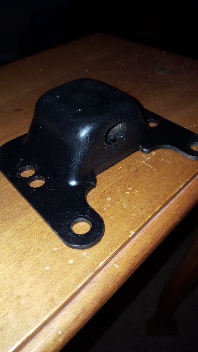

1. I have seen that there are different frame stands for these cars. Mine is a big block Buick so my factory stands won't work, correct?
2. Here is a picture of one from an extra set that I had laying around the shop. Are these the ones I need? I have a set of DD's I plan to use.

Hello,
I bought the Holley forward bias engine mounts and did not use any part of the mount in your picture on my A-body. This one inch or so of forward movement of my engine allowed much easier use of my 4L60E without cutting the floor pan - also could reuse my stock El Camino transmission crossmember. I then paired the Holley mount to a 2002 (I think) model year Camaro half of the engine mount. This also kept my driveline angles down the drive shaft to the differential nearly perfect.
I used my original 5.3 liter underhood battery to starter wiring harness and a few "Adel" clamps to attach it to the forward screws of my oil pan.
