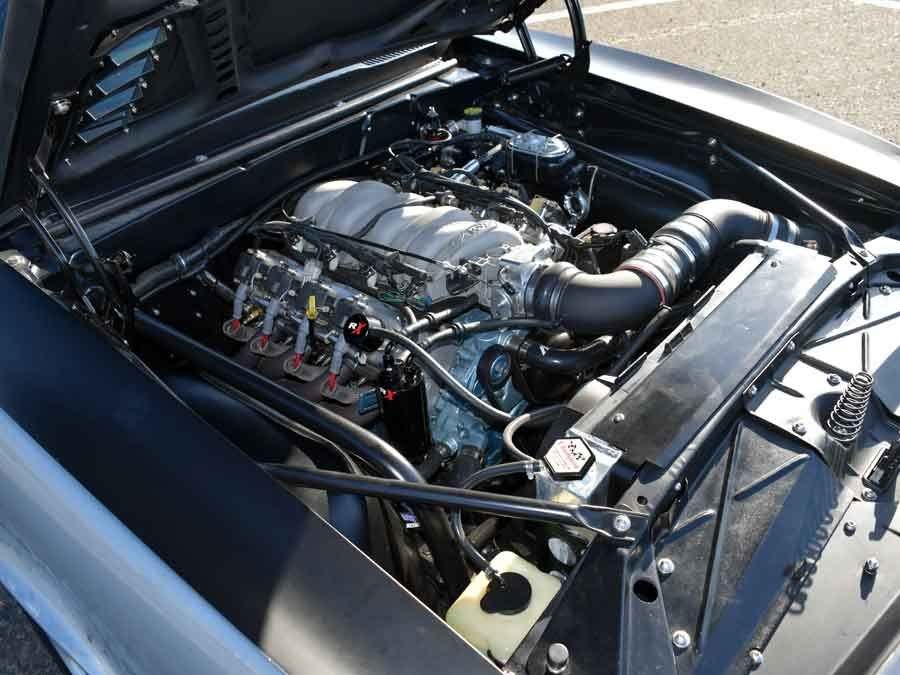

I know im terrible at updating build threads. But the engine is in after a few setbacks and life happening in general. Here are a few threads showing my issues over the last few months.
Swap Plate Issues:
https://ls1tech.com/forums/conversio...surements.html
I wound up using the ICT plates as far back as possible, so now i have another set of plates to sell i guess.
Holley Terminator X Misunderstanding/First Start:
https://ls1tech.com/forums/conversio...minator-x.html
Found out you need to take the SD card out of the Holley Handheld and use the computer software in order to pick stock injectors and a stock MAP sensor.
Power Steering Line Blows Off:
https://ls1tech.com/forums/conversio...blows-off.html
Ordered an adapter, should be in today.
Aside from that ive been idle tuning, and i drove it to the car wash yesterday with minimal issues, just no power steering.
