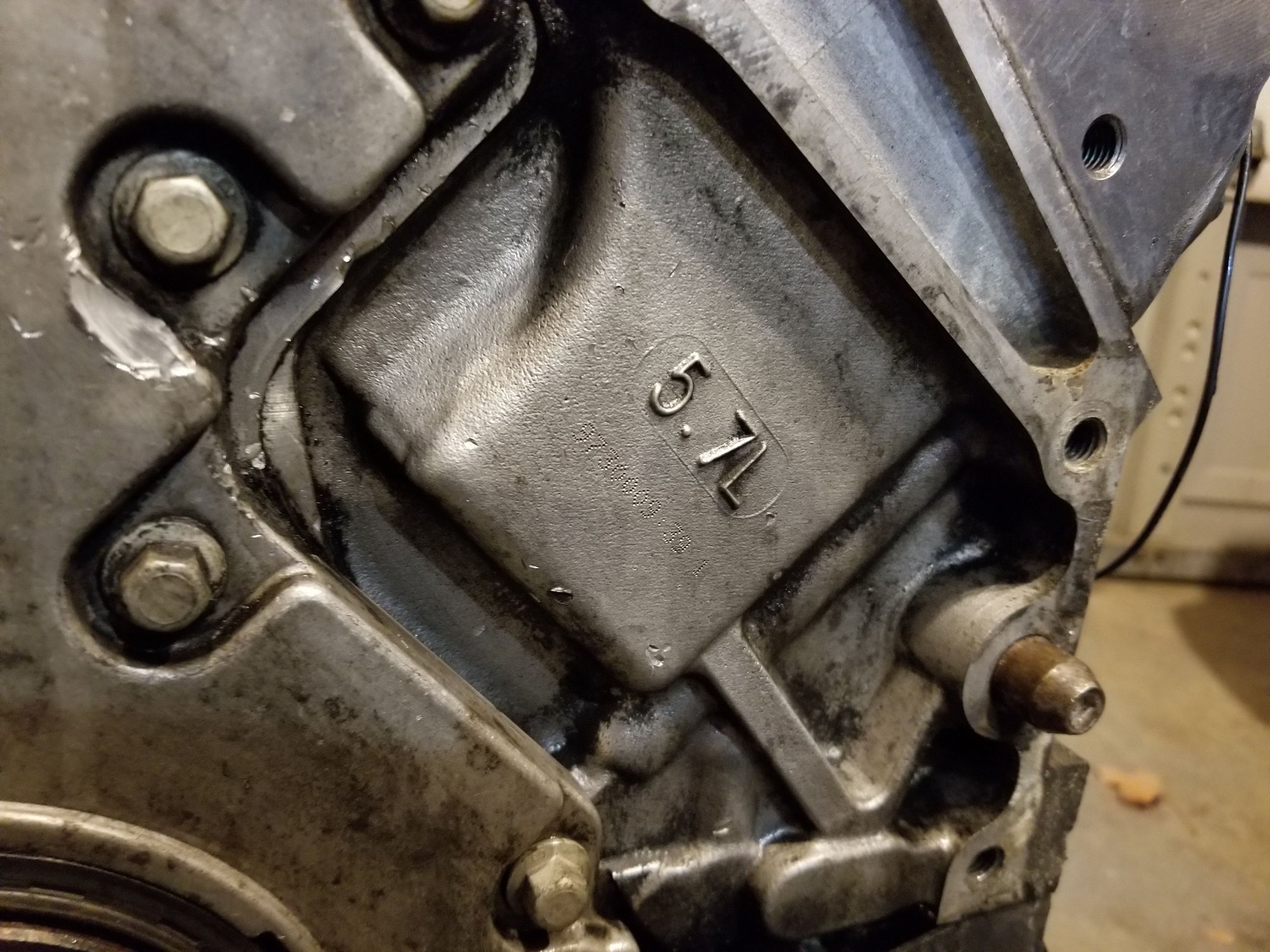

Heres the engine thats going in.
Its a 1998 LS1, with stock ugly perimeter bolt heads.It has a cam in it, a Thunder Racing Trak Cam (231/234 .640/.590 112 LSA). Dual springs, TS Pushrods etc... Everything else is stock, and no idea on mileage. I plan on either using the heads off of my Junkyard 06 4.8L or pulling another set if i can find 243's. I dont plan on a boosted application for now, so the LS1 should be fine. I may switch to a gen 4 truck engine in the future if i get bit by the bug.

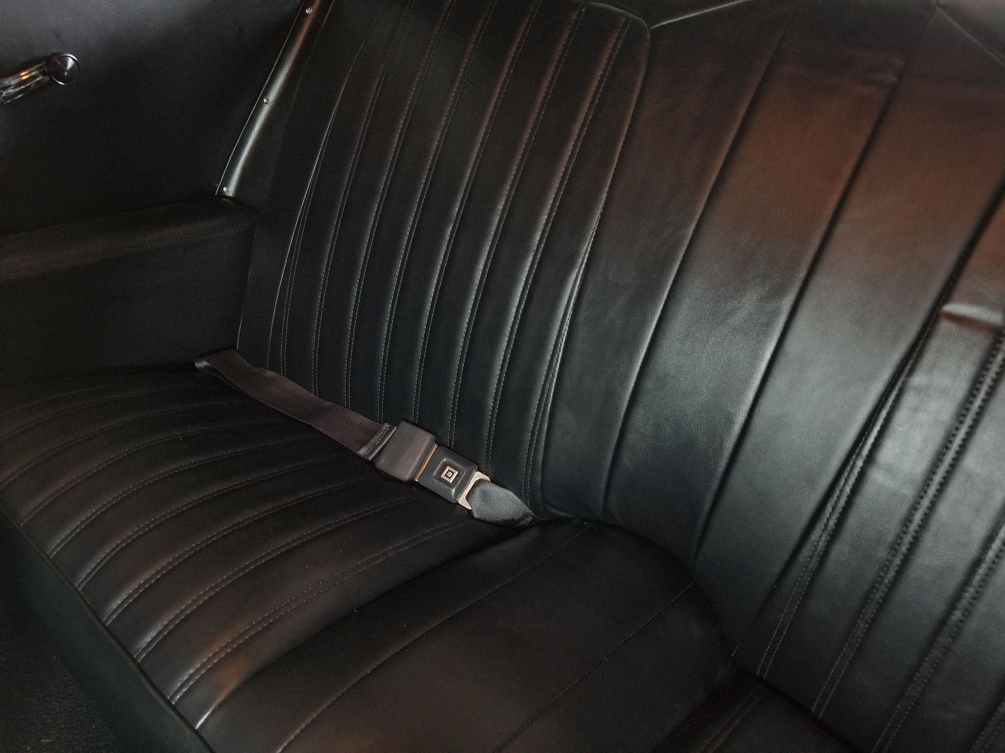

Recently swapped out a very bent axle, and found some GM seat belts for the back so i can put the car seat back there.

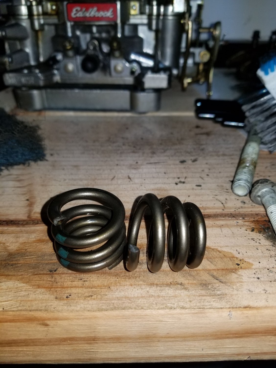

Got lucky and found a set of 799/243 heads in the junkyard, on an 08 Van with 80k Miles. It was bucket day at the yard, so they were 25% off. Not a bad score for $60/pair.
Had to remove a couple broken bolts, the gen IV motors seem to have better bolts.
Then I found out why the van was junked, it had a broken valve spring. Looks like it nicked the piston, but i took the heads anyways for the price. The Valve doesn't look bent, i might just run with it, im not sure yet.

If the valve is not bent, I bet the valve guide is fine.
Andrew
Andrew
Thats reassuring, the valve sure feels fine in the seat. I may just lap them for good measure.

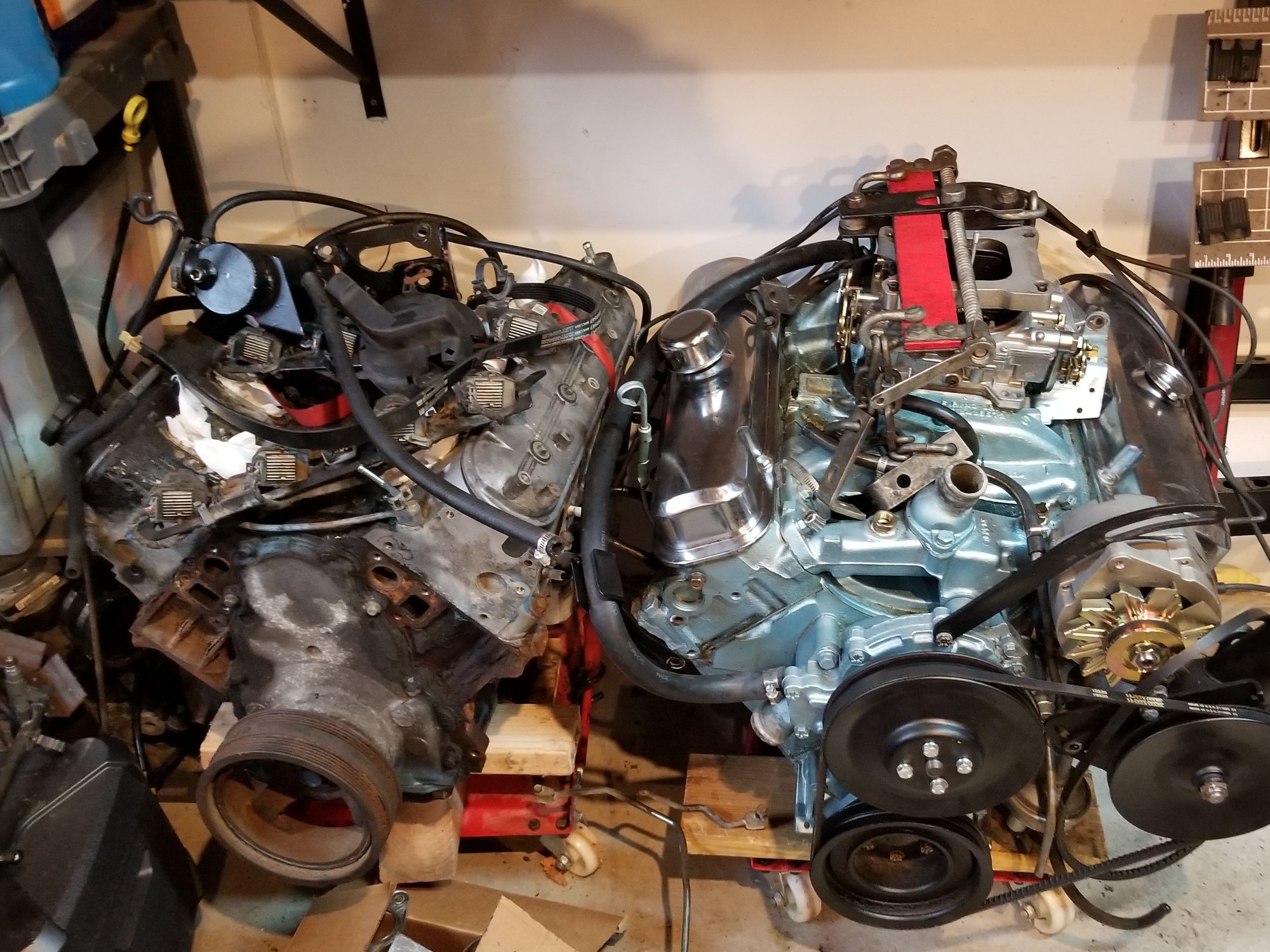

Pulled the old 600lb monster out. Set it next to an Iron 4.8L for size reference. Should be a nice weight savings going to an Aluminum LS1.

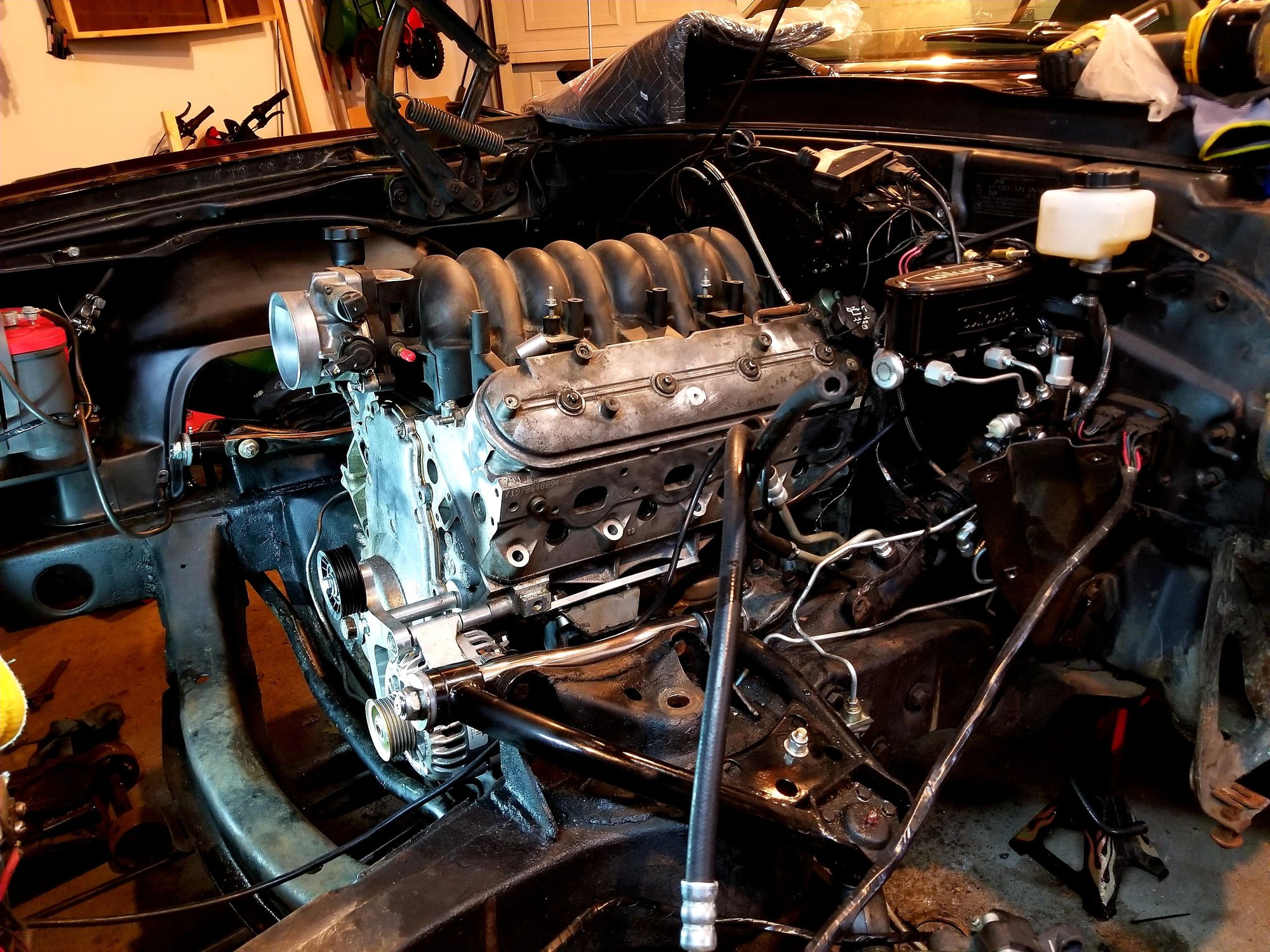

Mounted the engine to start mocking things up and checking fitment.

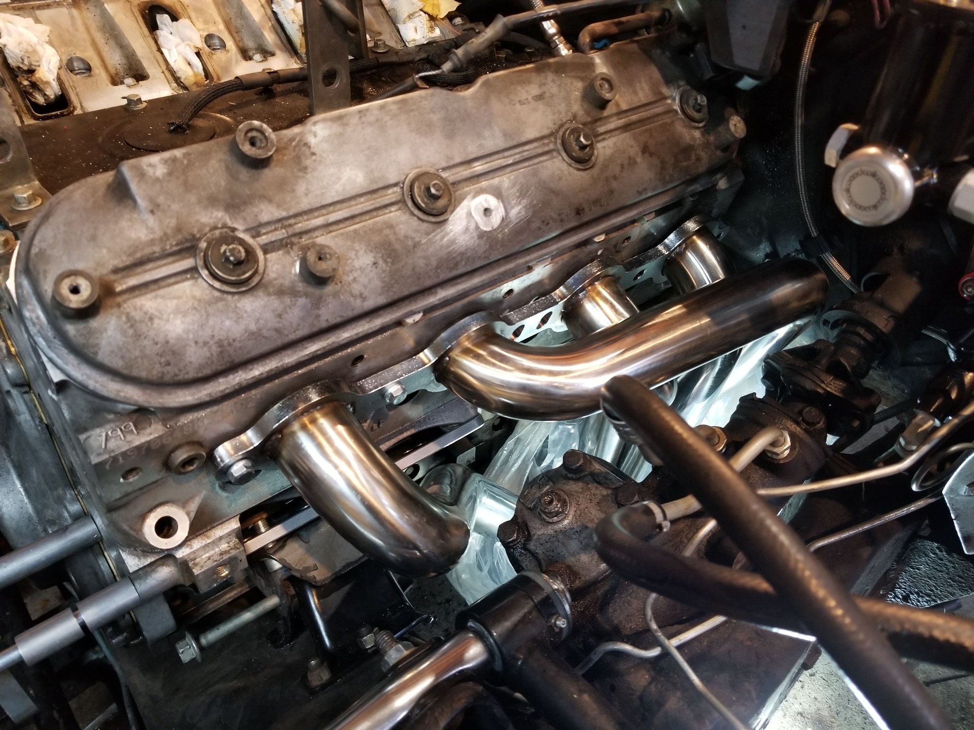

Test fitting the headers.
They get pretty close to the steering, but do not touch. Also there is only one plug wire that looks like it will be a pain.
