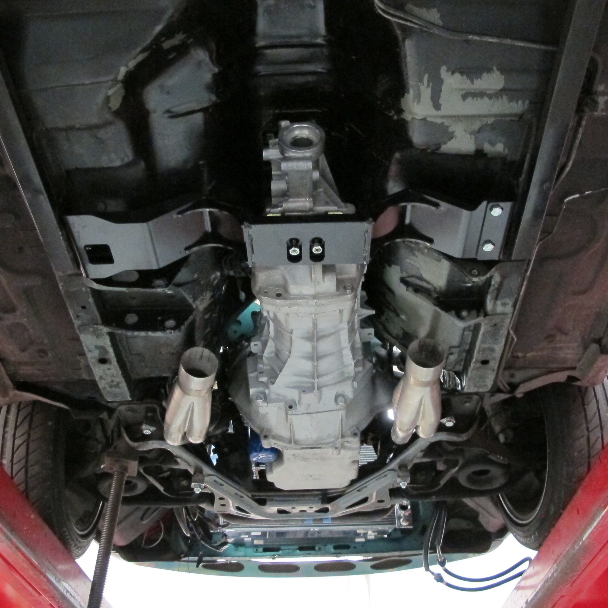

If you use the Hooker Blackheart Fox Body LS swap components to mount your engine/T56 transmission, you will only be required to trim some extraneous production locating tabs off of the right side of the transmission case and cut a 3/4" deep notch in the rear edge of the factory tunnel shifter hole. This reduced effort is due to the Hooker mounting components locating the engine/transmission mating plane in the stock SB Ford fore/aft location and the engine center line in the stock offset position also.

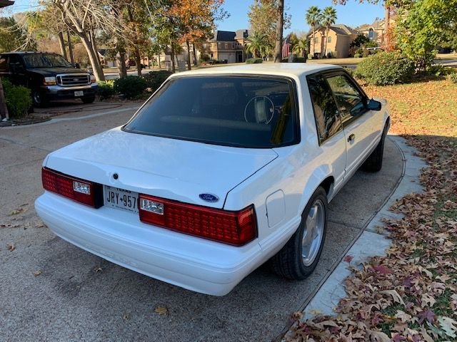

A couple of pictures of my 1991 4-cyl coupe. The previous owner said that it was painted about 2 years ago so it looks fair. I'm going to have the car painted again after my mechanical work. I want it to look real good not just fair.

Yes, those would be the correct engine brackets to use with the stock OE or Maximum Motorsports MMKM-1 K-members. You will have to use the Holley 302-3 oil pan in order to clear the steering rack, the F-Body pan will not work.That is a real nice car to base a swap project on.
