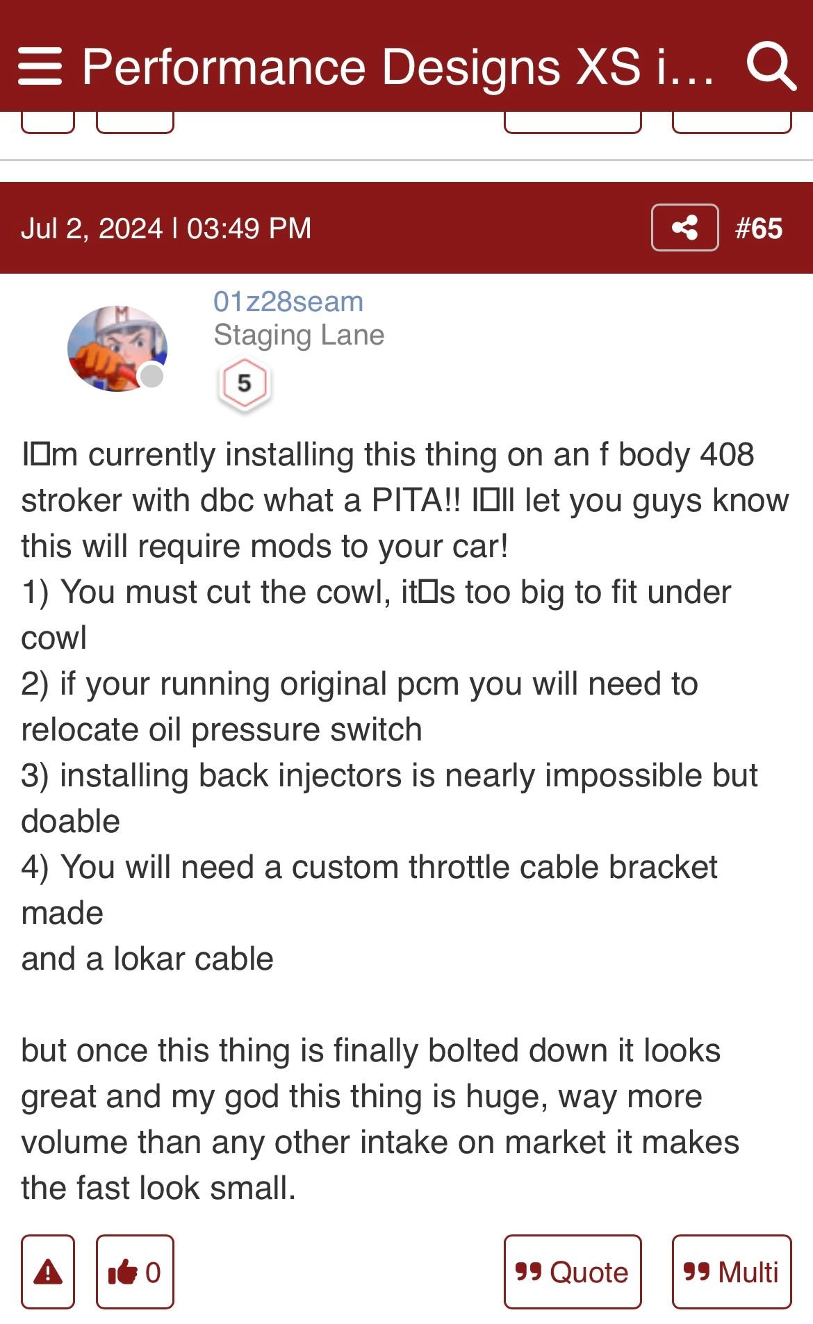

It appears running an XS would require cutting the cowl on a 4th gen F body. That would be something out of the question for me with my current low mile WS6 unfortunately. If it was a less desirable car I’d have no problem cutting the cowl. It’s too bad they didn’t make an LS3 MSD.
Why not PM that guy and get a few pictures of the bracket they fabbed up?!
That would be a nice addition to this thread
