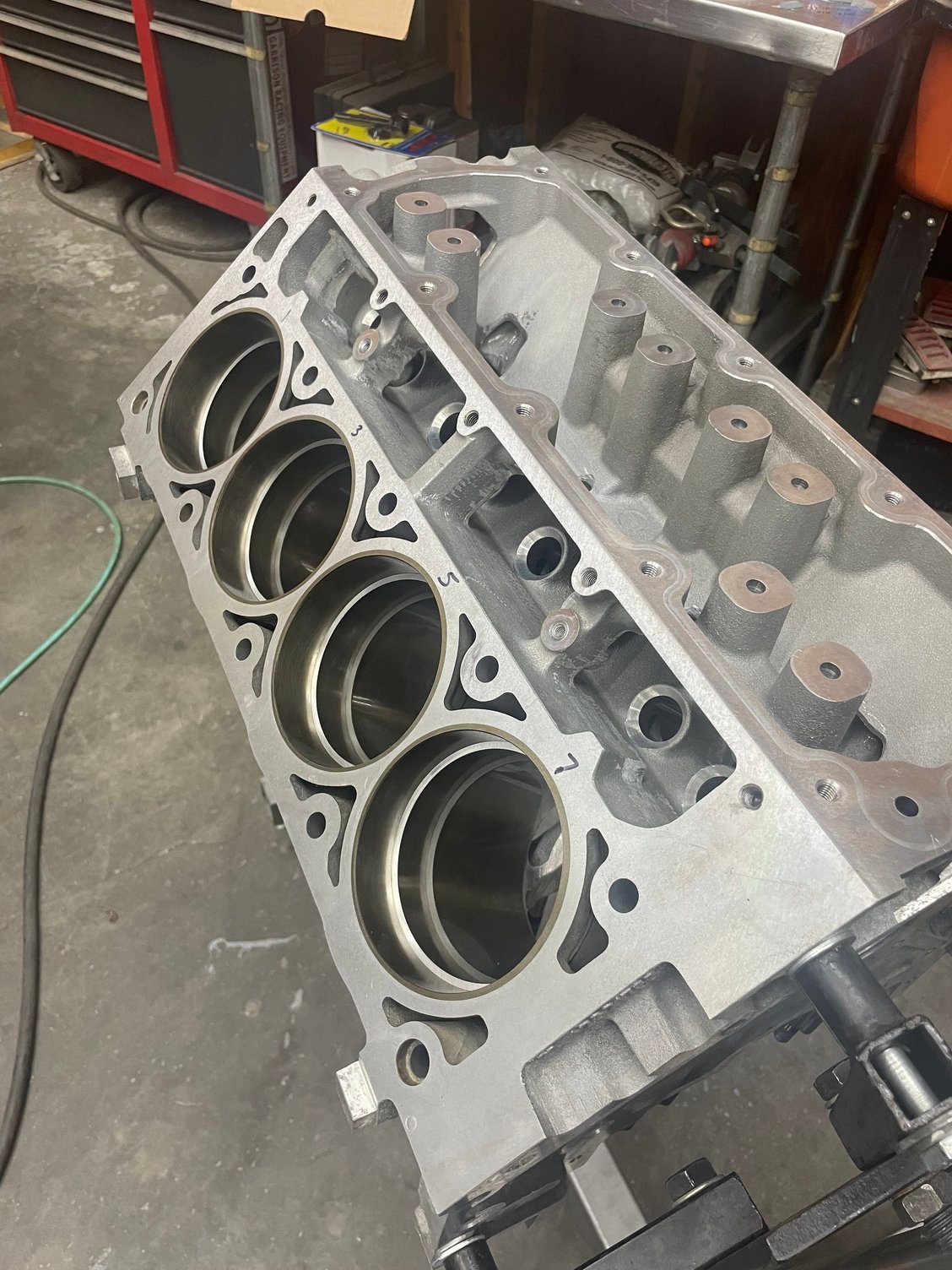

The Oem LS3 block was precision honed to 4.070
Semi-custom Wiseco pistons .043 rings with 2mm oil pack

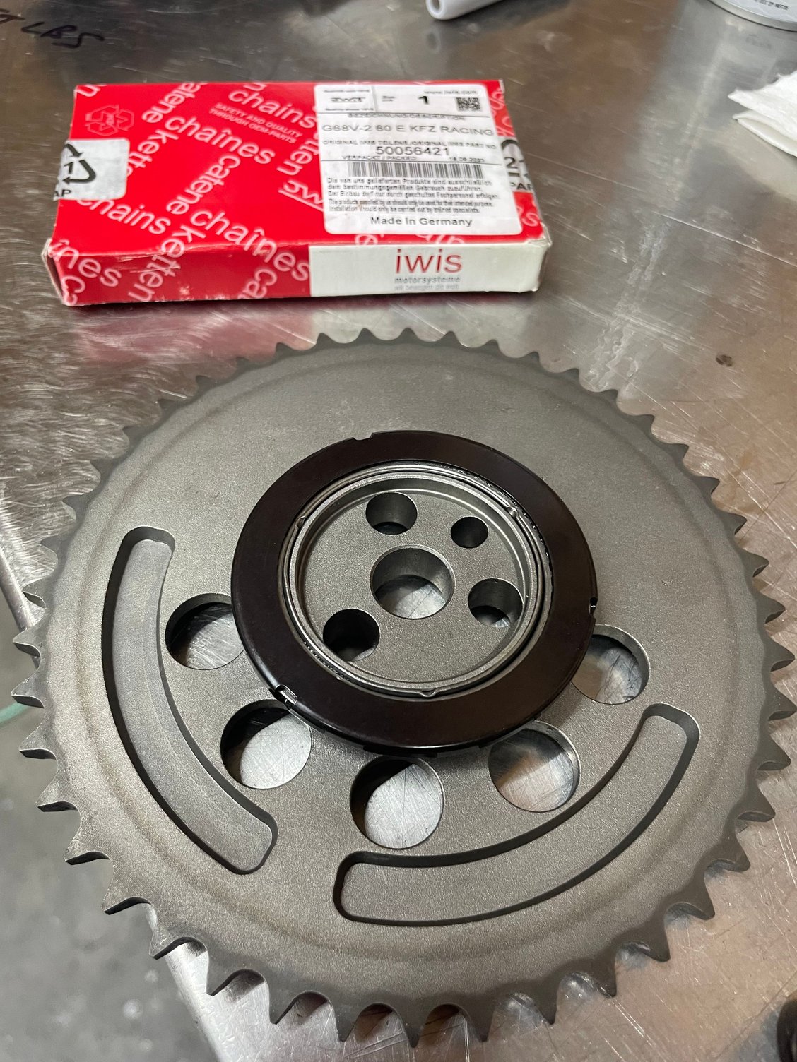

billet timing set

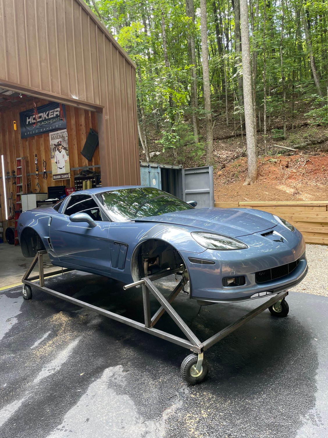

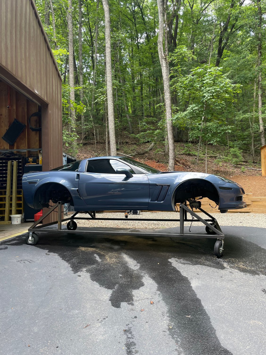

Having a car occupying a lift for months isn’t practical so I built a body cart to bolt to the body and rolled it out of the shop when I needed the lift for other stuff. Anybody out there need a body cart for a C6 Vette? Cheap!!!!!

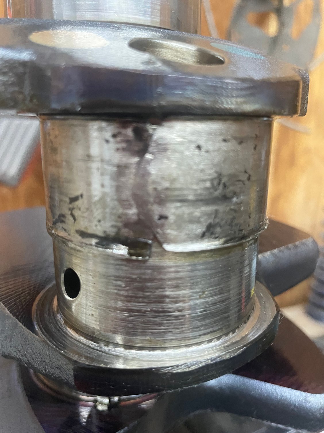

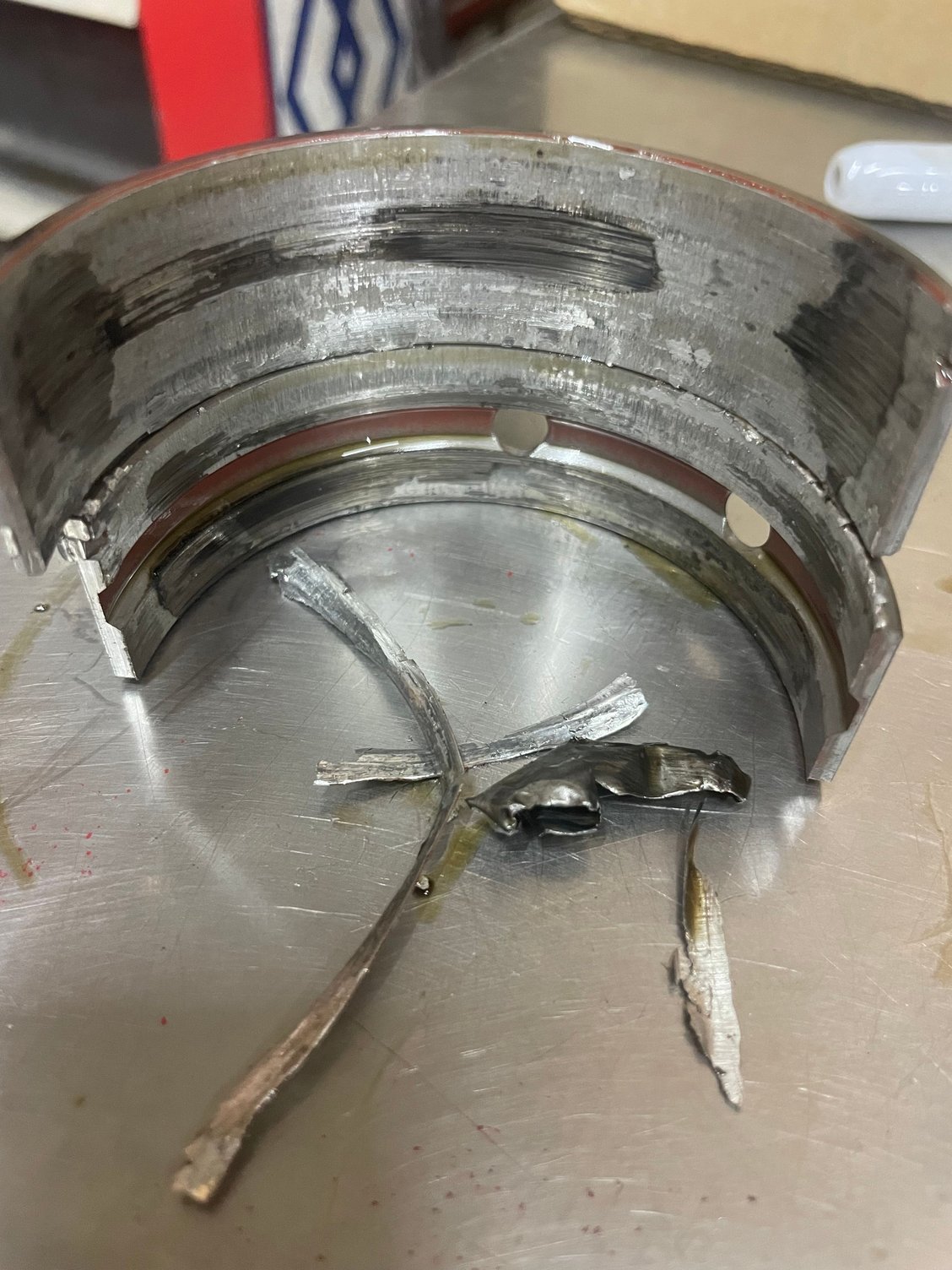

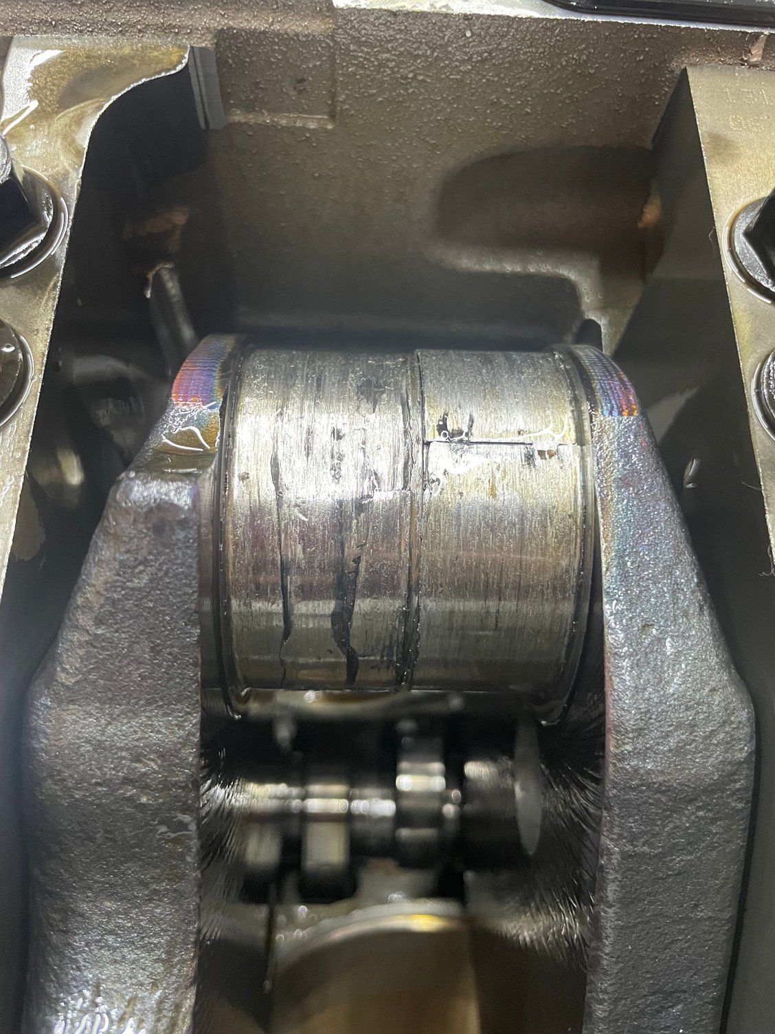

Upon tear down, there was 2 spun rod bearings, and 2 spun main bearings…it was a mess. So oil tank assembly had to be disassembled and completely cleaned. Those of you that know me at all, realize that I’m a stickler for cleanliness so obviously it was coming apart anyway. Oil lines from tank to pan were cleaned several times. I elected to replace the oil cooler lines and the oil cooler…with consent from the owner of course…with an Improved Racing oil thermostat and their oil cooler lines. I located a new oil cooler, which are getting hard to find, and the entire oiling system was now up to par. Anybody like pics?

Oooof that's some carnage. Lucky it didn't window the block! Were the mains reusable? The last bearing we spun we needed to replace the main cap.
Excited to see what this puts down! I suspect it will be quite the performer. Always been intrigued by those 3.9" stroke cranks. This will be a fantastic datapoint for that new intake manifold as well.
Mains were fine. We were doing a line hone for ARP studs anyway, so it all cleaned up nicely. Amen on not windowing that block! Lots more coming here…

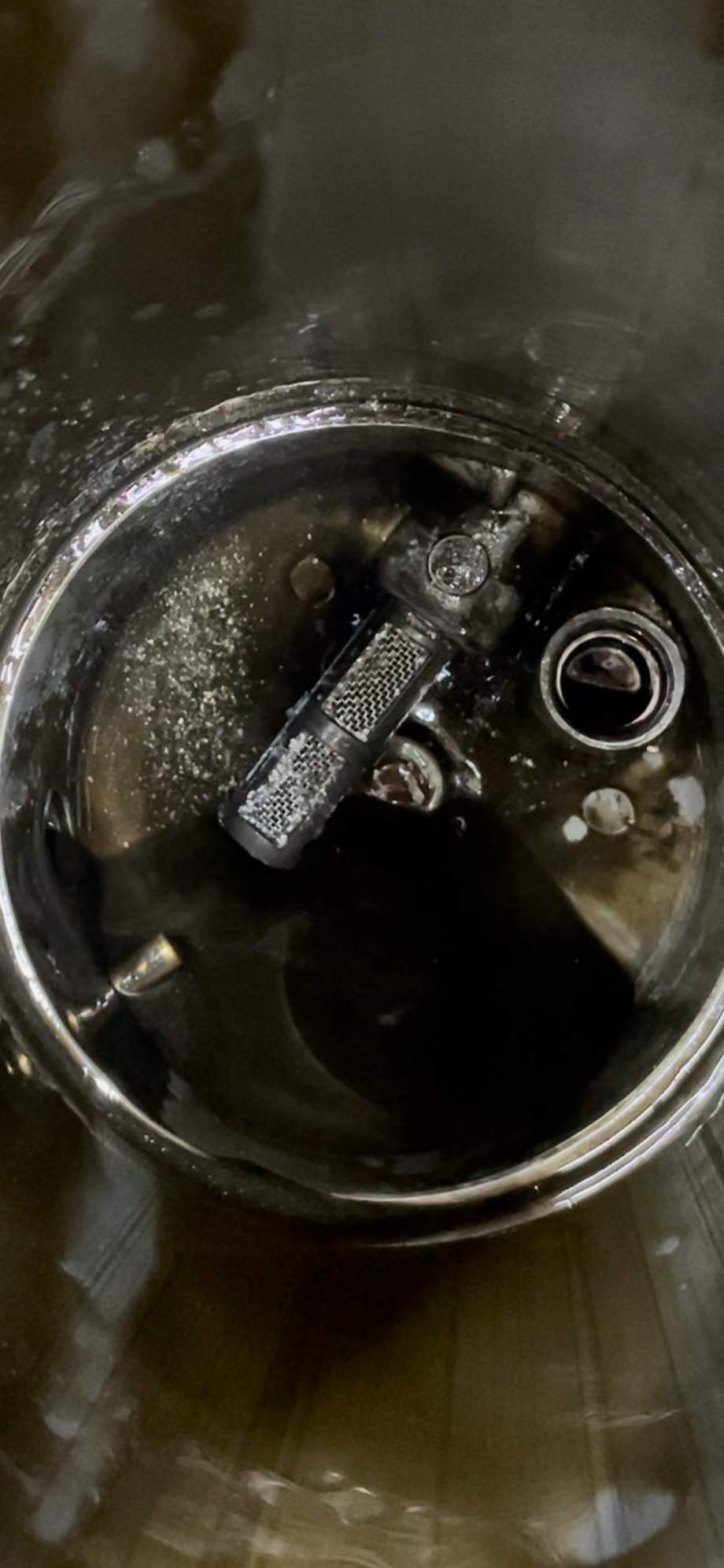

This is what the oil tank…which I pictured above full of bearing debris….looks like after I disassembled it and cleaned it…

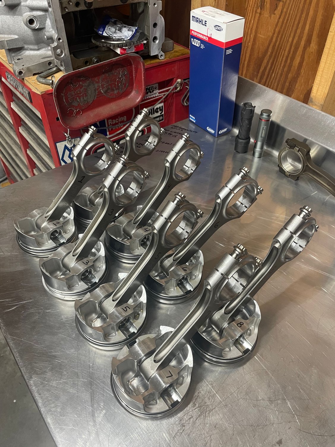

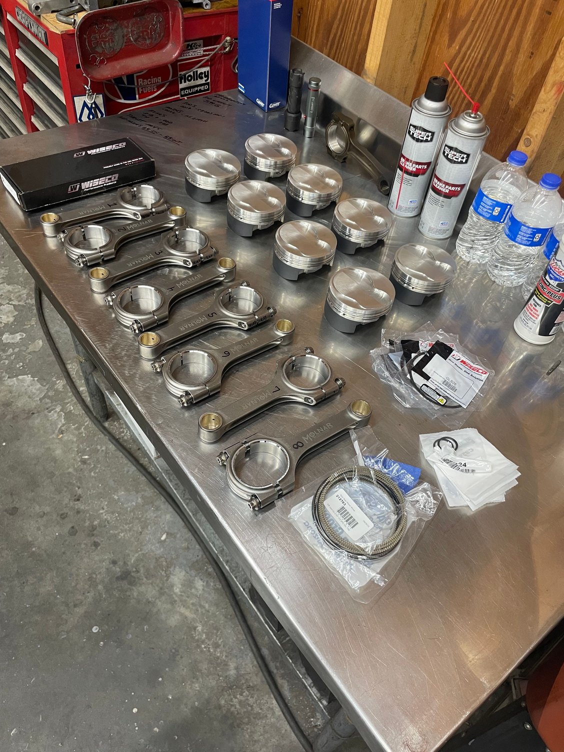

Here’s a bunch of pics randomized inner engine pics. You guys like pics, right?

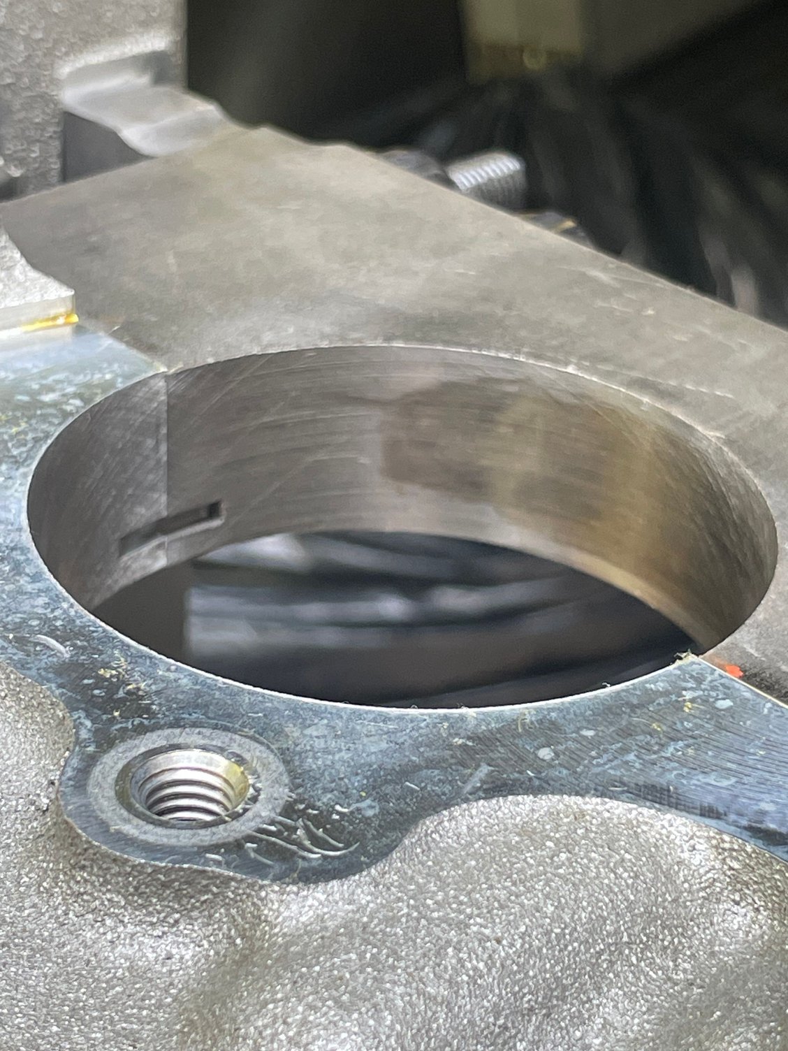

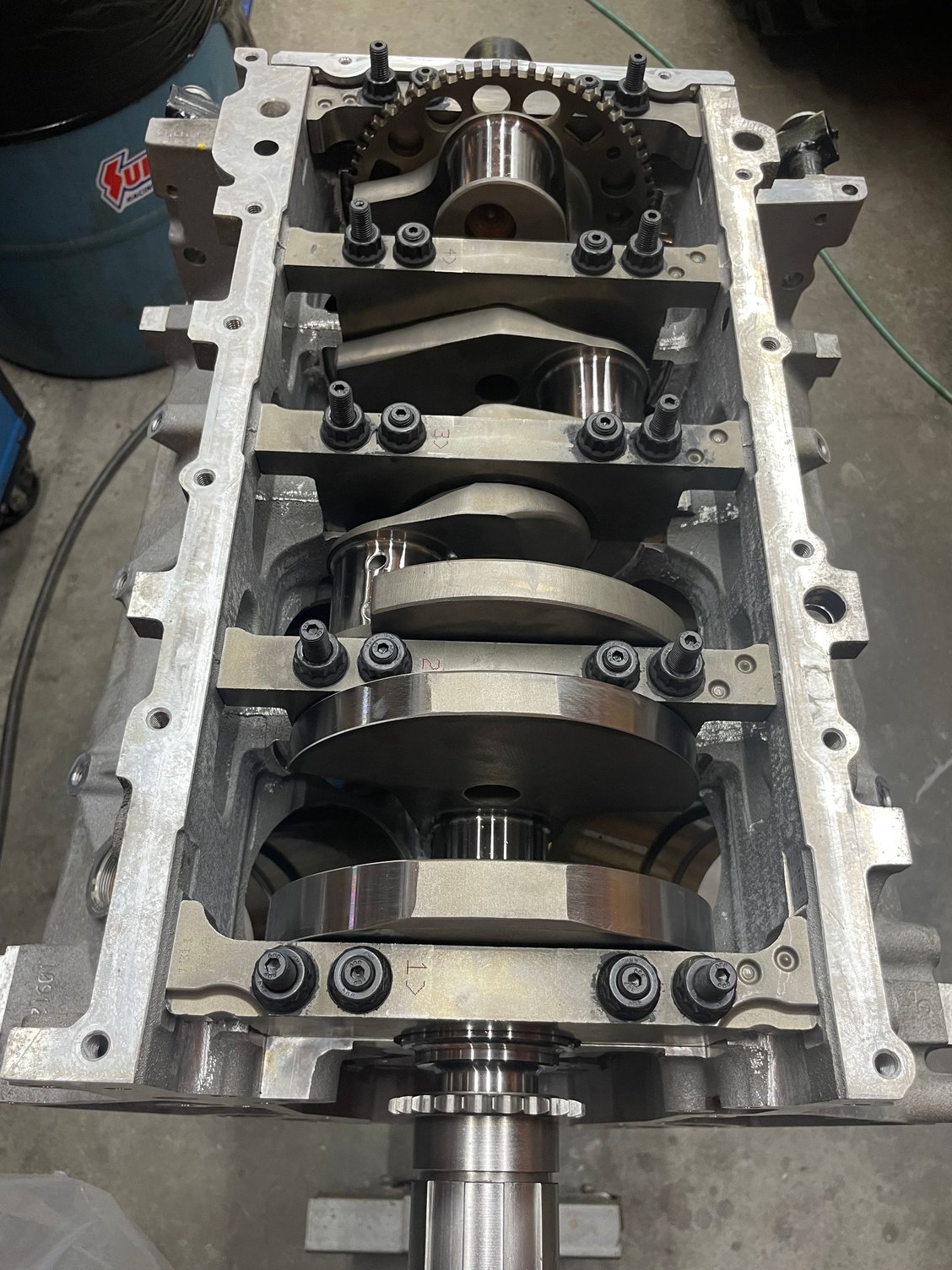

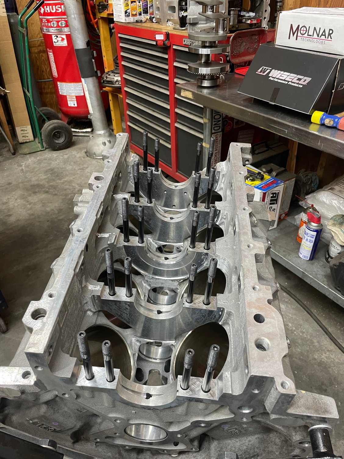

I’m posting this pic by itself to illustrate why it’s important to line hone your mains after ARP main stud installation. The shadowing illustrates where the hone didn’t touch. I’ve posted this pic recently in another thread to show my point. This is the front main of this build after line honing.

Crank in block for the final time and mains final torqued…

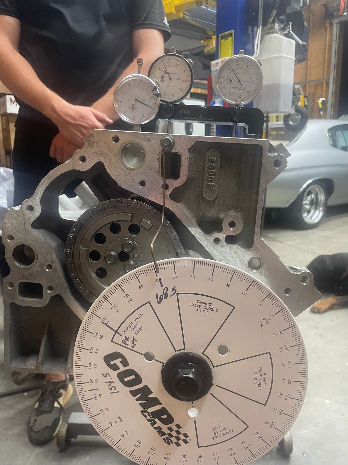

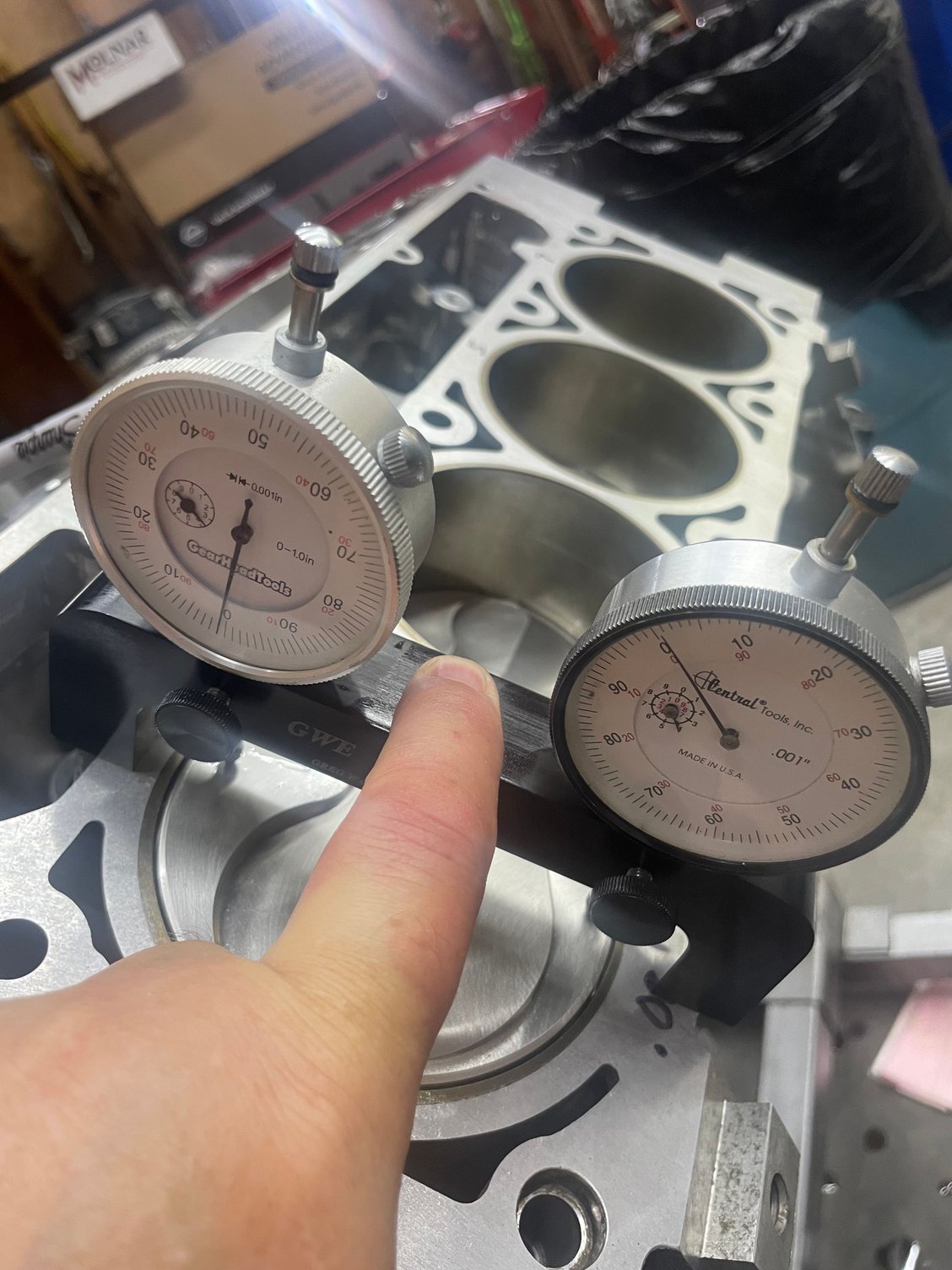

Finding true TDC here for camshaft degreeing…

I like that dual gauge for checking piston rock.

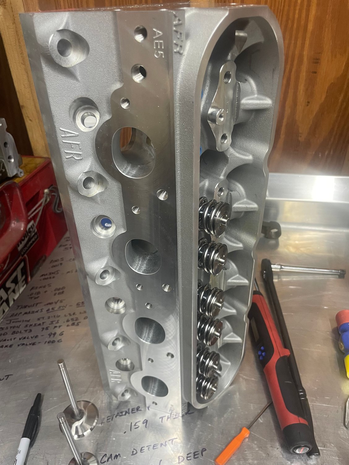

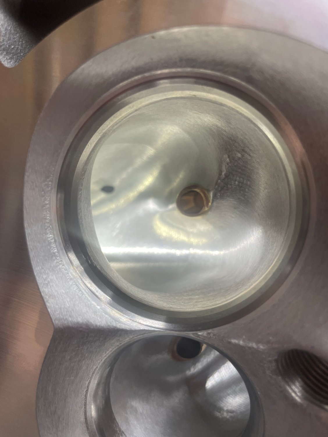

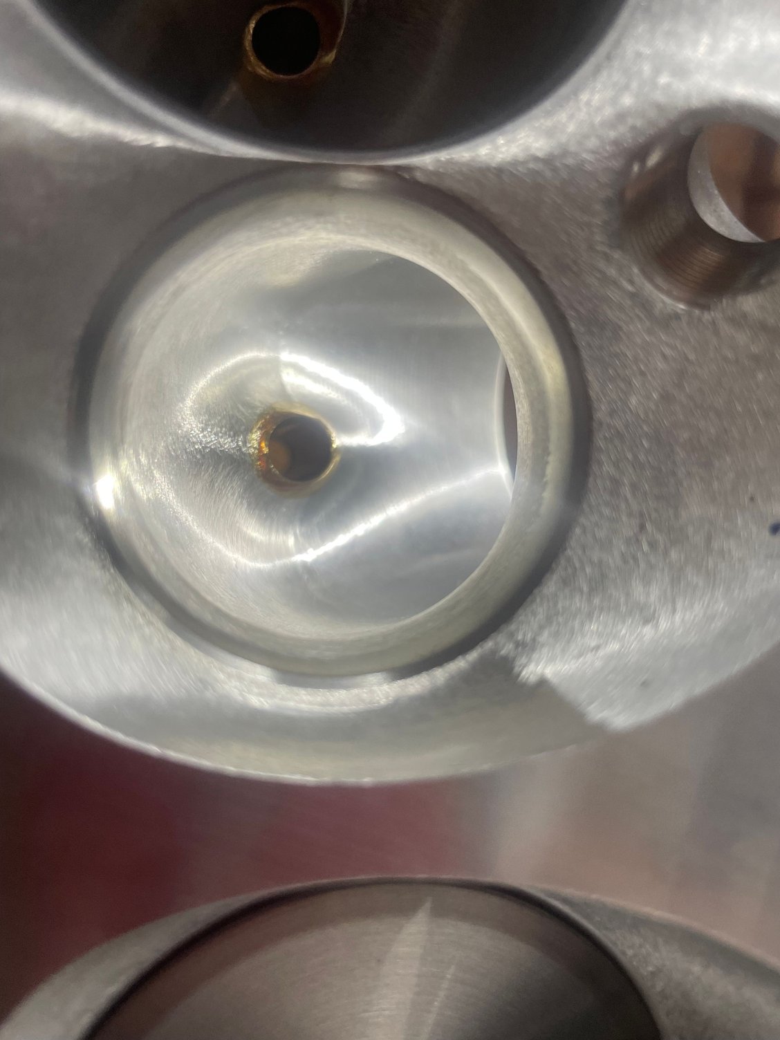

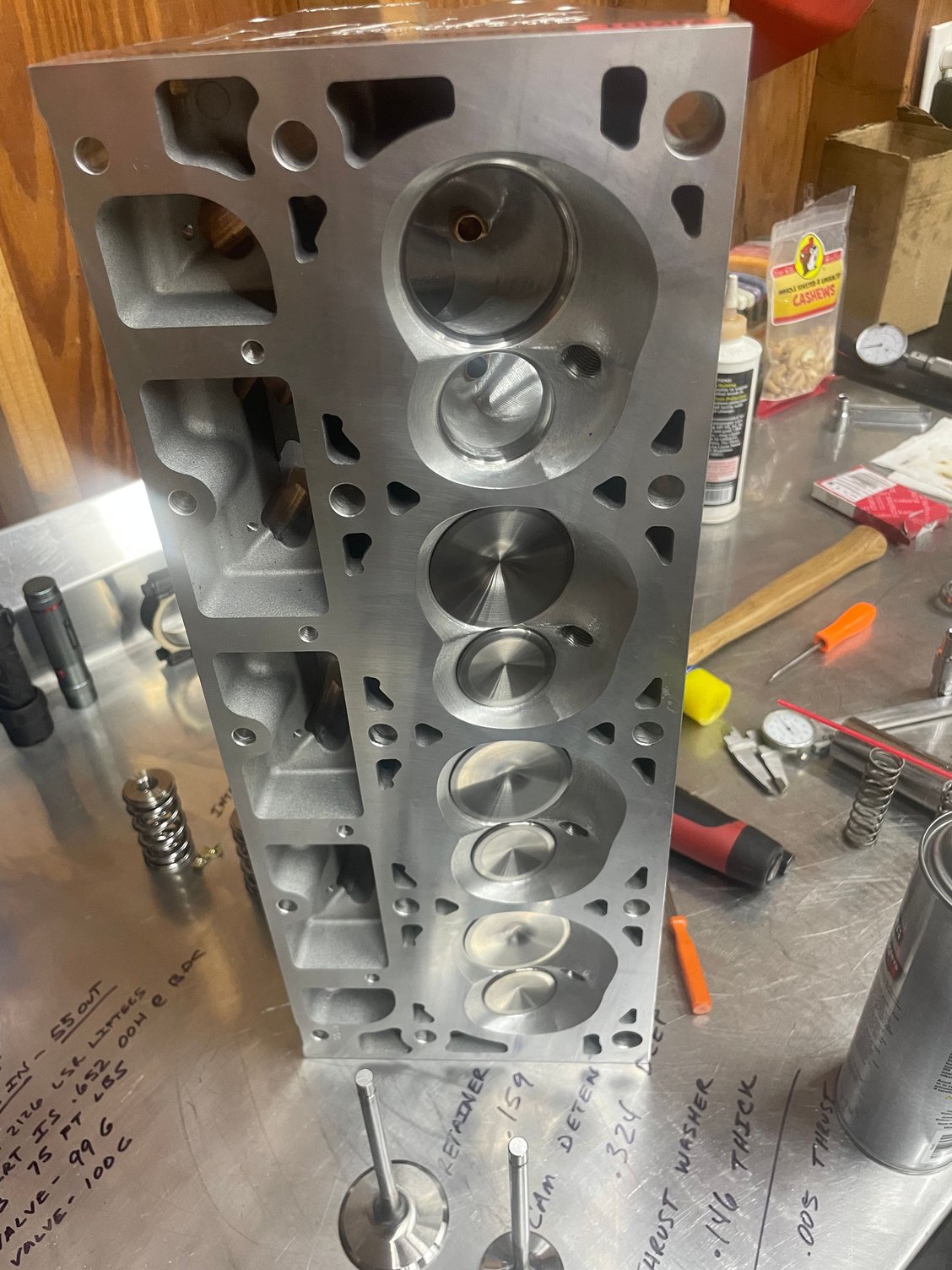

A good set of heads will make a combination work well together. A GREAT set of heads will take a combination to the next level. I’ve seen many people talk about Oem LS3 heads…which I am a fan of…being hard to beat by aftermarket LS3 offerings. That may be true for most aftermarket LS3 castings, but I must say that the MMS 26X LS3 head offered by Tony Mamo has exceeded my expectations by a lot…and that’s not easy to do. The head is a hybrid design that uses the LS3 port flange, but with a very fast moving port. It’s a 12 degree valve angle, a very efficient chamber design, and a beautiful exhaust port design. I’m sure Tony will jump in later and give you guys all the juicy details. I will say this to add here…the intake port flows 390ish cfm, which is almost as much air as my MMS 265 LS7 heads on my 434…with a smaller port. Air speed is very, very high, which makes this a super efficient head. 2.170 intake valve and a 1.600 exhaust valve is utilized. We stepped up to the NexTek springs which are polished, for ultimate valve control at RPM…

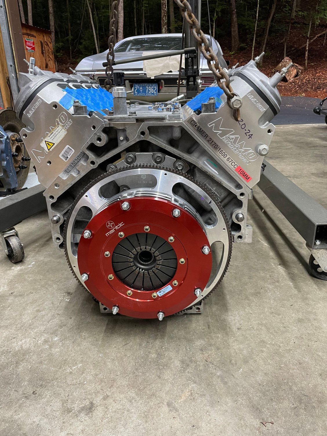

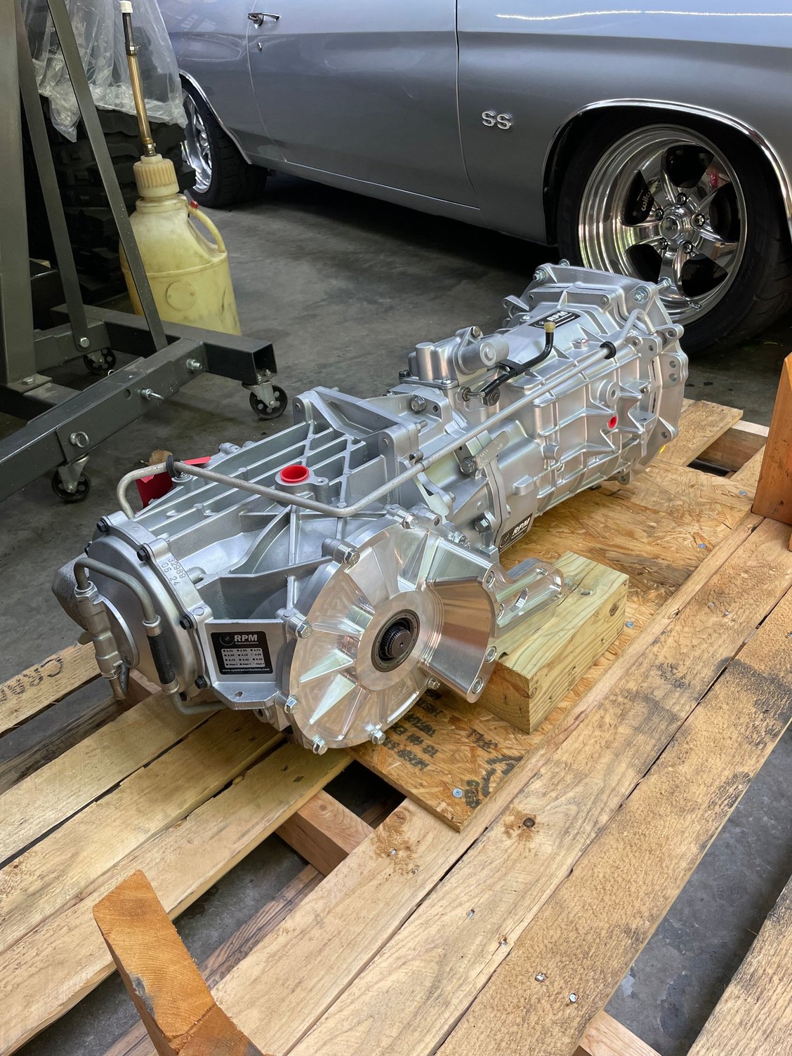

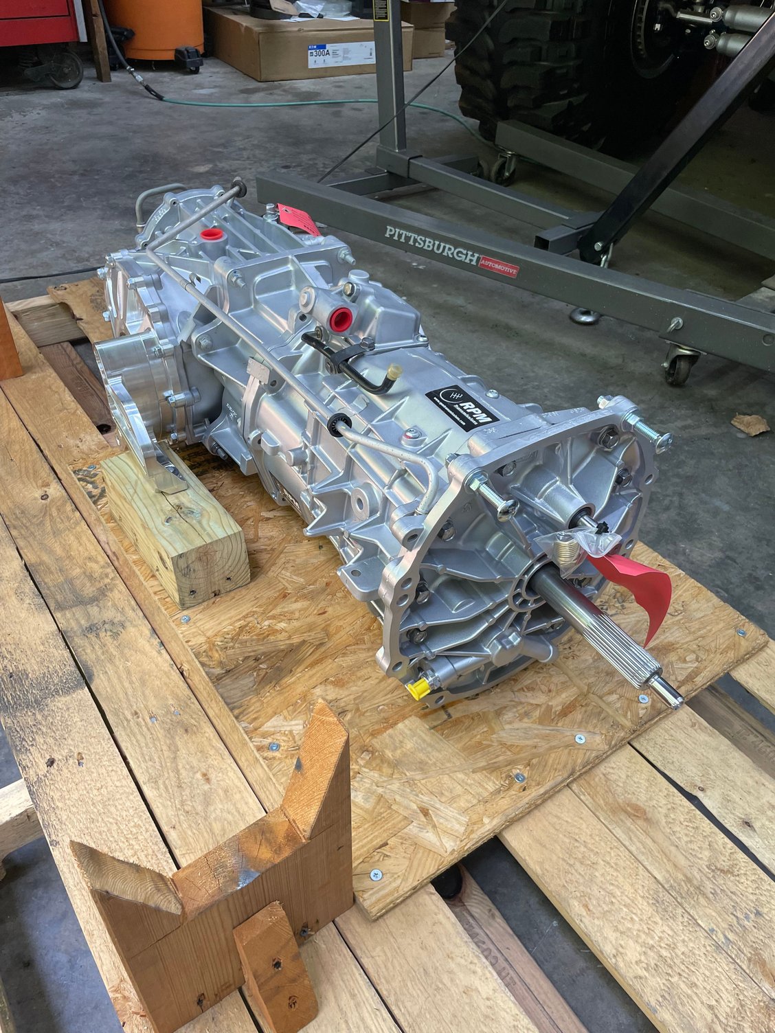

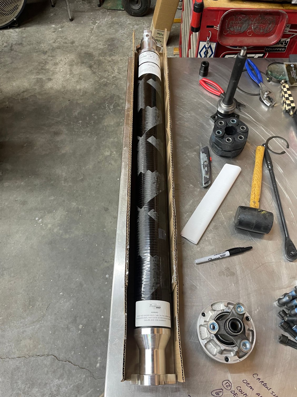

Drivetrain jewelry…the transmission and diff back from RPM, the carbon fiber prop shaft…I assembled the torque tube for RPM…and Tonys MMS Mantic lightweight twin disc ceramic clutch bolted to the engine…

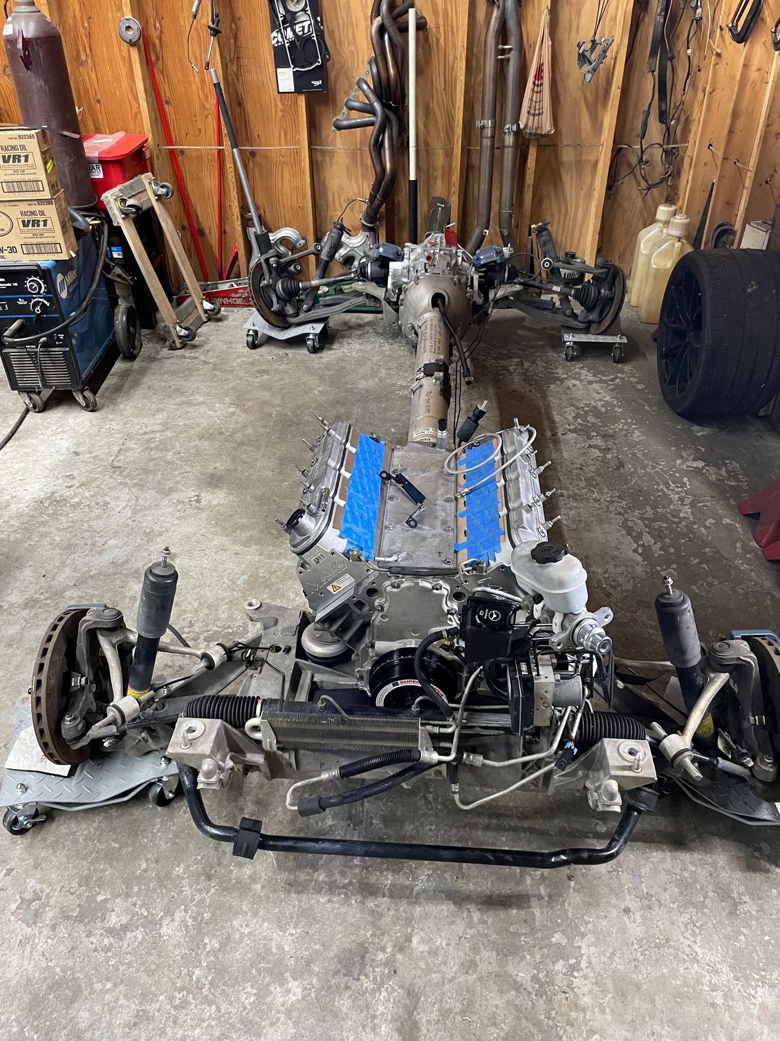

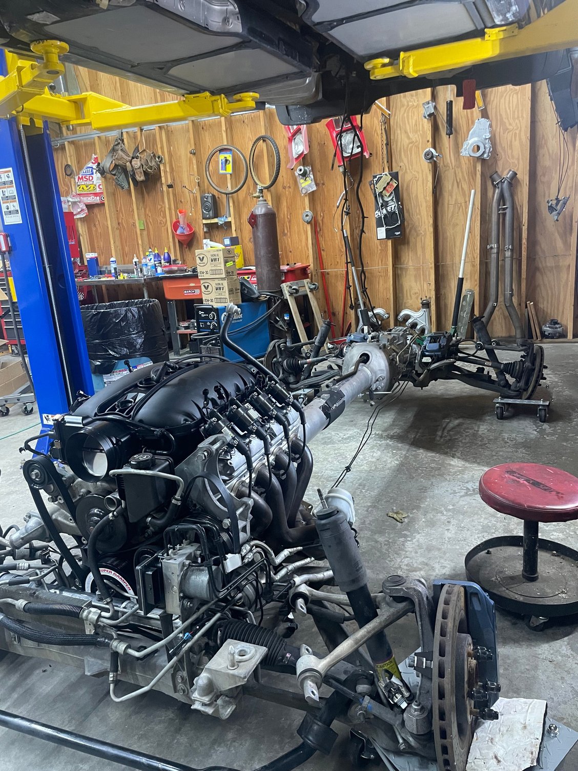

A couple shots of the drivetrain back together. Getting ready to drop the body back down and put this monstrosity back together…

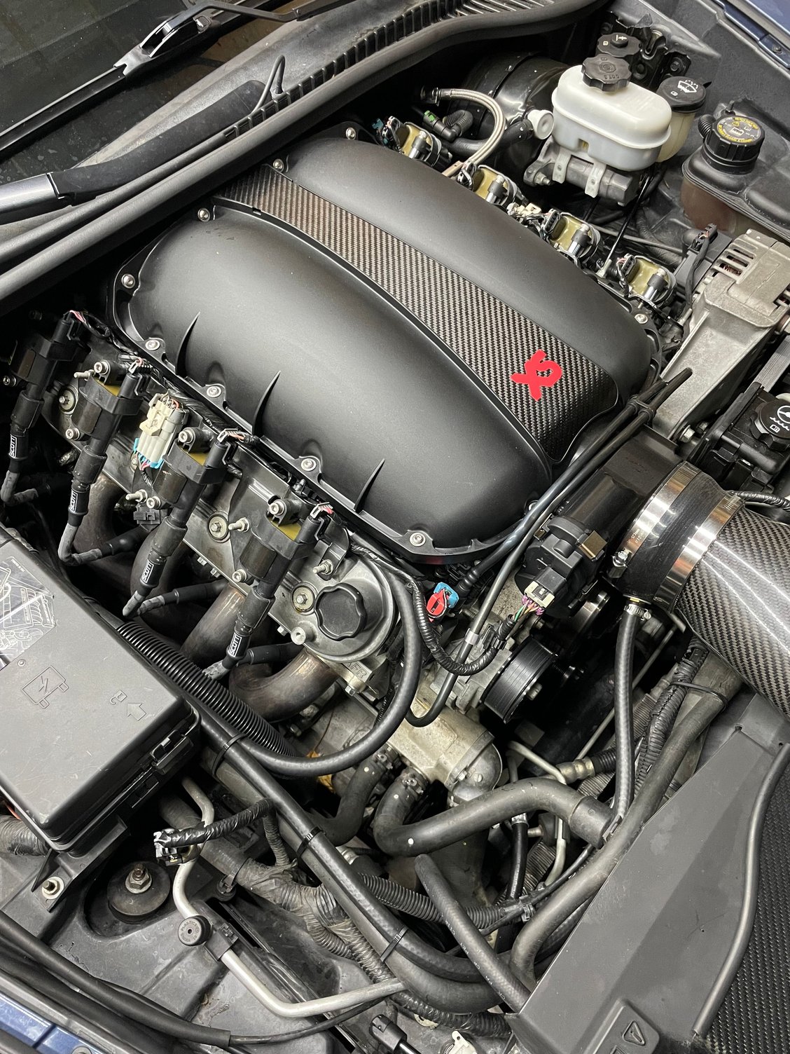

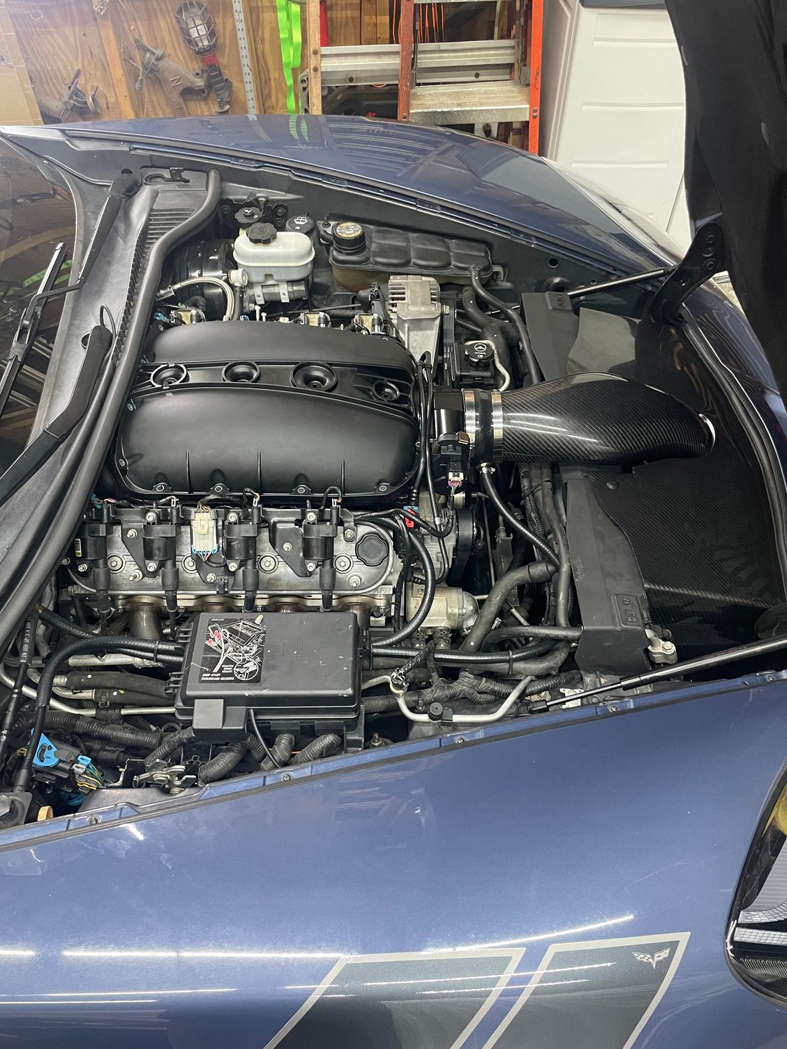

A couple pics of the engine bay with this Performance Design XS intake installed. It’s super clean looking and works very well…
