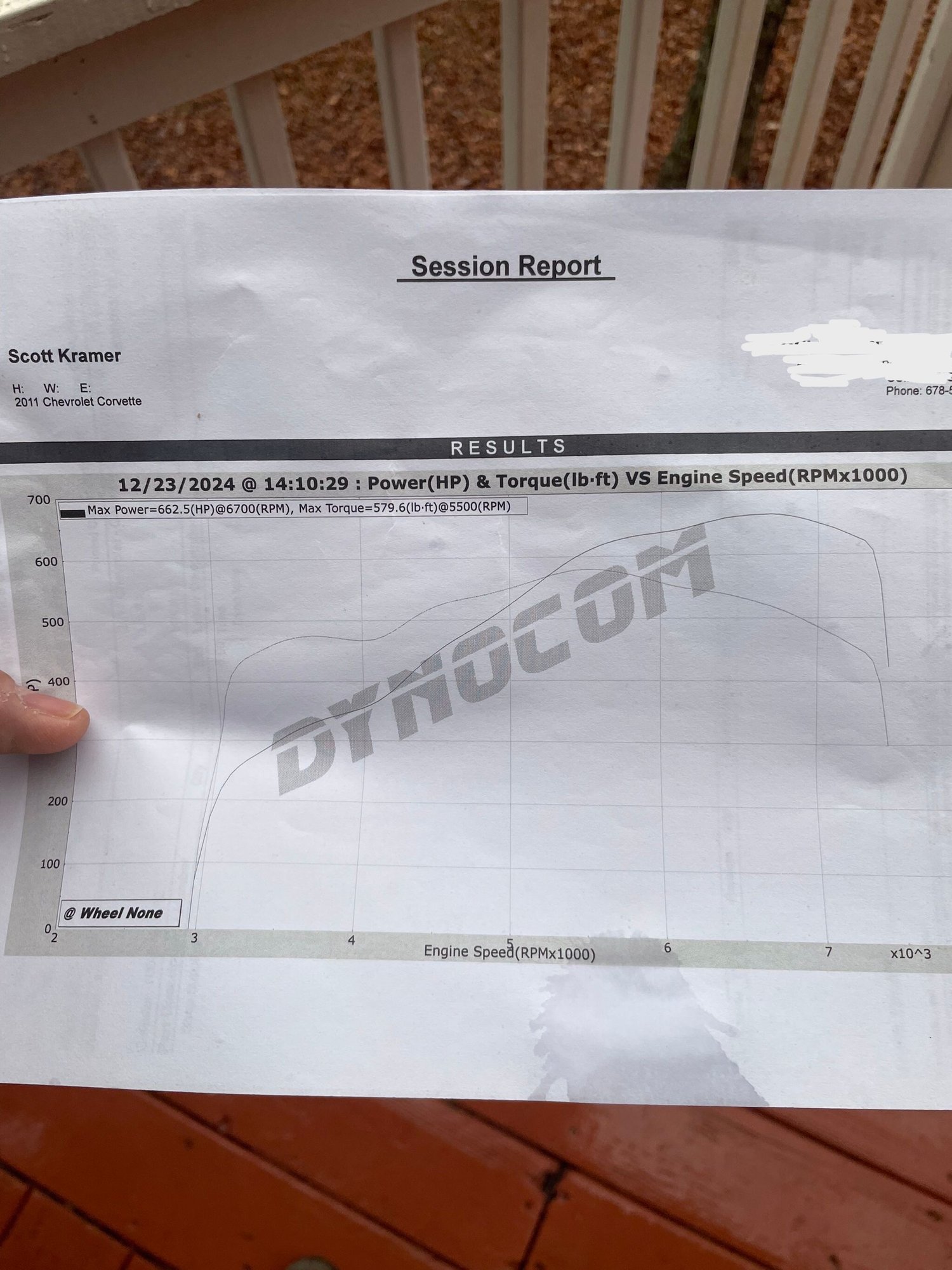

So I knew the car felt strong during preliminary remote tuning drives, so I thought that dyno day would bring a good number. A 3.90 gear does hurt dyno numbers, but makes these cars much more fun to drive. I was shooting for 600 wheel, which would have been epic for a 403, but I thought we had a chance. Nick the owner of the car was hoping for 575-580. I used a local dyno for both final WOT AFR tuning and numbers. The shop owner called me and told me that I just set a new NA record in his shop. He builds Vettes…lots of vettes for many years. He’s built over a dozen Z06 cars and he wants to know what I did to this car to out perform any 427 he ever touched. Car did 662/579 on his DynoCom. I’m friends with the guy, but I told him that there’s no way that this 403 did those numbers. So I found another local shop with a Dynojet to compare this to. At the end of the deal I pretty much hit what I thought it would do…593/525. I’m not interested in hub dyno inflated numbers or any other inflated dyno numbers…looking for legit numbers for real data. This won’t impress some folks and I’m ok with that.
This is on pump 93 gas and mild timing. With this cars 12:1 compression, on E85 this thing would easily hit 615-620. It’s a hoss. The real winner here is the torque however. 525 ft lbs is built 427 numbers. The PDXS intake is a long runner unit that helps push torque, and the combination is set up to compliment it.

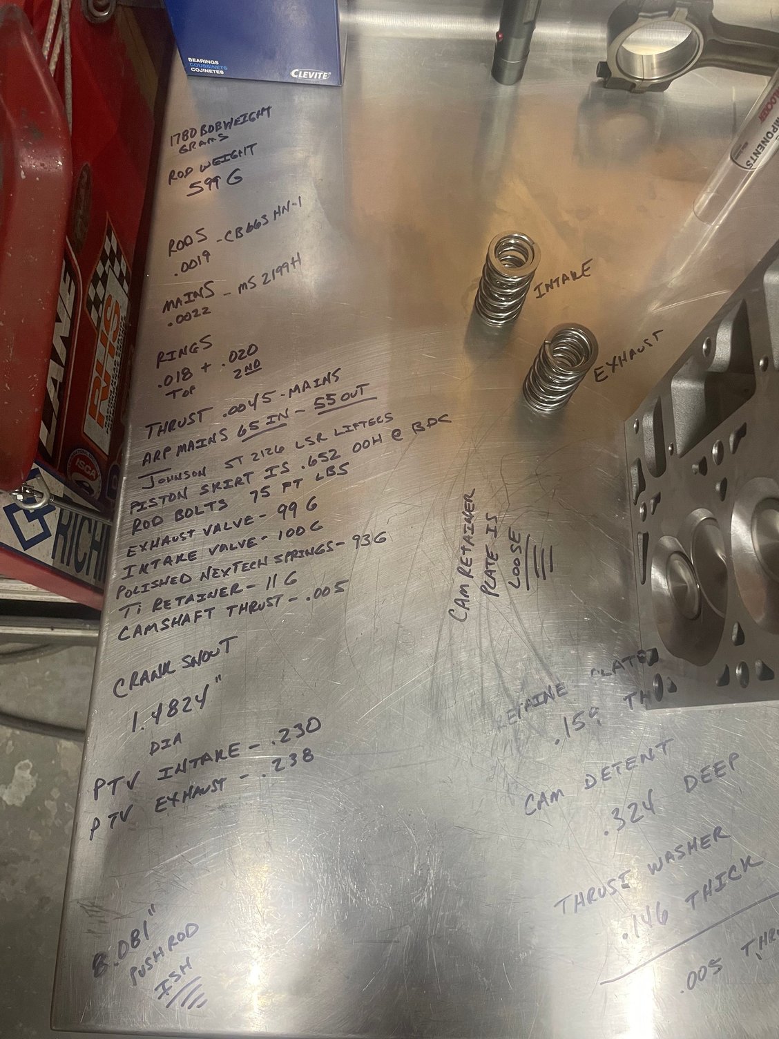

I write notes as I go on my assembly table with a sharpie. Cleans up with one swipe of a rag and some brake parts cleaner…or similar…when I’m done. I’ll spend a week with mock-up and measuring stuff, so this list takes a minute to establish. I snap photos of this as I go in case it magically gets erased along the way. Here’s a pic of this list pretty much complete in case you guys want to see dimensions, weights, etc…
That's funny, I do exactly the same thing.

PS......The difference in the dyno's was something else....this is why dyno numbers are almost useless to compare unless they are taken on the same dyno.
No different than flowbench numbers even when guy's aren't fudging the number to make them look better....LOL
Most testing equipment spits out different numbers.....that's why its always ideal to have a baseline run on the same dyno before you mod your car....that's the only true way to see what you really accomplished
While I would have liked to believe the original Dynocom hub dyno numbers it was pretty obvious by the torque output that to me they had to have been inflated but it doesnt take away the fact it was the highest NA car they had seen on that dyno and the owner of the shop was very impressed.
Hub dynos almost always read higher due to the fact that the engine isn't having to accelerate the weight and mass of the rear tires. That's a huge difference at the end of the day
What was cool was the shape of the two curves from two different locations was the same and that makes sense....that's exactly how it should have been

I like the "ish" under the pushrod length, lol
solid build.

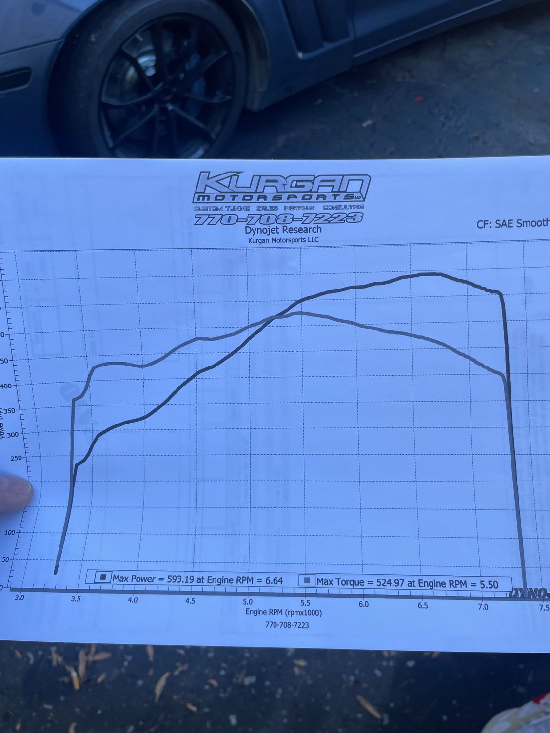

Thanks for posting Tony. I hadn’t included the original dyno sheet, so I’ll throw it up for comparison sake…

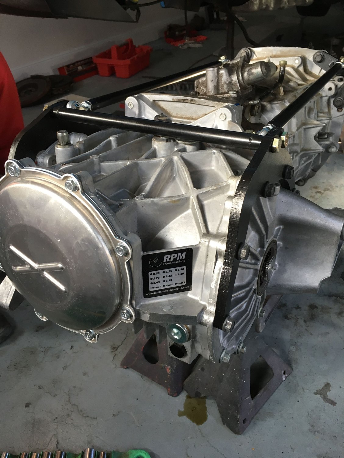

One hell of a well thought out build! Nick is going to be miles of smiles. I would guess in drag set up it will go low low 10s pretty slick and likely high 9s. The 3.90 gears and mantic clutch are 100% perfect for the combo imo. Great job to all involved and nothing better than having someone like Scott giving the personal attention to your build and assembly. Can’t wait to see it in person!
only thing I don’t see is a trans/diff brace. I highly suggest it in the near future

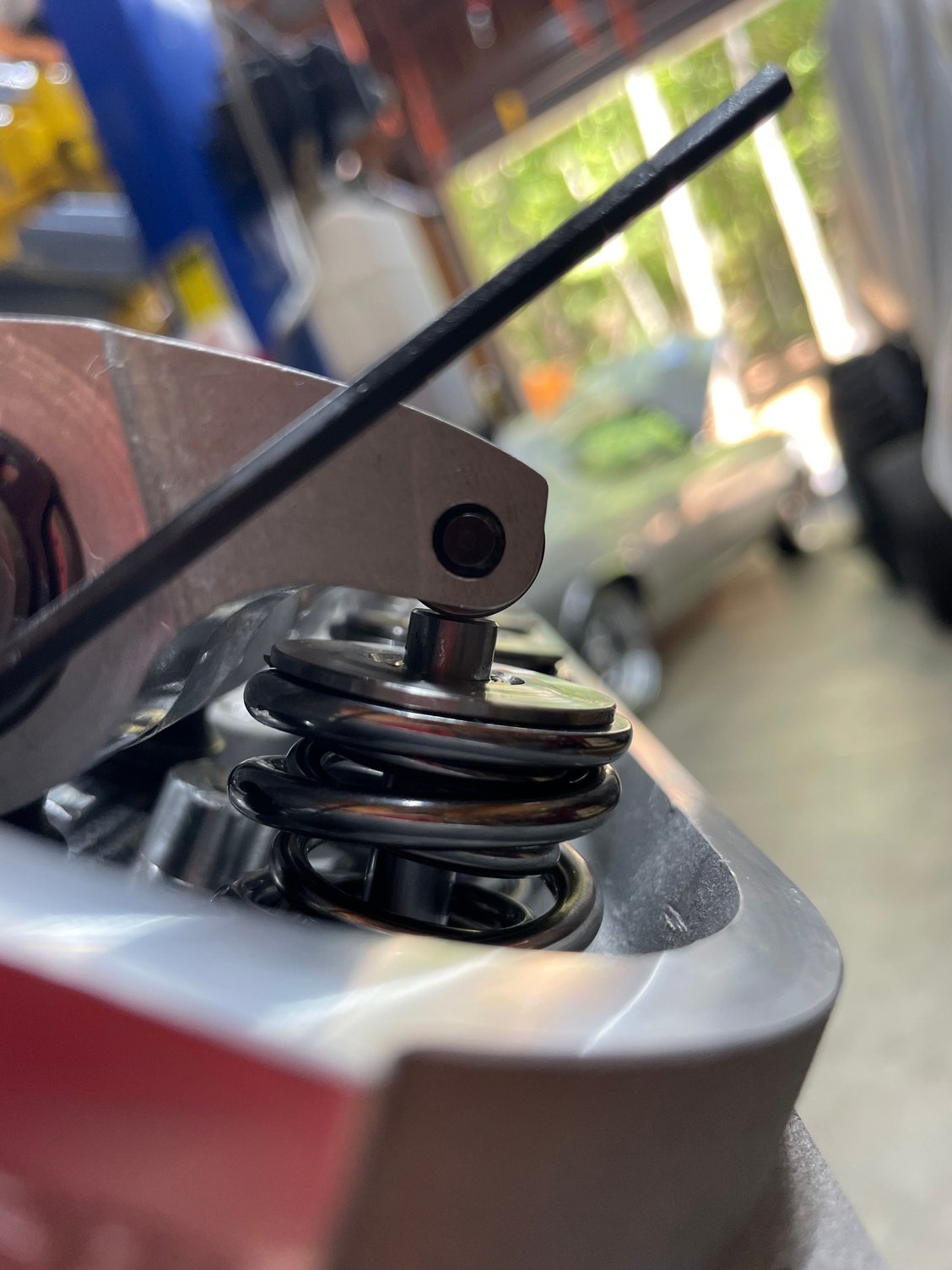

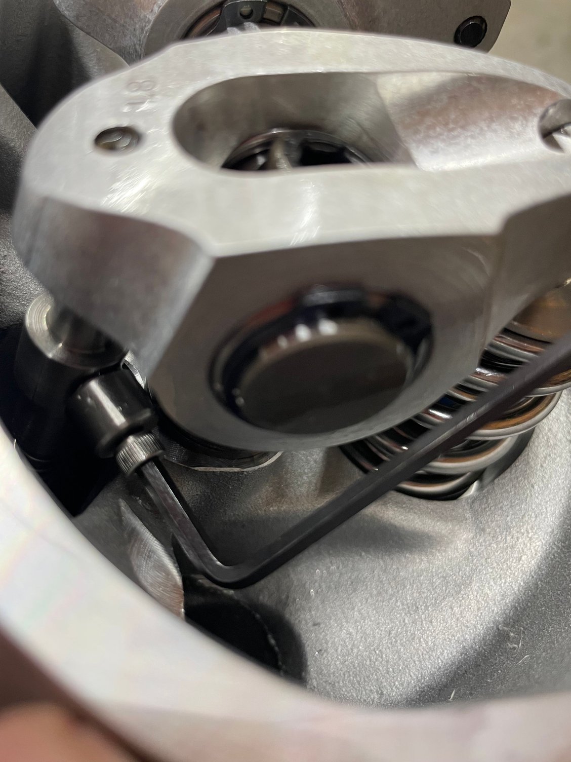

Here’s a couple pics of me measuring pushrod pushrod length with my MS Racing Components tool. Buy one and you’ll throw your adjustable pushrod measuring tool in the trash can…it’s soooo easy to use and 100% accurate. I’m also checking wipe pattern here in second pic…
I just got one of these after a discussion with Scott. He's right. This tool is so simple you'll wonder why you didn't think of it first. It is also dead nuts accurate. It makes using the old style checkers and counting bolt turns look like stone age methods. Thanks for the tip, Scott.....

Thanks Philly-cheese! It may run like that with you or Dougie-fresh at the wheel, probably not my tank *** 🤣.
I think that brace would be a great plan, as she's a chonk. All that weight/power/gear will probably spell disaster.
