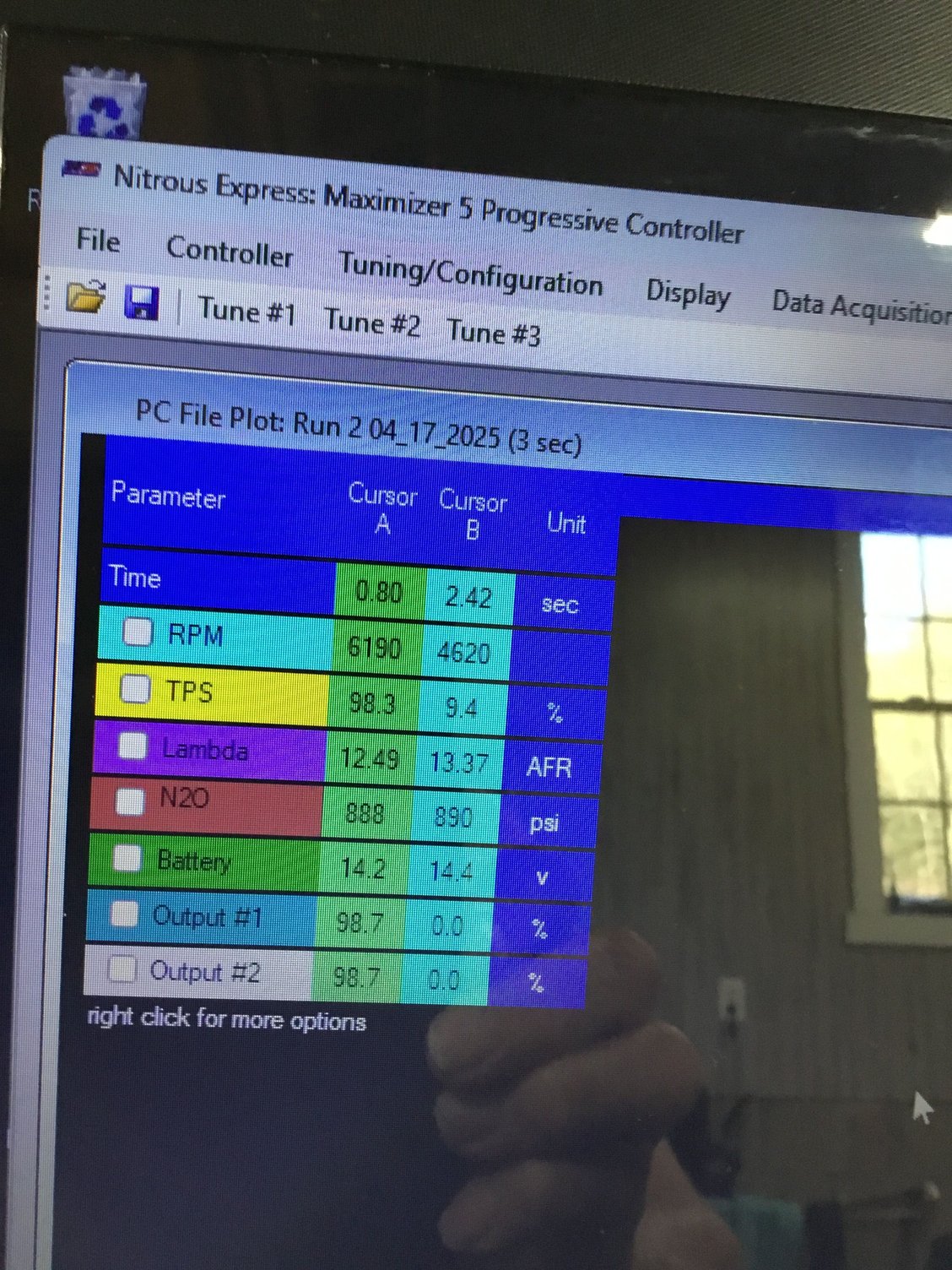

+1 for for the stupid shi? I’ve done in my life,I’m with
grubinski every time I get in my car it’s trying to kill me
i was out yesterday on my favorite piece of road (no traffic) doing short nitrous pulls
Scott great job on the build
