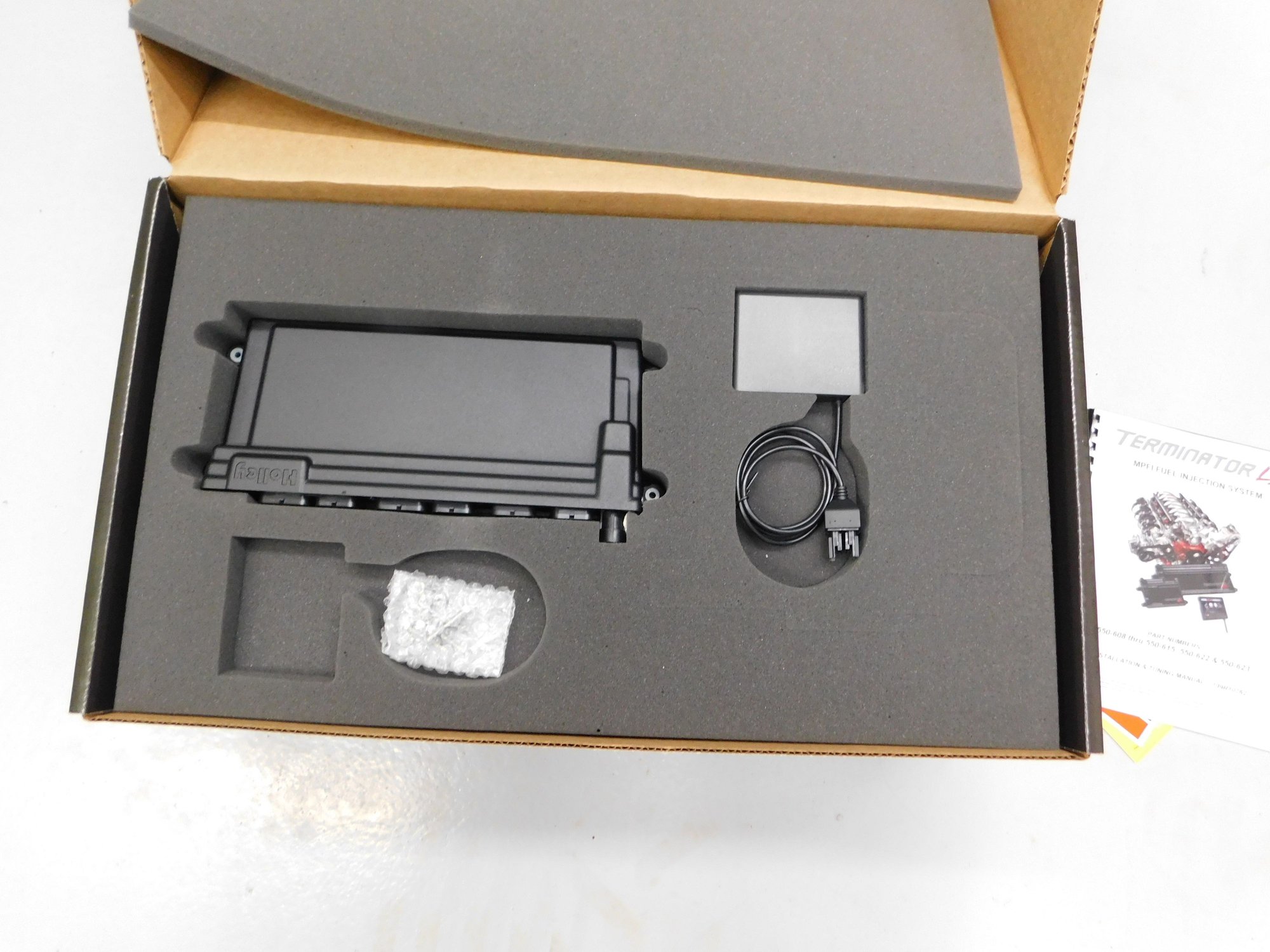

Earls Ultra Pro trans cooler
Will be using Holley's Terminator EFI system
