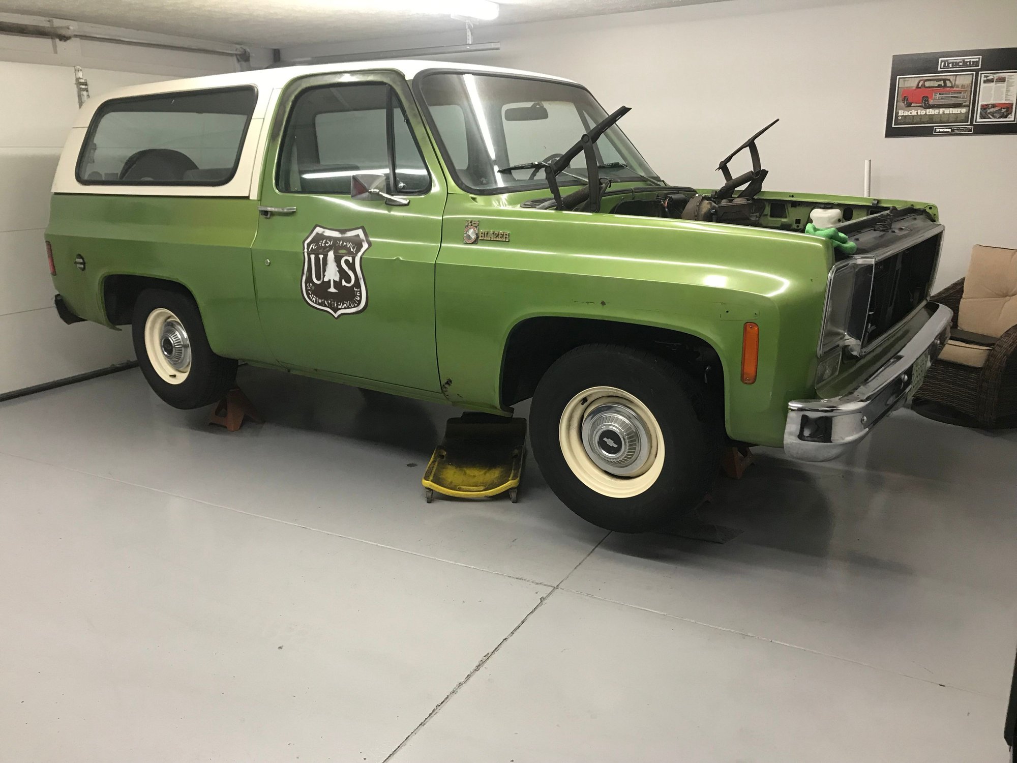

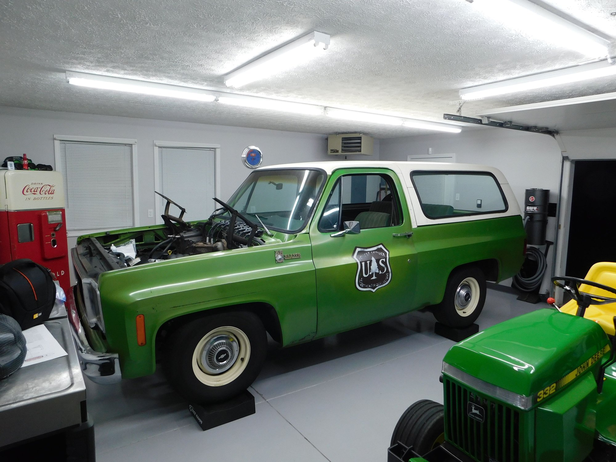

Thought I would share some info on my latest build, 1976 K5 Blazer with an LS3/4L75E swap. I will post up pics on a daily basis and feel free to ask questions or leave suggestions.

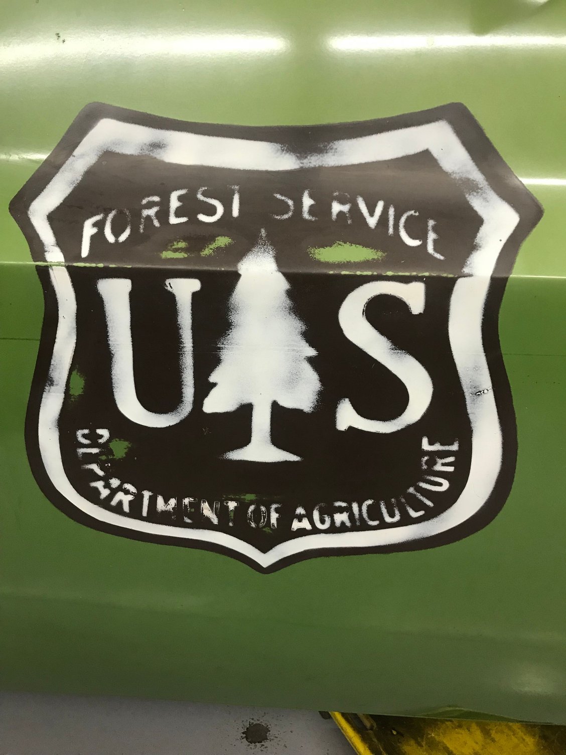

neat looking blazer. is that an old park preserve truck? i cant make out the door sticker.
not 100% for sure but its pretty cool anyways.
Old Jan 25, 2019 | 01:46 PM
ls1nova71's Avatar
Joined: Jan 2008
Posts: 4,406
Likes: 211
From: Liberty, MO
That's bad ***! Hope you dont plan to paint it! I had a Department of Agriculture 59 Chevy wagon, but the lettering had been removed, so you could barely read it on the doors.

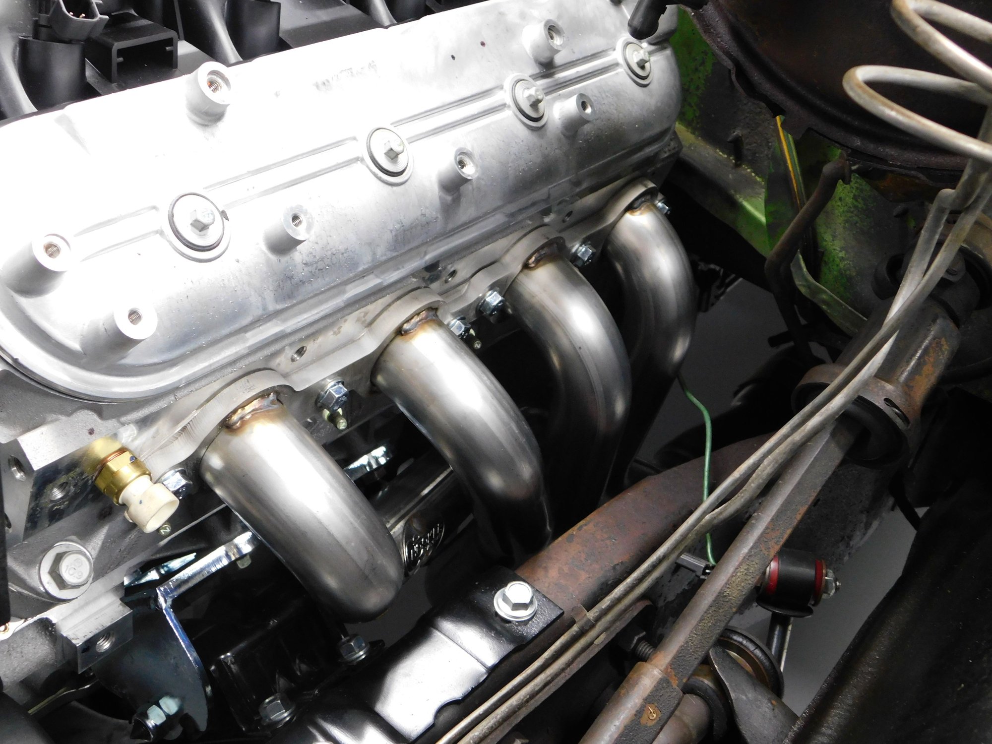

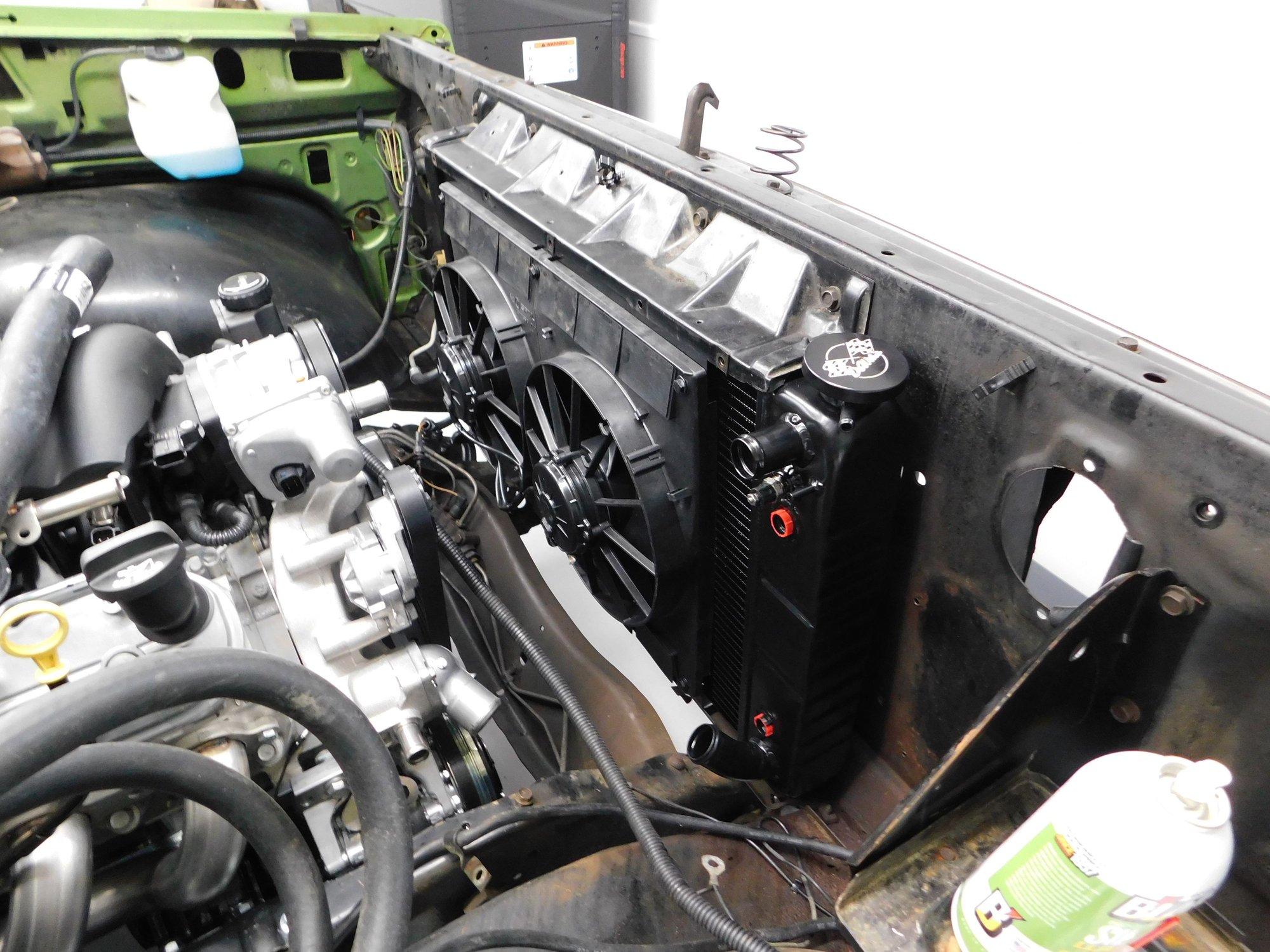

Dewitts LS swap Radiator
Hooker C10 LS Swap headers

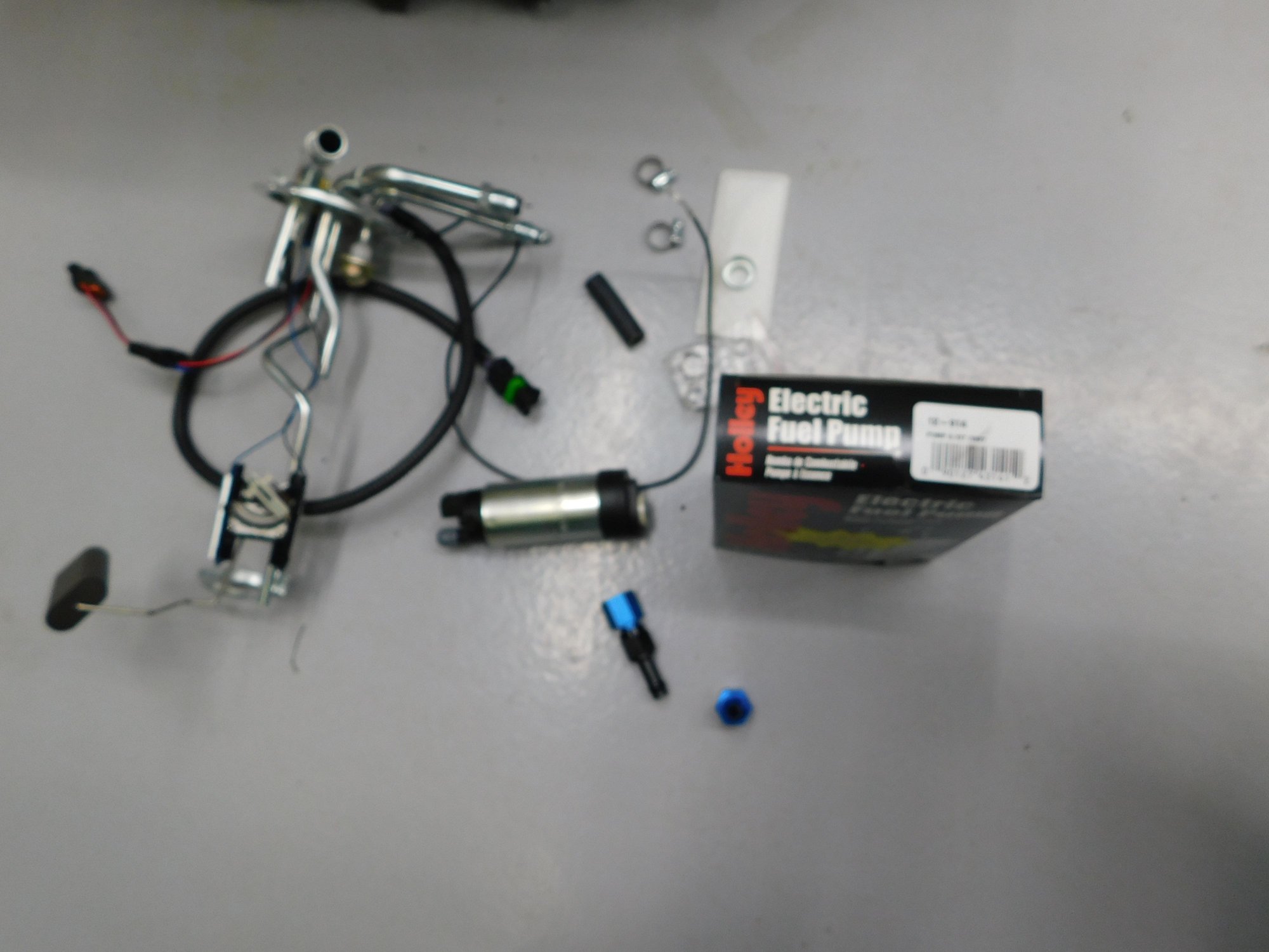

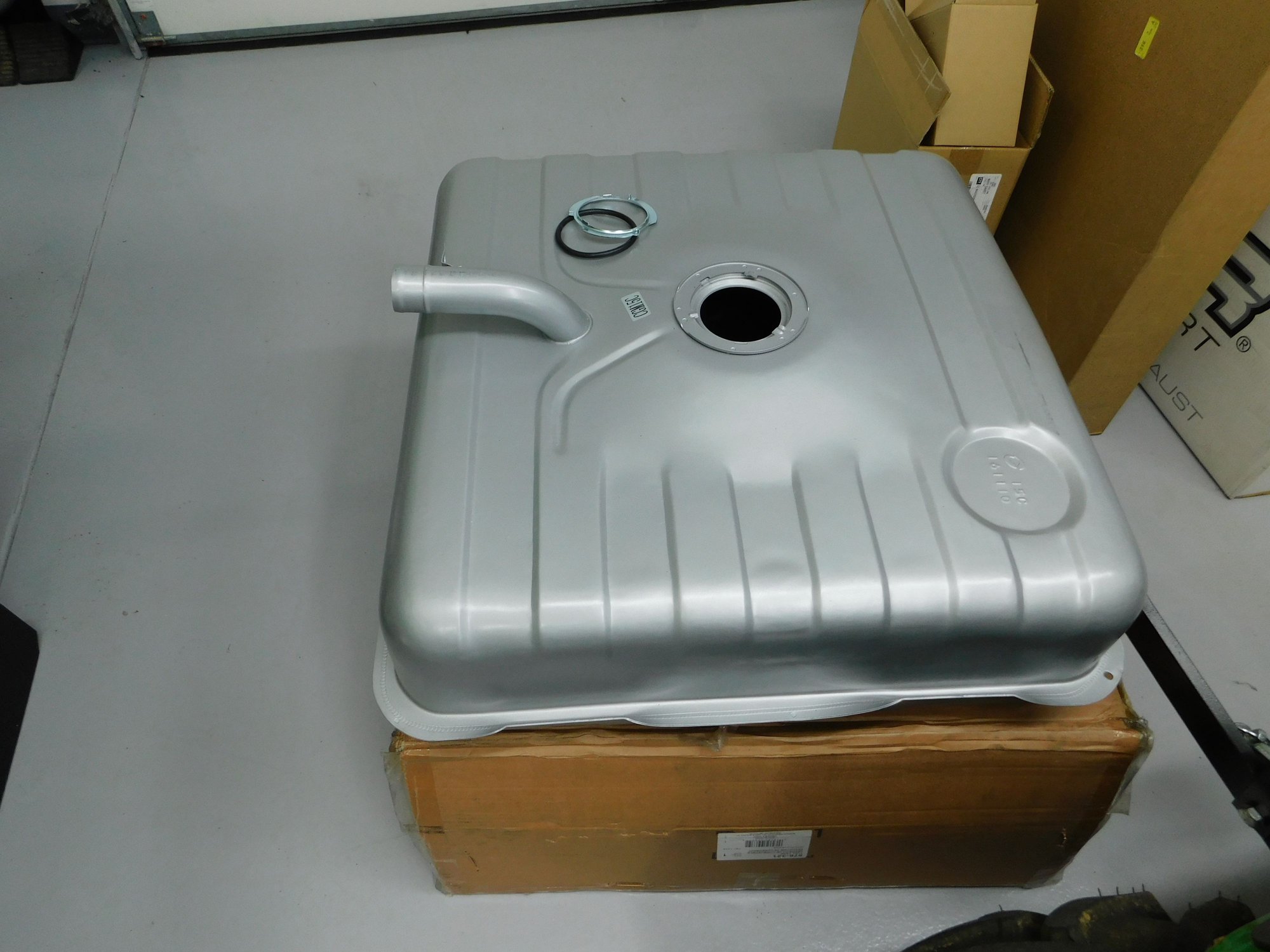

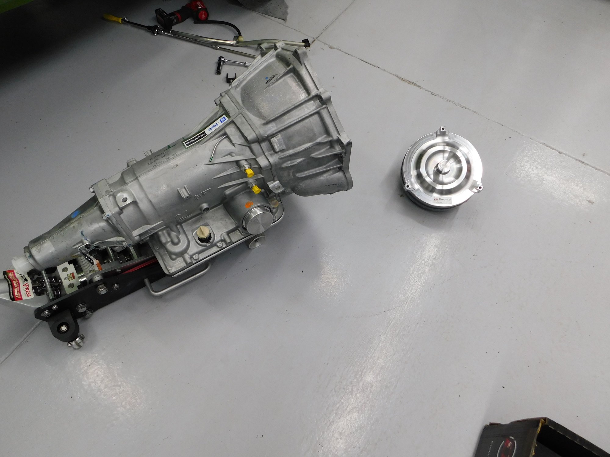

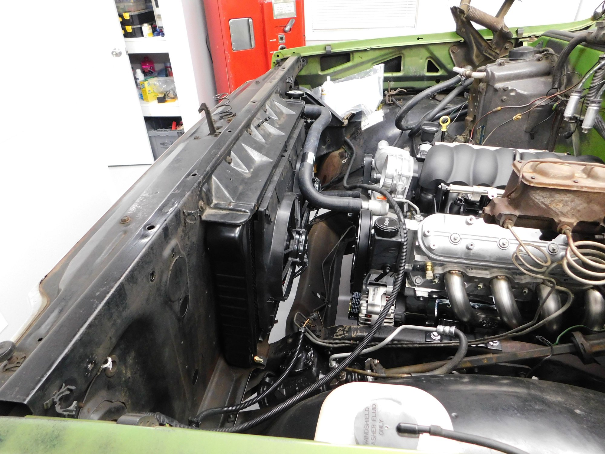

Chervolet Performance 4L75E and 265MM 2800 RPM Circle D converter

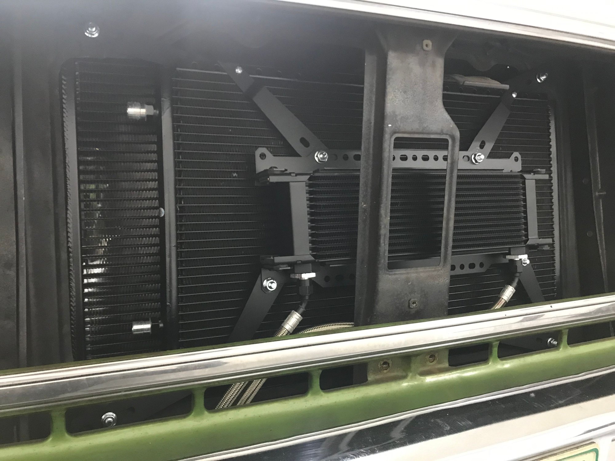

Vintage Air condenser and Earl's Ultra-Pro trans cooler

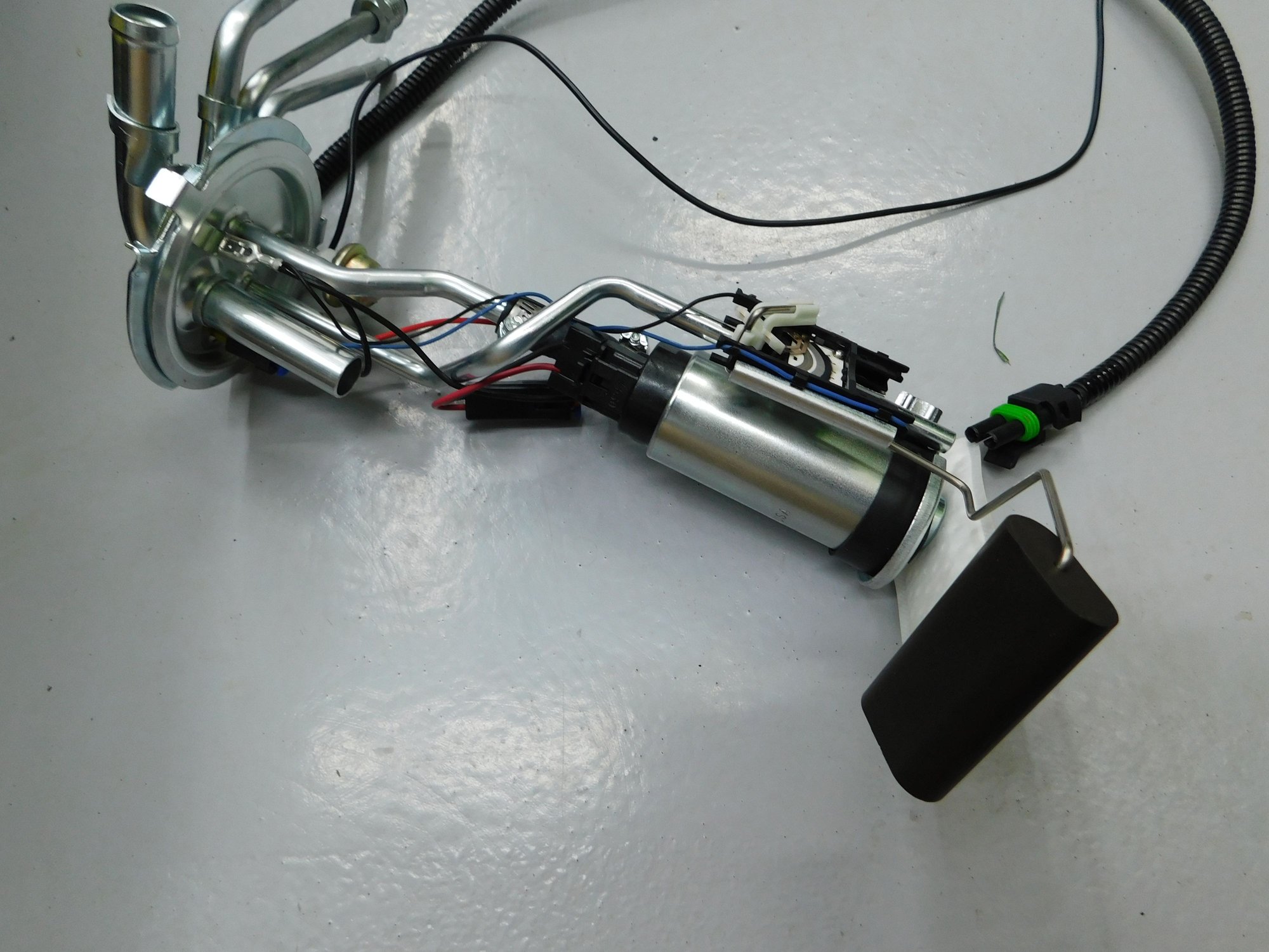

New tank for the fuel system
Blazer EFI sending unit and a Holley 12-914 255lph pump

84C10,
Is that trans their new supermatic version of 4L60E style ? Let it be known, it is recommended (B&M) that trans coolers have the lines mounted on the top to allow any trapped air to be bleed out. FWIW
Old Jan 28, 2019 | 09:33 AM
84c10's Avatar
Joined: Sep 2013
Posts: 192
Likes: 9
From: Rockfield Ky
84C10,
yes it is a heavily updated 4L60E rated at 650ft/lb. Thanks for the input, I'm not sure I can agree with them, I will stick with what has always worked.

Cool truck. That sign on the doors look like they were done recently and then rubbed to make them appear old. They're cool anyway, but pretty sure they arent original.
Yeah, I just thought I'd pass it on. If you ever had a issue, then that MIGHT be it. LOL. Now get wrenching !!
no one asked me, but i'll just say it now. sell that fancy pants gussied up 60e to some other poor soul and slap an 80e in there and be done with it for all time

If you research the 4l75E you'll be surprised what people are doing with them. Being rated at 650 ft/lb it will be fine behind a 480HP LS3. The gearing in the 4L60 is much nicer than the 4L80. I think the original 4L60 was only rated at 360 ft/lb
