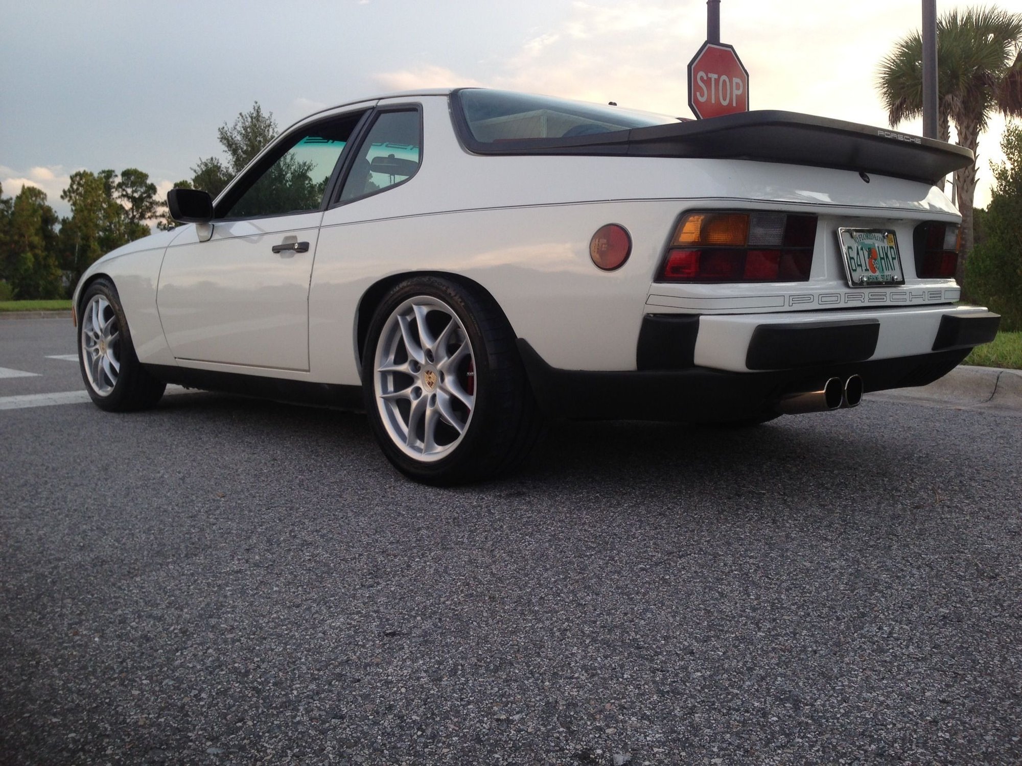

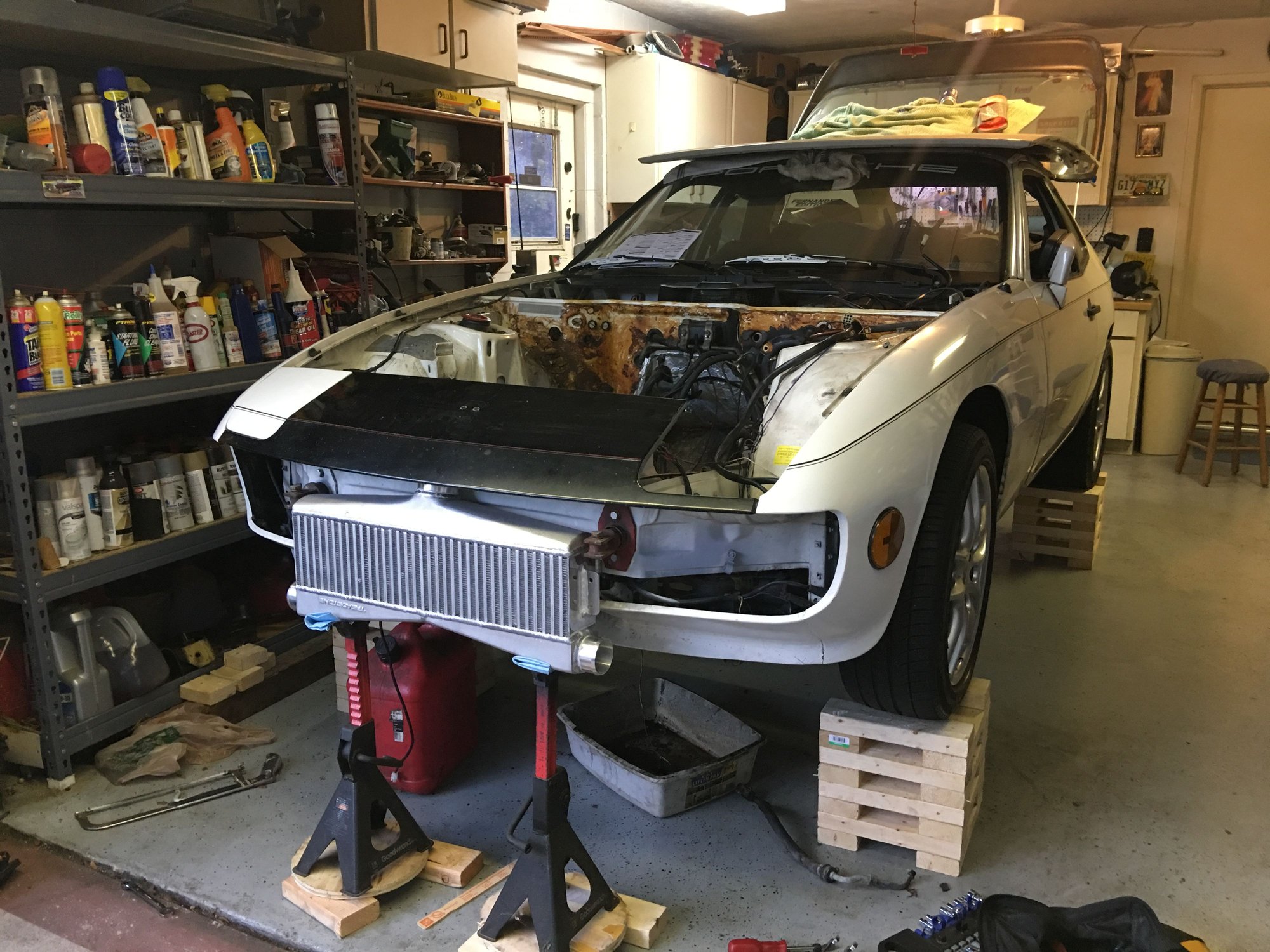

This is the car before the build!

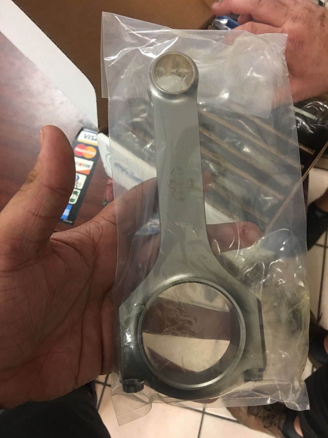

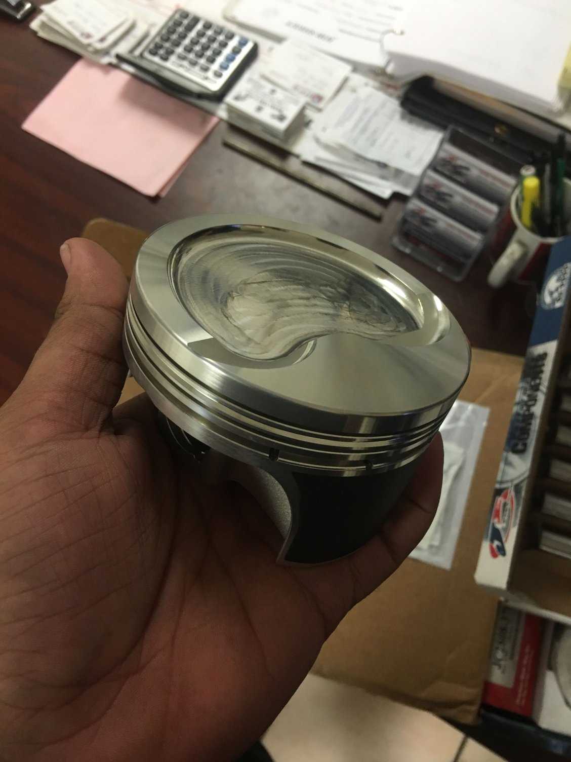

Forged rods and pistons, all ARP hardware top to bottom!

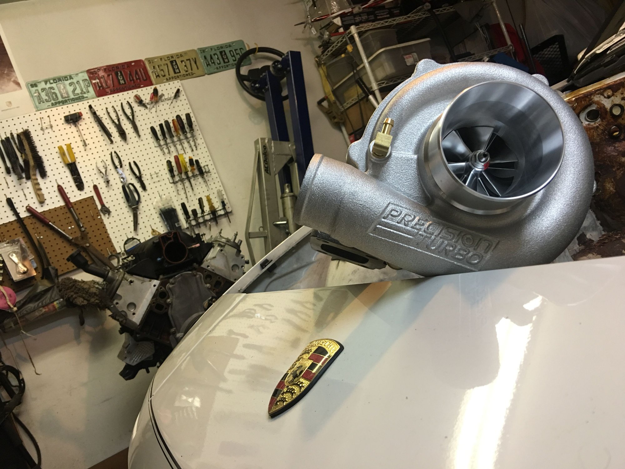

Posts: 78

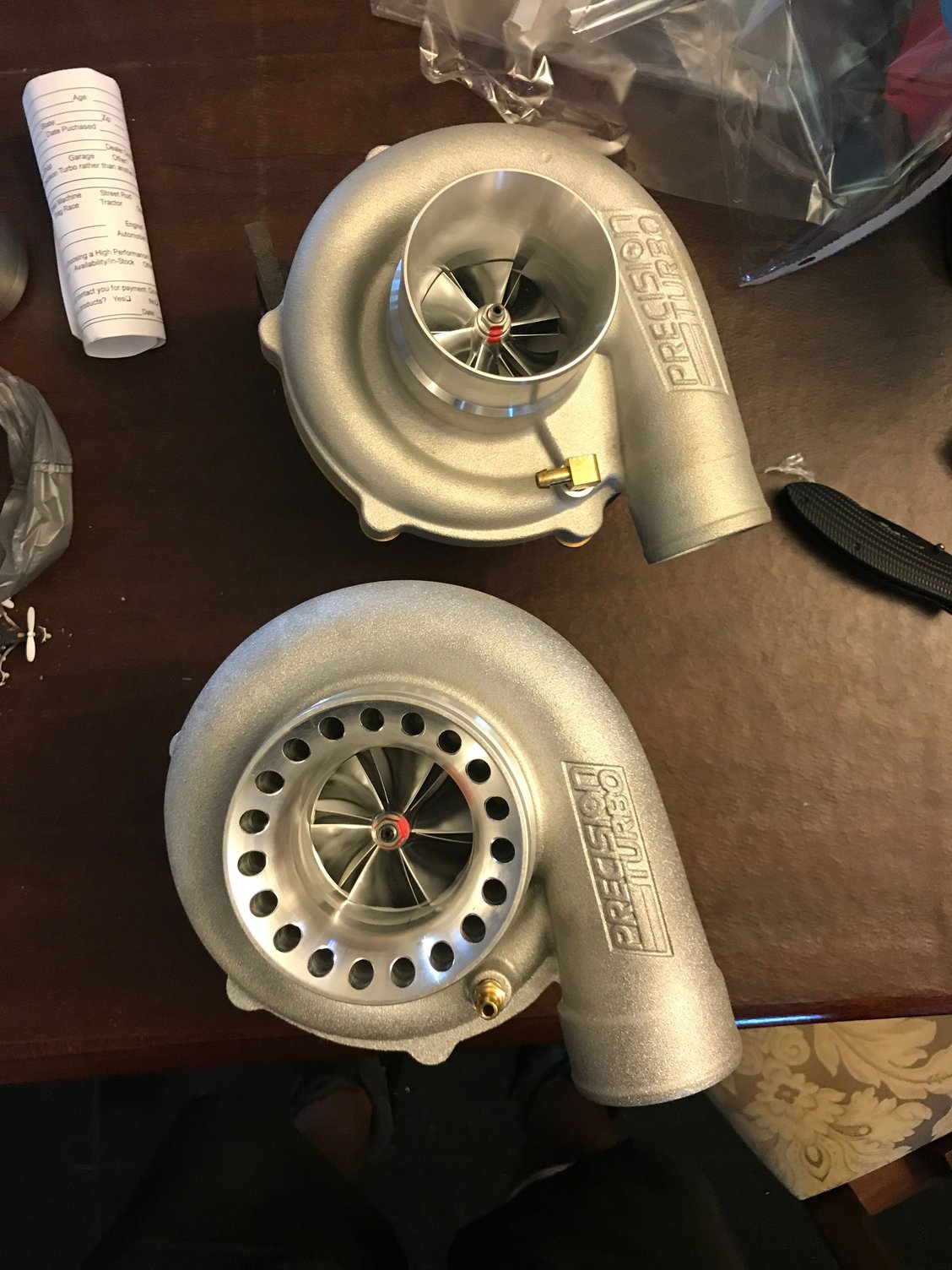

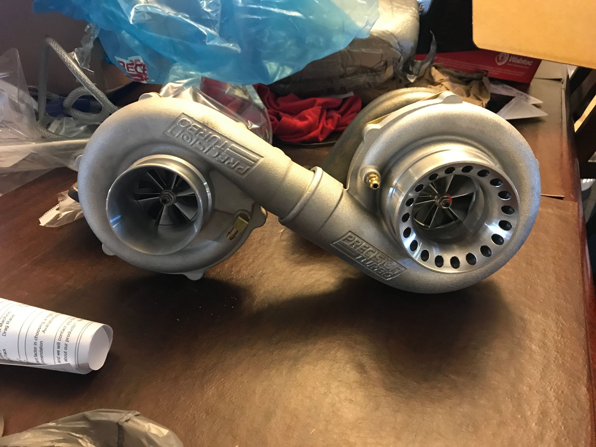

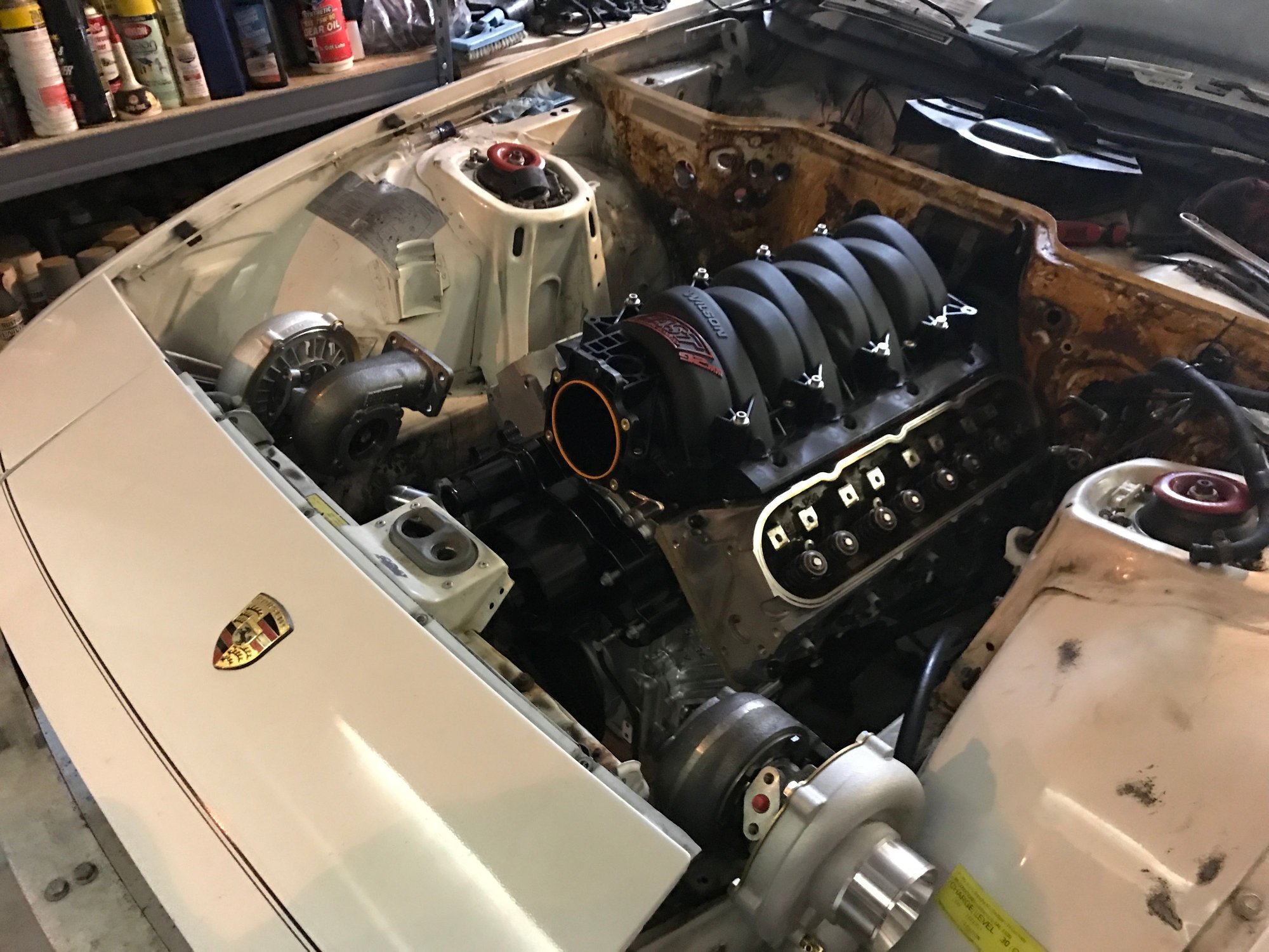

Already upgraded turbo size haha, from twin 5831’s to twin 6266’s

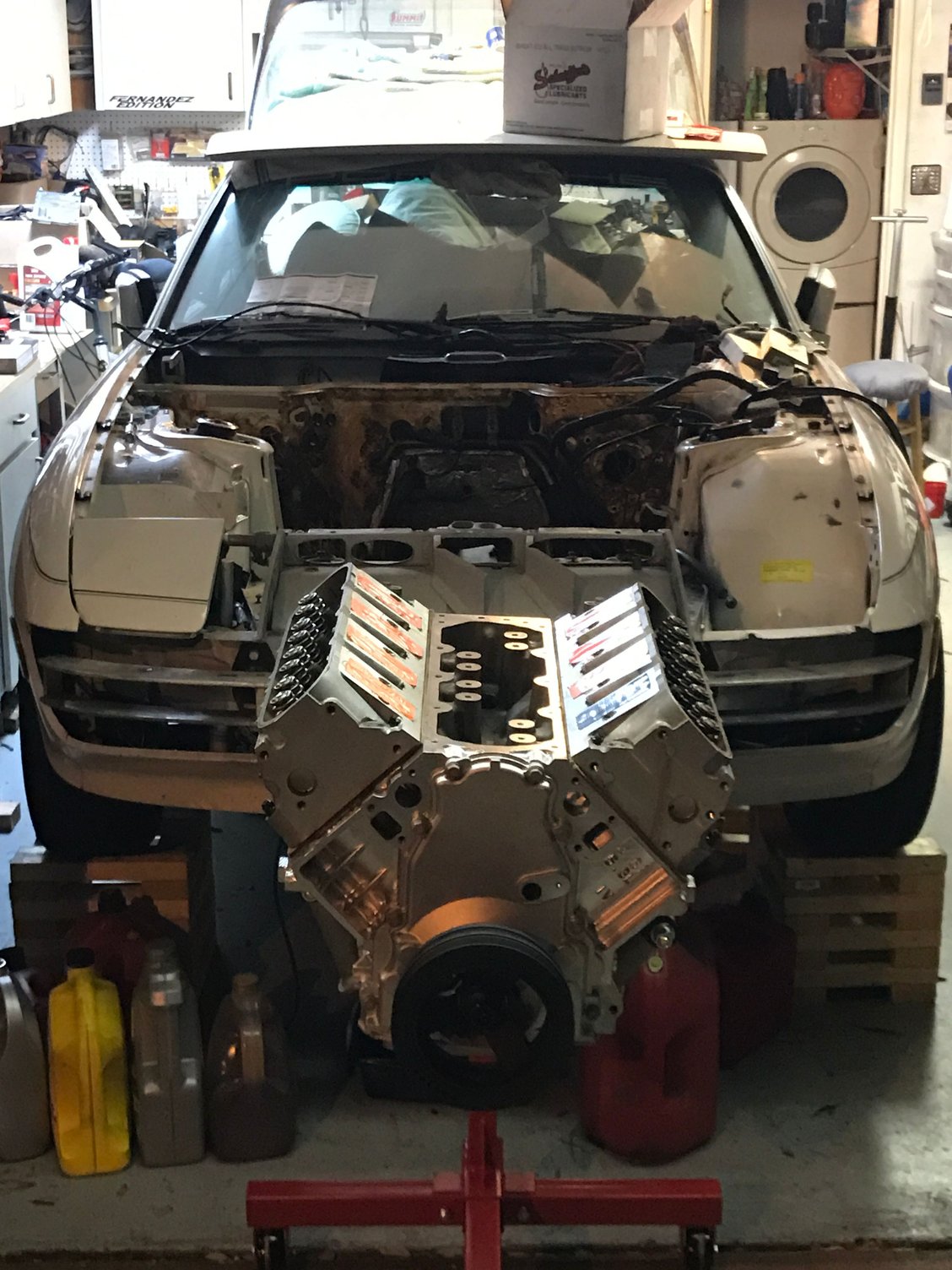

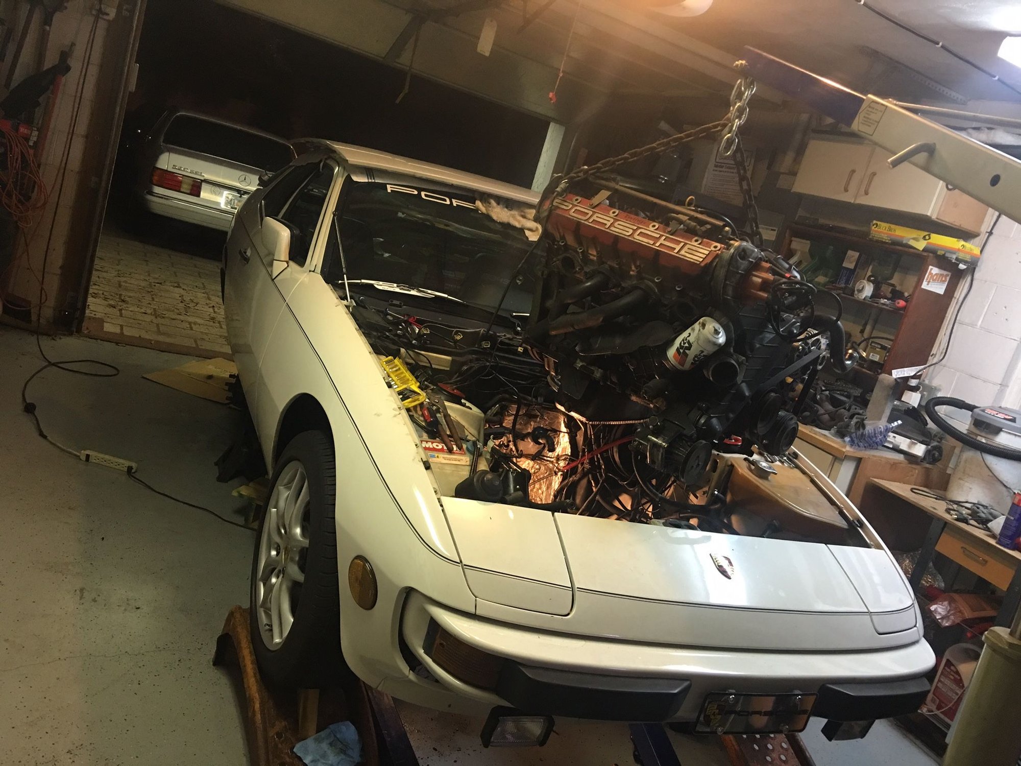

This is where the juicy stuff starts! Starting to chop up ol Pablo! Everything is explained in the videos!

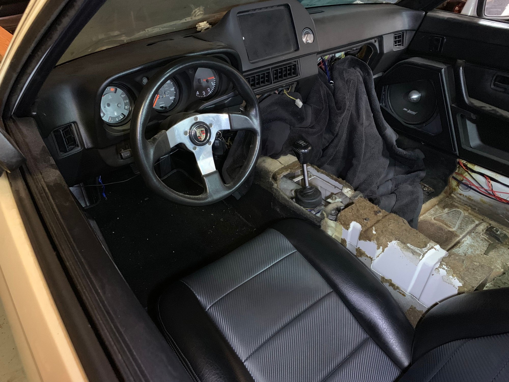

Chopping up Part 2! All is explained in the video

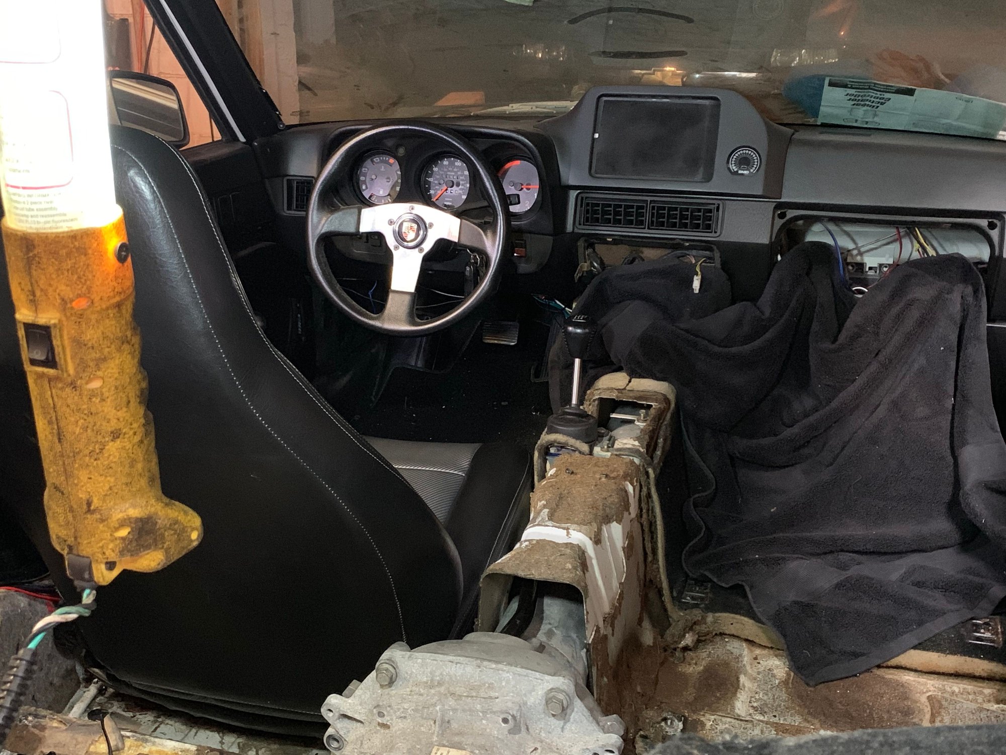

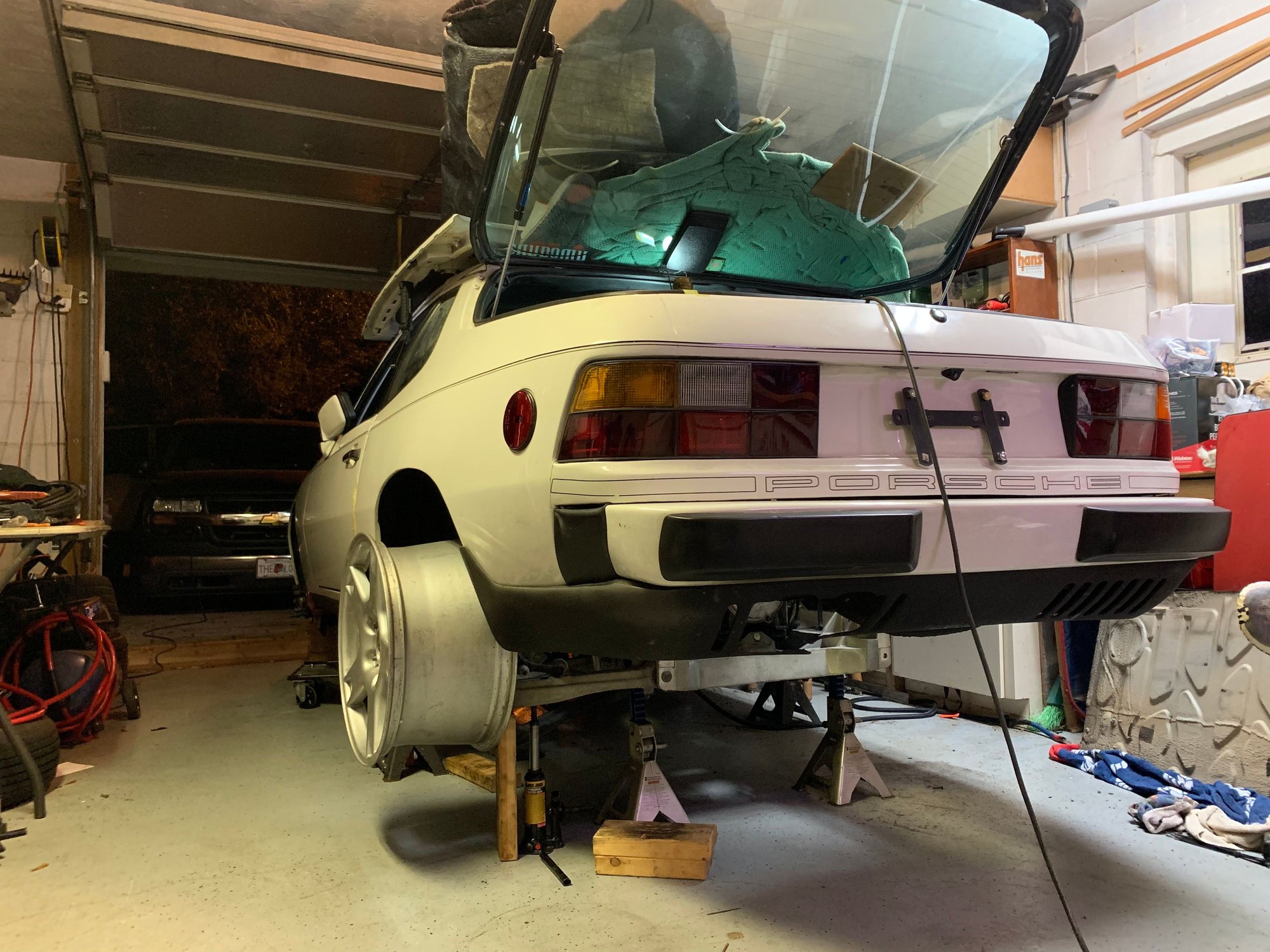

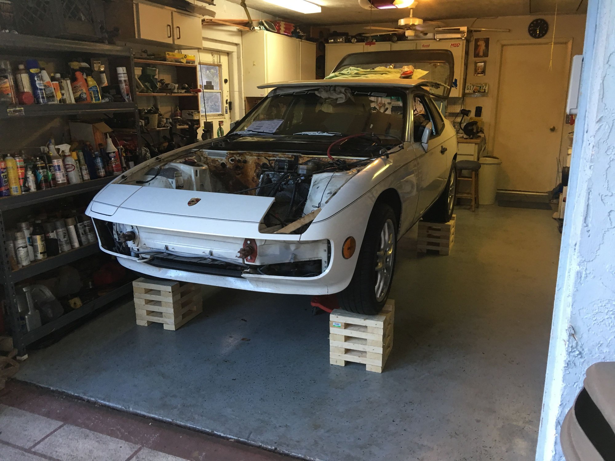

Here’s another update from this weekend I just got done editing!

Old Feb 12, 2019 | 03:28 PM

I think those wheels are a tad wide.
What are your plans?

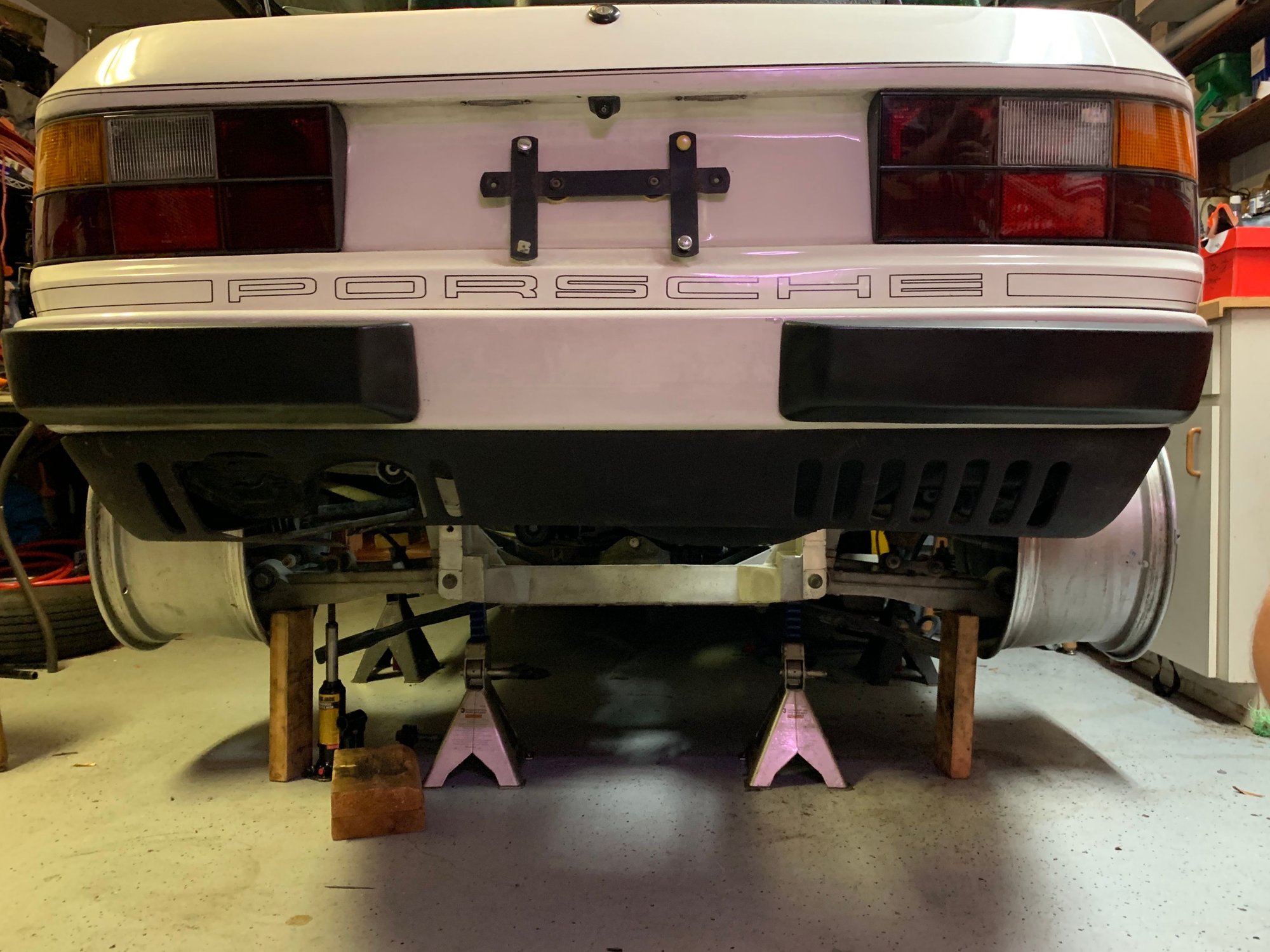

At the present location of the torque tube, are the axle centerlines about where the Porsche ones were, or higher?
yeah, they are only 9.5” wide. Planning on going bigger, the offset might help, but I am going to have to do fender flares or wide body.
I believe they are yes, maybe an inch or two lower than Porsche.
An inch or so isn't too bad. Adjusting suspension height will take care of that.
yeah I hope so, did u watch the video where I talk about it and show where the ride height looks like it will sit at?
Yeah, hard to tell with it up in the air and no tires on the wheels. I saw how you don't have much room to move the tube up. Hopefully with height adjustments it will be OK.
yeah it really is tough, or I can chop up the tube from the shifter back

Are you going to mod the body to cover wheels/tires, or mod the suspension/track to try and fit the body? I guess the 944 body would give you a bit more to work with in that regard. Cool project.
I've had a similar project in the back of my mind. My 242 is LS3 powered. Turns out the C5 Corvette wheel base is 104.5"; the Volvo wheelbase is 104.3". So putting a Volvo "hat" on a C5 rolling chassis came to mind. Engine set back would require firewall to moved back about 6" to clear the motor, but as long as you have to cut unibody to make things fit, what the heck. Similar track width issues as the Volvo is much narrower than the Vette.
