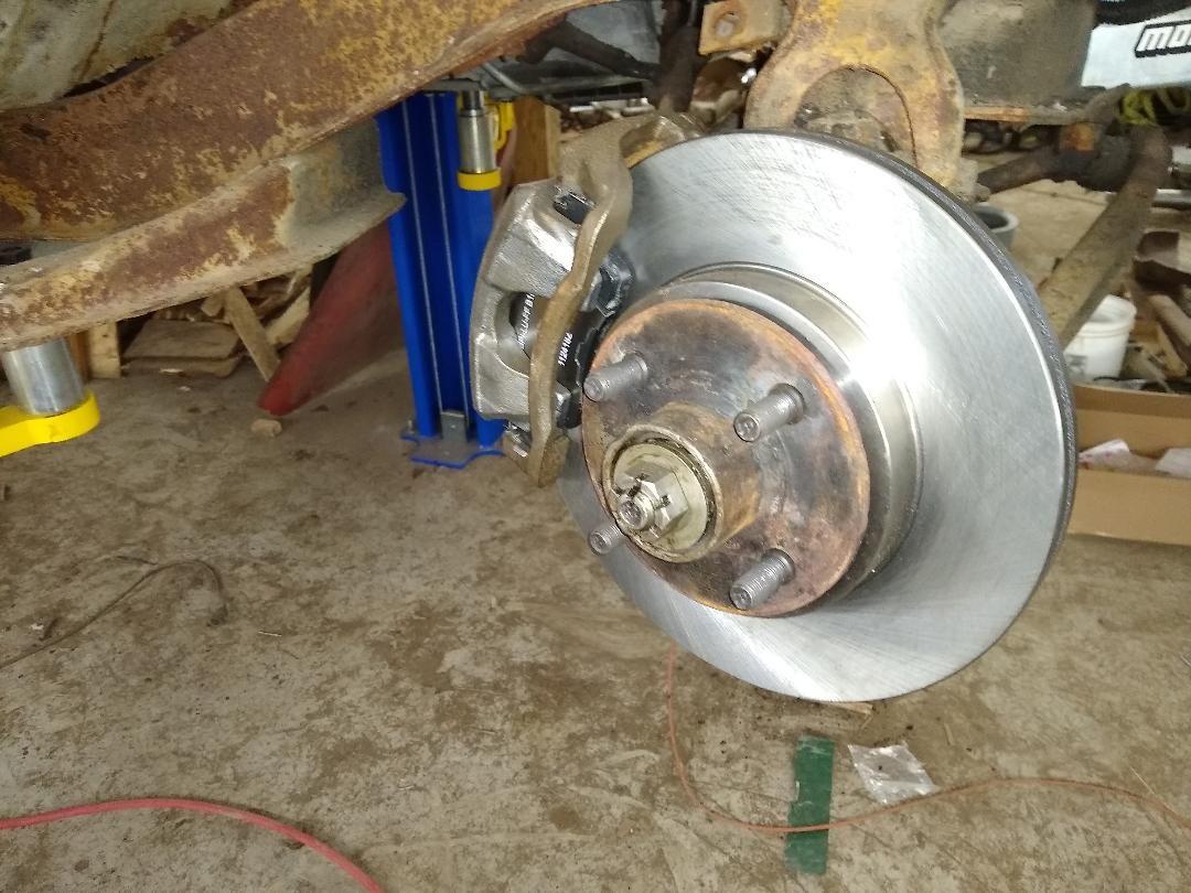

Here are some pics of disc brake conversion and new driveshaft
New Driveshaft made by Cook Bros., Watertown, NY
Had to remove more of the floor!! Front section of driveshaft is able to slide
Got a Studebaker Disc brake conversion kit from Turner Brakes
This kit uses your stock hubs (once you remove the drums, and spindle assembly
The Caliper mounting bracket
