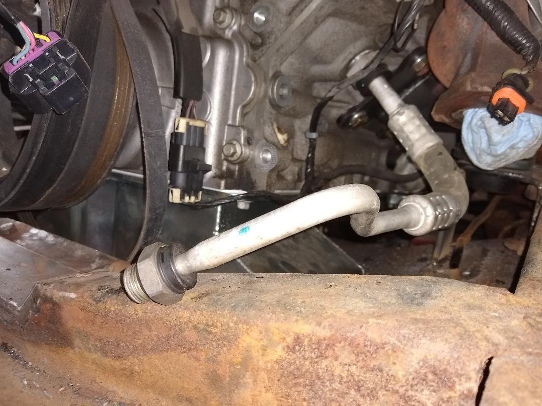

Does anybody know what this goes to? I think it is coolant line ,but part of the oil cooler system. Can I just remove it and plug it ?
Old Mar 13, 2019 | 09:23 PM
Posts: 22,291
Likes: 3,616
Looks like it's screwed into the side of the block, but into an oil gallery or water jacket? I would think either way you could remove it and plug the hole

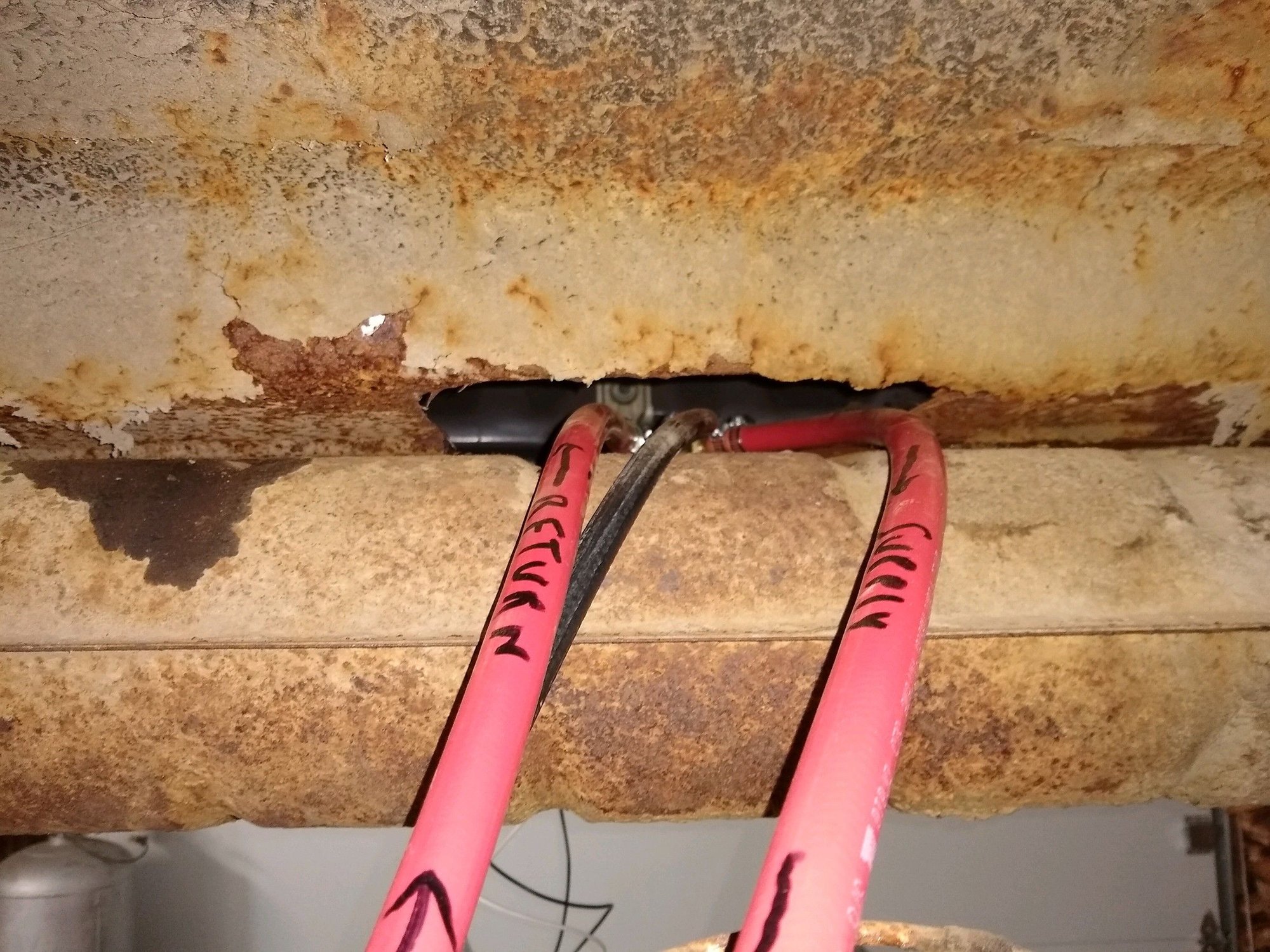

Took out gas tank, re-lined it with POR-15, put in high pressure fuel pump,new sending unit for fuel, and put tank back in
Ready to hook up
tank didn't have fuel pump so i had to make a hole in trunk, so tank would fit,I will make an access panel
put in 2000 corvette fuel filter /regulator

What are you using for fuel line? I've never seen red rubber fuel line.

48studebakerbusinesc's Avatar
Joined: Dec 2018
Posts: 42
From: Rensselaer Falls NY
Default 48 Studebaker LS-3 conversion rear end width
Got it at Napa,it is rated for 200 psi
Pretty sure that's an oil cooler line. I think there is a block off you can get for it.

I see in your fuel tank hose connections you are using worm gear clamps, those are incorrect for fuel injection lines, at your fuel regulator you have a mish mash of the correct and incorrect fuel injection hose clamps as well. Another note those quick disconnects at your fuel regulator have the plastic retainers which have been known to not retain the quick disconnect properly and pop off causing fuel leaks and possible fires. I also have never seen red fuel injection hose, as you say it may be rated for 200#’s of pressure, but is it fuel injection hose rated? Just a few words of caution.

What would be a better set up? The last thing I want to do is have the incorrect set up and have problems. Although I have 40 years shade tree mechanic experience,This is my first build , and there is a lot I don't know
That is a coolant line for a cooler...……. You can remove it as GM has plugs for cars not having that function...…. But.... Beware that when GM installs them at the factory the sealant they use usually causes thread damage during removal...… happened on every one I removed...…. If that happens I had a tap made for fixing that issue...… Let me know and I will send it to you to re-tap the hole...…
Ken
Went to dealer today,ordered the plug. When I removed the hose , came out very easy and nice,I will have to wait and see how the threads are when I get the plug.
