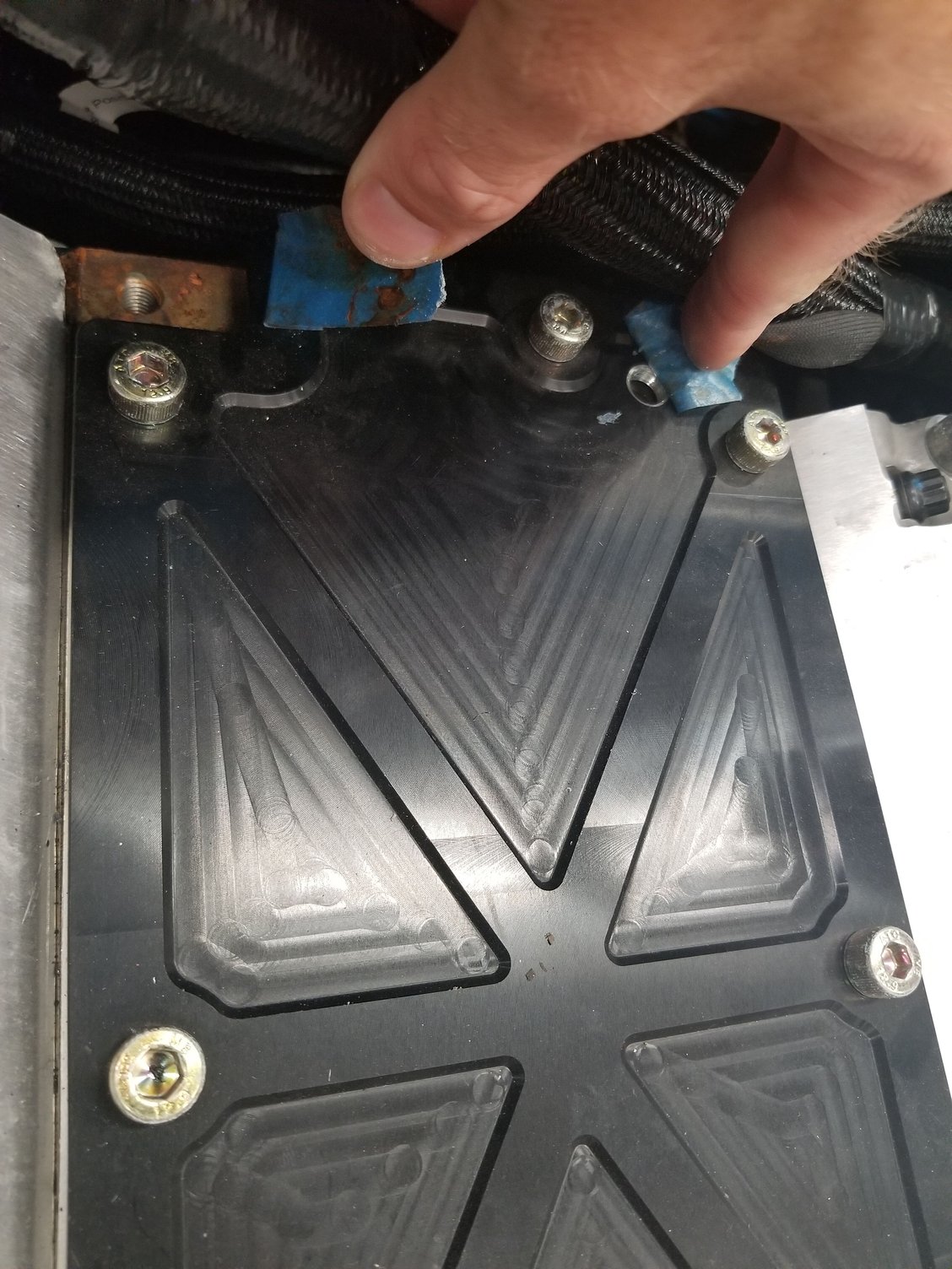

I'm in the process of installing a new engine in my Camaro and I can't find the thread pitch of the port that is just past the valley cover on the rear of the block. I initially thought it was 1/8npt but it is a good bit smaller than that. Does anybody knows if this is an oil port and what the thread size is? Any help would be greatly appreciated. Thanks

Unless you know who made it...you're in a better position than anyone to say.
But from that photo, no way whatsoever does it look too small for 1/8" NPT, assuming you're referring to that open threaded port just below a bit of tape.

Posts: 230
Yeah the one on the right I had drilled for 1/8npt. The one in question is the one on the block on the back left.

Do you have an assortment of metric screws? See what fits....

Its 16mm 1.5 auto meter sells an adapter fitting for it #2268
If you mean the hole the same as all the fixing holes for the valley cover, then it is the same standard M8x1.25

Thank you everyone for the help. It was M8
