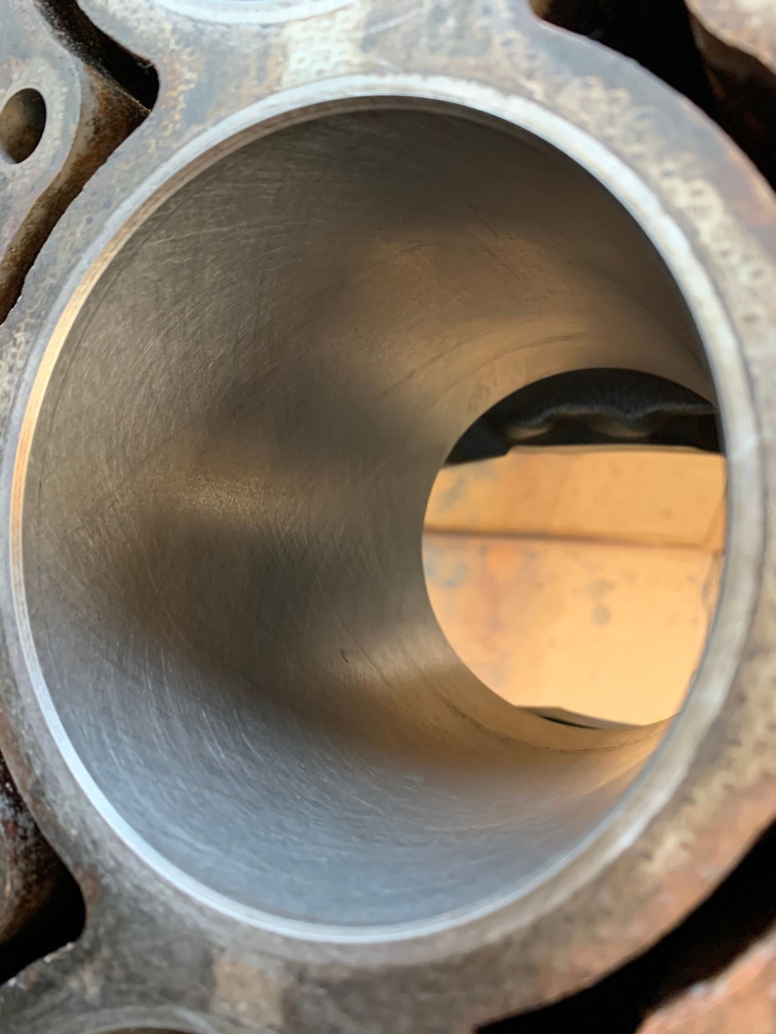

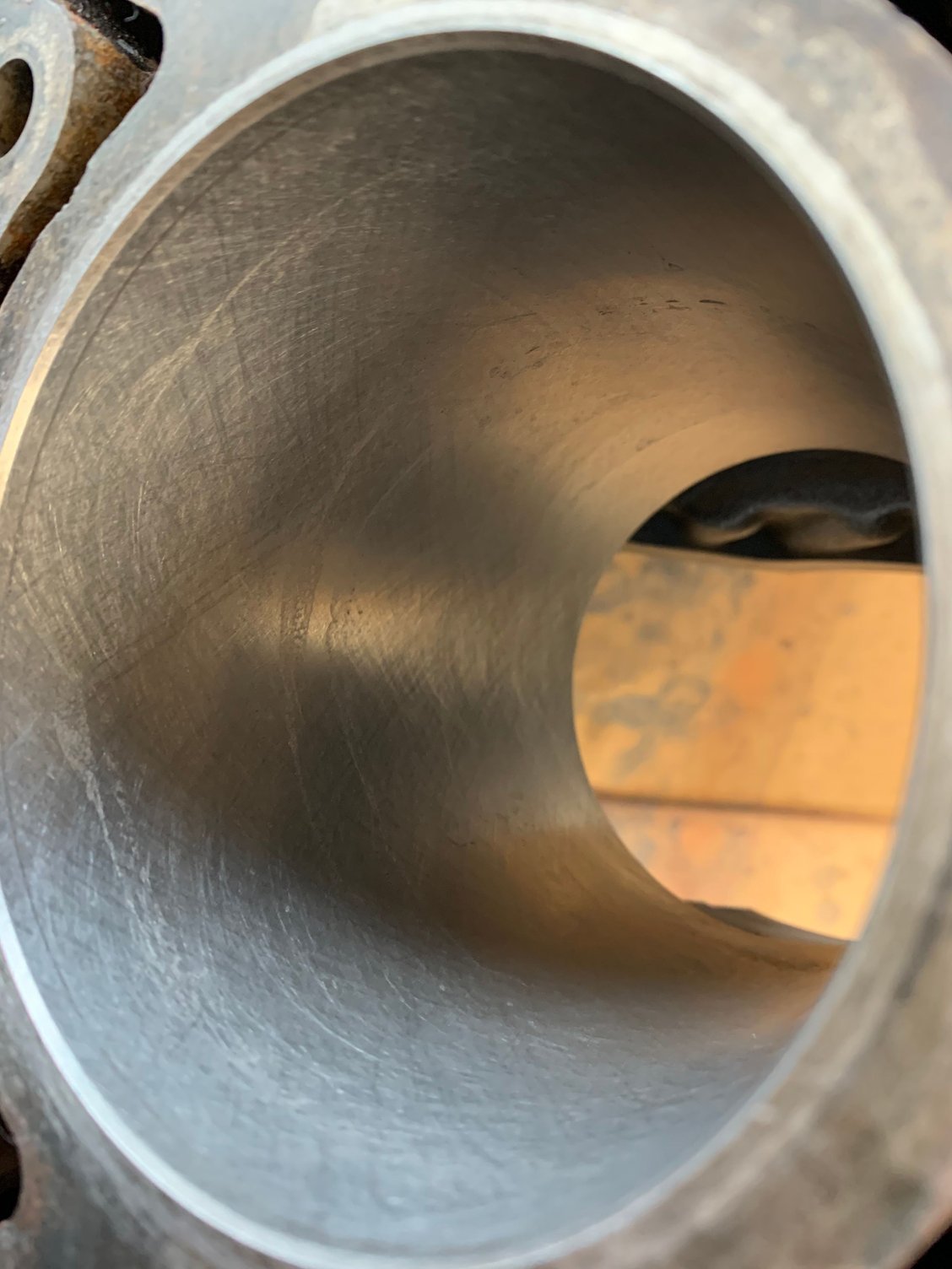

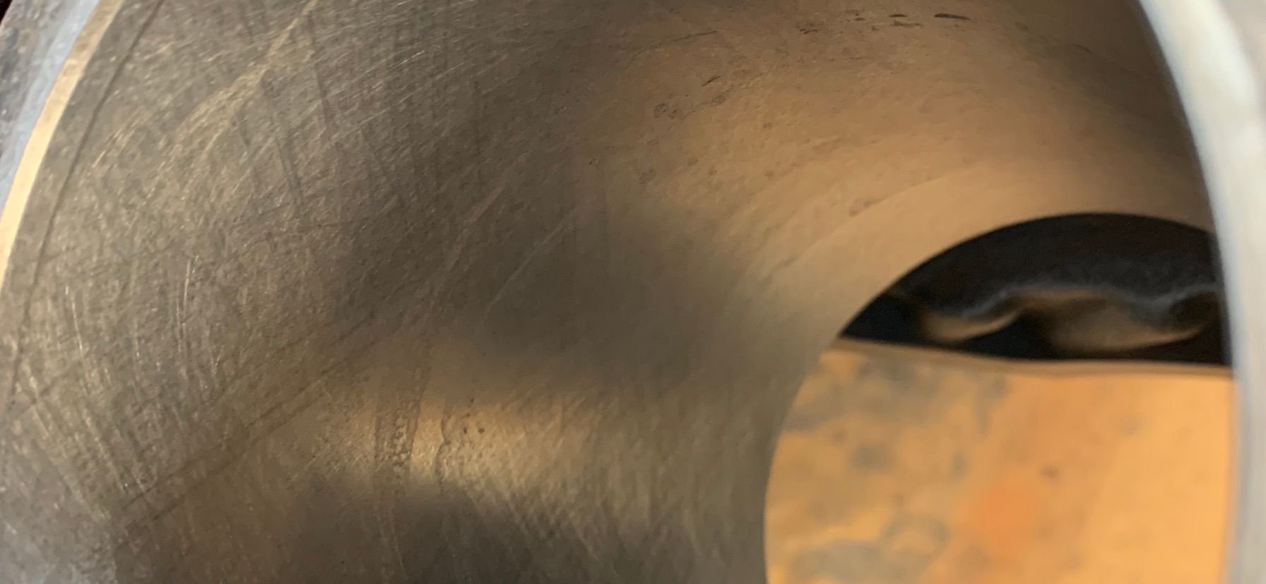

Would like feedback, was home last week and tore it down. Some of the cylinders look like rings were stuck or some water got in? Was a running engine a few months prior to me getting it. Anyone think this is usable? I feel like it needs .75mm over to be safe. I did ball hone the cylinders as they were glazed pretty good, I could just barley see some cross hatching under it.

Old Jan 2, 2020 | 09:55 AM
Posts: 22,291
Likes: 3,615
There is crosshatch ALL THE WAY to the top of the holes. Run it.
Old Jan 2, 2020 | 10:29 AM
LS CHEVY II's Avatar
Joined: Jul 2019
Posts: 116
Likes: 13
From: Indianapolis, In
I added that I did hone the cylinders, that's not factory. Still thinking the same thing? I agree its minimal and the cylinders should catch most of the oil pre burn.
Old Jan 2, 2020 | 10:42 AM
AwesomeAuto's Avatar
Joined: Dec 2019
Posts: 1,129
Likes: 478
Can you feel any of the spots by hand? If not, ignore the stains and run it.
Old Jan 2, 2020 | 12:53 PM
Joined: Jul 2019
Posts: 116
Likes: 13
Yeah, a little bit. Almost seemed like a few cylinders had tiny pocket holes. I believe the pictured cylinder had a small wavy feeling near the staining.
