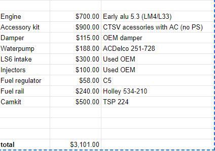

Hi,
For my swap I need an engine that has CTS-V spacing and carintake.
Have I captured all the needed items to convert a 5.3 alu engine into a 5.3 "Car" engine?

Old Dec 4, 2019 | 09:08 AM
Jimbo1367's Avatar
Joined: Jul 2009
Posts: 8,035
Likes: 664
What about exhaust and fuel delivery?
CAI?
Old Dec 4, 2019 | 09:25 AM
turbogrill's Avatar
Joined: Feb 2018
Posts: 19
CAI?
Not sure about exhaust yet. But it seems like the OEM camaro manifolds, aftermarket cats and OEM porsche muffler works well.
Traditional long tube headers is going to be hard (911, engine in the back facing the wrong way). Maybe some shorty headers or huggers could work as well. The Porsche mufflers sits nicely under the fenders.
Fuel delivery will be Porsche pump and C5 regulator with aftermarket fuel rail (needed for clearance). There is a write up on it and doesn't seem to be that hard.

I would also budget for a corvette or aftermarket oil pan

Is it just me? Buying $2400 worth of parts to bolt to a $700 engine seems a bit odd...
Old Dec 5, 2019 | 06:05 AM
Michael Yount's Avatar
Joined: Jun 2015
Posts: 3,125
Likes: 501
Time you get exhaust and oil pan figured out -- I'd look at just buying a used LS1, LS2, LS3.....

That $3100 will turn into $5100 really quick. Fuel system, belts, hoses, fluids, exhaust, then factor in $500-$1000 for all the parts you dont know you need yet.

take the original estimate and double it

Considering what you are doing, AND that you are looking at just using a 5.3.... have you considered starting with an LS4? Those are a 5.3 aluminum car engines for the FWD applications. Aluminum block, Flat tops, 799/243 heads, car intake with 30# injectors, It's got a different bellohusing pattern, IIRC (the 60* V6 pattern) but if you are using an adapter, you might be able to work with it. Its designed to be as compact as possible. Even shorter accessory drive than a vette/cts-v setup.

To be fair, his post was the cost to convert a truck 5.3 into a car engine intake/accessories, not the cost to swap a whole vehicle. Its not gonna cost $7000 to put a car intake and FEAD on it.. (Cam costs and fuel filter shouldn't be there either, technically).
I would think the point others mentioned above is valid: For the money, you may be better served by finding a Corvette or CTS-V LS1, LS2, or LS6. You've outlined $3k to get an aluminum block with a car intake and short accessory drive (and yeah, probably need to swap the deep truck pan for something shallower). You might be able to find a complete engine with everything you need. Sometimes spending more is less in the long run. LS3 would be nice, although not likely in that price range.
I assume you've done the homework on the horizontal/vertical positioning of the AC compressor and alternator on which drive you need, and not just the offset spacing of the pulleys.
This is exactly what I am trying to figure out, I read constantly how people manage to get a swap for cheap by using a truck engine but maybe that doesn't work in my case.
Seems like I will start with a car engine. A CTS-V engine would be easiest (has accessories in the right place), a LS3 would be coolest.
I guess the truck swap makes sense if you can just drop it in without fiddling to much with it.
