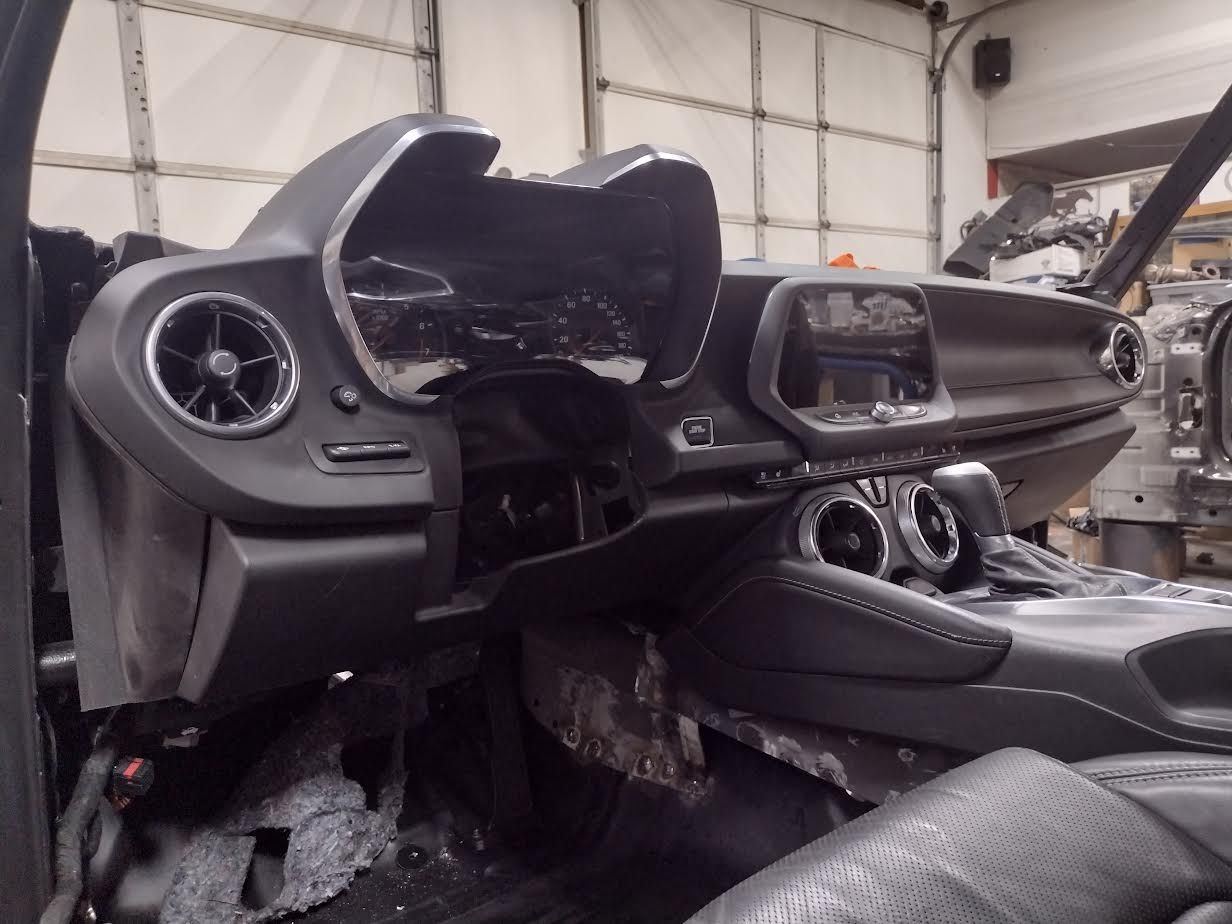

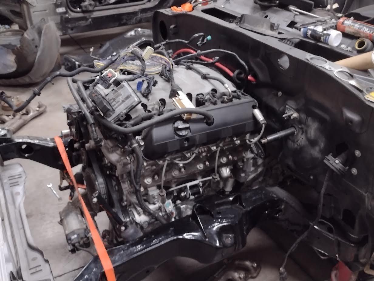

Exclamation lt4 swap in 72 chevelle
so first time posting hear just moved to tenneesse and im starting a restoraton shop RMC ridgewood modern classics and its just me. im taking a 2016 camaro ss motor/trans/electrical and dash and insterment cluster and putting it in a 72 chevelle i am running into problems with service theft deterrent light. I have hp tuners and disabled the vats and did a wire intire to ecm pcm but it cranks fires up a sec and shuts off i tryed reprograming keys to it and nothing the door locks and remote work but its not starting. i ran a dtc test and i keep having no envirmental identifire receved from ebs and inflatable restrant modual would that be my problem for starting? but with vats disabled y is that causing the prob.
