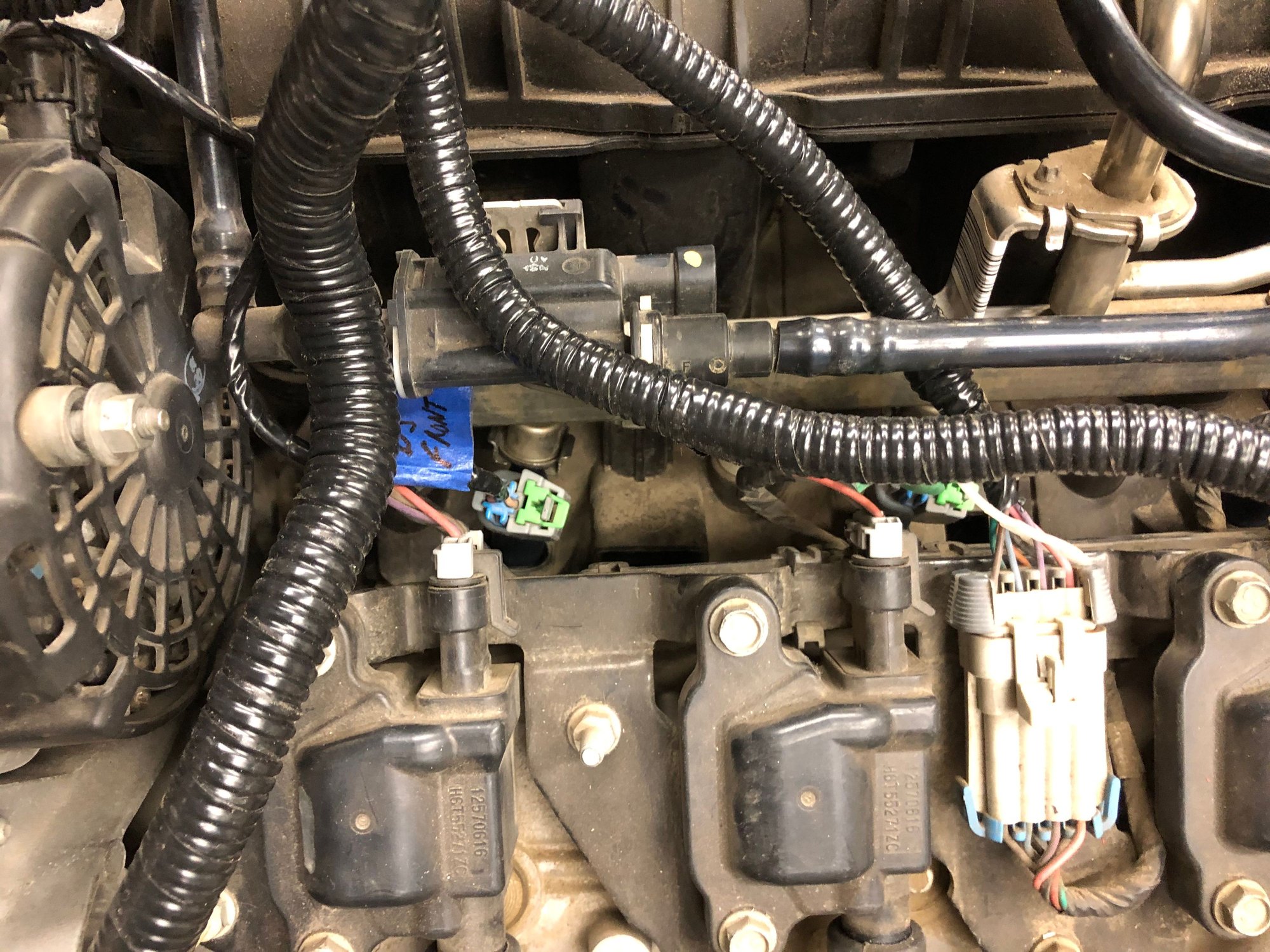

Engine is from an 08 Tahoe, 5.3 Vortec. I'm test fitting the stripped down wiring harness and there is no plug for the evap solenoid. I assume it's been deleted as I asked the programmer to remove anything unnecessary. Just wondering what to do with this stuff. Remove the solenoid and hard hoses and plug it on the intake?

Yes just cap it off.

Thanks 01Camaro. We don't worry about inspections or emissions here. My tuner eliminated the evap. I finally got back to the shop and pulled off the solenoid and lines. Gen IV is not like the Gen III. All that was left to cap off was a nipple on the intake. 1/4" I believe.

Confirming this was the situation on my Gen IV LS3 - disable the appropriate stuff in the tune; remove OEM plastic line/valve from the intake and put a cap over the nipple that the plastic line came off of.
