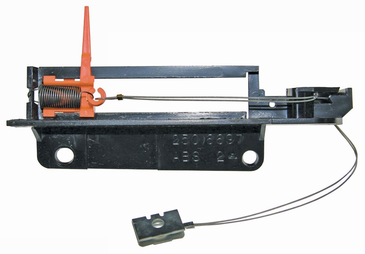

I think that year of GM the gear selector needle is just a simple cable pull. One end of the cable pulls the needle. The other end has a metal clip that attached to the collar on the column - just slides onto the edge of the collar (near the bottom?) that moves with the shifter lever. All you have to do is slide it a little to the left or right to adjust
. Very simple system actually.
