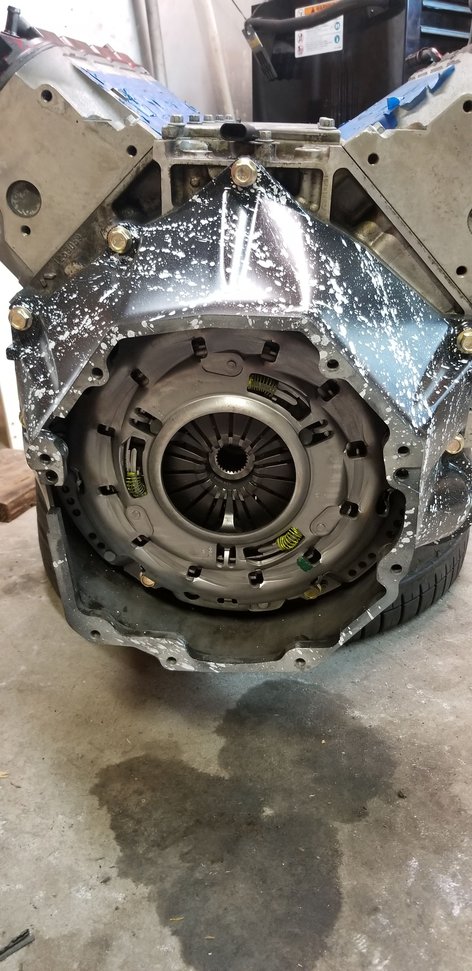

So I'm new to the ls world and swapping a 99 5.7 paired with a t56 into a nissan 350z. I have installed the motor and trans about 3 times due to oil problems and some fitment issues. This weekend I hope to put it in for the last time. I noticed this time when I tighten the pressure plate the teeth pull in a little bit. I'm not sure if it will cause an issue upon start up. I'm still waiting on a new slave cylinder to arrive (the last one was defective) so I have a few days to kill. The clutch I'm using is a LUK clutch.
Any help would be great!!

Thats pretty much normal, when you tighten down the pressure plate it makes the fingers go down a little.
