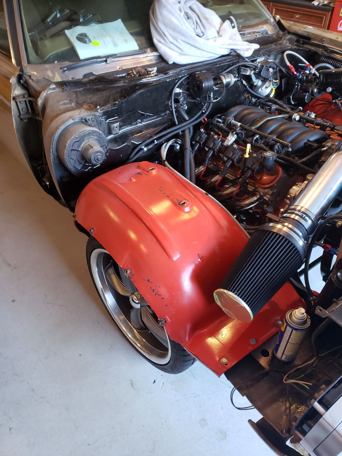

Okay here goes,
The motor is a 2002 LS1 w/ DBW from a Corvette.
I am buttoning up all the standalone wiring and harness connections on my swap. Ran into a bit of a problem. First off I couldn't get the Fuel Pump to prime, I checked the relay connections that I had setup and realized I had a couple of wires backwards. Before I had realized what I had done with the Fuel Pulp Relay I had gone ahead and ran a 12v battery source directly to the fuel pump and it turned on and it was just priming the whole time, I successfully had the motor fire up and had to turn it off by disconnecting the battery connection to the fuel pump, would have ran until the fuel ran out. So now that I got all the wiring connections wired up, now when I turn the key I can hear the fuel pump prime for 2 seconds and the DBW/throttle get power as the throttle body fin moves a bit with key in on position. When I go to start the motor it fires up, but for only for like 2-3 seconds and then the motor turns off. I cant even hear the fuel pump on after the priming stage to when I turn key to start it.
I had gone through the ground pins 1 & 40 on the red and blue harness, the ground connections were good.
I went through pins 19,20,57 on the blue harness and all had power. I checked all the injectors and they also had a 12v signal. I did a continuity test on the #9 fuel pump relay from the blue harness as well and it was fine.
If anyone has had this issue, or have any suggestions please let me know.
Thanks Guys.

Not sure about the vats but I I'm in a similar situation.i haven't had time to troubleshoot mine yet but recently when I got it to the first start phase the fuel would run for a few seconds then stop.It ended up having a burnt pin in the deutch(spelling?) connector I had near the pump. I'm going to swap out the deutch connector for a weatherpak connector.

When the key is turned on, the fuel pump will prime for 2seconds. If the PCM see the ignition pulses within 2 seconds of cranking, the PCM shuts the pump relay off. I'd make sure the relay is clicking and you have power at the fuel pump. Make sure you have good ignition signal and spark.
