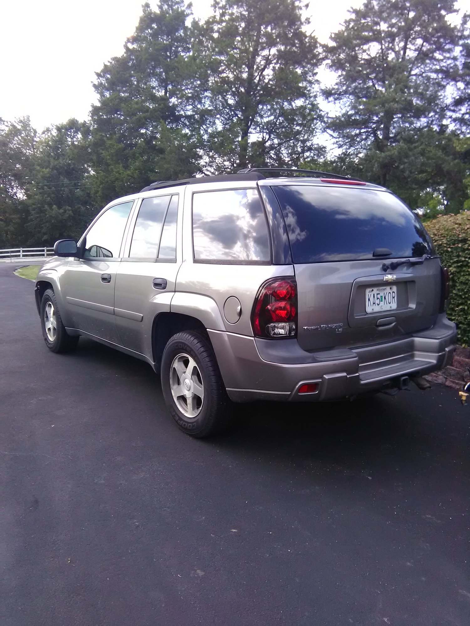

To bad you ain't 50 miles out side stl . I got this one for sale but........ It's got 258,000 mi believe it or not every thing works runs and drives ,hood is peeling paint. A lot ove service engine lights on for bad cats/iac and who knows what else, would be a good start for you 600bucks too bad you ain't closer man.
