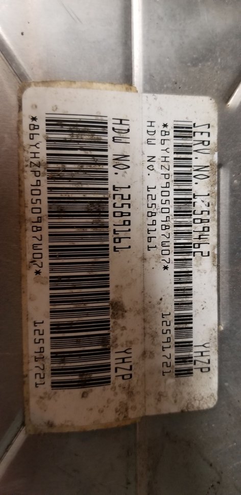

I have a LS1 (2001 Corvette Engine) In my 1971 Nova. It will have a 4L80
I Picked up a Wire Harness (Red/Blue). looks like it was out of a 2005 GM Van LQ4.
The first thingI noticed is that the Fuel injector connectors were not the same. After a quick search I found adapters.
Now with that said should I expect to have more terminal end fitting not fit? Should I expect to find more adapters?
Thanks
