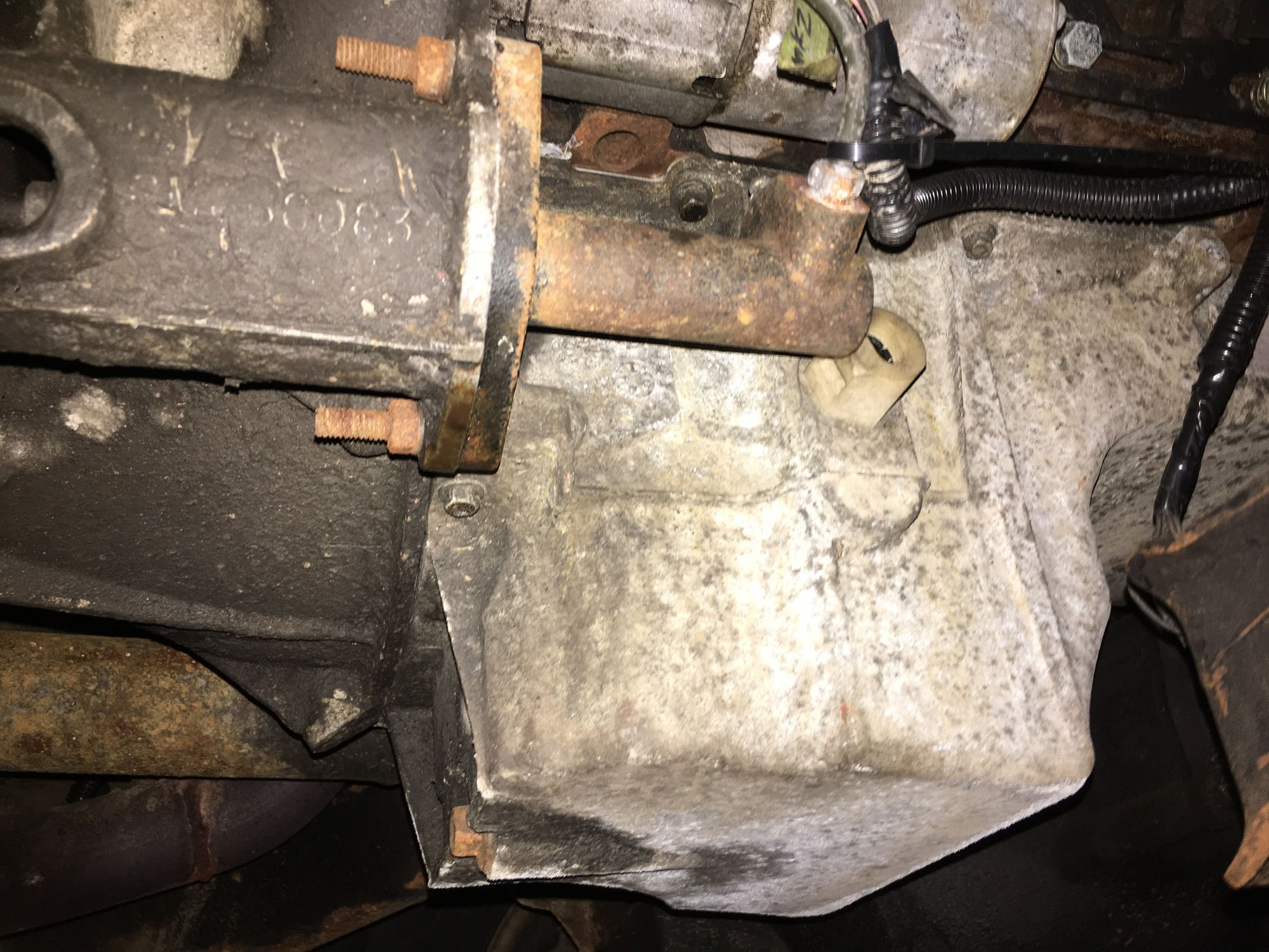

what oil pan is on your motor? I have an nv3500 out of a 94/95 s10 with external slave , and factory 4.8 oil pan wont clear external slave... you have any pics or tips for fittment?
Old Mar 20, 2020 | 05:36 PM
jeffs55chevy's Avatar
Joined: Oct 2017
Posts: 184
Likes: 17
From: napanoch ny
I’m using the stock truck oil pan from the 4wd 99 Sierra. The slave cylinder even clears the low oil sensor in the pan. The slave cylinder I’m using is a 90-91 Chevy truck style because it takes a normal inverted flare line instead of the roll pin setup. So maybe that is shorter than the 94 style slave cylinder.
Old Mar 21, 2020 | 10:36 AM
slocaddy's Avatar
Joined: Jan 2010
Posts: 1,074
Likes: 17
From: sarasota fl
thankyou vvery much, i will deff be going that route, you just helped me a bunch!
Old Apr 11, 2020 | 01:13 PM
Joined: Oct 2017
Posts: 184
Likes: 17
From: napanoch ny
No problem. Now that I think of it, it might have been a metric bubble flare and not inverted, but either way it’s an easier setup than the roll pin style especially if you have to make your own line.
