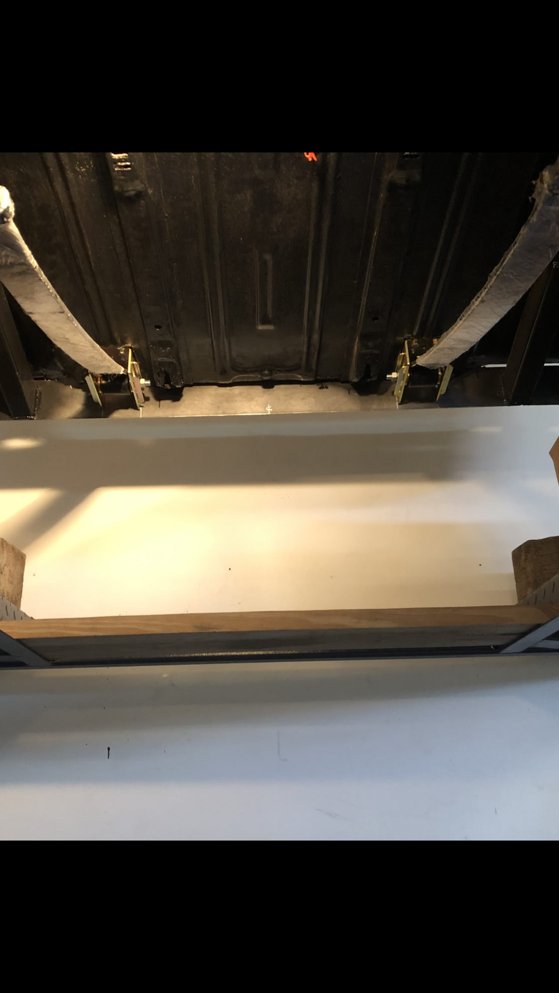

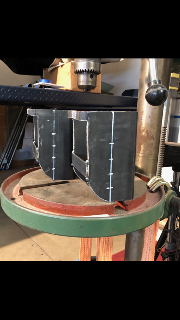

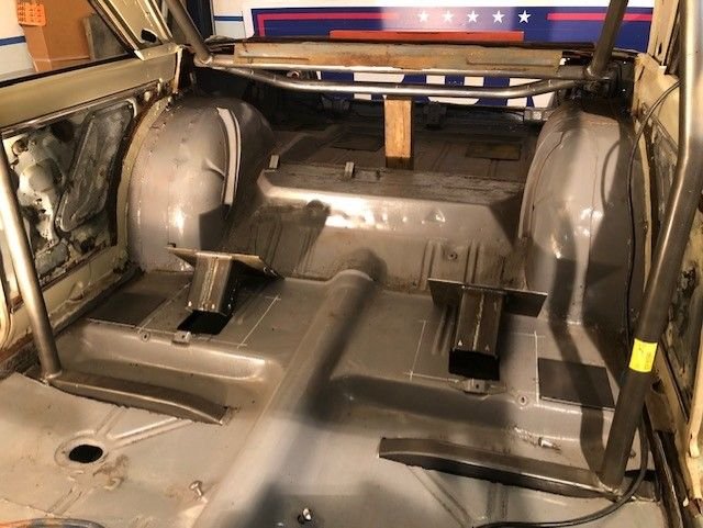

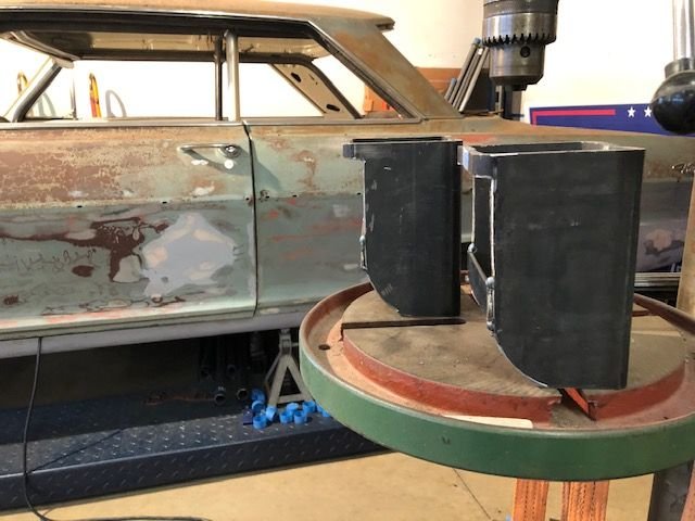

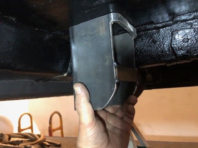

I built these new front leaf spring buckets for the new Smith Racecraft split mono leaf's to ride in. There will be four different ride height adjustments.
Old Jan 11, 2021 | 09:32 AM
  #44
Jciowa582's Avatar
Joined: Apr 2020
Posts: 85
Likes: 66
From: NW Iowa

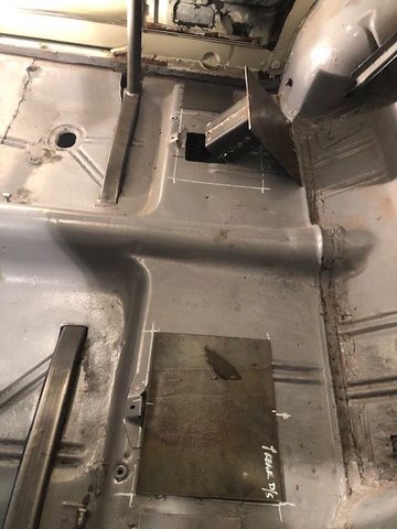

Here is a look at the adjustment holes to be drilled.
Old Jan 11, 2021 | 09:36 AM
  #45
Jciowa582's Avatar
Joined: Apr 2020
Posts: 85
Likes: 66
From: NW Iowa

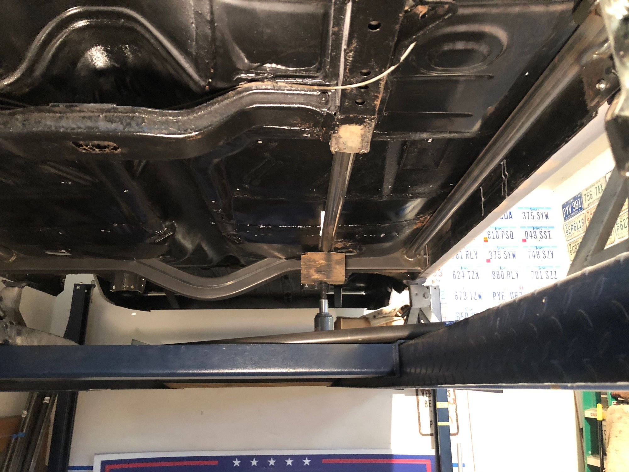

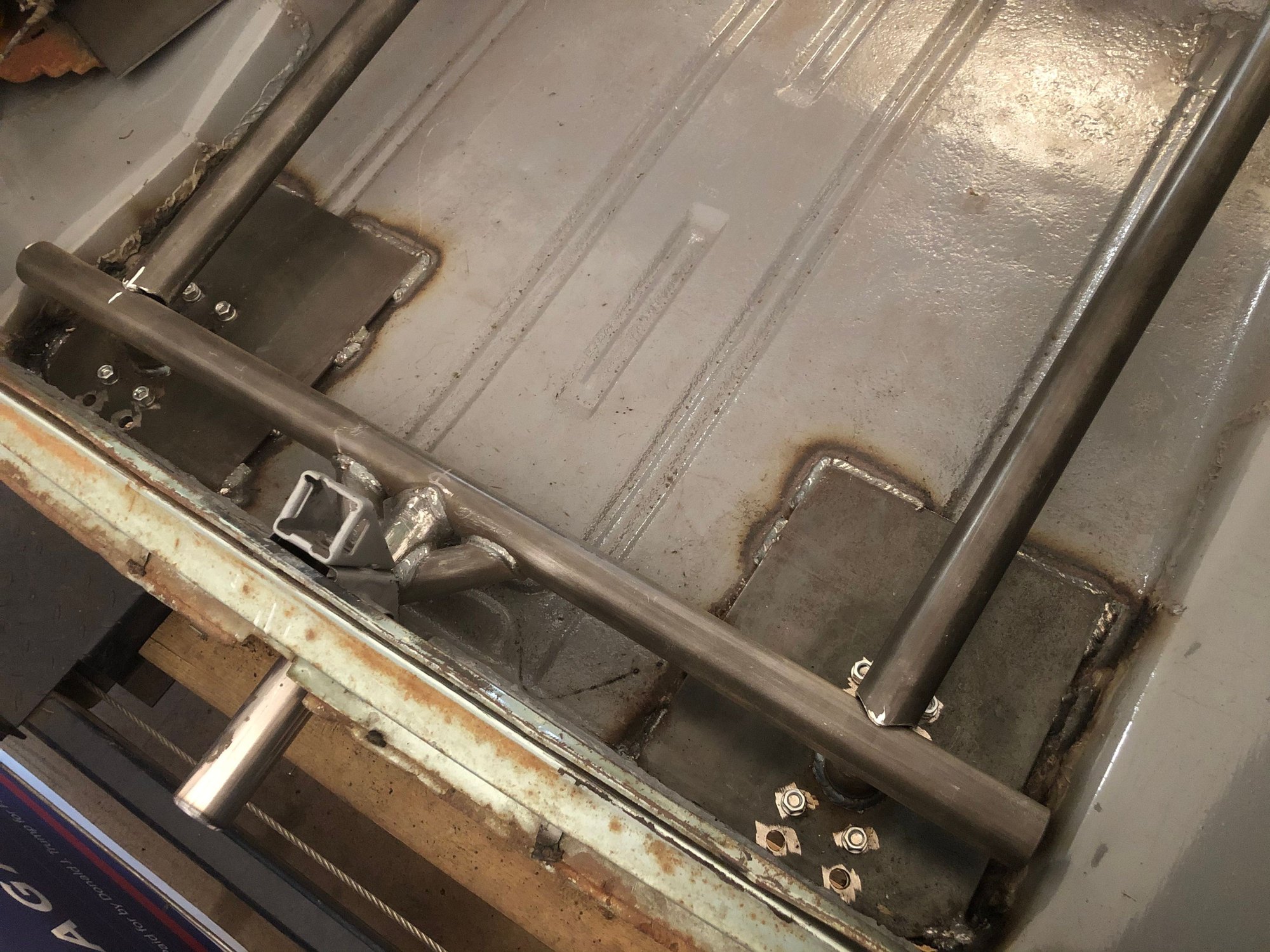

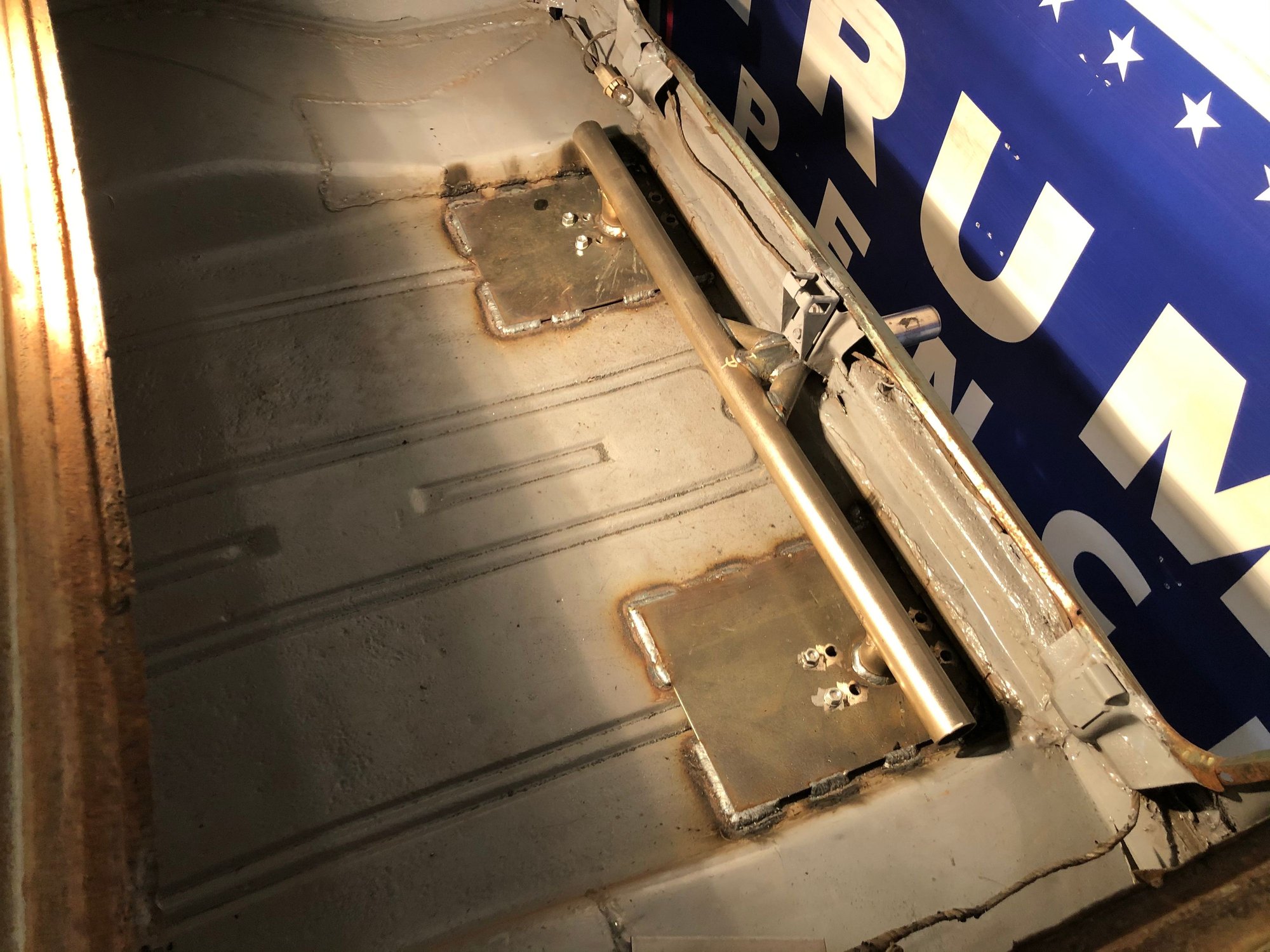

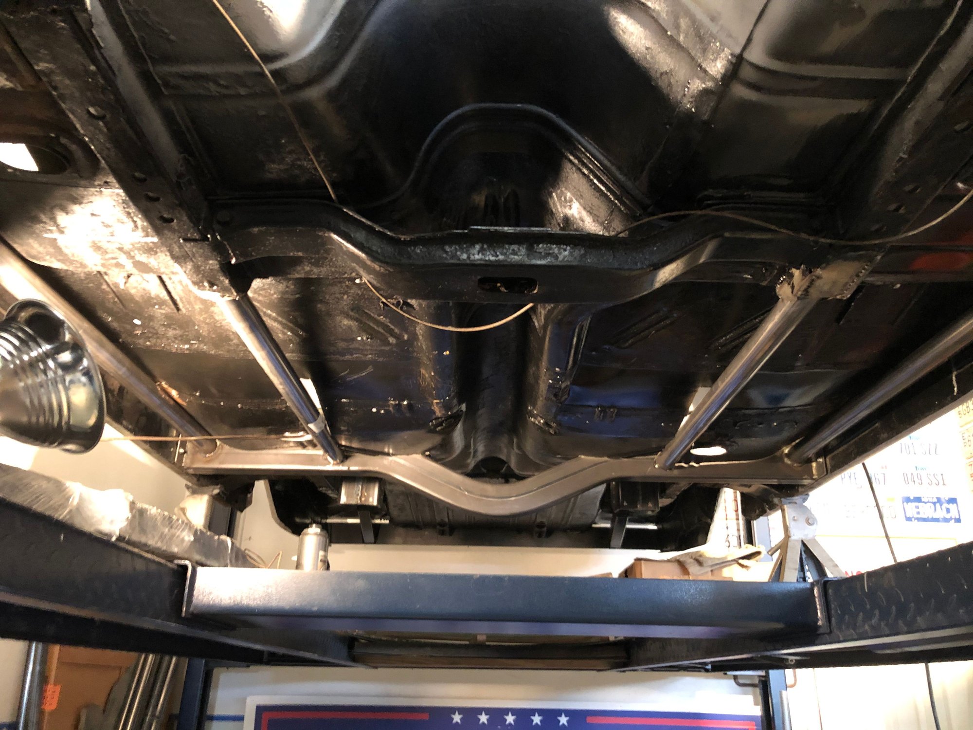

Here is a shot under the car where the buckets will drop through the floor under the back seat attached to a flat plate welded to the floor pan.
Old Jan 25, 2021 | 11:44 AM
  #46
Jciowa582's Avatar
Joined: Apr 2020
Posts: 85
Likes: 66
From: NW Iowa

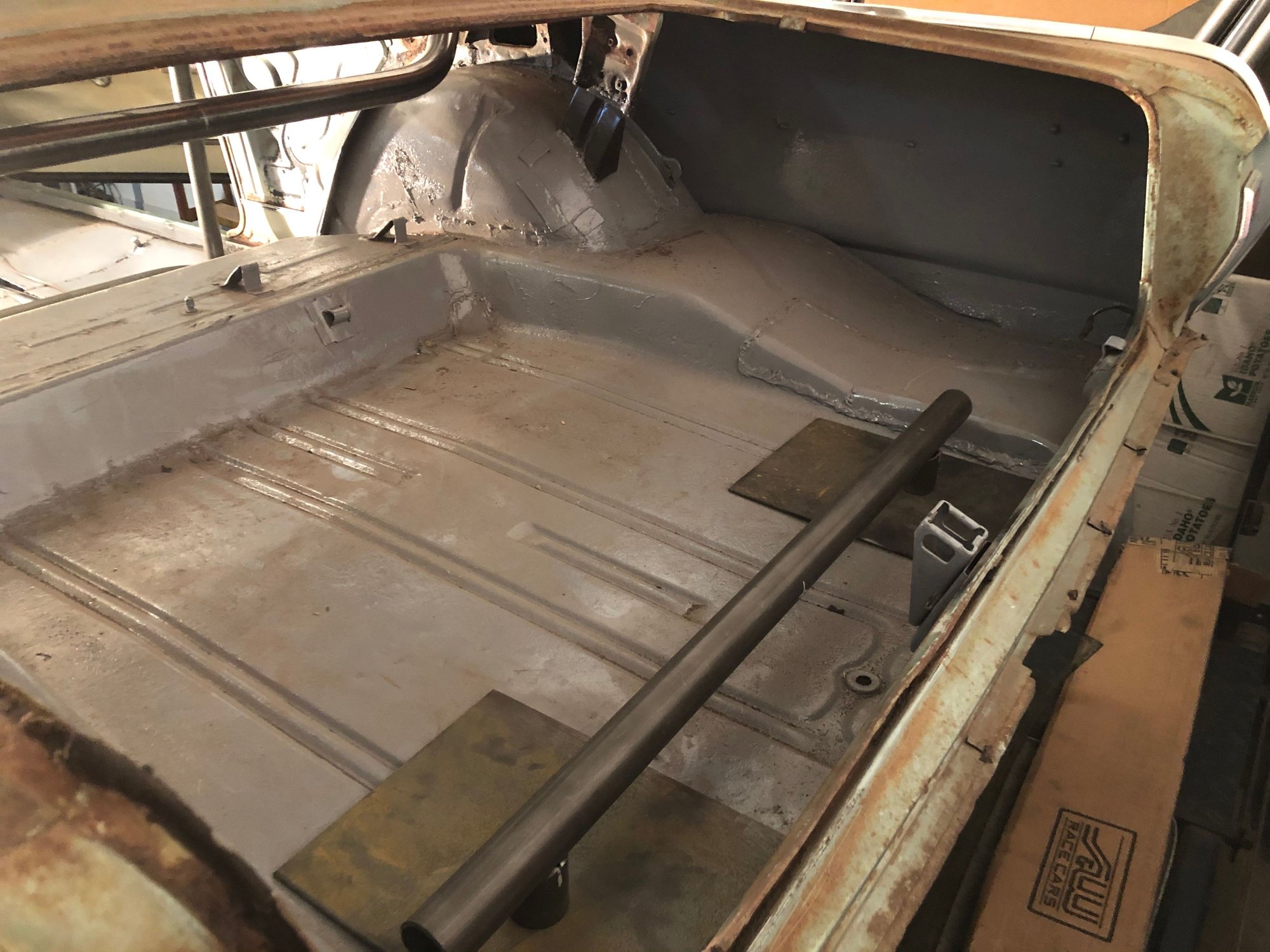

You can see how the buckets are now welded to the plates and will drop down through the floor.

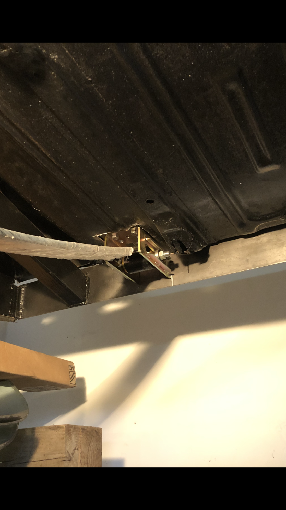

Old Jan 25, 2021 | 11:46 AM
  #47
Jciowa582's Avatar
Joined: Apr 2020
Posts: 85
Likes: 66
From: NW Iowa

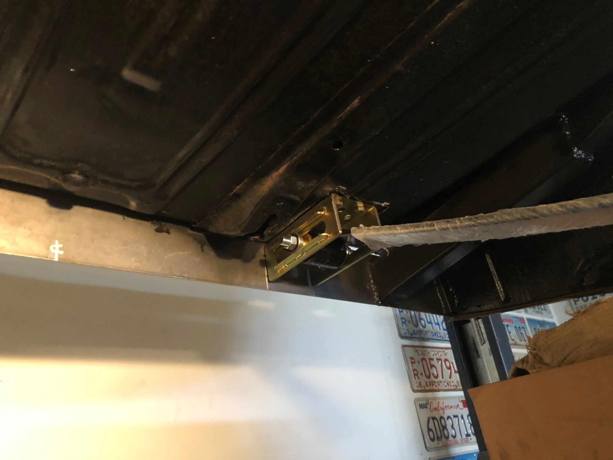

Old Jan 25, 2021 | 11:47 AM
  #48
Jciowa582's Avatar
Joined: Apr 2020
Posts: 85
Likes: 66
From: NW Iowa
Here you can see how they hang down through the floor.

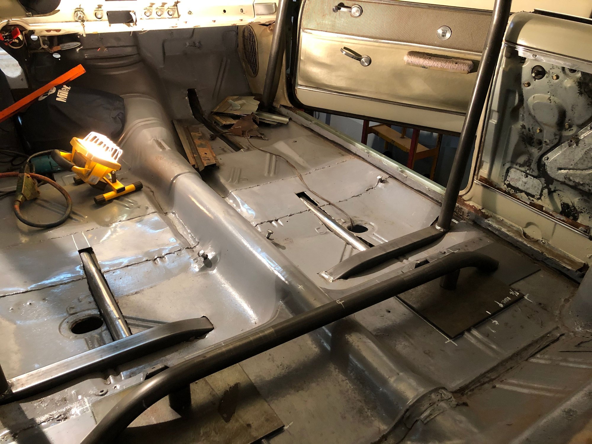

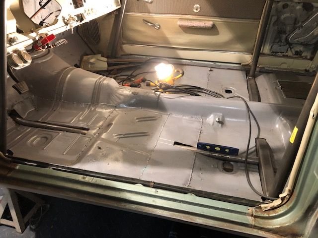

Drivers side frame connector in place ready to weld up.
Old Jan 25, 2021 | 12:11 PM
  #50
Jciowa582's Avatar
Joined: Apr 2020
Posts: 85
Likes: 66
From: NW Iowa

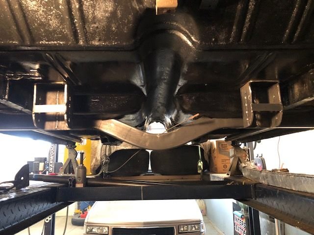

Old Jan 30, 2021 | 06:54 PM
  #51
Jciowa582's Avatar
Joined: Apr 2020
Posts: 85
Likes: 66
From: NW Iowa

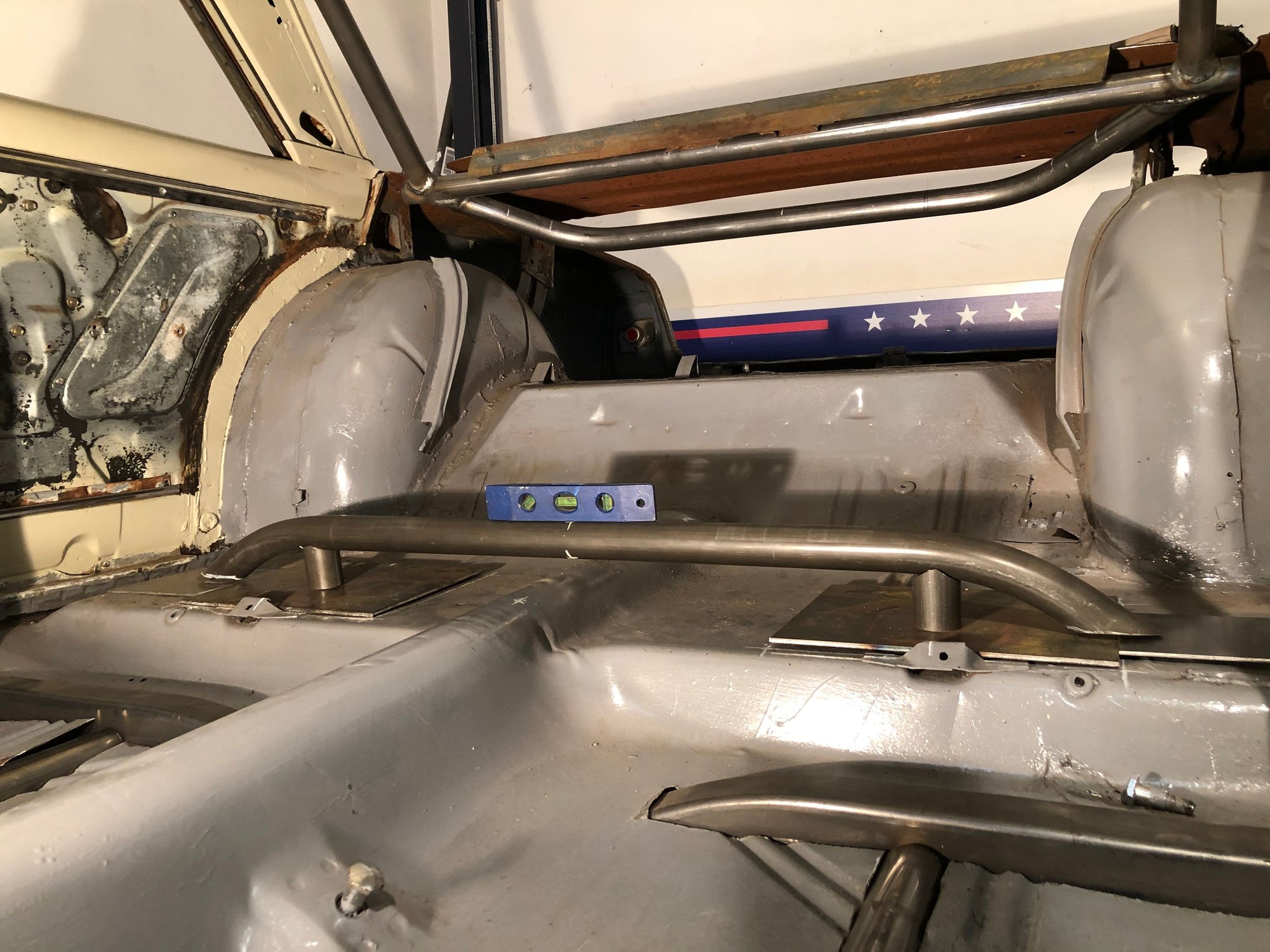

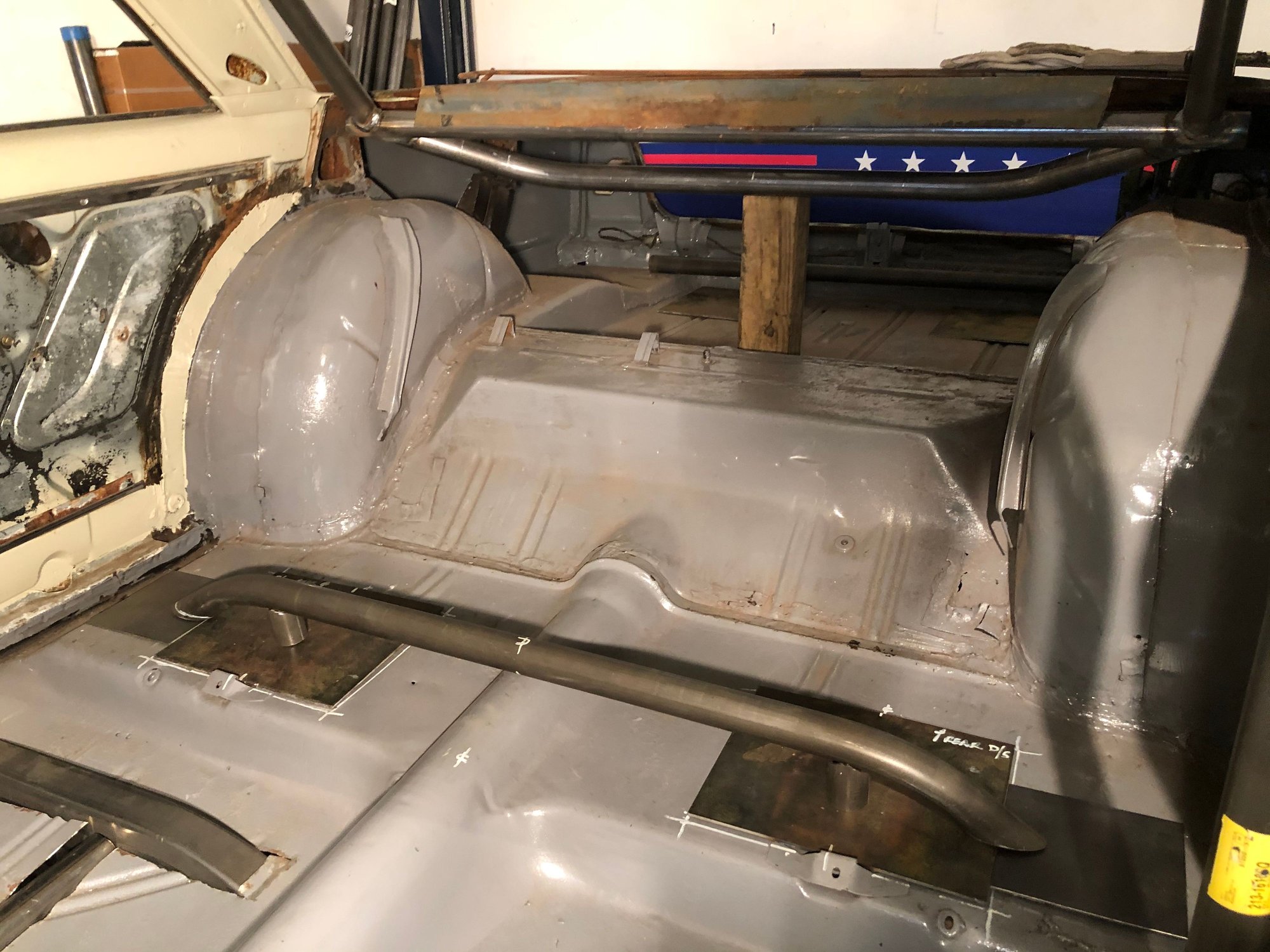

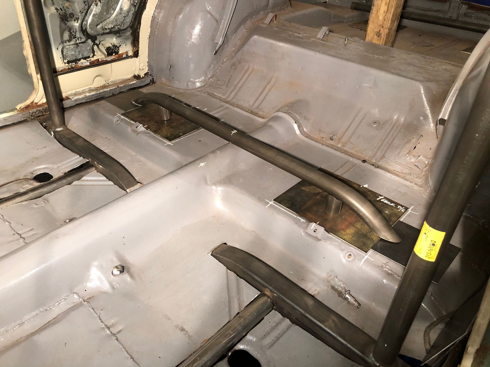

I bent up this bar today to tie together the new spring buckets. This will tie into the rear sliders with a tube frame.
I ran the frame connectors from the main hoop all the way up to where the front stub bolts on.
Trunk plates will be welded to the floor then the sliders will bolt to them.

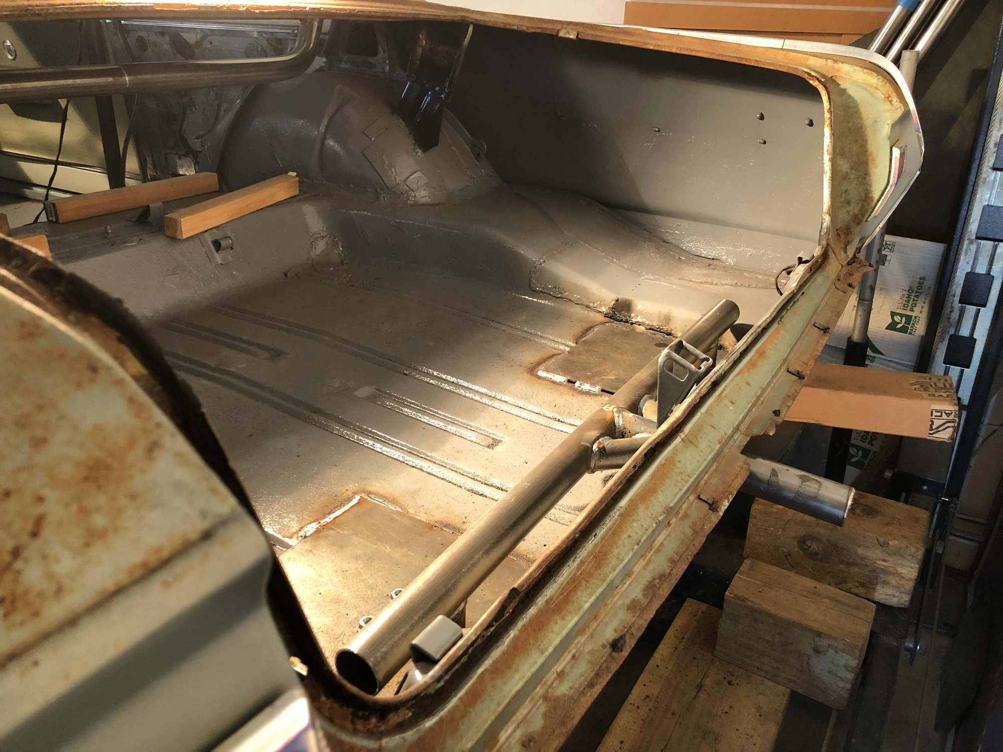

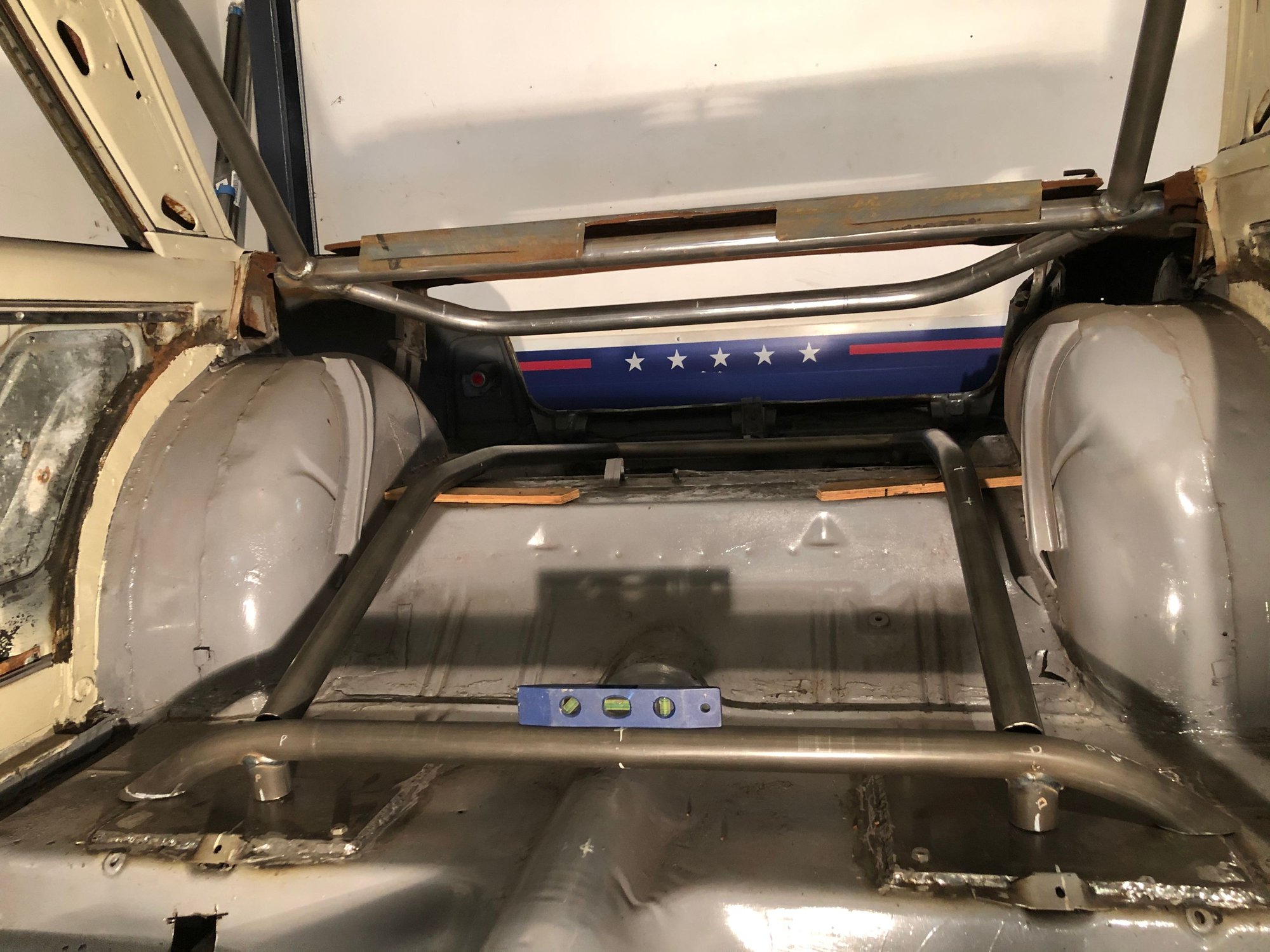

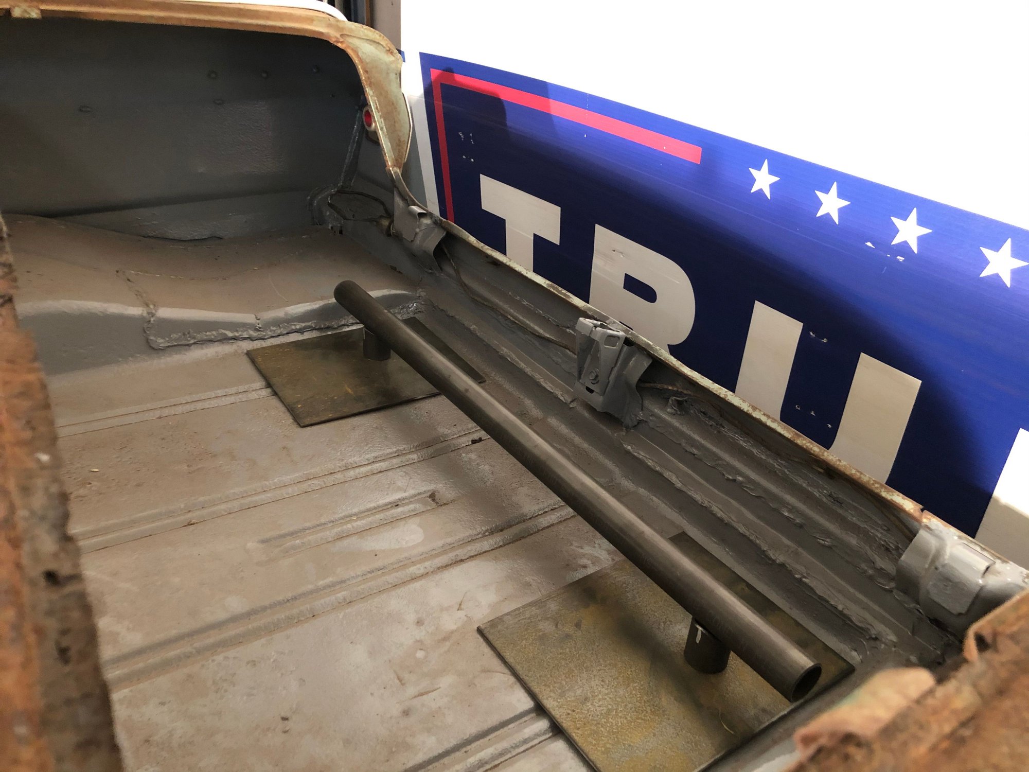

Rear sliders mocked up.
We are going to shim the sliders so the face down towards the rear end.
That’s a Speedway Chrysler slider.

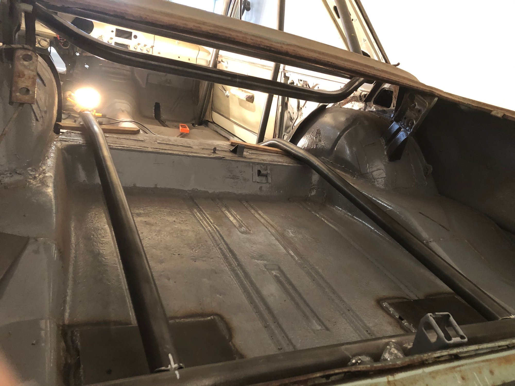

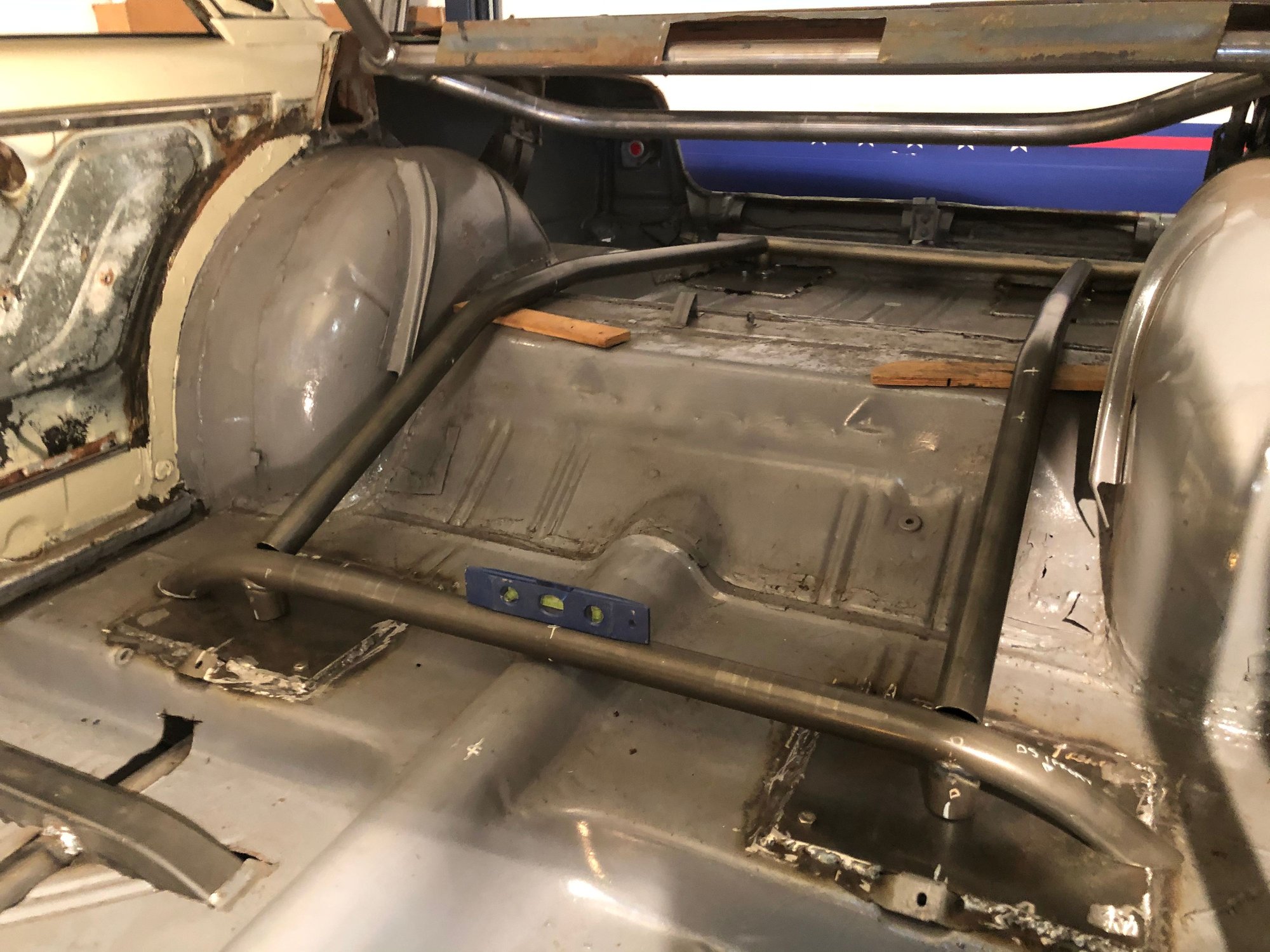

Rear bar with parachute attachment fabricated and installed.
New tube frame rails installed to tie the new leaf springs to there new location. There will be an upper one installed next.
