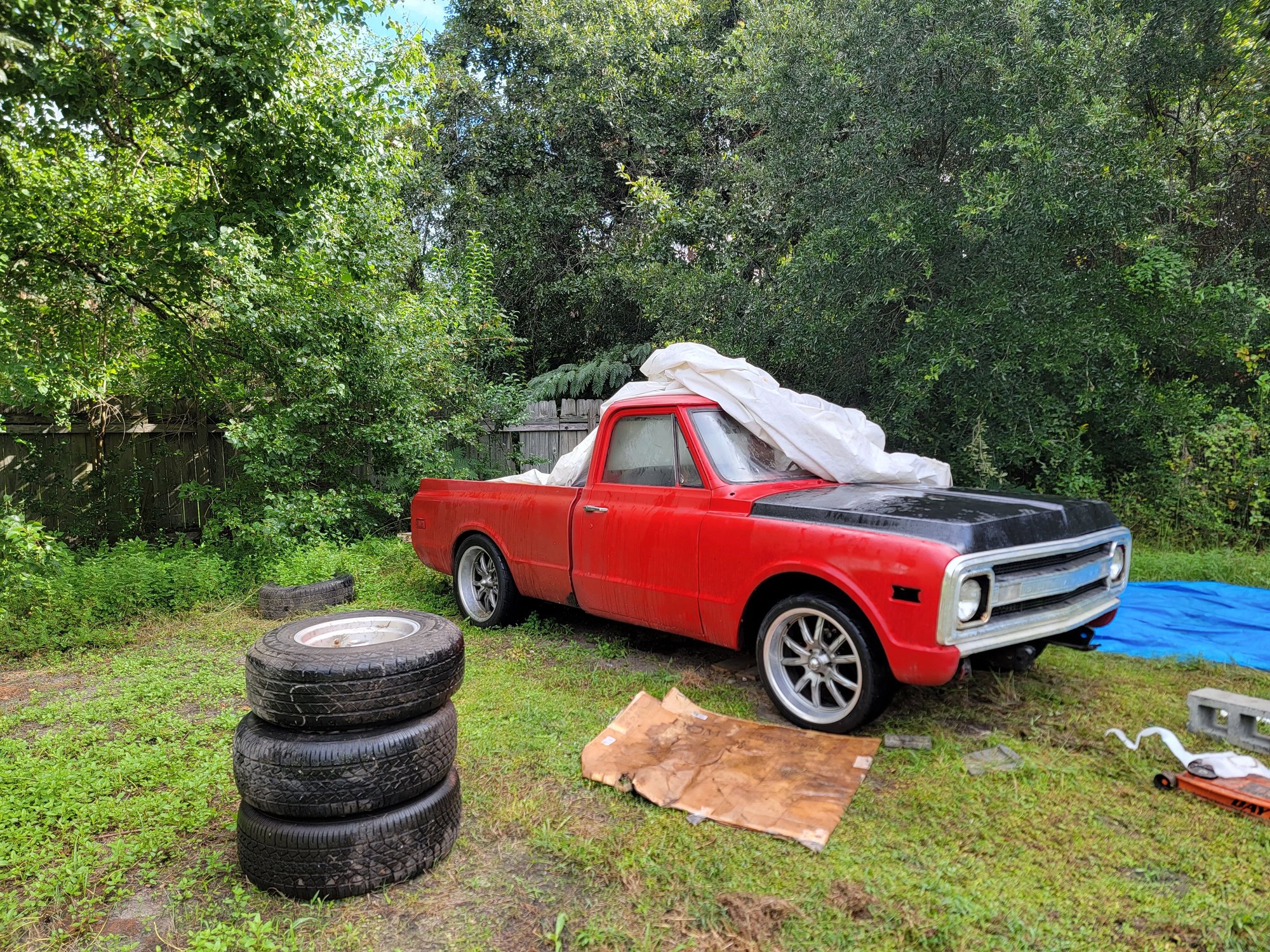

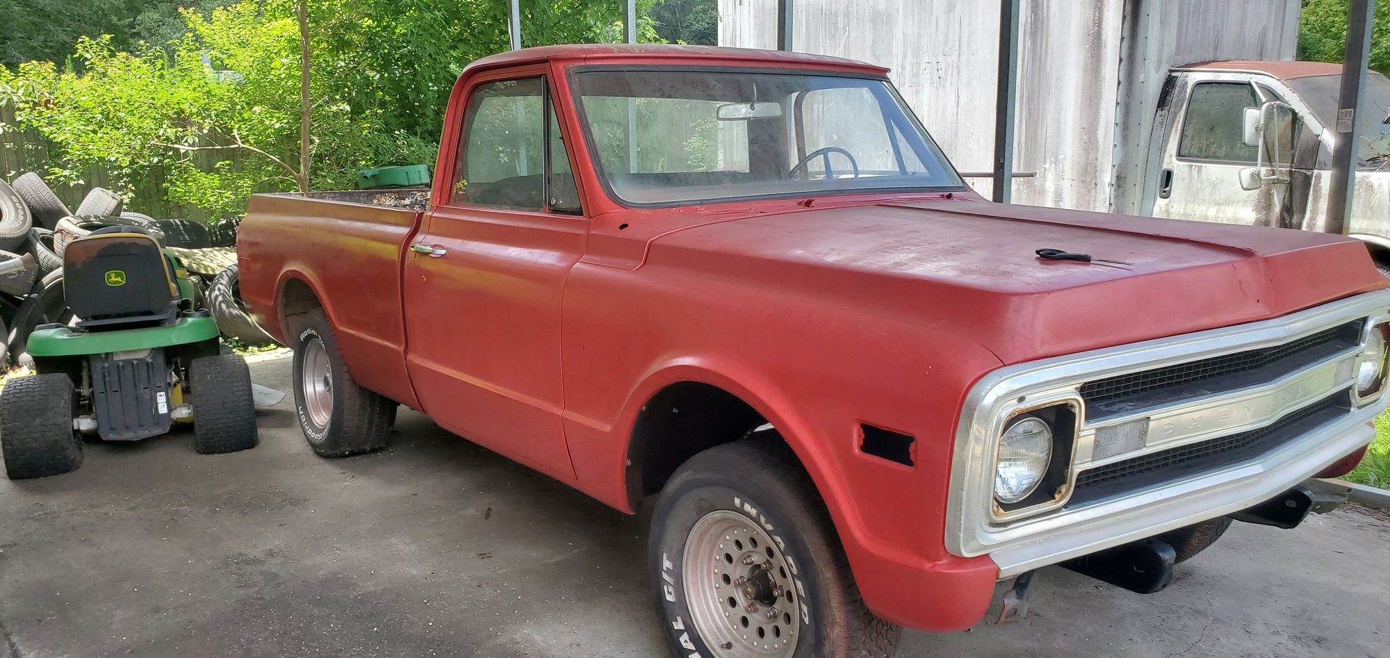

I picked up a new project a month ago that I've always wanted. It's a pretty decent 70 c10 swb. I'm just about finished with my 71 Chevelle project and I wanted to do something else that's alot simpler and cheaper.
Hopefully I don't go overboard with this project too, my plan is to fix the body, add a couple of modern touches and to use it as a daily driver. I'm still in the planning phase right now it may be awhile before I start this project.

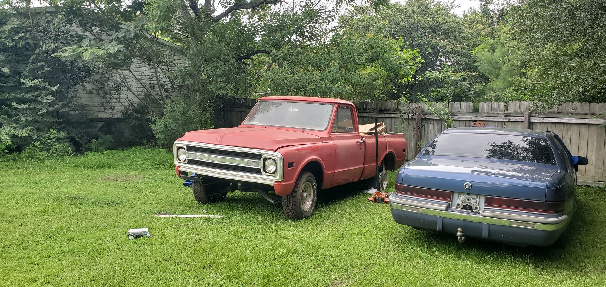

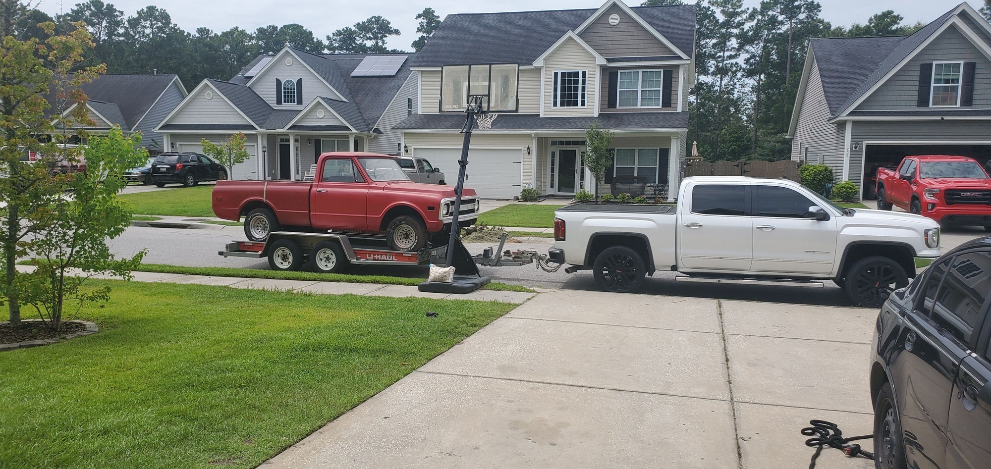

Here's the truck, the previous owner started to restore it 9 years ago and gave up it's been sitting for awhile. I bought it as a roller.

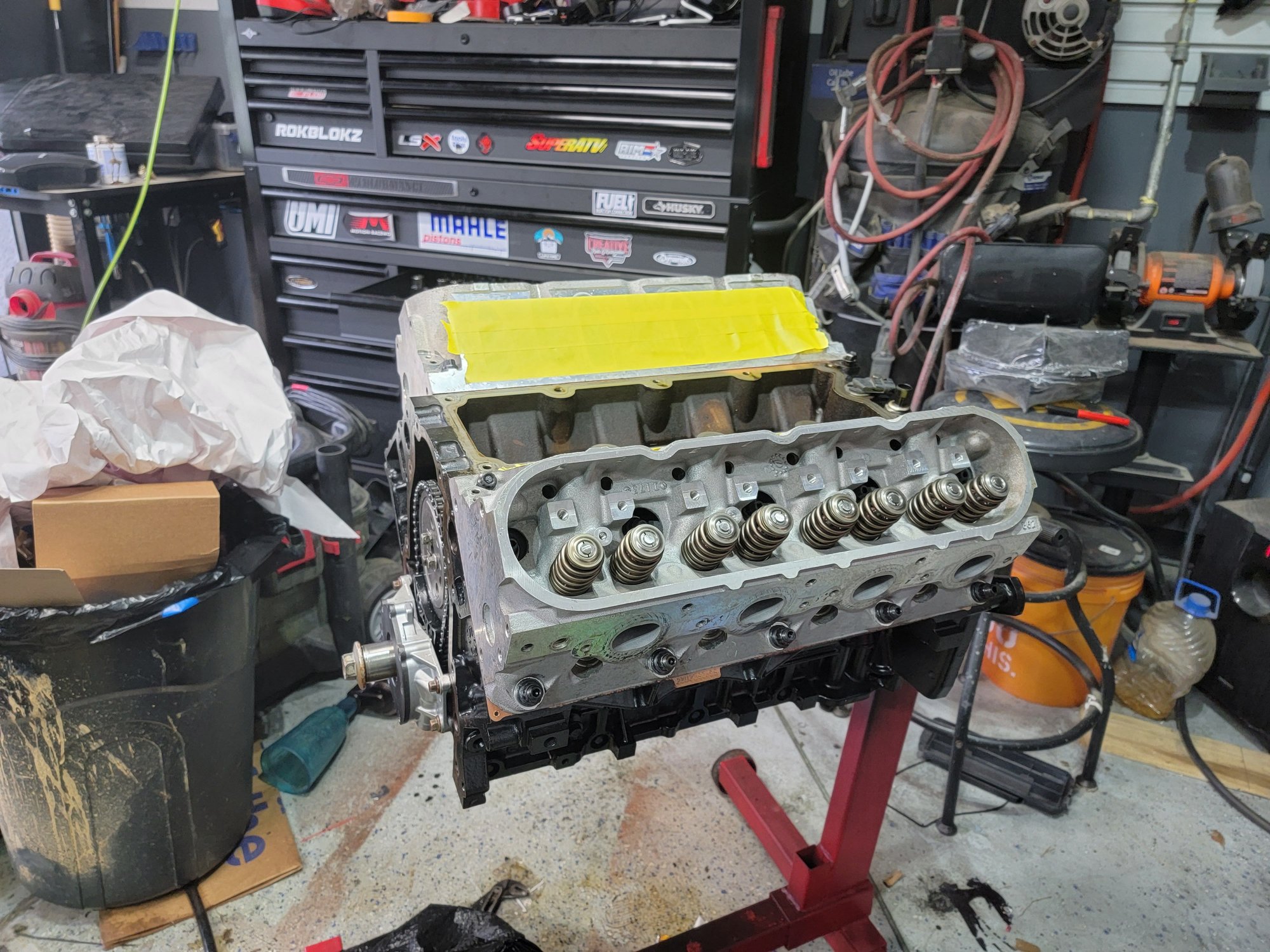

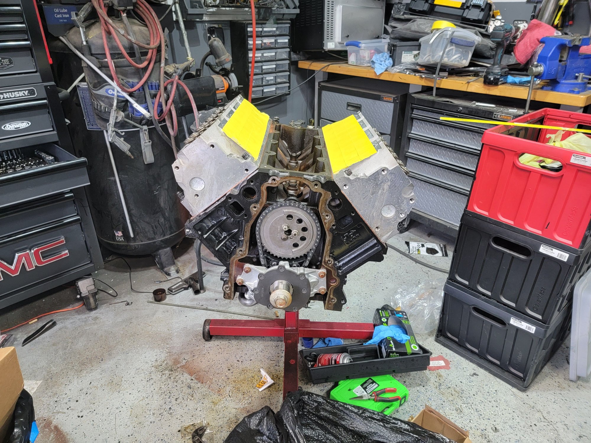

I made some progress with my project, I've decided to run the engine with the stock bottom end for now. I had the heads refreshed. I've installed the summit ghost cam, Chinese f body pan, oil pump lifters, etc. The plan now is to run a single turbo. I also picked up an 08 5.3 with 799 heads that had low oil pressure for a future forged build for this truck.

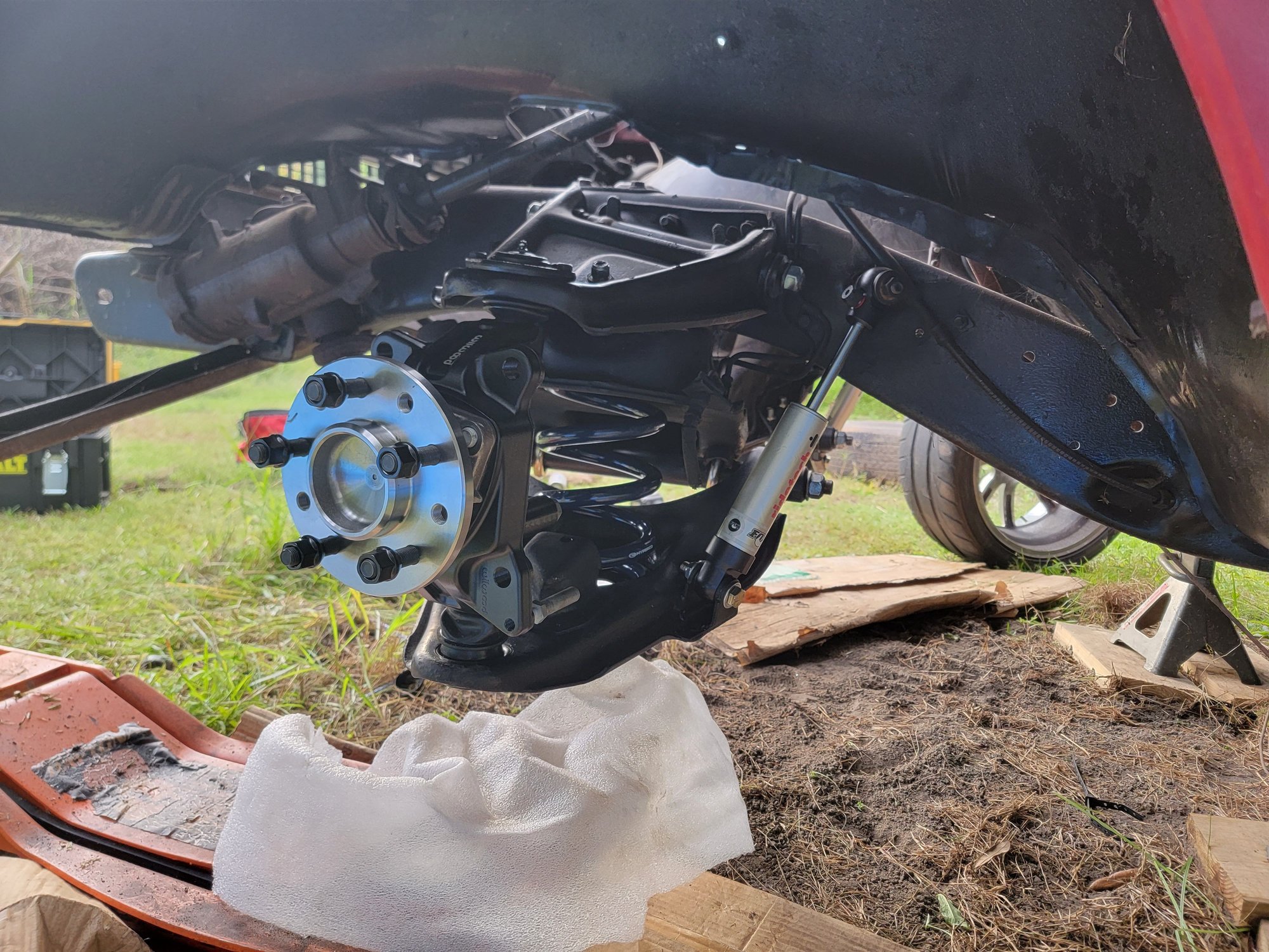

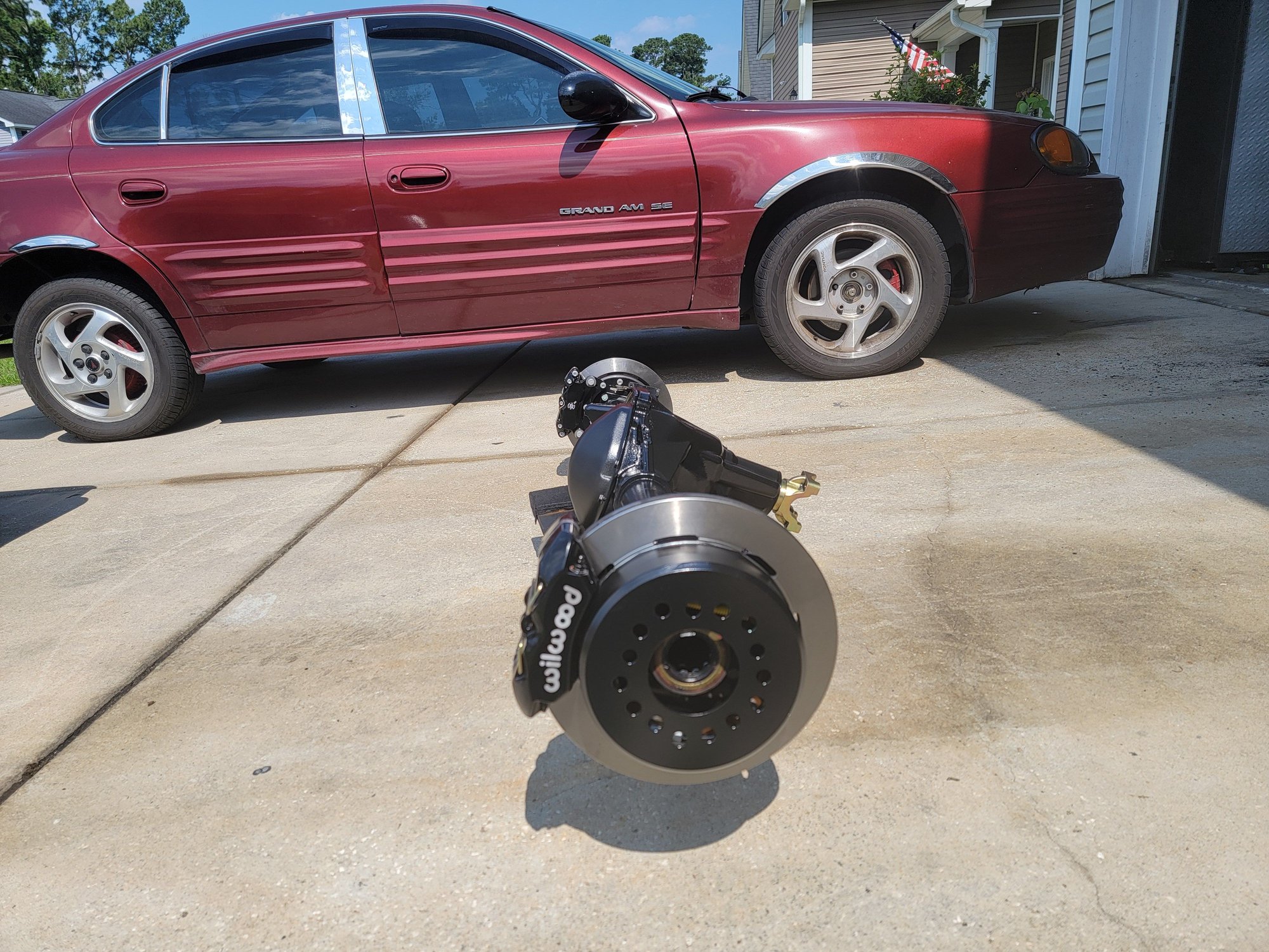

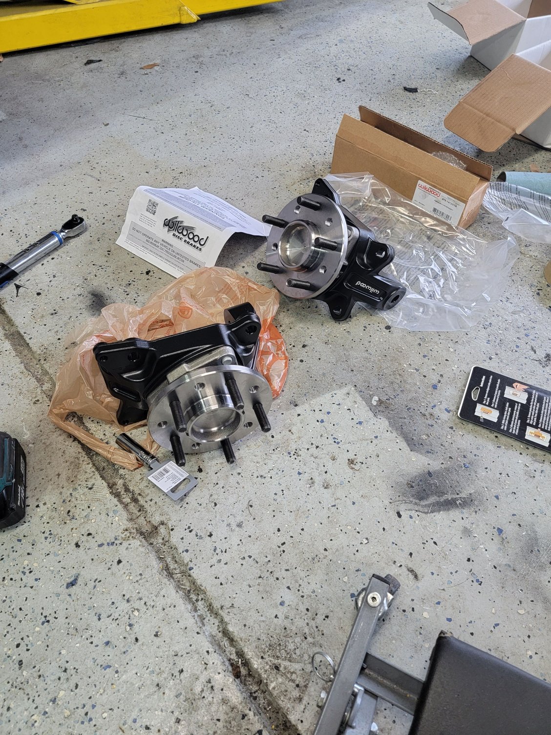

I've decided to tackle the chasis first. I plan on running the ridetech streetgrip kit. I had the stick 12bolt rear rebuilt with 3.42 gears and a posi. I also added willwood 4 piston disc brakes with the internal parking brakes. These rotors are drilled for different bolt patterns so I had my axles re drilled for the 5x 4.75 pattern. This will allow me to run the wheels from my Chevelle on this truck. I also went with the willwood modular drop spindles upfront which are also drilled for both patterns.

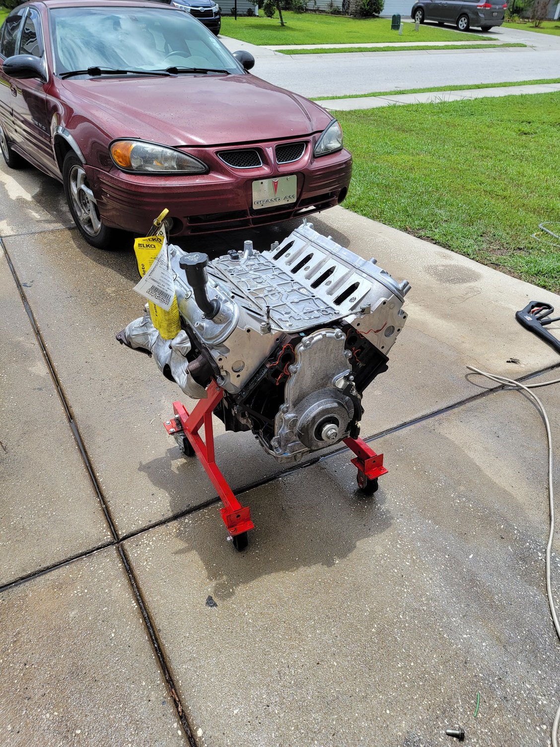

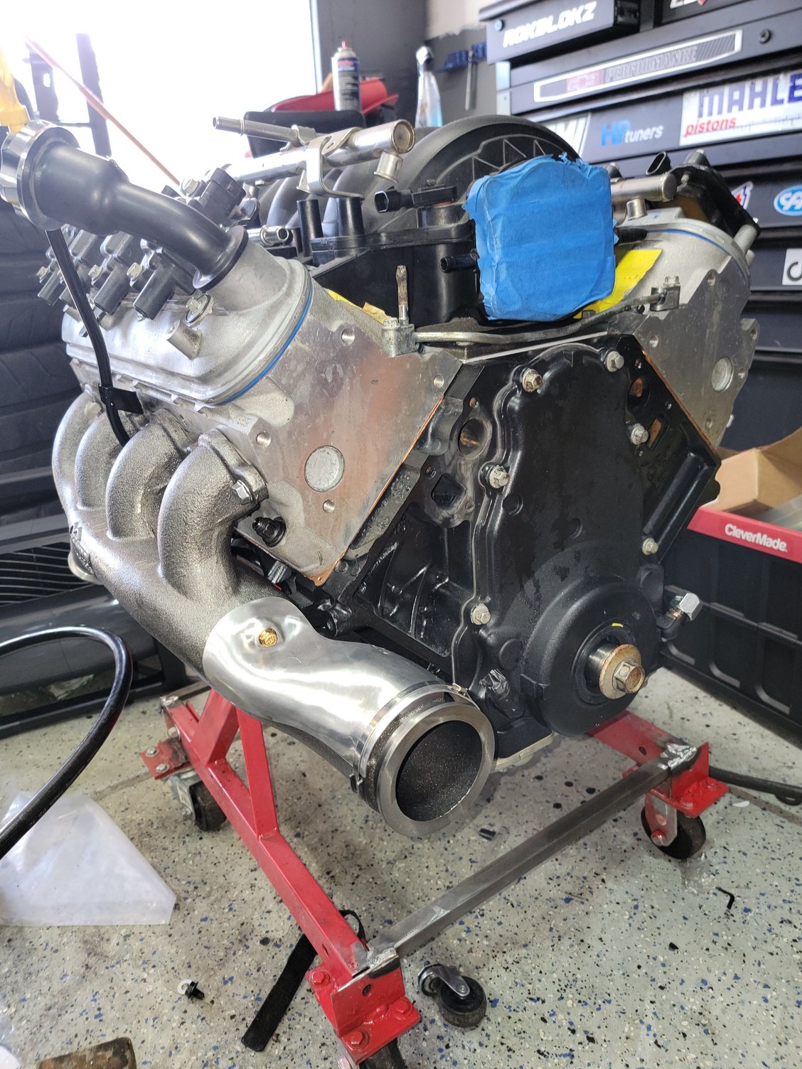

I have my high mileage lm7 ready to go. I left the engine internals stock, installed a knock off f-body oil pan, new oil pump, timing chain, lifters, summit 8715 ghost cam and spring package. LS9 head gaskets and Chinese head studs. I also bought the HOLLEY cast turbo manifolds.
The plan is to use this engine to get the truck up and running and build something better down the road.
I also picked up a gen 4 5.3 with 799 heads for $200. Engine was pulled because of low oil pressure but I only wanted it for the heads.

I started installing some of the suspension parts that I have. I went with the ridetech streetgrip system. I also converted the truck from 6 lug to a 5 x4.75 and 5x5 bolt pattern. I'll be using the car bolt pattern so that I can reuse the wheels that came off my Chevelle.

Your Chevelle had 2 different bolt patterns?
Old Oct 8, 2021 | 11:09 PM
lawrenq's Avatar
Joined: Jan 2009
Posts: 283
Likes: 47
From: Charleston, SC
No the truck is set up for two different patterns.
Old Oct 8, 2021 | 11:48 PM
Posts: 22,295
Likes: 3,617
So you can only use 2 of the Chevelle wheels...
Old Oct 9, 2021 | 04:03 AM
will69camaro's Avatar
Sex On Wheels
iTrader: (19)
Joined: Feb 2005
Posts: 2,549
Likes: 23
Chevelle is car bolt patter (5x4.75”). He had the rear axles drilled for 5x4.75” and the wilwood front spindles have both patterns. I’d think he could use them all…
Old Oct 9, 2021 | 10:51 AM
Posts: 22,295
Likes: 3,617
Ahh gotcha! The pic of the Wilwood hub shows it but I failed to notice!
Thank you!

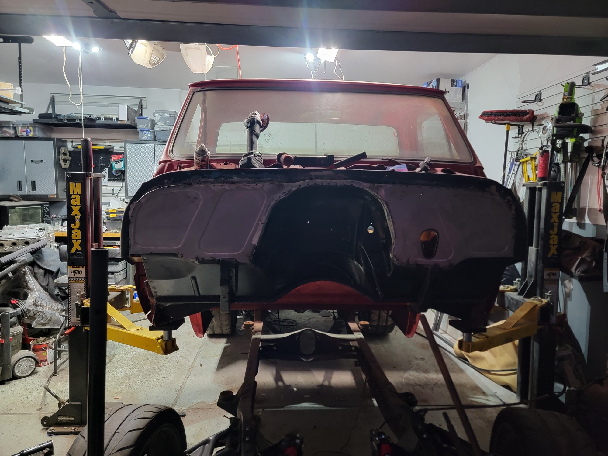

I've been working on the truck the last couple of weeks. Right now I have it completely stripped down to the cab. No surprise but I found more rust than I thought I would. So the cab is getting a new floor, cab corners, rockers, etc.
I stripped the frame and painted and finished installing the suspension. I'm debating on what to use a fuel tank. I jad my mind set on a boyds tank with a zl1 pump, but I'm unsure how that'll work with a turbo.

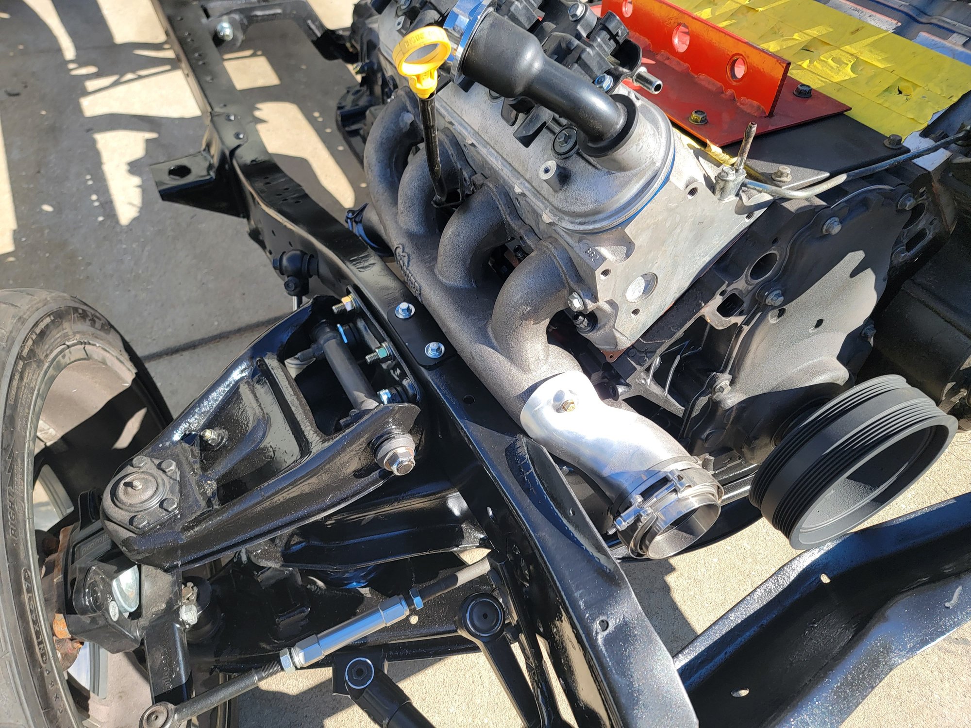

I'm using the holley engine mounts and turbo manifolds and everything clears but I'll have to trim the frame on the passenger side as it's too close to the header.

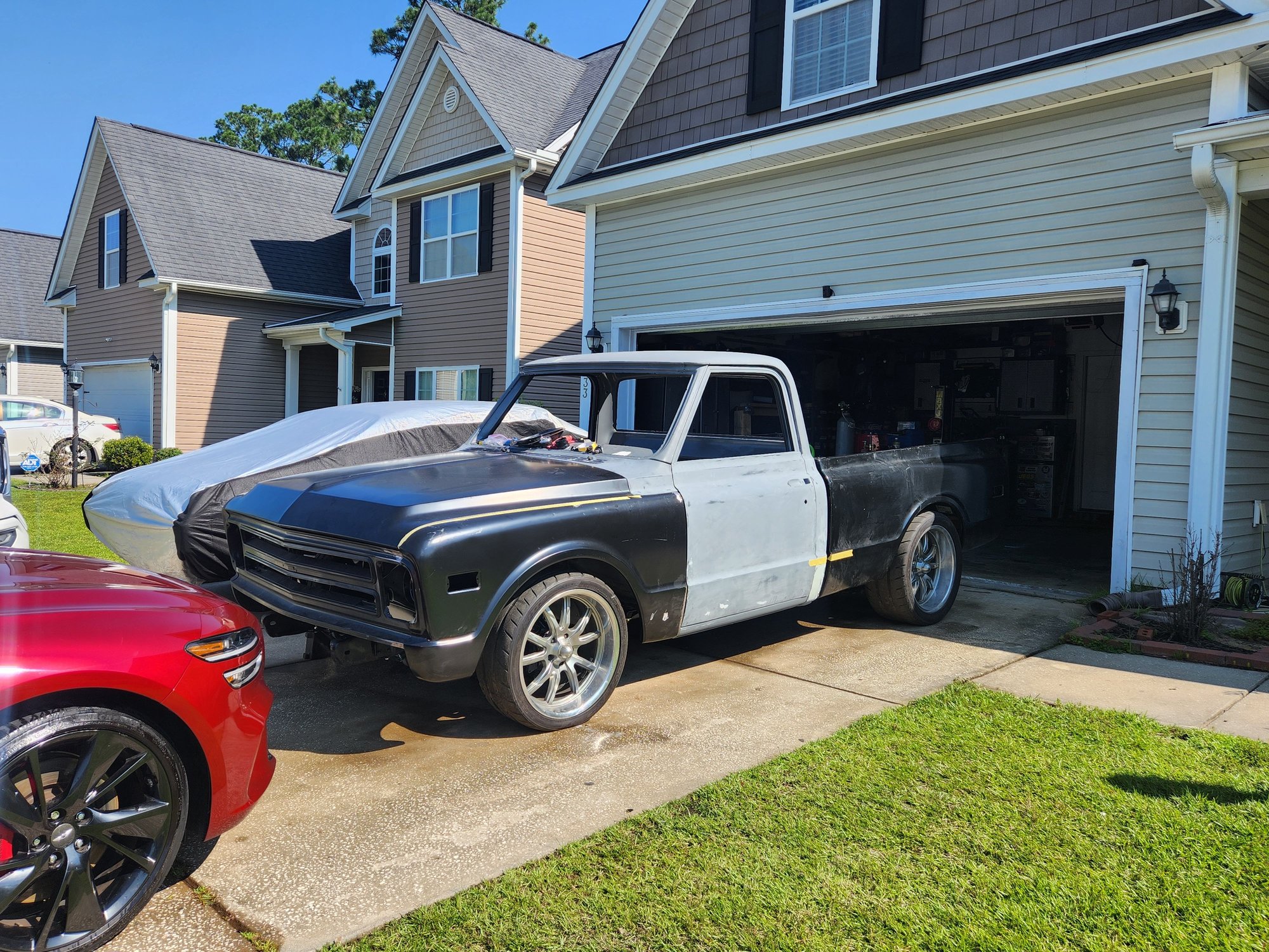

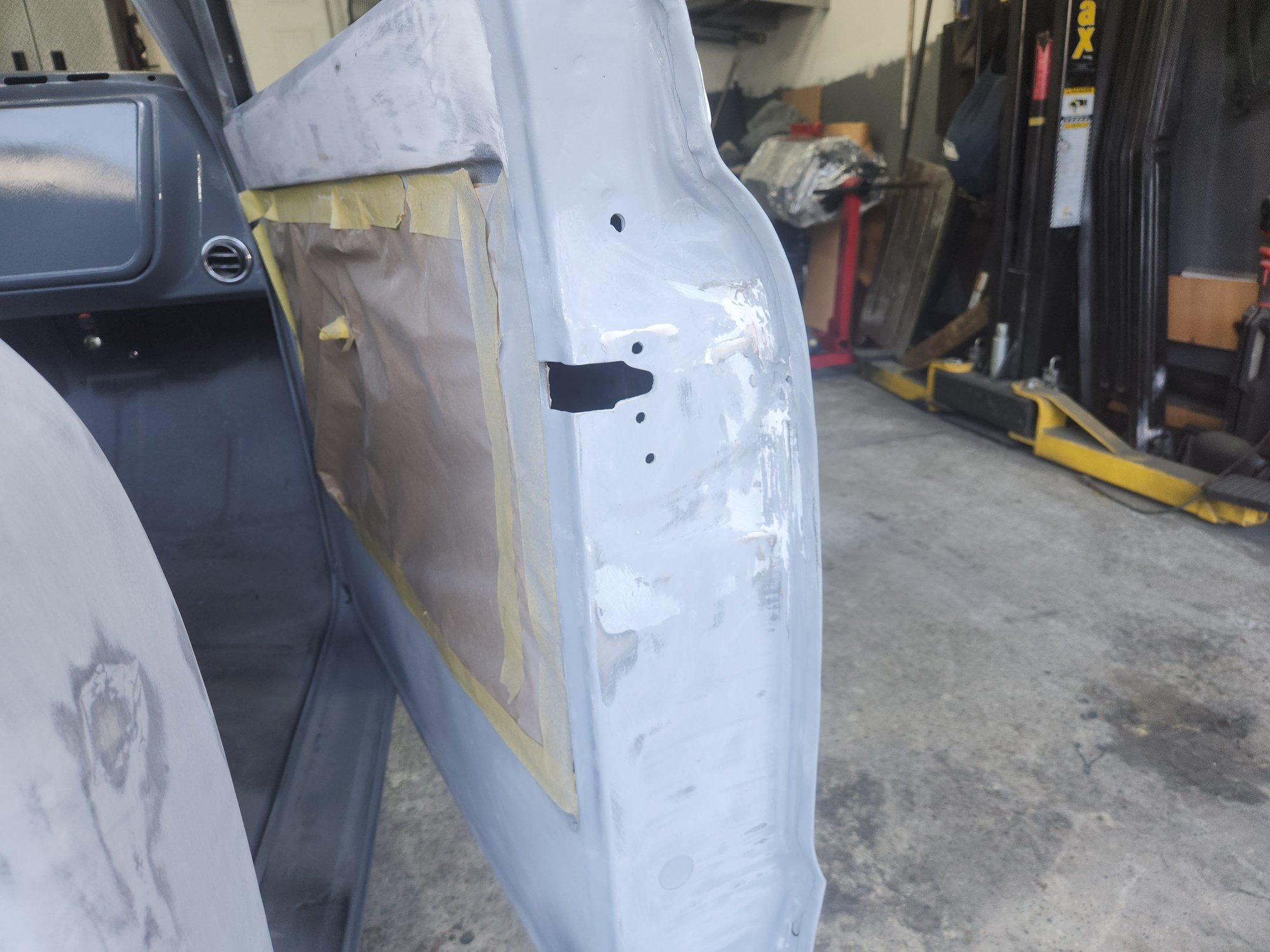

It's been awhile but most of the bodywork has been completed on the truck. I've converted the front end to a 68 and bought a whole new bed. I've also molded in the new style Altman style latches in the doors and installed Porterville hood hinges.
