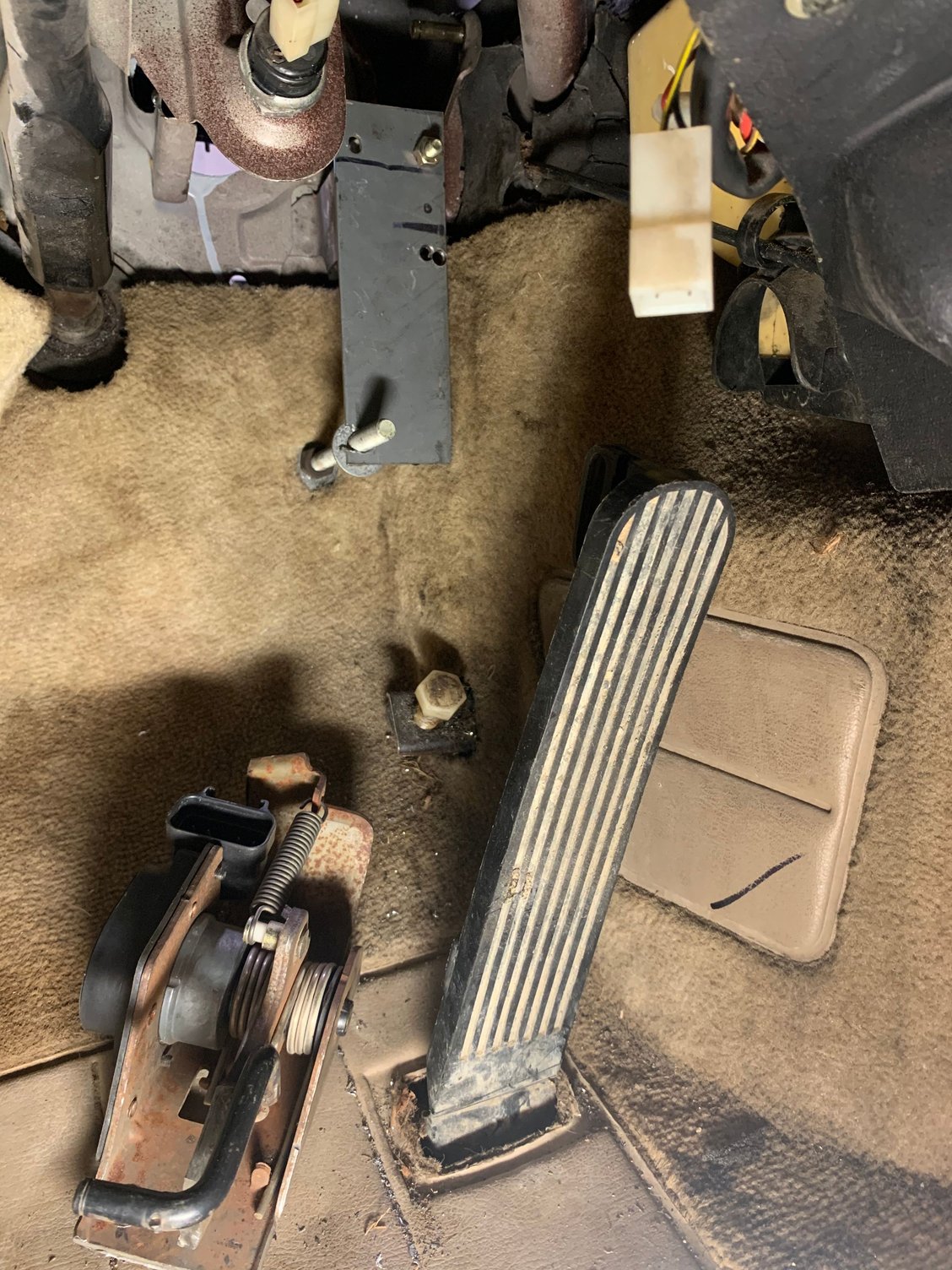

i made my own engine mounts, and poured the urethane bushings in them myself too. It was just easier than trying to get a bushing and cutting it down. Cheaper too. I welded on the stock aluminum pan for awhile, but it was turning into a headache trying to weld to the dirty aluminum. Did a little searching and figured out a 55-57 Chevy ls swap pan from kegs was very close to what I needed. So for $200 for a pan and pickup I figured I’d try it. It worked fine in my car, after using some heat and putting 2 small dents in the pan to clear the steering rack.

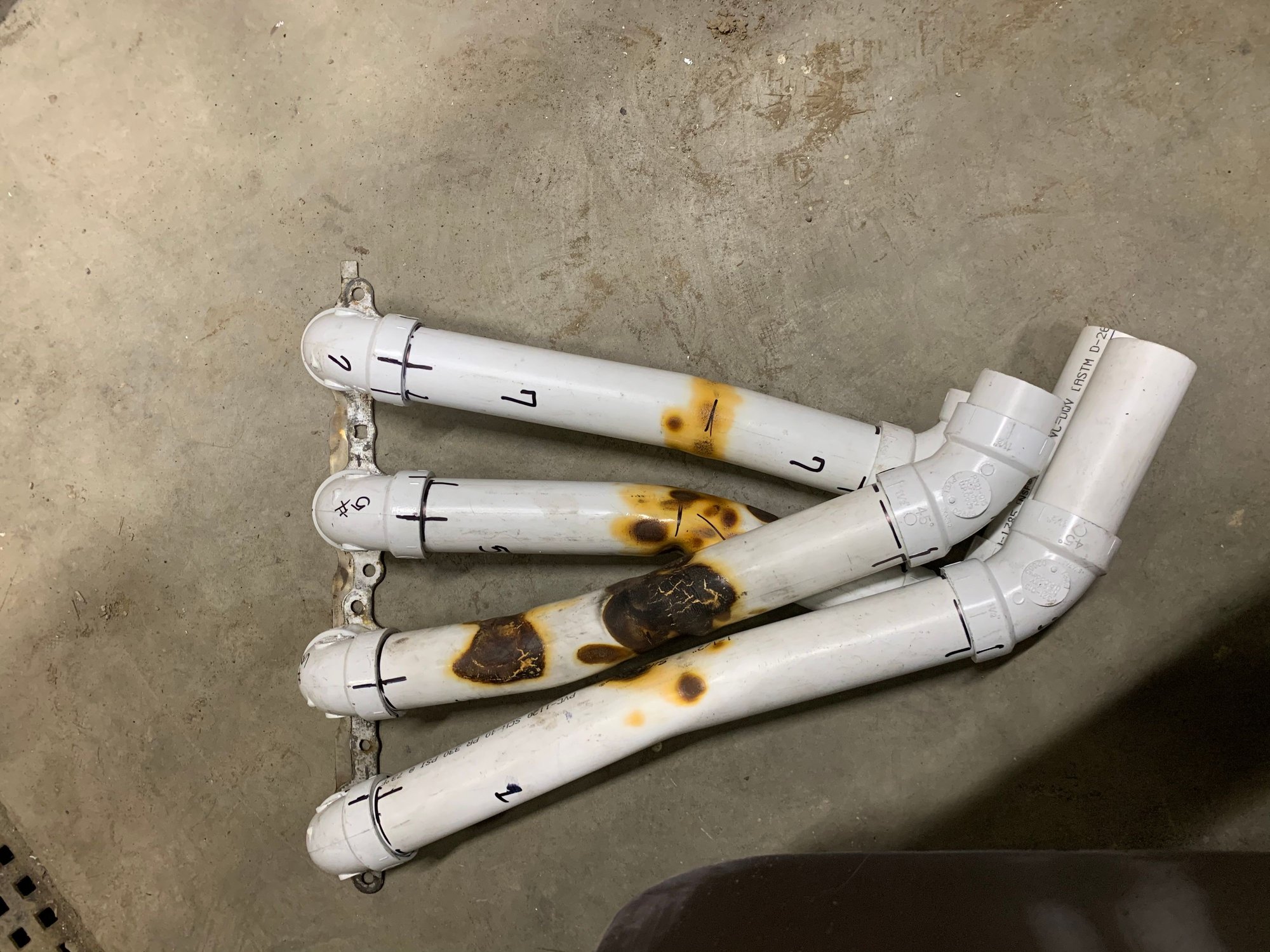

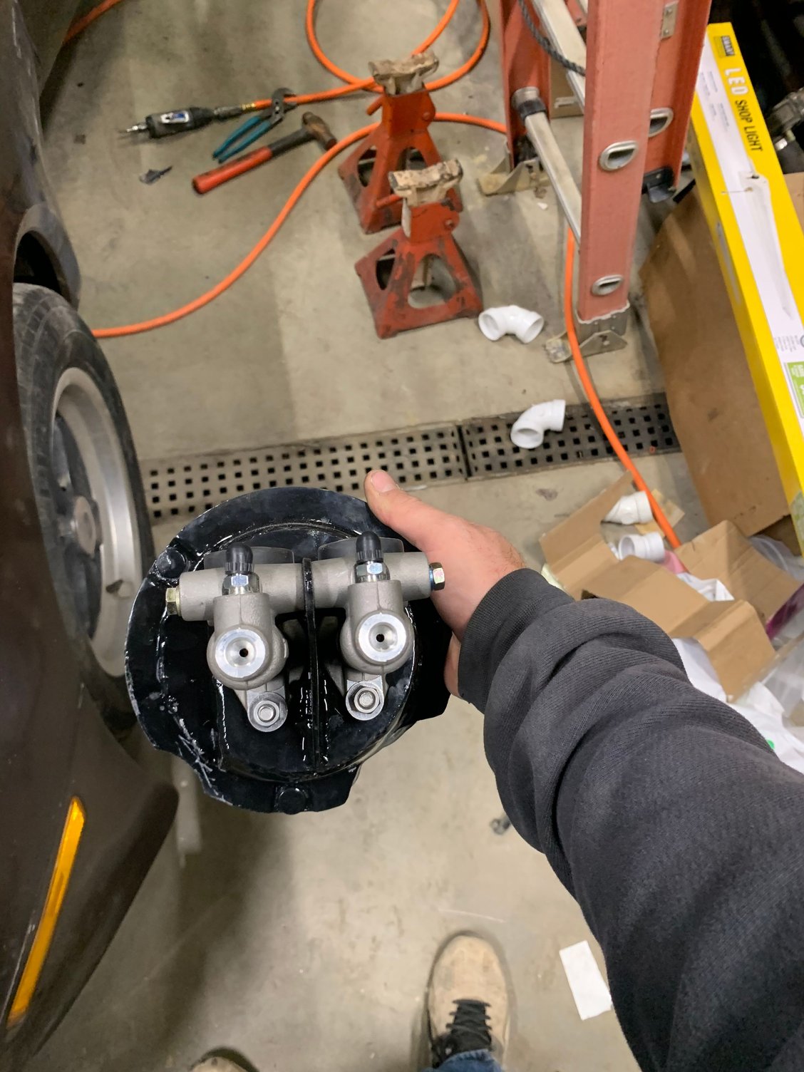

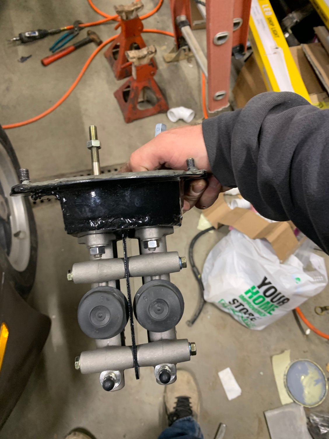

looks like the dual MC setup will just clear the engine, and I’ll be able to run the coils in the stock location. I picked up a handful of 1-1/2 pvc fittings today, I’m going to use that to mock up the headers.

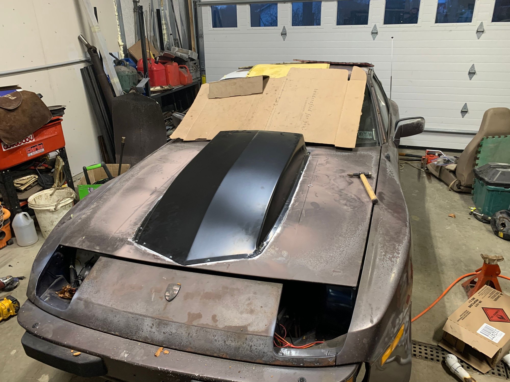

I’d like to run the truck intake, I’ve already shaved everything off of it except the MAP sensor, I will have to relocate it though. I know 99% of Porsche owners will hate this, but I’m going to put a cowl scoop on it. I got a 4” steel one on the way now. It still might not be enough to clear. If so I’ll get an aftermarket intake.

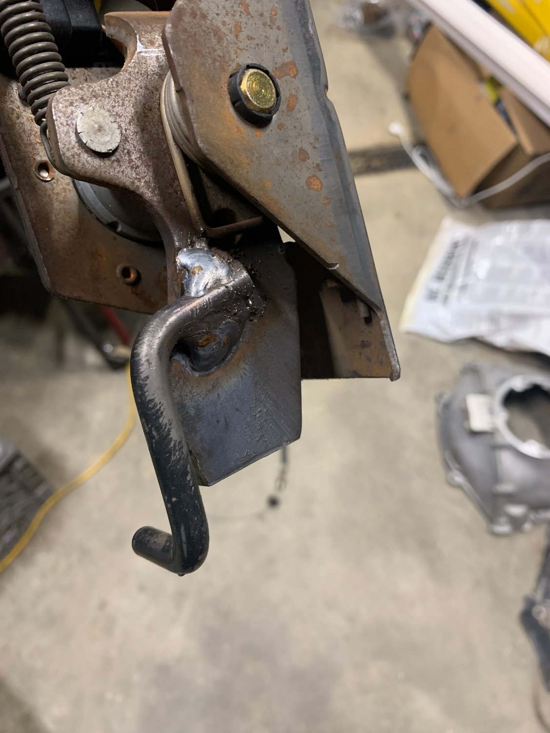

since the stock pedal was floor mounted, I decided to leave it in place. I made a plate to mount the GM pedal to, cut most of the pedal off and fitting the Porsche rod to the GM pedal.

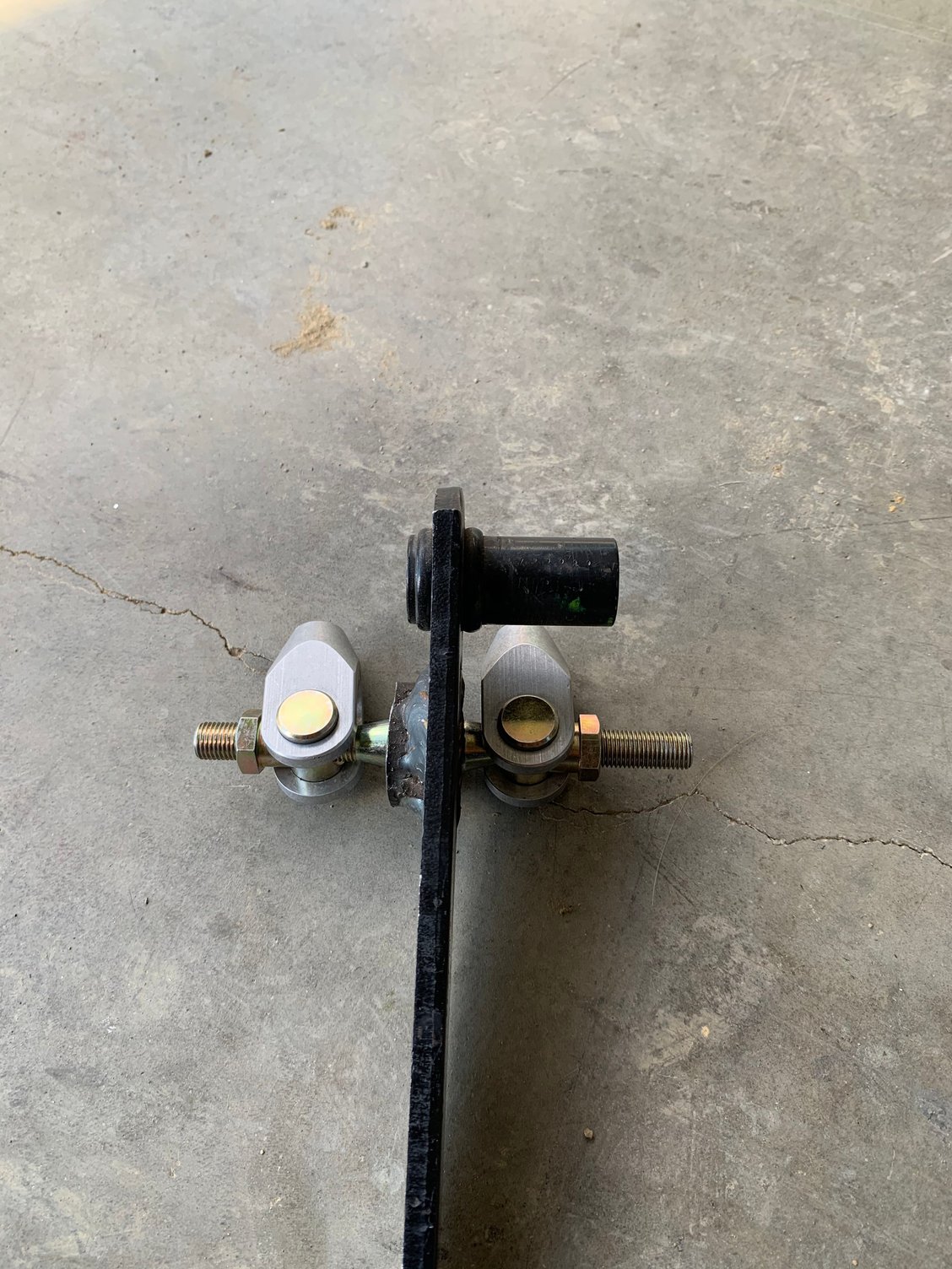

I fitted the balance bar to the brake pedal. It took some clearencing but it all clears. It will be awkward to adjust them, but once they are adjusted it won’t need messed with.
I thought about adding a 924 Turbo Scoop but in a different location. Most Porsche Owners already hate what we do anyways so who cares?

Exactly, if I wasn’t doing all this to this car, it would of ended up in a field rotting away. Well they are really going to love this hahaha.

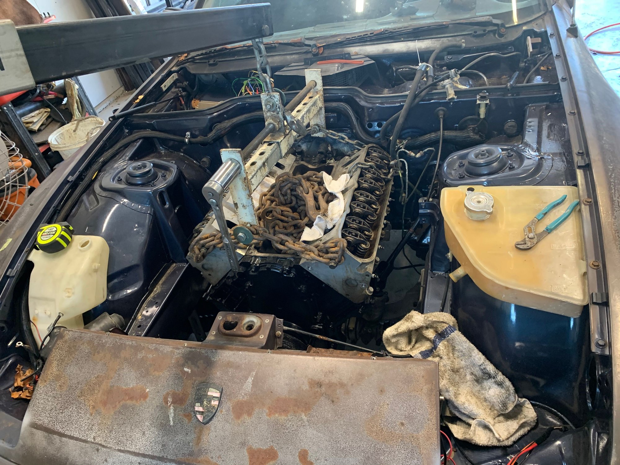

started making the mock up headers. 1-7/8 primaries are definitely too big for the current engine, but will wirk well for future plans.

I got the master cylinders fitted and pulled them to build the headers. Trying to button up small details. The factory VDO oil pressure sender is a challenge. Being 18mm I’m having a tough time fitting where to place it. It may go in the remote oil filter adapter.
