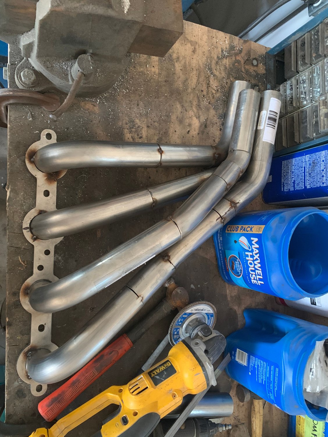

Got the tube for my headers, this is a first for me but I’m eager to dig in. They won’t be perfect, but you got to start somewhere. I need to get a dual regulator for my argon bottle so I can purge these as I weld them.

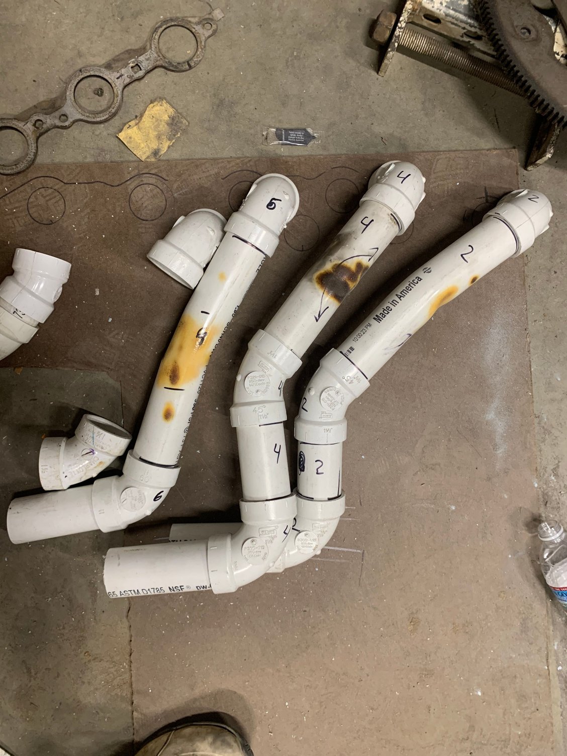

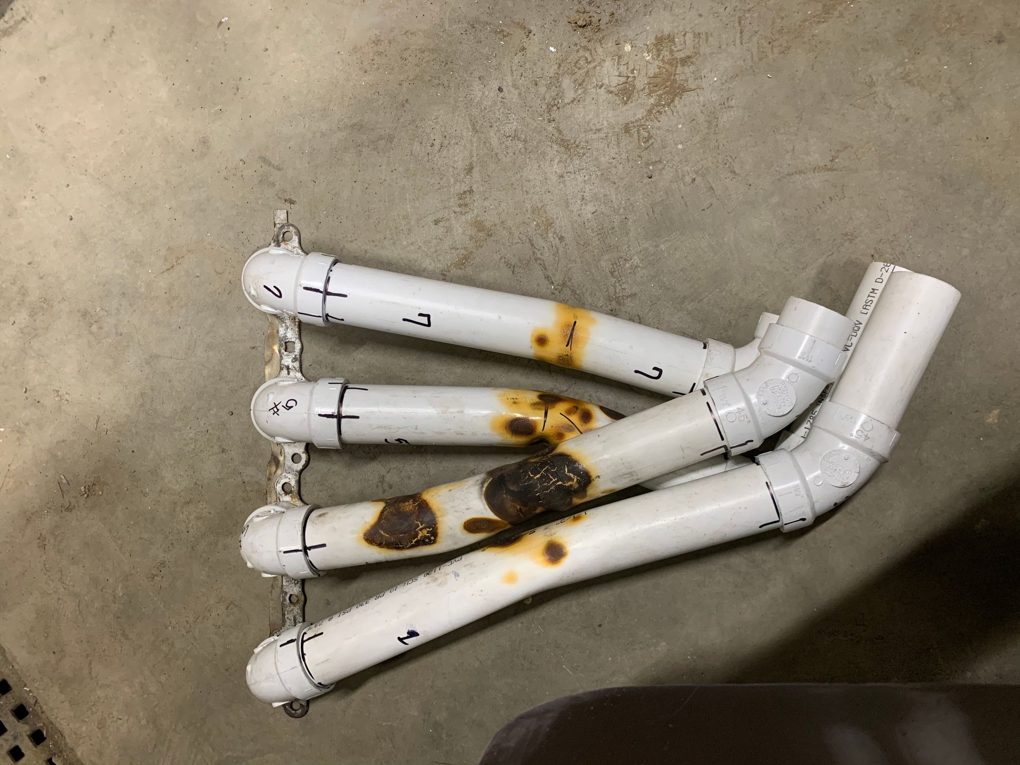

Rmchevelle, I just made mock ups out of PVC and purchased bends from Columbia River Mandrel and Summit (Stainlessworks).
This is my first time so I am sure these aren’t ideal, but you got to start somewhere. Hopefully the next set I build for whatever project will be a little

That looks pretty good to me! Once fit is good - break tacks at the flange, weld up the tubes and then re-attach to flange?

Iamblamb, this one may not be as tight as your project. This header has to wrap around the steering shaft and is kinda odd. The 1-1/2” PVC I used is larger than the 1.75” stainless tube I am using, but I’d rather go big for mock up and smaller for the end product.
Michael, your exactly right. I’m tacking it all, and I’ll cut the welds on the flange so I can weld up the primaries separately. I honestly haven’t done enough research on how to build headers, I’m just flying by the seat of my pants. I do know I need to purge the inside with argon when I finish weld the seams, so I’m buying a dual regulator for my argon bottle.

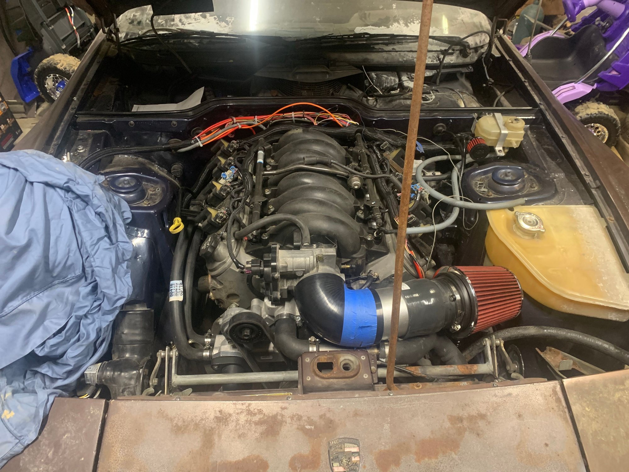

Got everything in and tried starting today. I used PCMhammer and TunerPro to write to the PCM. I used a common OS Id 7603. I removed vats, EVAP stuff, selected manual trans, E fan settings and removed a few MILs. It wrote fine and seemed to be good. I used the stock harness modified per LT1swap.com, and a 18 cuircut fuse/relay panel.
Had a few small hiccups but I was able to get it started. Before starting I had 3 DTCs
P0452 - EVAP, I will need to remove it from the tune
U0107 - lost communication with TAC
I checked Voltage and ground at TAC, and checked grounds at TB. All were good. With the key on the TB would move with pedal movement. After starting car it idled for about 1 min then I shut it off. Giving the car throttle the engine stumbled and then went back to idle. Tried again and it did nothing but idle.
Checked DTCs After that run and had 16 codes.
7 were EVAP and rear O2 sensor related so I will take care of them.
3 were MAF related, MAF was connected but not it in the intake air flow path. That’s human error on my part.
The codes I have to correct
P1516 TAC position performance, through my research I need to ring out all the control wires from TB to TAC.
Possible causes,
no VSS
TCC Brake Switch not connected to anything. I thought it would make only effect converter lock up while car is moving?
P0200 Injector circuit malfunction.
Things to check,
12v at each injector, ohm injectors, check circuits with noid light.
P0230 FP Primary circuit malfunction.
Causes,
Bad PCM? Research didn’t give me much info.
I cleared the codes and tried to start the car. No start, it will fire off for a second on starting fluid. FP is 58 at the rail. As I type this it really sounds like a voltage problem to the injectors.
Everything was pulled from the same running truck. I went through the harness and repaired anything that appeared to be faulty. Any connection or splice I made was with bare butt splices, crimped soldered and heat shrunk. Not saying I’m perfect but I really tried to make all connections good.
It seems like DBW is problematic with swaps sometimes. I am considering going to DBC. I have a DBC PCM and TB. I’d honestly rather not after going through the trouble to install this.
Sorry for the novel, just want to be detailed in case someone has some input. Any help or advice would be greatly appreciated!

Problem Solved:
Disabled everything abuse management related in the Bin file.
