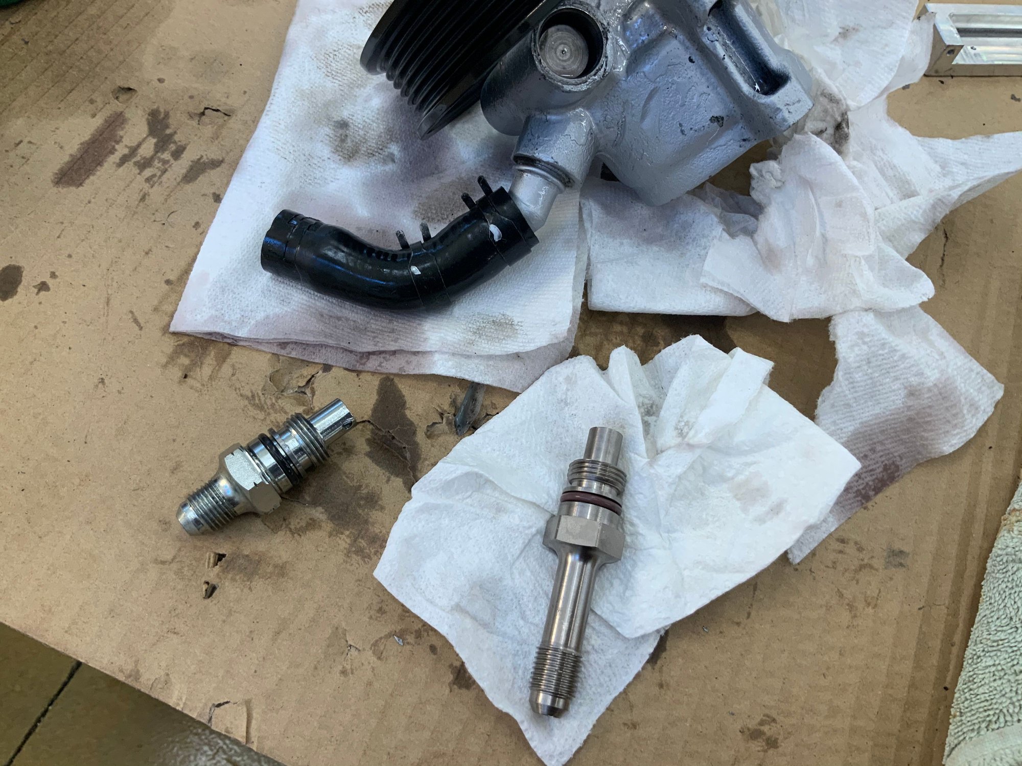

Am replacing my t-bird style rack, new one says it’s set to run off gm PS pump. I had installed the flow reducer originally but cannot find the OE valve parts. I know I saved the stuff, but how it works, when you need it again, it’s gone.
My question is, this is a corvette PS pump and I have a 2006 GTO PS pump, can I use the internals and fitting from the GTO pump to put things back to original?
Thanks!
Thanks!
Yes, you can.

Got the pump out and removed the aftermarket flow control. It’s been so long since I put this in I can’t remember if it’s just the threaded valve that was replaced or were any parts behind it changed?
Am going back to stack with new high flow rack. I am also using the Earls 6an extension fitting.
The only internal difference is the diameter of the internal orifice which makes me think this is the flow control.
does this makes sense?
