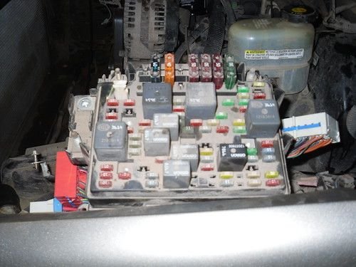

These are so simple to get all the harness stuff you need in one shot.
Fuse box...
Black connector from the middle of the fuse box. (Bottom side.)

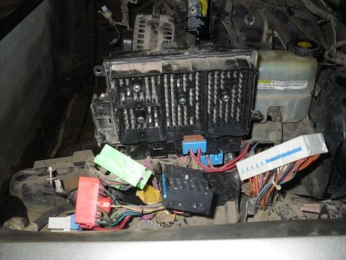

(Black connector in the middle)

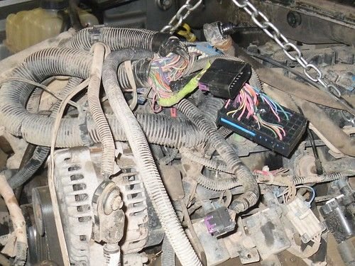

This is the main one that will go with the harness to the engine. It and the two that go to the ECM. (There are a couple of smaller ones also. They are quite obvious when you get to them.)
Orange, green and white stay with vehicle...

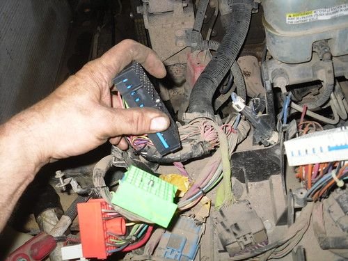

Black one in my hand is one you want...
Here's a pic of the three connectors you will end up with...very simple.
