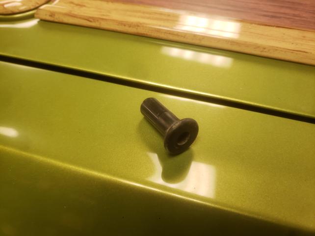

I am changing my brake system to hydroboost. On vehicles with hydroboost the port where the vacuum booster would normally goes gets a plug. I used to know the GM part number but can't find it anymore.
Does anyone have the part number for the plug that goes in that port? Or have one to sell?

Never seen just the plug from GM. Only the vacuum port nipple.
ICT Billet makes one.

Old Nov 28, 2020 | 03:59 PM
Thealien's Avatar
Joined: Oct 2009
Posts: 219
This is the GM part.
And the ICT billet one.
ICT BILLET

ICT Billet sells a billet aluminum one for $15.
I had a part number for the plug years ago, but now I can't find it anywhere.

Originally Posted by AwesomeAuto
ICT Billet sells a billet aluminum one for $15..
And I linked to the ICT built one in Post number four in case anyone else is looking.
