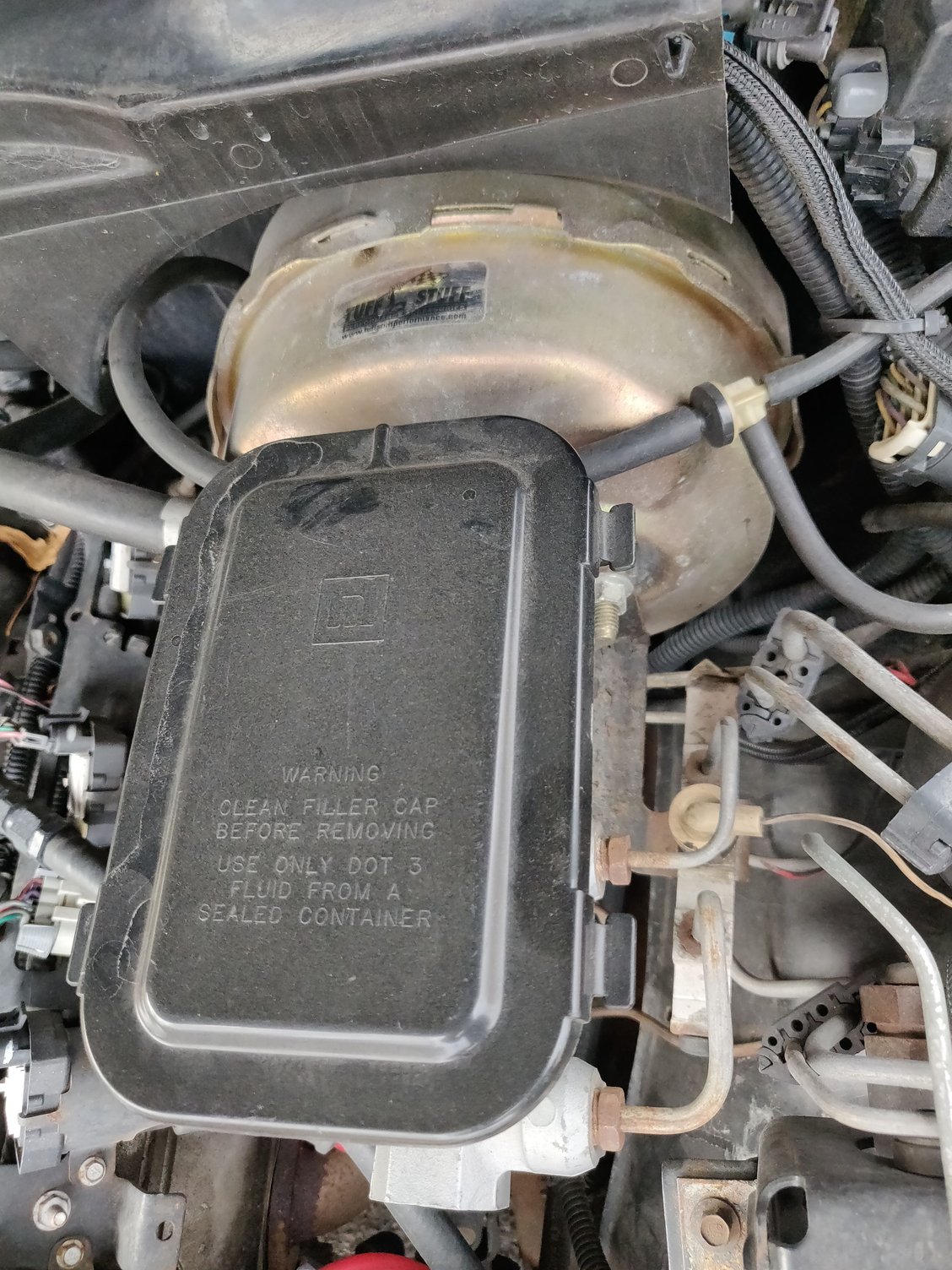

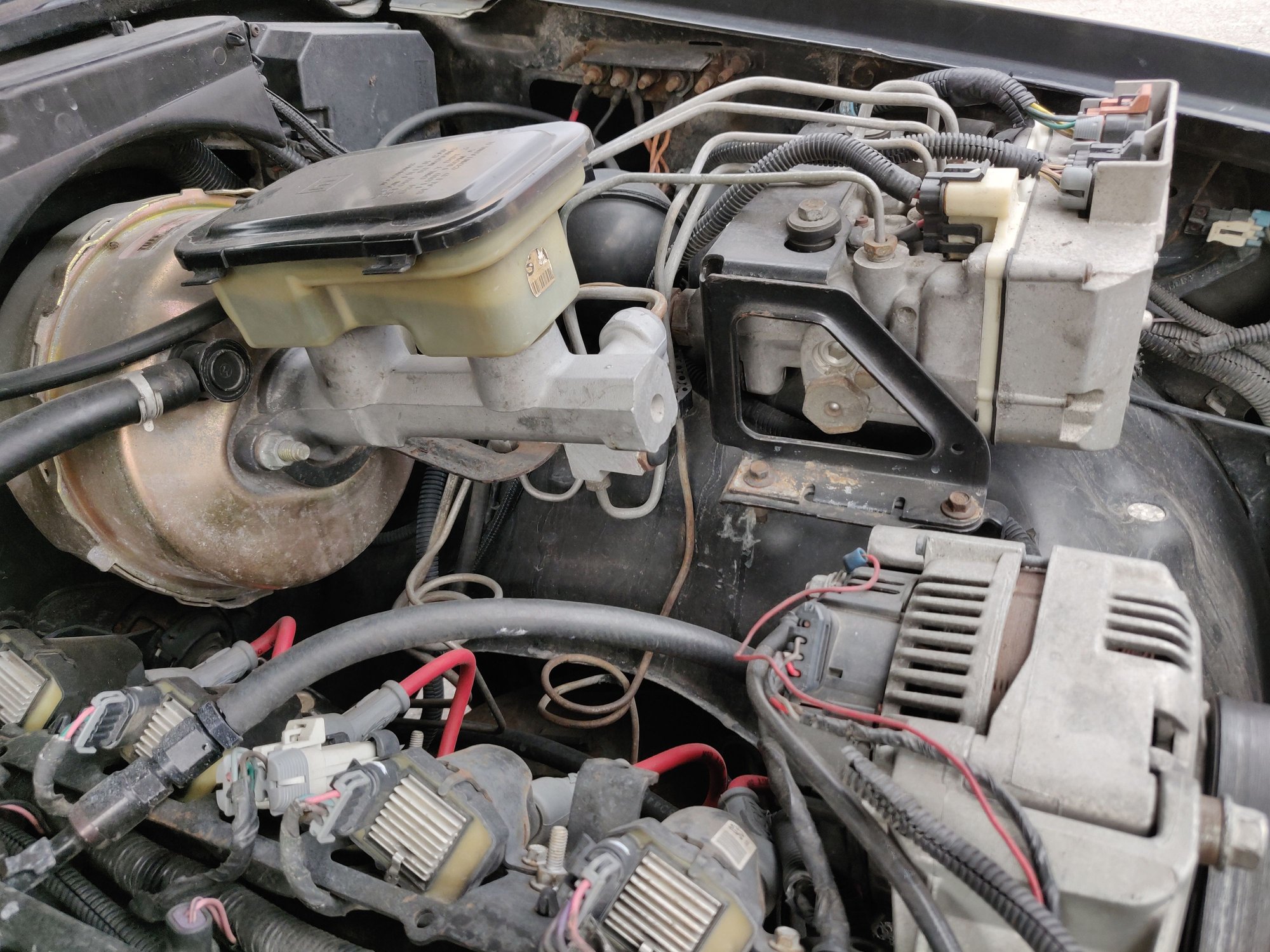

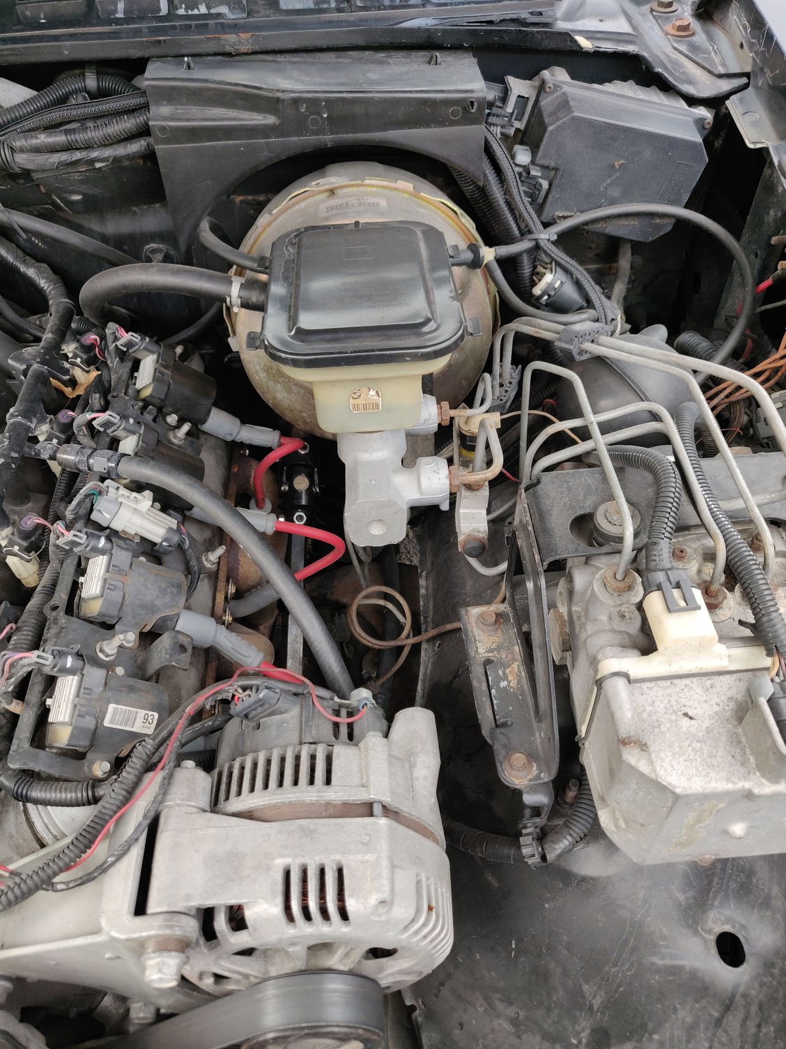

I have a 8" Tuff stuff booster in my 94 s10. I swapped my truck almost 9 years ago. I keep saying I am swapping to hydro, but still haven't.
I believe it's 2223NB, but not positive.
I researched, and if I remember correctly the c3 Corvette had one that would also fit and I believe the Fiero. I'm not sure if your just looking for a junkyard solution or what.

Here are a couple. Jared usually knows what will or won't work, especially on a s10. Mines been done almost 9 years. I bought his harness way back then. It's ugly, but it's literally a daily driver, snow, rain and sunshine.

Thanks for the pics. That looks like it will clear without a problem.

The coils aren't the problem. Corvette coils and brackets. The issue is the pin that the cover snaps into. Might have 1/8 between the pin and the booster.

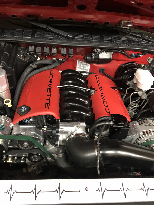

Well...I didn't want to hit and run. The Tuff Stuff 8" booster solved a couple of problems. The fuel rail covers fit and clear perfectly. I developed a vibration that I was having trouble tracking down. I thought it was a transmission problem so I took it to a shop. I got a geared that worked on it...trans was fine...nothing loose. For whatever reason, the booster was causing the vibration when stopping.

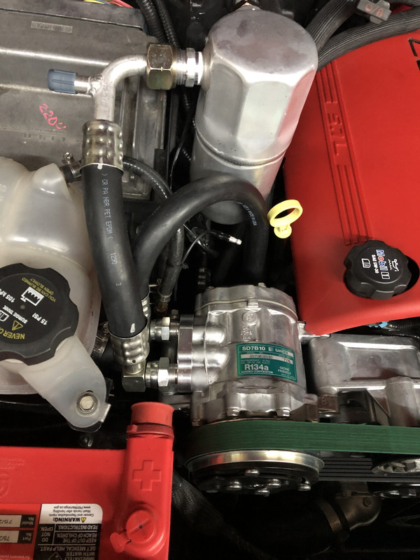

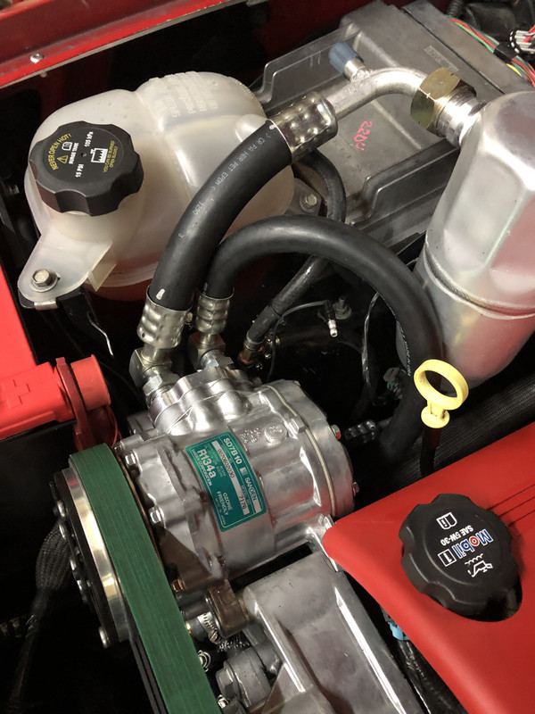

I'd love to see pics of your a/c. I'm still hoping to have a turbo under the hood, and a/c. I'm going to swap out the factory box for a vintage air mini, because as you said, there's not a lot of room under the hood of a s10. It fills up fast.

I'll get some pics in a day or so. I'm pre-painting some siding. I'd rather do its while it's horizontal on the ground instead of 2 stories up. You're right...not much extra real estate under the hood. Still not happy with my ac yet. I'm going to call Cold Hose and see about some more custom fittings.

Here's the pics..
