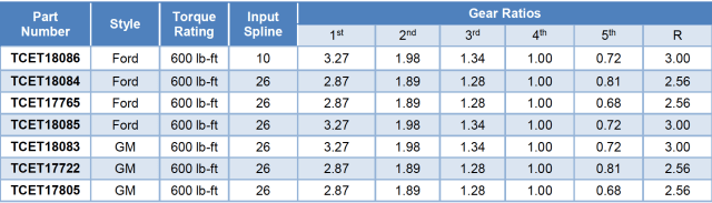

Michael,
I agree on all accounts. Here are the available TKX part numbers:
Mine is the 17805 variant.
Andrew
