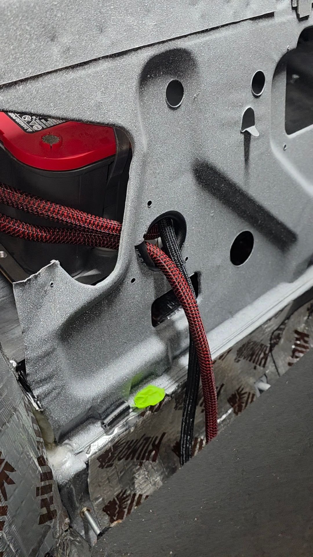

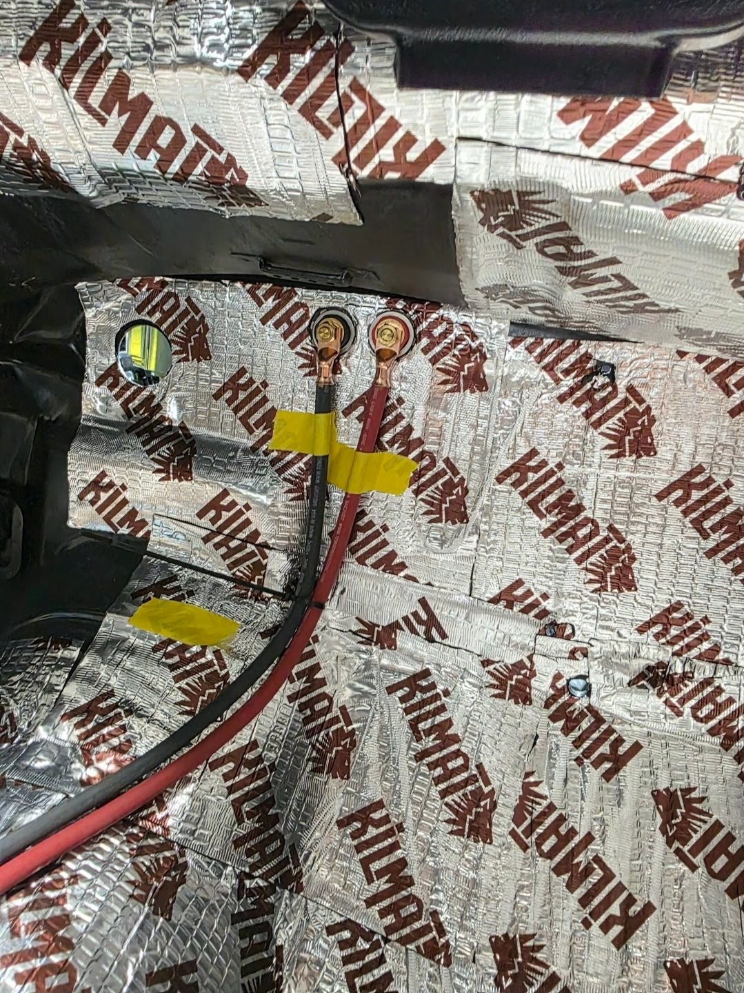

For the positive pass through, you want it fairly close to the starter. Because that's where it will connect.
I wouldn't put the main harness down low. You're asking for water intrusion. I have a 2" hole in the firewall, behind the engine.
Andrew
Ok great. I will order the 2/0 wire, start wiring the Terminator X Max, prime engine, and start laying down sound deadening.

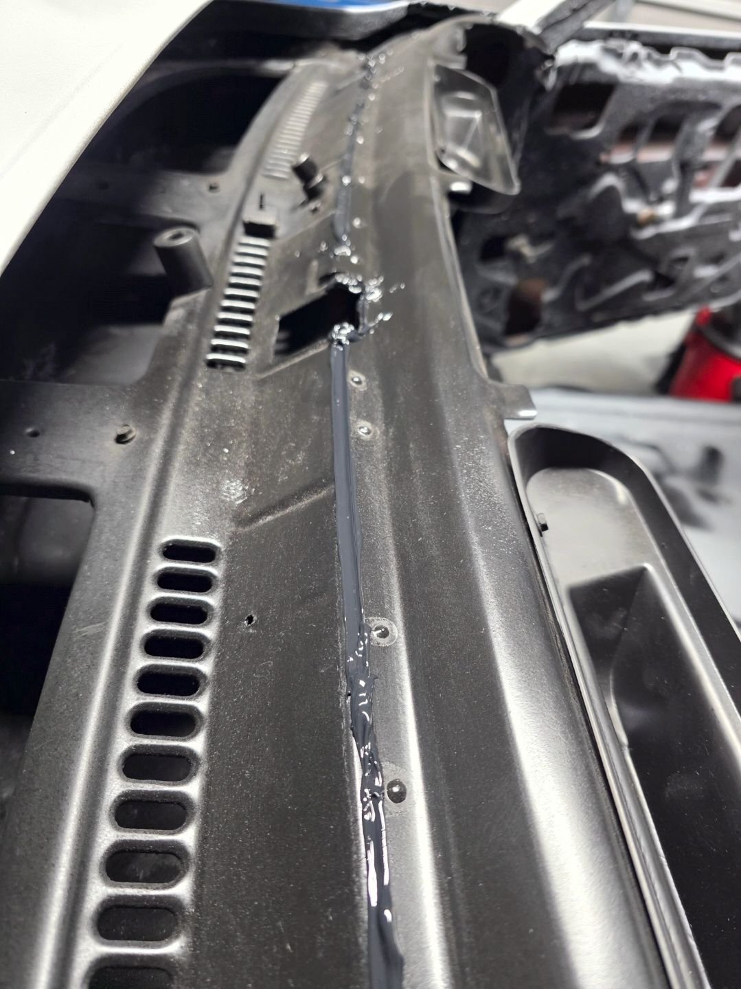

Well I'm about to get this wiring in... I am using the Terminator X Max, AAW Highway 22 plus and putting in some sound dampening. My A2W Ice Tank came in also. The HWY 22 will be trunk mounted. Hopefully the wires are long enough. Also performed some seam sealing on the build.

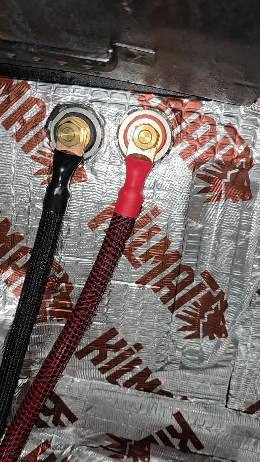

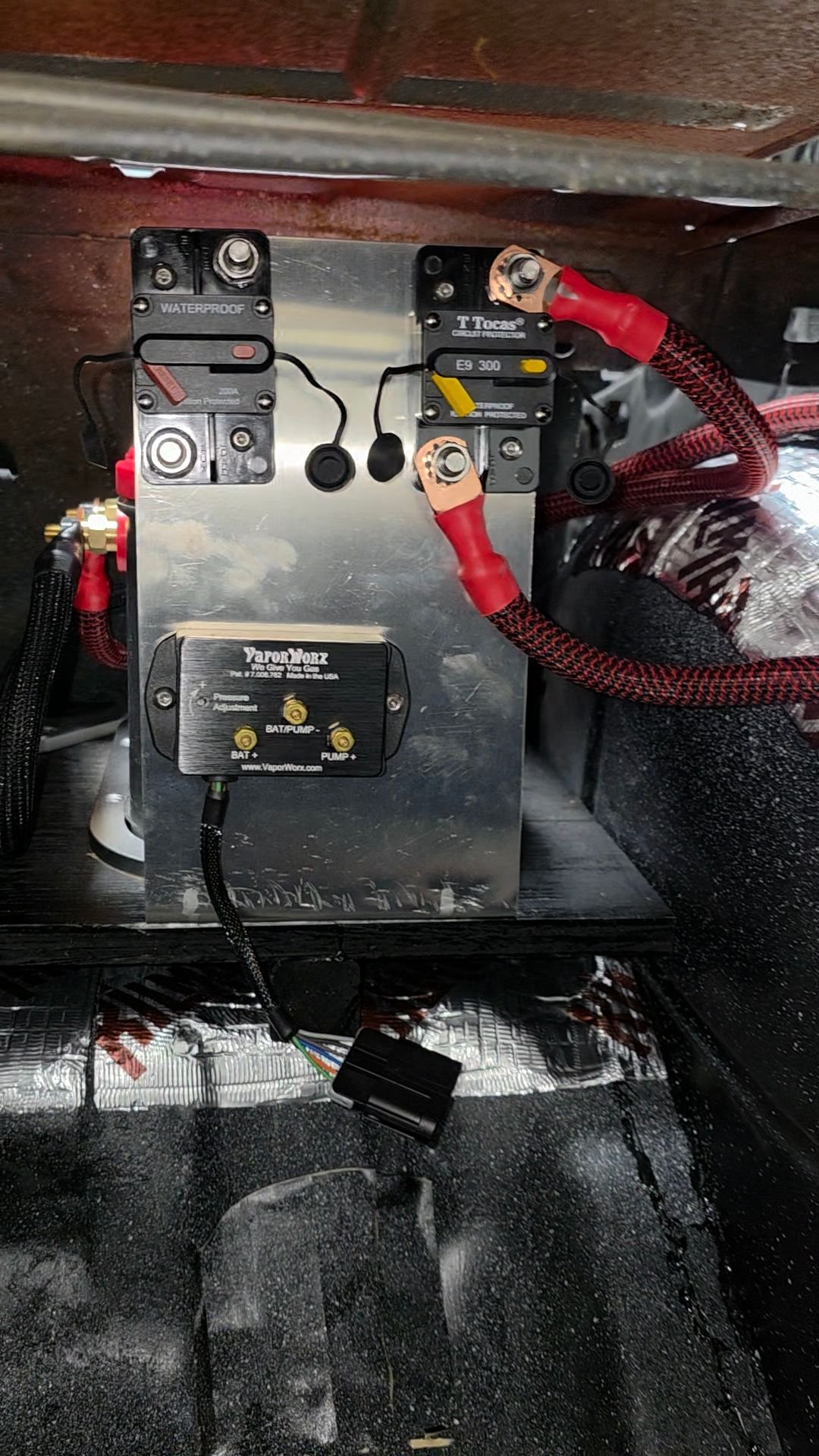

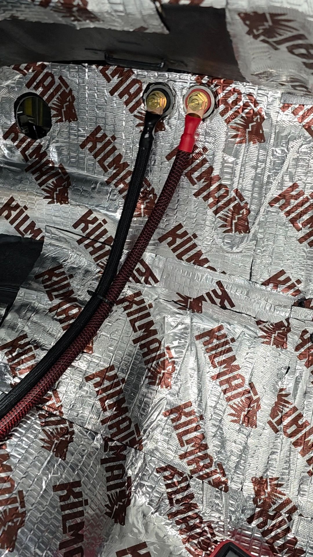

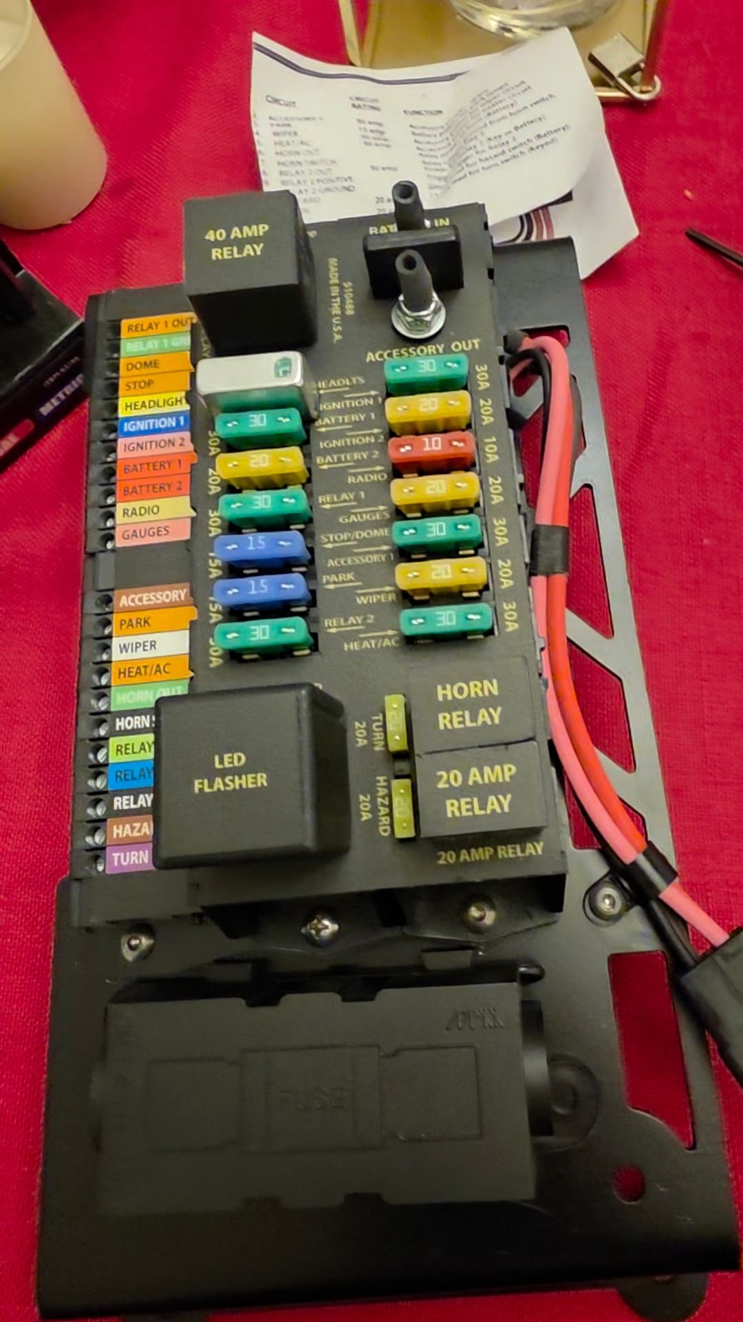

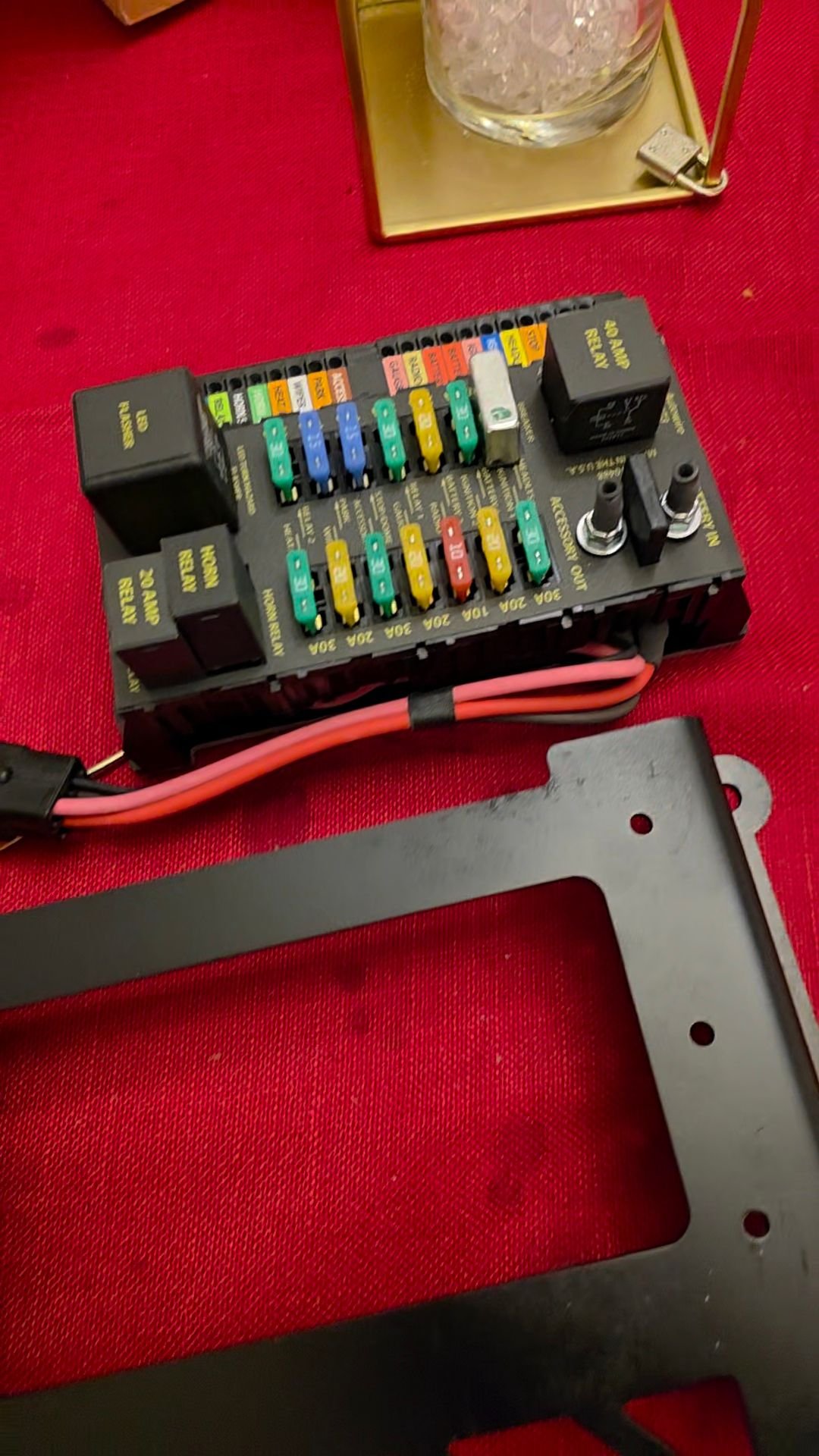

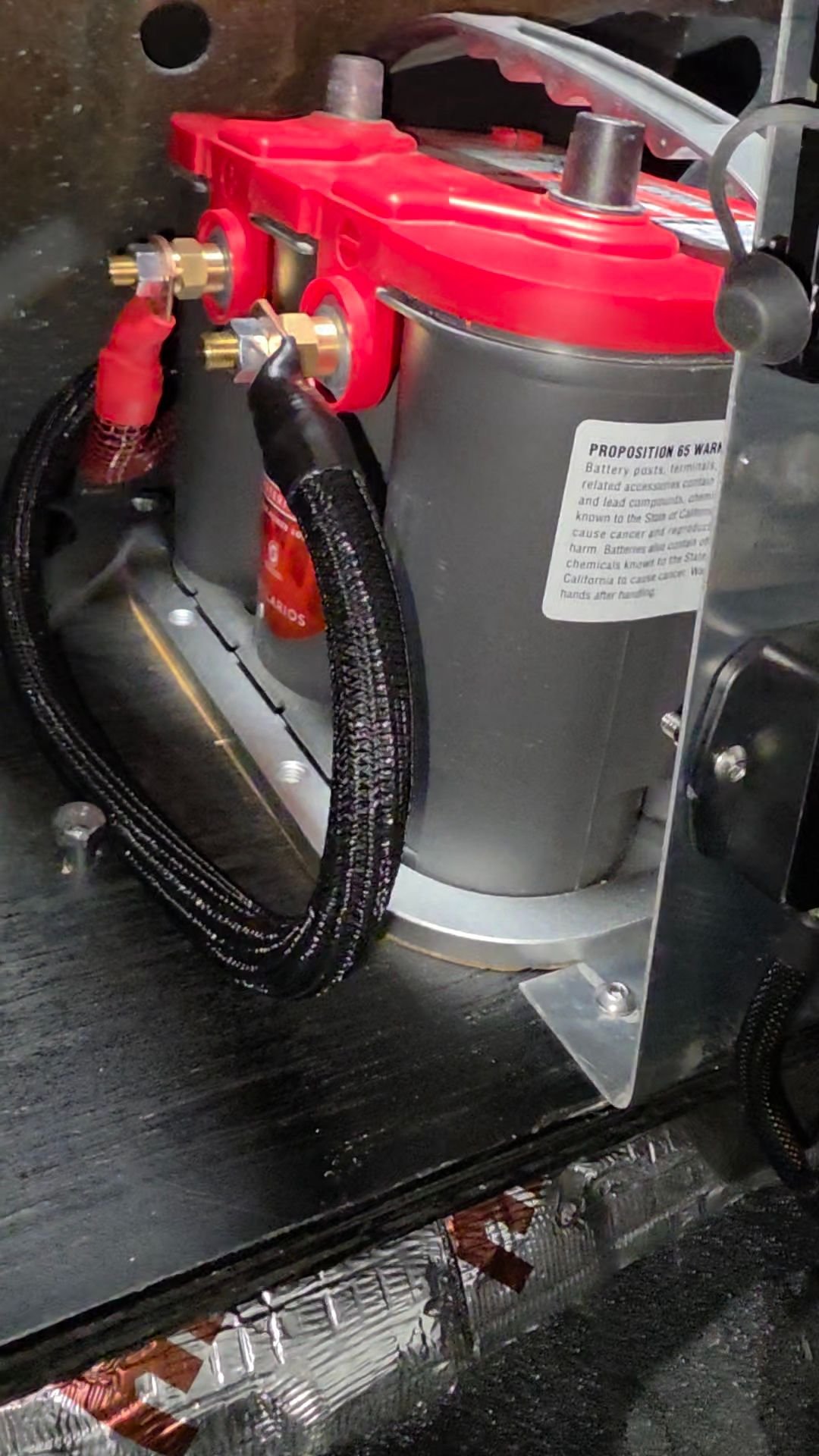

Default Electrical Progress
So I've been making great progress with the electrical system. Followed the instructions of some great people on this forum.
Old Mar 9, 2026 | 05:01 PM
  #151
Donny Wonder's Avatar
Joined: Dec 2020
Posts: 145
Likes: 39
From: Fort Bragg, NC
Default Post Mock up
The previous pictures were of the electrical components mocked up. This is them secured with tech flex. Feel free to make suggestions.
Made a simple but sturdy grommet using fuel line.

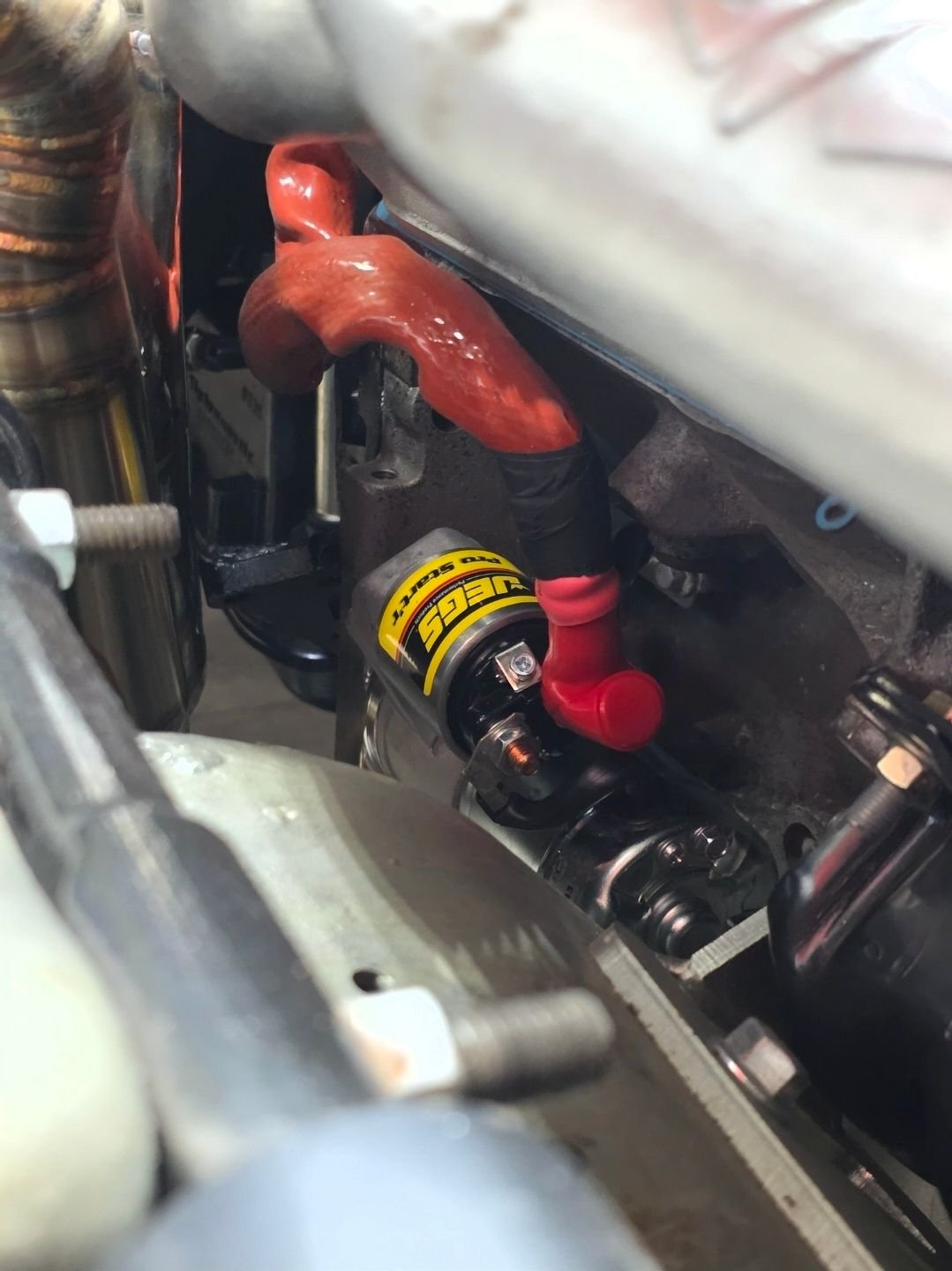

The Vaporworx PWM controller is mounted. I have to start thinking about the routing.
