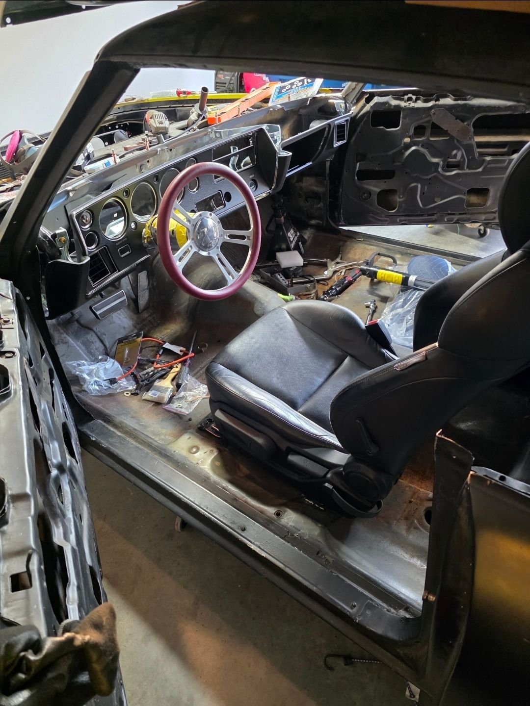

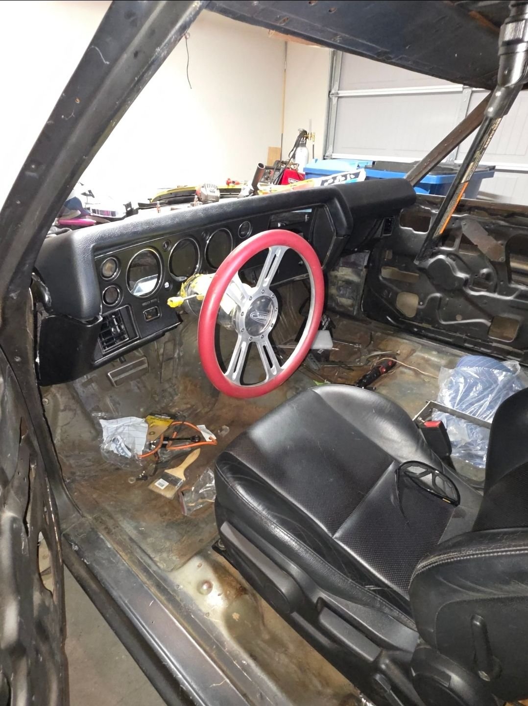

I finally have the seat mounts welded in and the dash mocked up! Everything is centered well thank goodness. I have to fab up and weld a few brackets for the dash.
looks great are those the BMW seats?
Old Sep 19, 2025 | 07:14 AM
  #122
Donny Wonder's Avatar
Joined: Dec 2020
Posts: 145
Likes: 39
From: Fort Bragg, NC
Fronts are Hyundai Genesis. Rear are 5th Gen Camaro.

thanks bud, just curious but why didn't you go with the bmw's

I didn't want to deal with wiring them at the moment.

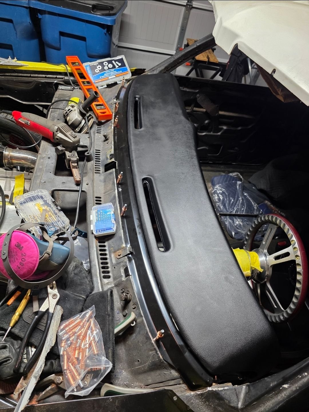

The process is going well. I'm going to weld the upper dash cowl in this weekend. I'm excited and happy with the results so far.
P.S. Those dash clips are pretty horrible. I may epoxy them on the upper dash pad.

Dash cover clips horrible, you say. I agree and use some JB Weld to keep them in place on the dash cover.

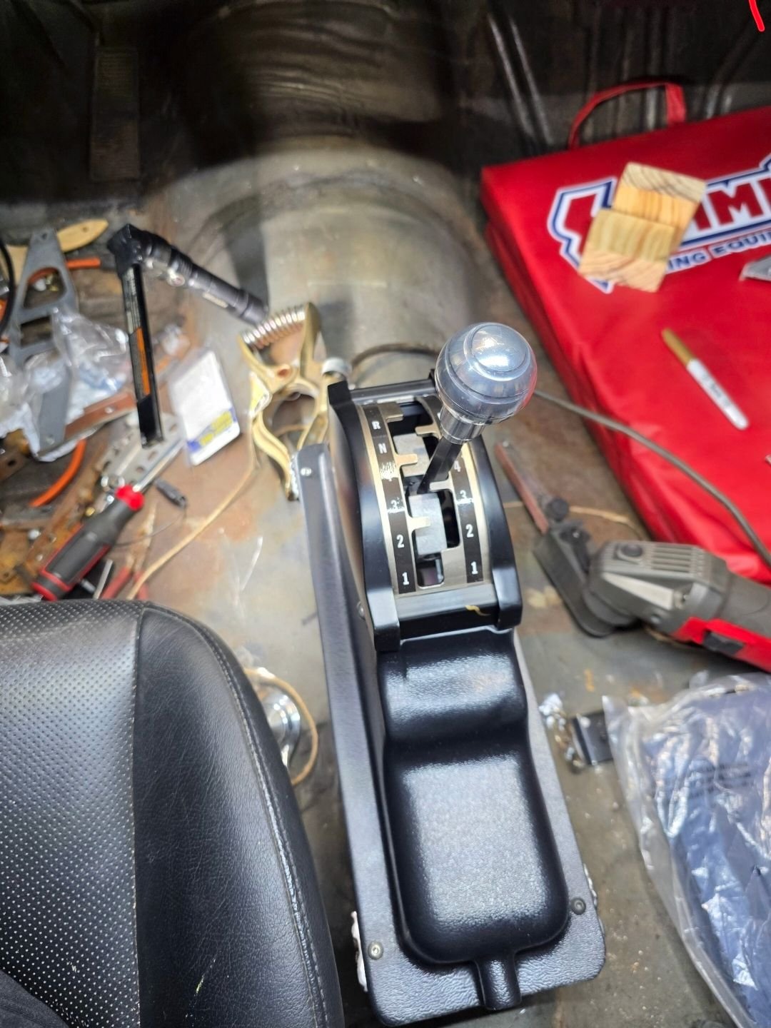

Default The shifter is in!
So I went and fabbed up some brackets and welded them in to mount the shifter.

Looks great

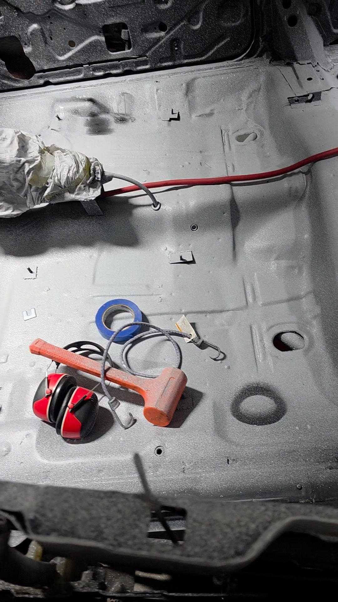

Default I'm making progress...

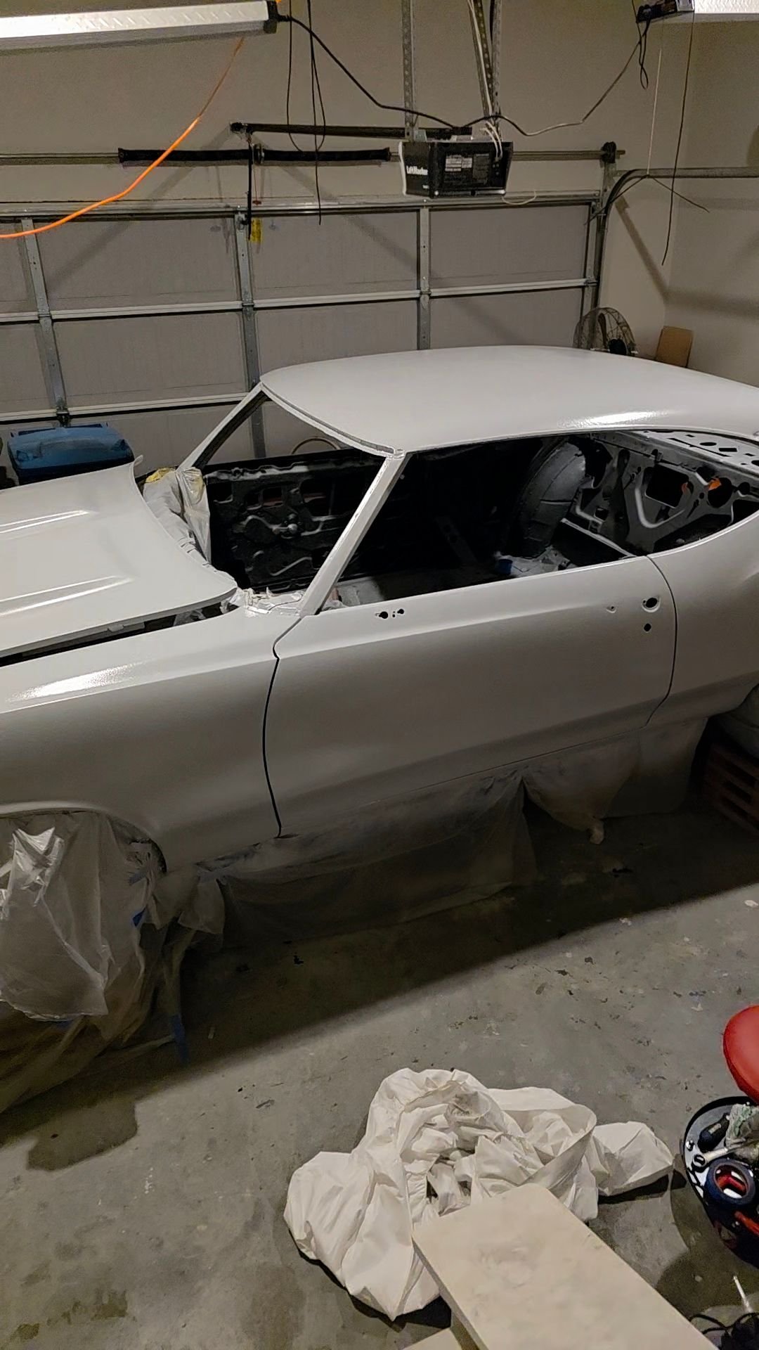

I finally have the car in high build epoxy primer. I'm am about to start on the wiring with the battery being in the trunk. I was don't want to have my have 1 million and 1 items under the dash. So let me know if my plan makes sense.
1) Have Terminator X Max under passenger seat/ I would prefer the trunk if possible
2) Put AAW Highway 22 under in the trunk
3) Should I run 1/0 gauge wire right through the firewall to starter or use Painless bulkhead pass through
Some key things: I will be using the Vaporworx PWM controller. I also have the Tick Performance Low Profile Air to Water Intercooler. Any suggestions will be much appreciated. I'm trying to have this thing done so Andrew ProjectGatTagO can tune this thing.
Car in High Build Epoxy Primer.

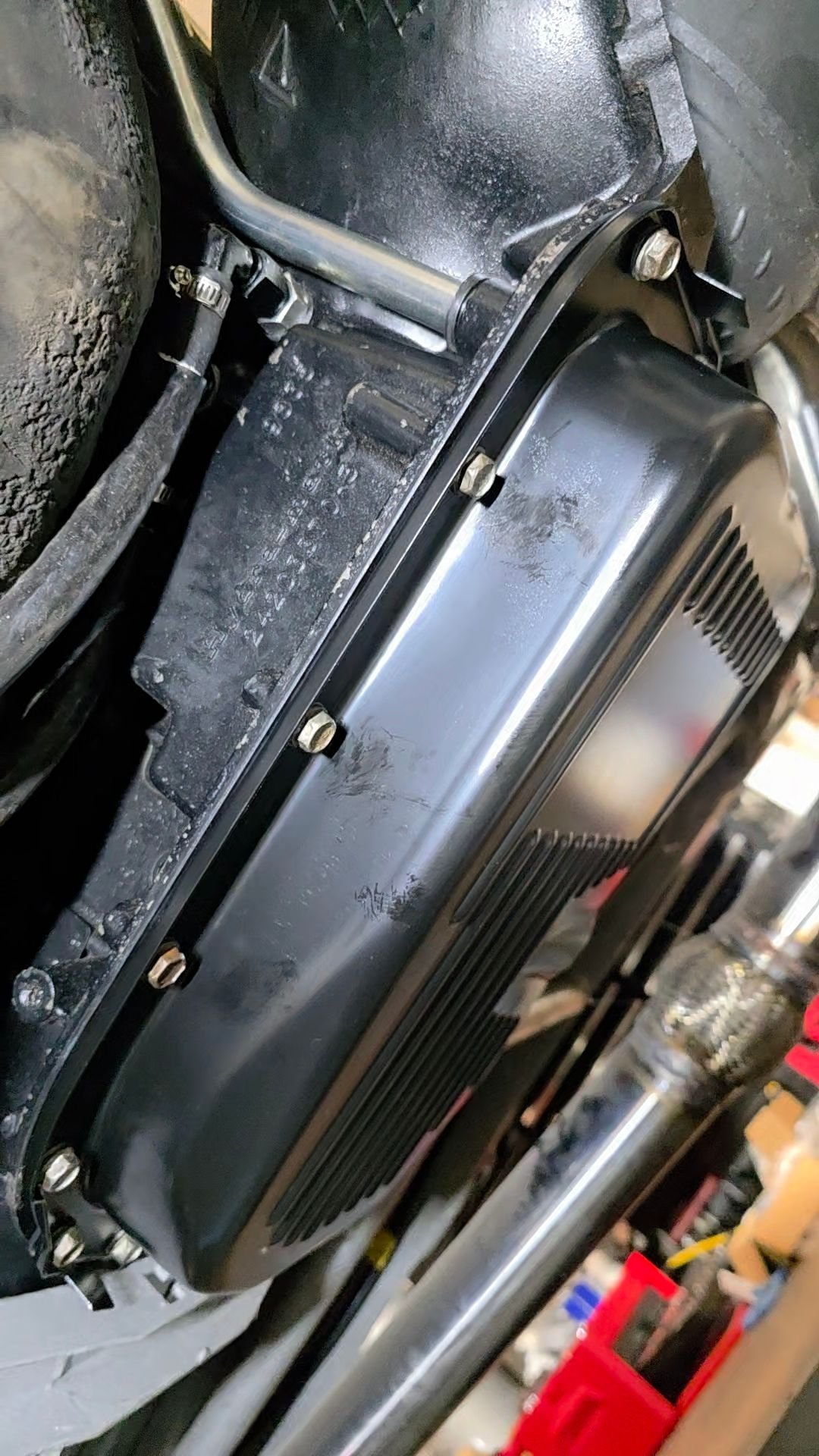

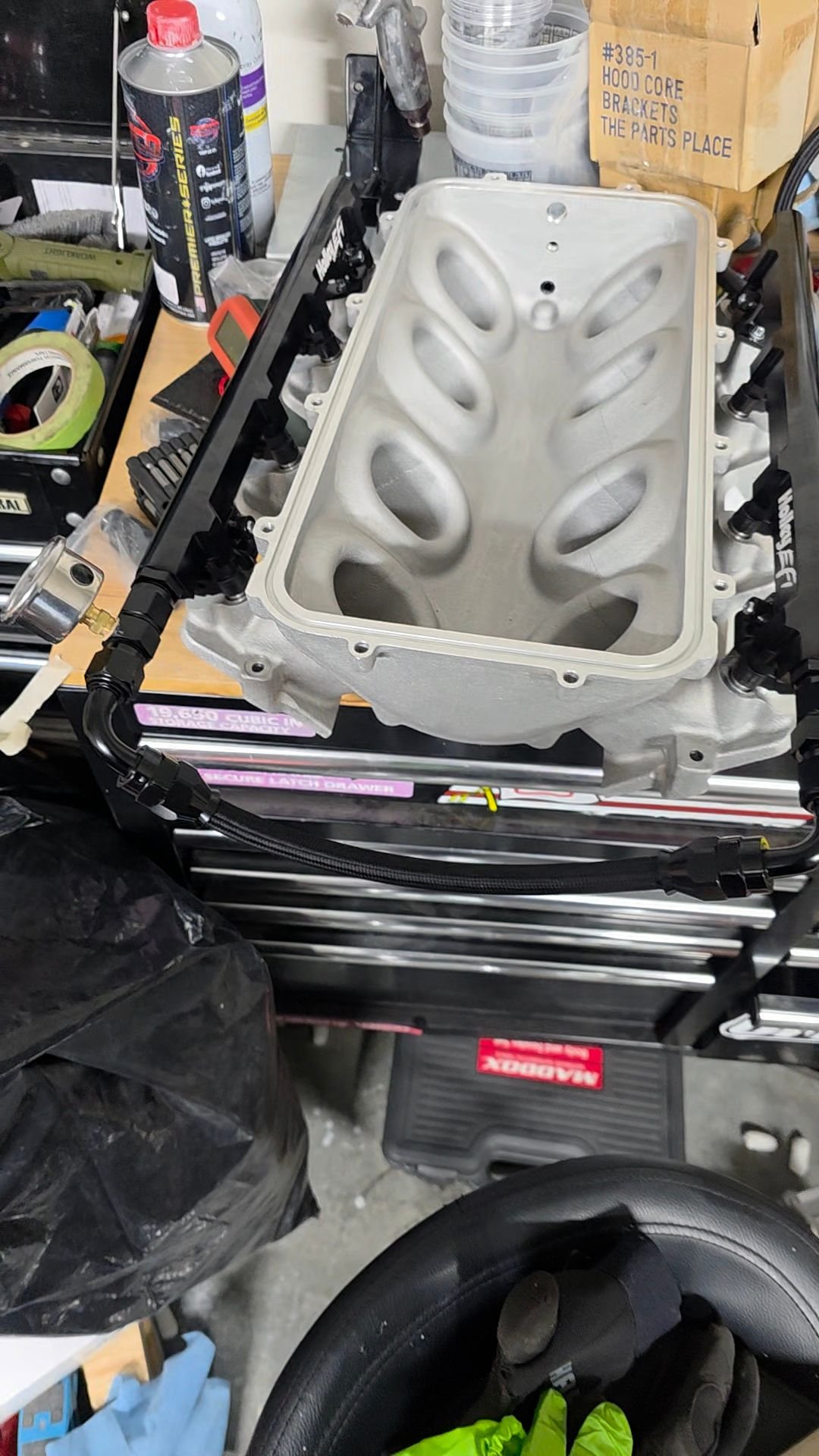

Made a crossover for the base of the intercooler. -8AN
Added a transmission pan with a drain.
Early model 4L80E pan with a drain.

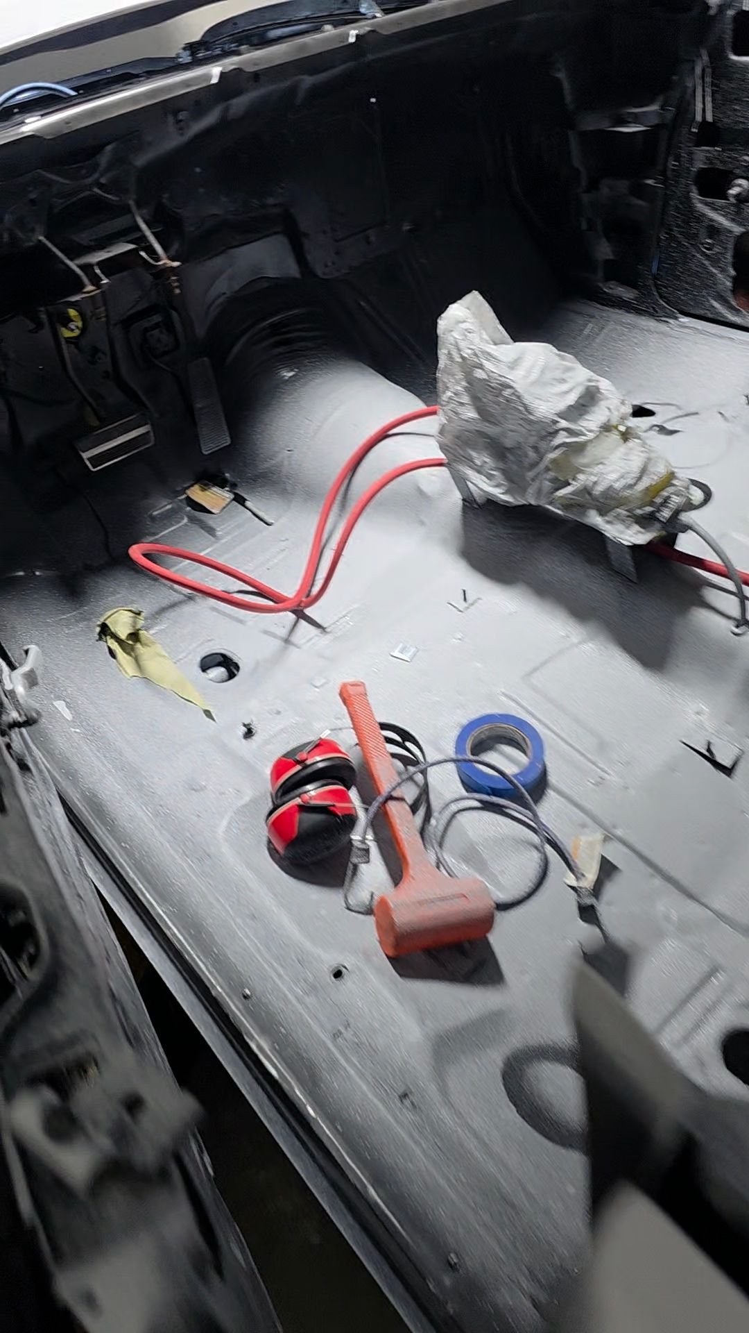

I would mount the Terminator X max in the glovebox area for easy access. You will want to have access to the ECU for viewing the LEDs that are on it and also for any wiring modifications or troubleshooting. I had a bracket designed that replaces the glove box that holds my Dominator and Hardwire PDM 28.
I don't know if it will work for you, but I can have another one made and you can adapt it for your needs.
Since the battery is in the trunk, I would use 00 gauge welding cable for both positive and grounds. I would run the positive wire through the holes in the rear bulkhead with a grommet and to a bulkhead pass that is somewhere at the intersection of the firewall, kick plate and the transmission tunnel. Position it in such a way that you can easily access it from under the car.
https://www.waytekwire.com/product/c...eeder-stud-red
The ground cable (also 00 gauge welding cable) can go through the trunk floor and run inside the passenger side frame rail and it should go directly to the engine block. I would then add a short 00 welding cable ground from the engine block to the frame and another one to the body. This will ensure that you have an excellent ground network without any redundant paths.
Andrew

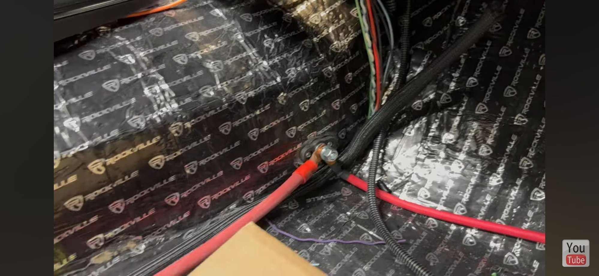

Andrew,
I appreciate you taking the time to help me as always. I will just mount the Terminator X Max in my glove box and cut the back of it out. My car is a super Frankenstein and has an aftermarket Chevelle dash. So I don't mind cutting on it at all.
I will order up the 20ft each of the 2/0(00AWG) welding cable. I guess I can sell the 1/0 or use it for my Subwoofer when the time comes. I already have the Painless Wiring versions of those bulkheads. I have this to use for grounding straps.
I borrowed a few pictures of the interweb of locations to put the bulkhead and wiring. Let me know if this will work.
I was thinking about.placing the bulkhead up and over more. That way it won't get kicked.
I have a bunch of these grommets to run the Terminator X Max Wires through.

For the positive pass through, you want it fairly close to the starter. Because that's where it will connect.
I wouldn't put the main harness down low. You're asking for water intrusion. I have a 2" hole in the firewall, behind the engine.
Andrew
