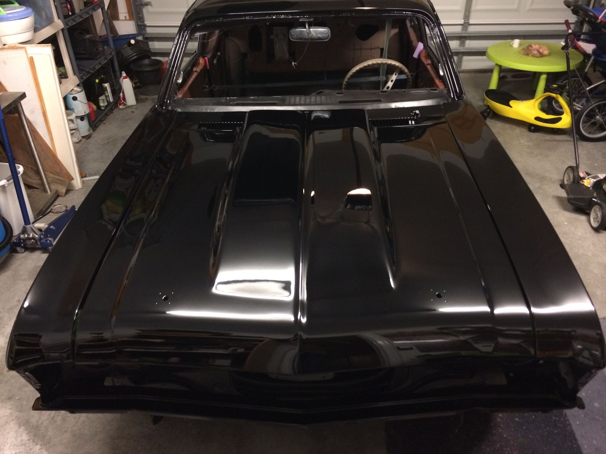

Ok, all, long time reader, first time poster.
Finances are prepped, beginning my build on the 70 Nova. A lot has changed since I've driven it last. Painted in '16, its been sitting in the garage since. I recently pulled it completely apart and decided all the old driveline just wasn't going to go back in. I'm going to start a similar thread on Steves Nova forums to address the interior, etc, but am turning here for the powertrain and driveline advice. What I'm very much interested in hearing is information concerning kits and known combinations that will allow me to save time and money by only doing work once. I have a fairly decent mechanical background but no real shop anymore and not many connections locally. Just myself in a 1.5 car garage with a level of tools that stops at the torque wrench, air compressor, and electric impact level! I.e. no welder, lift, limited specialty tools, etc.
- What I want out of the car: strong street cruiser. This car will realistically never see a track but I want to run it up and down the back roads and have fun on the weekends with the kids. Goals are somewhere around 500 hp/ 500 tq through a 5/6 speed manual. Targeting cruising to work every now and then around 1800 rpm at 60 or so mph so thinking 3.46-3.73 rear gears with some sort of limited slip.
- What I'm thinking: used 6.0-6.2L LS based motor with LS3 heads/intake, reworked factory computer, longtube headers, and a rowdy sounding cam (sound is non-negotiable!). Trans; seems like the new TKX would be perfect with a .68 fifth gear and a 3.55-3.73 final. I'm liking the GM LS7 clutch for this setup. I'm very interested in mini-tubbing the car and going with a 295-ish tire in the rear. Getting a complete 12 bolt rear from a company like American powertrain (open to leafs or coil-overs, don't think a back-half is necessary or in the budget) and upgrading the front stock with a basic disc setup. Probably 2in drop spindles.
- What I do have so far. 70 Nova body shell complete. Most recently a tired 355 ci SB and Muncie 4 Spd car with stock small 10 bolt rear and single leaf setup. 2007 Suburban 1500 with over 200K on the clock. However, I put a brand new 5.3 crate engine in it about 3K mi ago. 2003 Yukon Denali XL 6.0 with about 250K mi. Only issue with that is I gave it to my brother when his car died with the caveat that I get it back when it finally goes or he gets something else. I wasn't expecting it to last him another 10 years! Easy answer is to get my brother to buy the 'Burban for cheap and I get the 6.0 out of the Denali, but, his finances are prioritized to replacing his wife's vehicle before his.
- Budget: I'd like the car to be moving its self reliably under about $10K.
So, over to you guys to flesh out the plan with what you'd do and any advice on the direction to go, companies, LS swap products, etc that I need to be looking at. I have a local tuner (National Speed in Wilmington NC) that I'm going to be having a similar conversation with as they are who I've chosen to do the computer work. I'm at a career where my time is at a premium, so junkyard diving, etc, is not something Im interested in. Also, more importantly, PLEASE answer any question Im not smart enough to be asking; you dont know what you dont know!
Thanks for your time and look forward to the discussion.
How it’s sitting now
