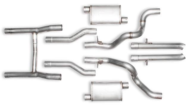

Managed to snag a Hooker Blackheart exhaust setup and it shipped. Will arrive tomorrow. 409SS, Rear Exit, 3.0" OD piping.
For headers I have Speed Engineering 1-7/8" Long Tubes. I was watching some of yours posts on FB and i have been considering putting Cats on this one as it's a driver and may keep the "smell" down a bit.
