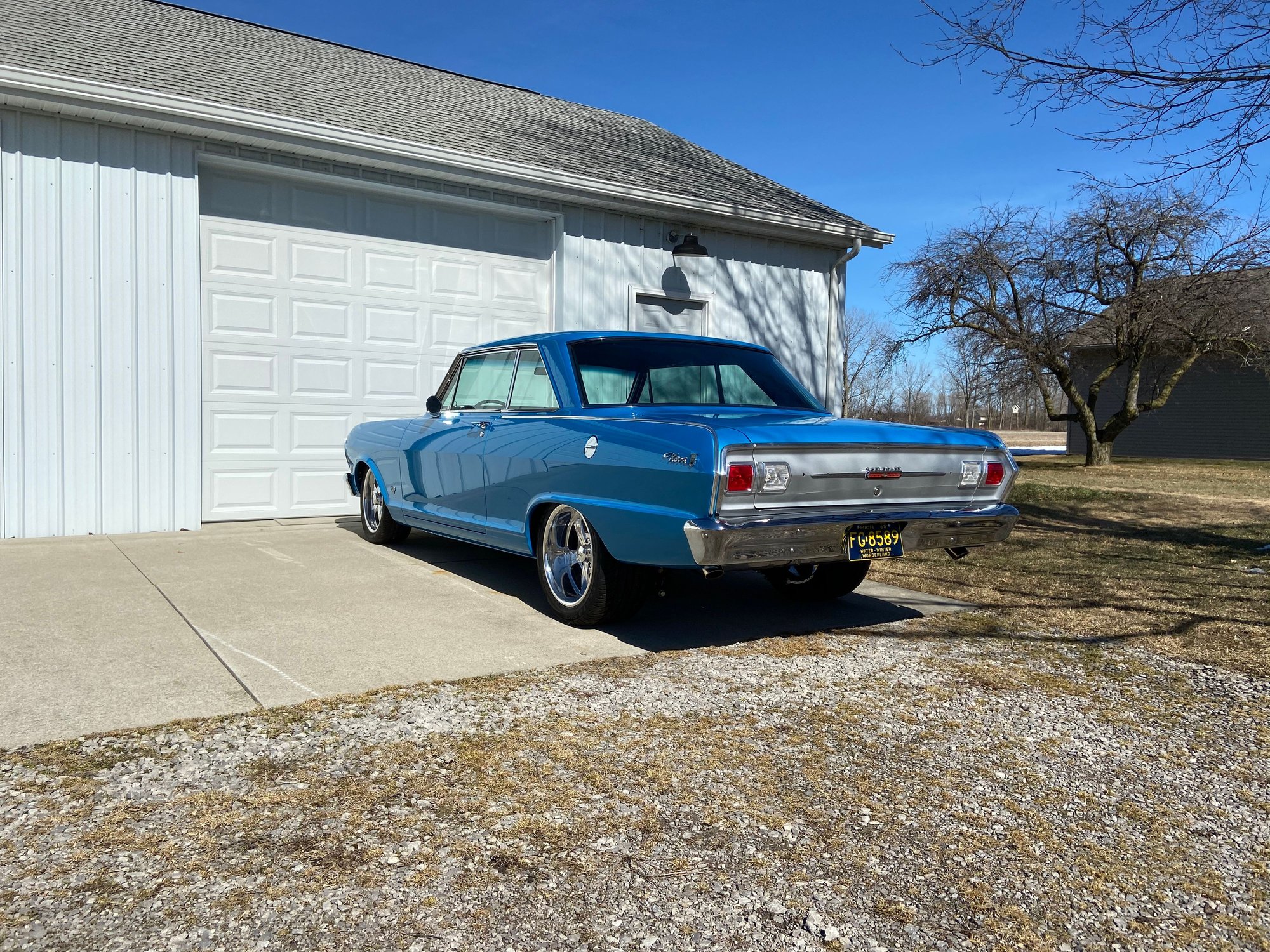

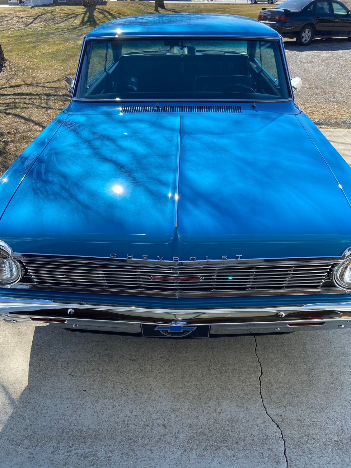

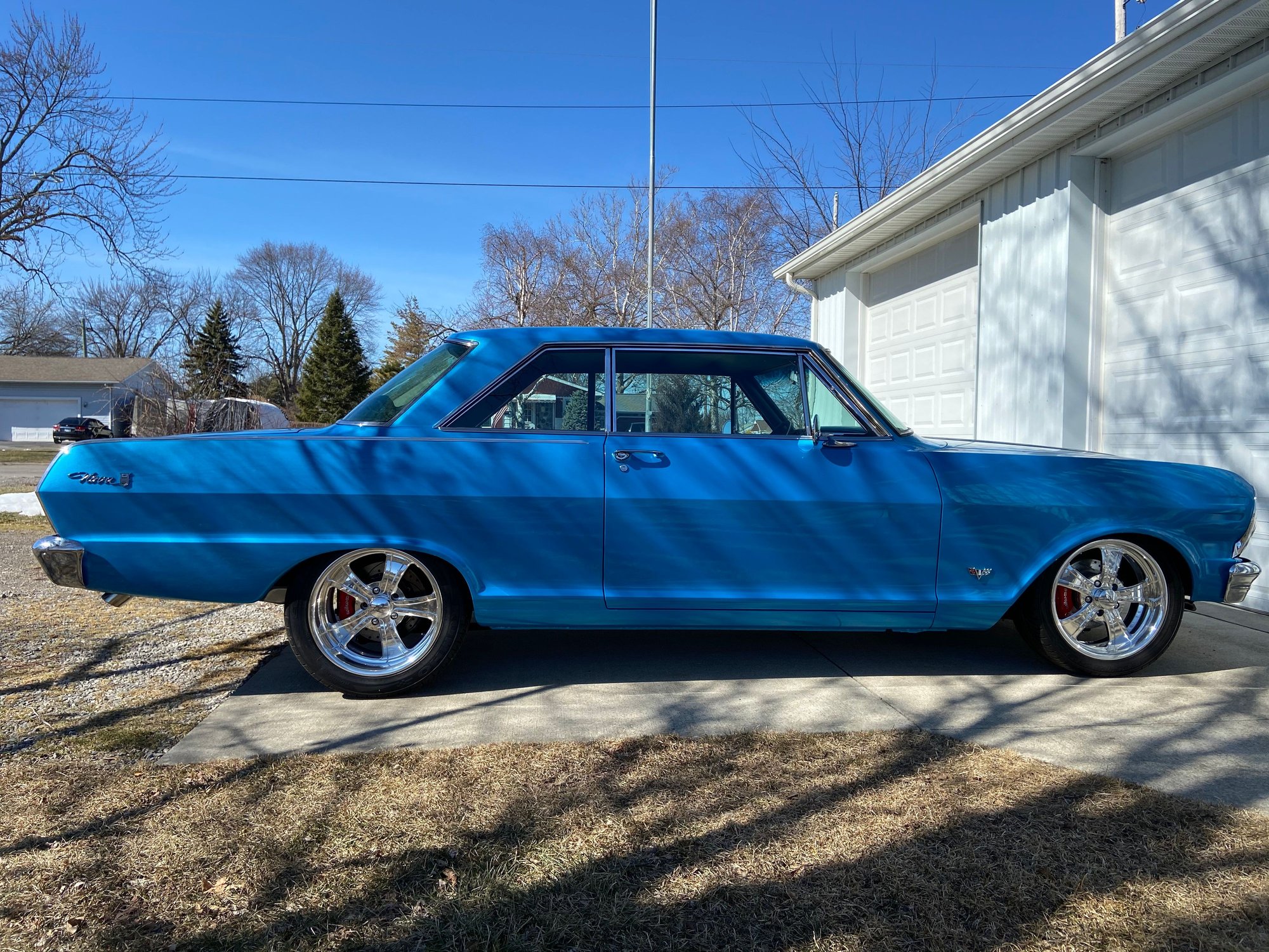

Sure I can post a couple more but they won’t be truck pics. 😆 lol
Its a 65 Nova but that’s ok thanks for the interest and kind comments I appreciate it!

Nice looking car. Glad you got it all figured out.
