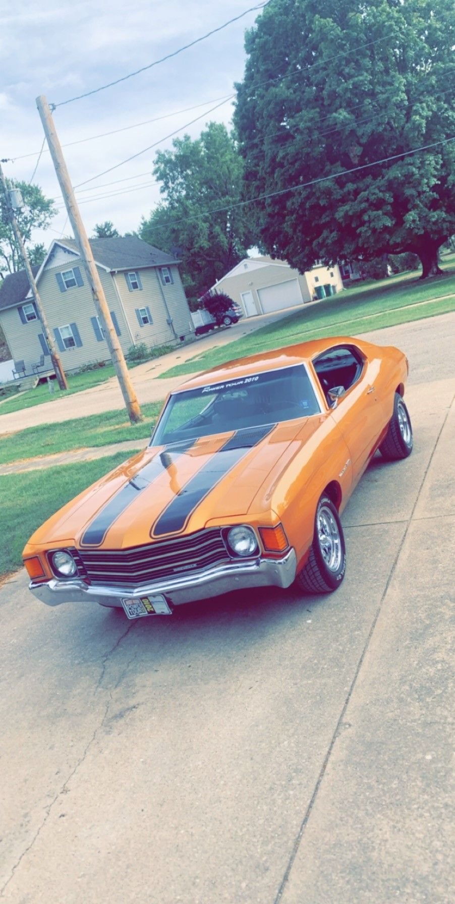

Had a friend give me a LQ4 6 liter block out of a 2001 pick up. Planning to build a single turbo set up to drop into my 72 Chevelle. Most builds I have found all show them using stock internals or crank at least. Unfortunately the block I was given is missing pretty well everything. I was just curious as I started buying parts, what does everyone recommend when doing after market crank? I've found some good piston and rod setups and I have good research on a cam. Also, what does everyone do when you have no ECM to start with? Been a long time carb guy with this Chevelle and this turbo LQ4 build has me pretty excited but I'm starting off a tad in the dark. Thanks (picture of the car getting the swap)
