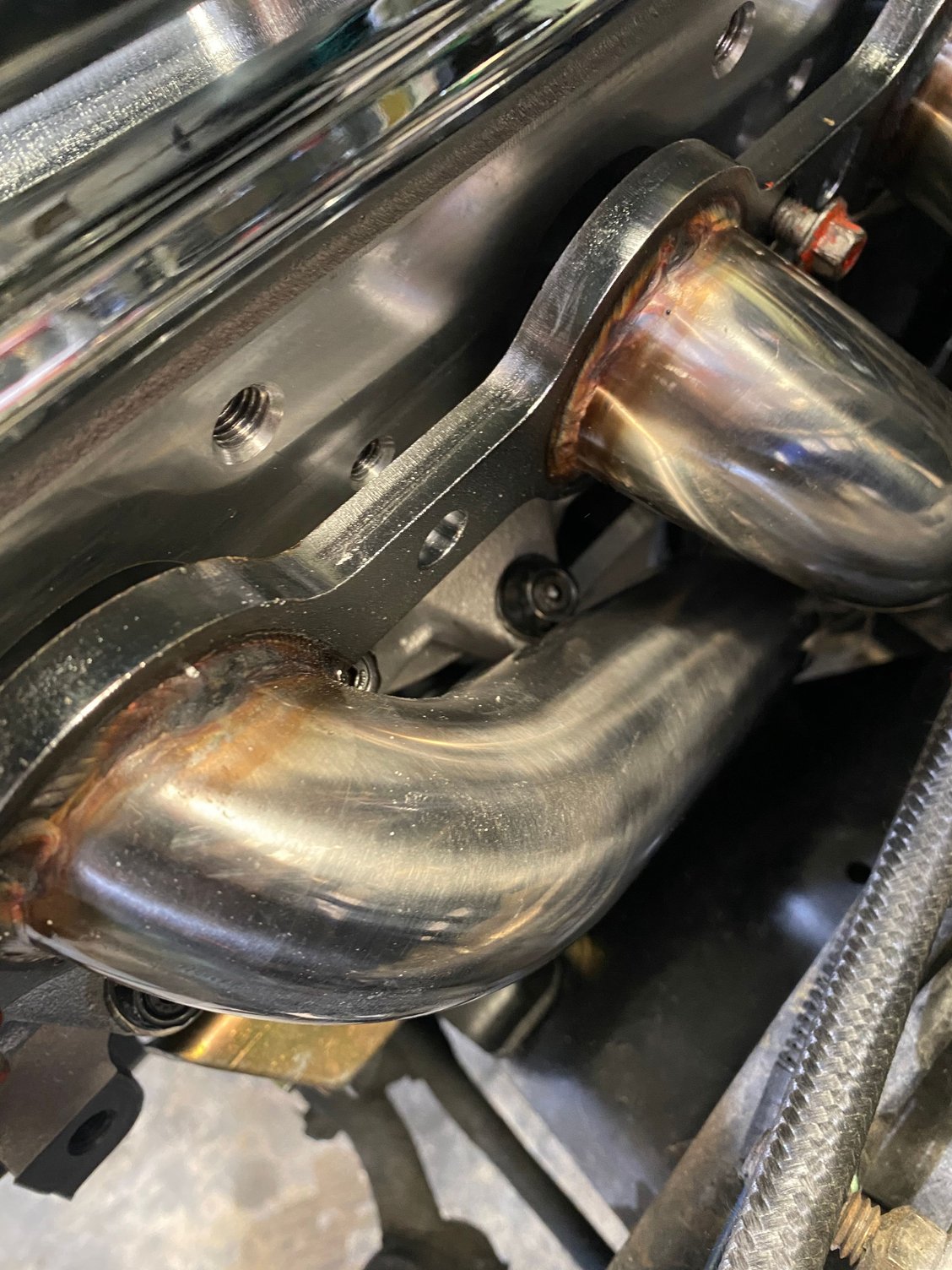

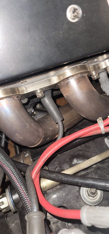

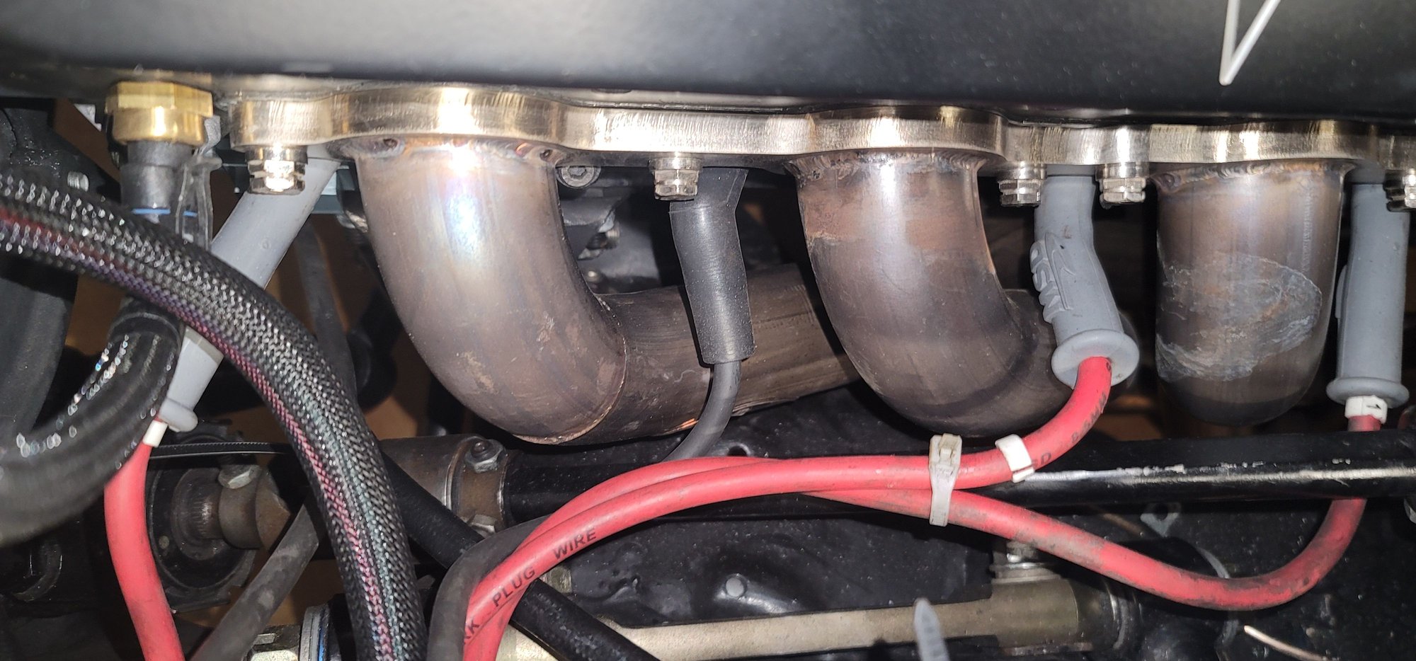

I had the1-7/8 Speed Eng headers on my 67 GTO, but my issue was the #3 spark plug was blocked by the primary tube. I ran them for a while then popped for Hooker Blackhearts 1-7/8 stainless. No issues now with access to the plug and no burning plug wires too. The Blackhearts are stupid expensive but they fit like they should and sometimes that's worth the money. They hang down even with the bottom of the trans pan incase u were wondering. Oh yeah I also torched the old SE headers and bent them away from the frame rail on the passenger side

looks like the blackhearts come straight out from the port before turning down. The SE headers turn right away and hug the block a lot closer. Looks like blackhearts will solve ur problem. ur welcome to come with me on my next bank robbery.

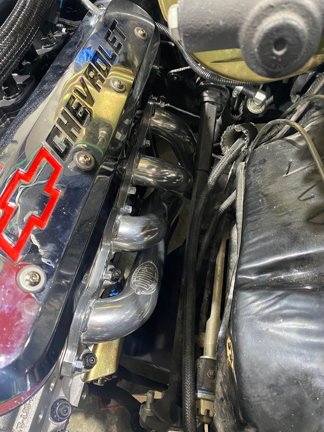

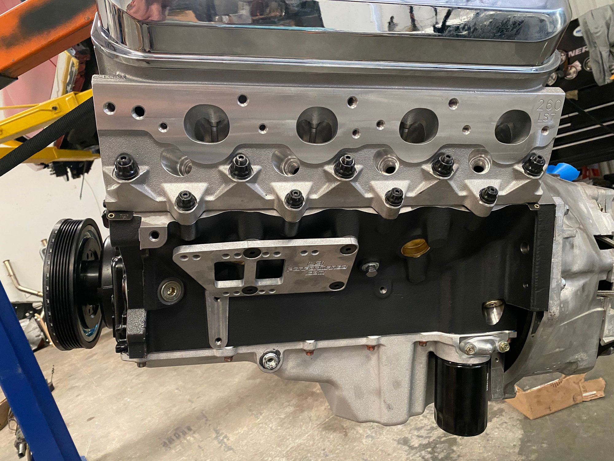

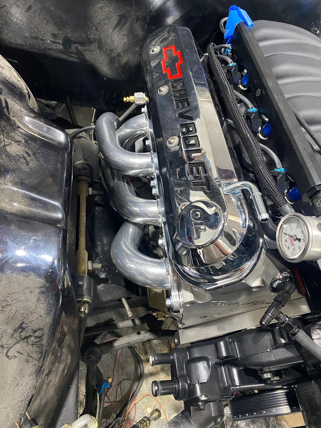

Got the Doug’s headers installed. Part number is D3336.
I am using a stock style SBC poly mount with eBay swap plates and the stock cross member mounts.

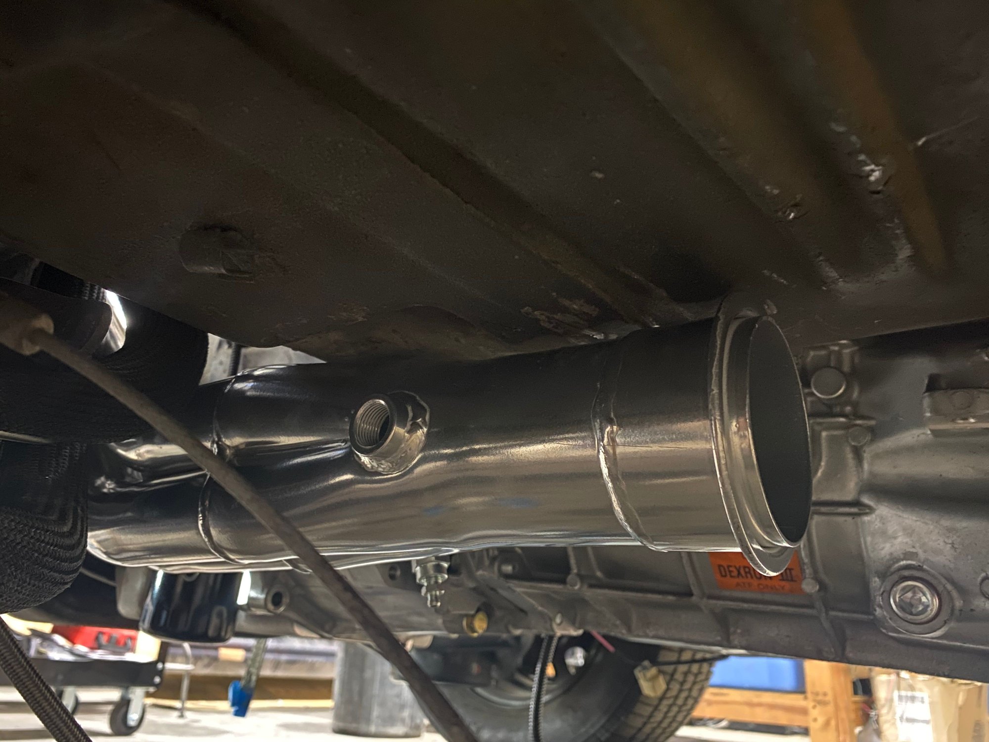

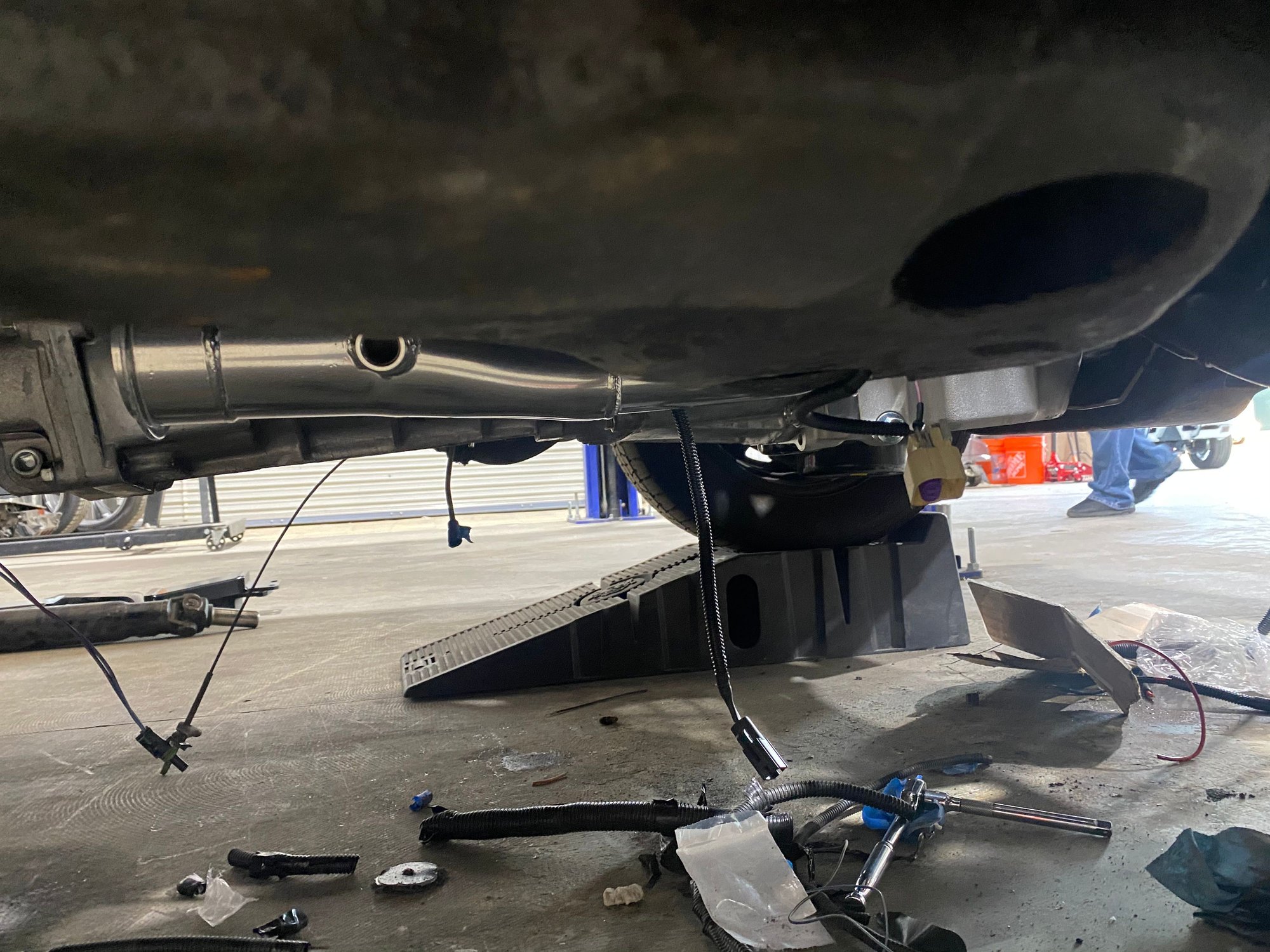

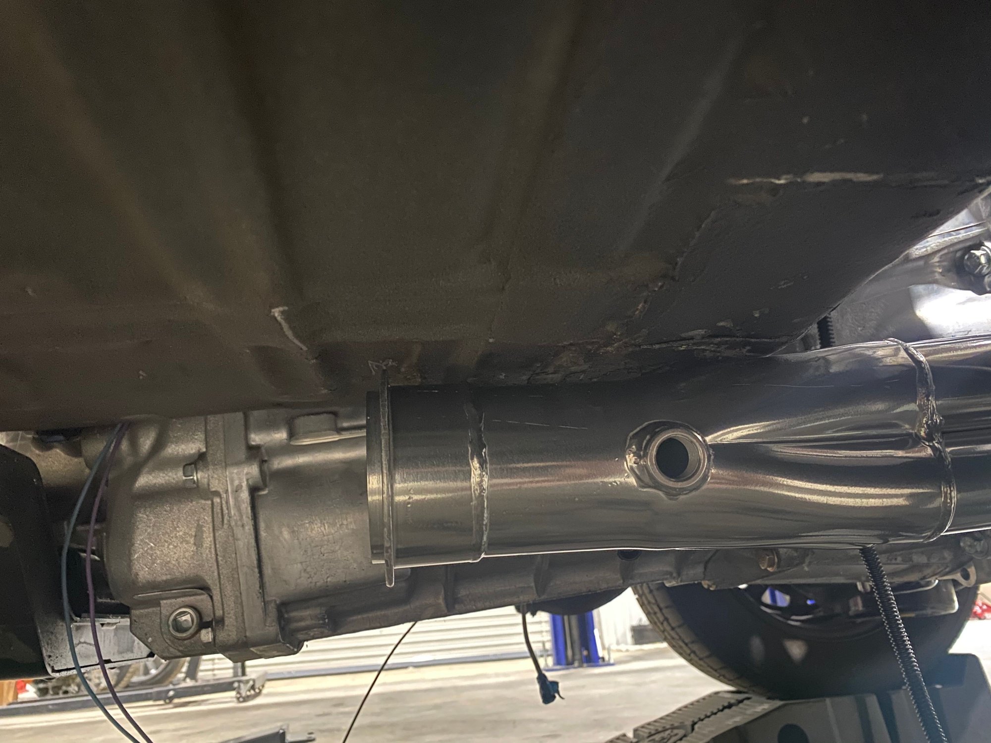

they fit great in the engine compartment but the collectors touch the floor :/ I used a pry bar to try and make more room which it did but not a lot. I’m looking at replacing the body bushings as the are original and probably pancaked.
Swap plate
SBc mount
Passenger side header
Passenger collector hitting floor
Driver header
Driver side collector
Ground clearance

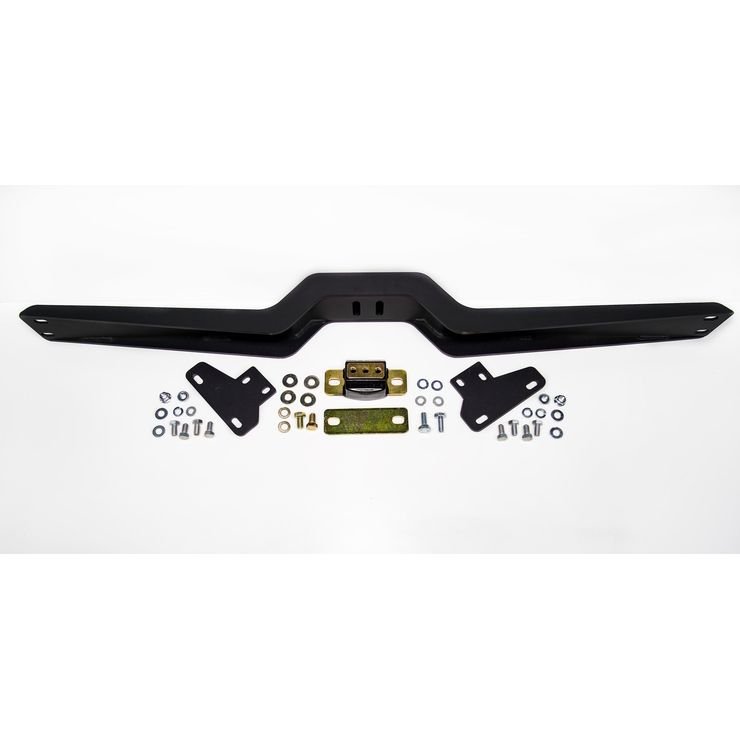

the transmission crossmember that came with my t56 kit from SilverSport Transmissions is very similar to this one
the crossmember is tight against the floorboard and drops down where the transmission mounts. The crossmember is approximately 1.5” thick. It’s a boxed tube design.
so the exhaust has to go under the crossmember
i might have one that offers better clearance for exhaust laying around my shop, I’ll have to look for it.
similar to this
