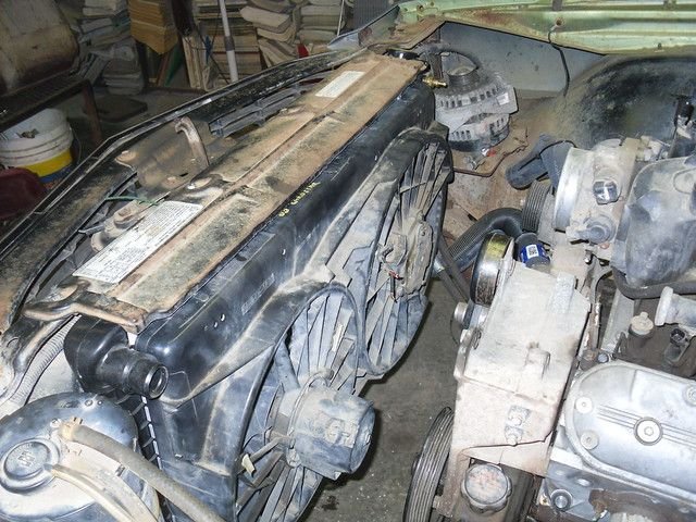

I have a 5.3/4l60e swap in a 74 c10 truck. It has a sns stage 2 cam Fti 3200 converter. I've been having a coolant issue lately. I have the stock c10 radiator 2 perma-cool e-fans rated at 1600-1650 cfm each. 190 thermostat. The fans come on when it reaches a certain point no problem. It's just when I'm in stop n go traffic for a long time or in a drive thru my temp reaches up to 230-250 and I have coolant spewing out of the overflow cap with or w/o a/c being on. But as soon as I drive off my temp goes all the way down to 180-198. NOTE: I do have the coolant lead from the head on the driver's side tied into the over flow hose going into radiator. Since I'm not running a ls swap radiator in the truck. What do anyone suggest could be my problem?

Can you post a picture of how you have them mounted???
I ran basically the same drivetrain combo as you for years with a Windstar fan setup...It is 4400 cfm total, But. I rarely if ever hear the second fan kick on...

Can you post a pic? The front steam vents need to be tied into the pressurized system somewhere, not into an overflow line to the overflow bottle.

I've solved my problem. Come to find out I had my steam line from the head tied into water reservoir line going into the outlet on the radiator above the cap. There was a peacock I was enable to thread a barb npt fitting and run the steam line to there which was located below the radiator cap but above the lower radiator hose. Plus I bled out the coolant system and drove in traffic no hot temps and stayed in temperature range as you mentioned for your setup.
