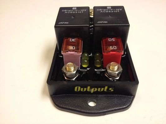

I have the same Windstar fan setup in the LS powered 72 A-body wagon in my avatar.
I run this dual relay setup in mine...
These are 70 amp relays...I'd have to look, but I think I run 30 amp fuses for each fan...never had a problem running both or just one. (I trigger mine with the factory ECM)
I know this is probably a mute point if your going PWM.
