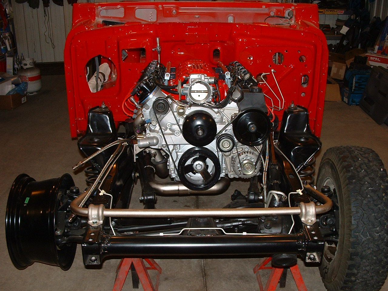

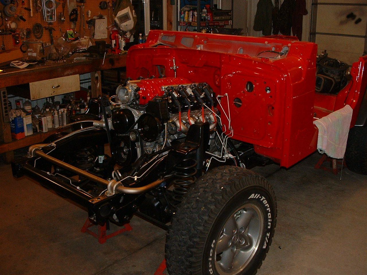

On my 98 TJ LS swapped I just bought generic block huggers. Sand blasted them and had them coated locally. Been on there over 13 years with no issues.
Couple of pics.
