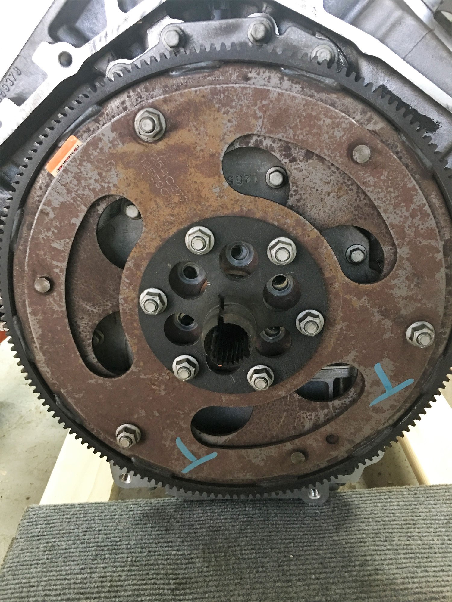

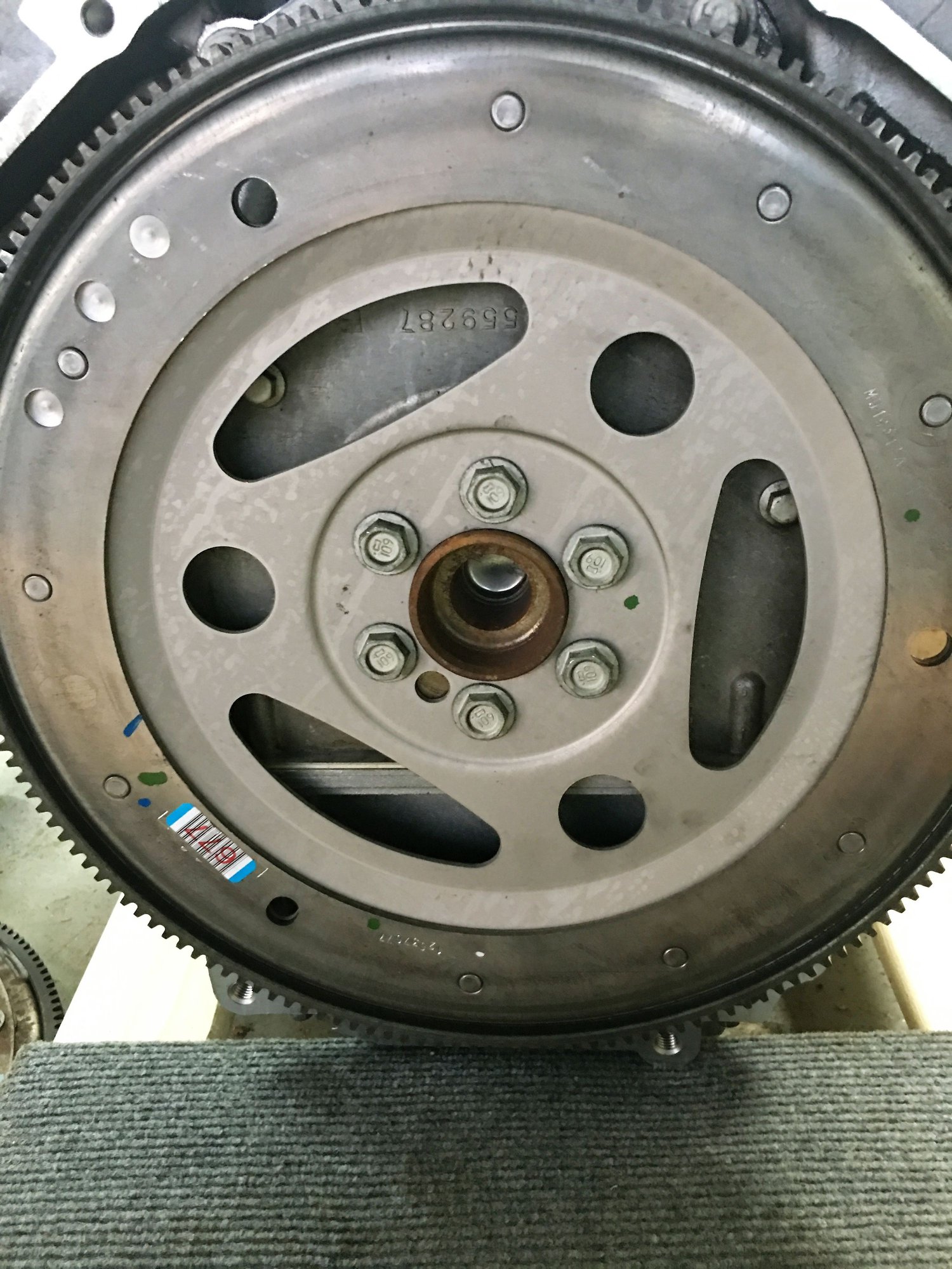

I put a LS1 from a 2000 Corvette in my El Camino, and had the same issue. The Corvette LS1 has a flexplate that the front of the driveshaft attaches to. I had to replace that with a standard flexplate. I think I used one from a Camaro. Then I used a 4L60E from a 1999 Camaro. Below you can see the old flexplate and the new flexplate.

I believe if you tear apart the setup in that pic of the corvette flywheel,, you'll find thats a regular flywheel/flexplate behind a adapter/spacer assembly for the torque tube connection.
