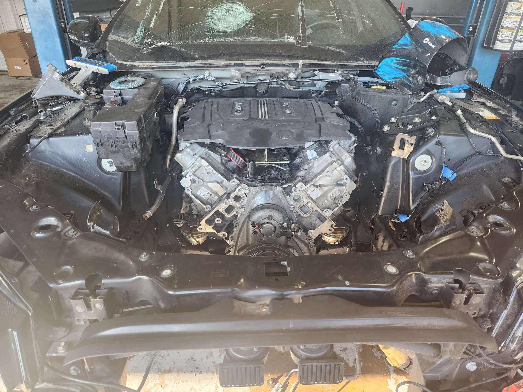

I am still on the fence about the ecm that I'm going to use. Have several options.For now the jaguar ecm will stay, and I have gone through the engine harness to clean up the unnecessary things. Want to keep it as factory as possible, but I'm not opposed to ripping it all out if it dosent work correctly. The pmc adapter did in fact mate the LT engine that I have to the 8hp. Was able to reuse driveshaft and all. Engine placment is awesome with plenty of room. However i'm hoping this older can system will play nicer than my 20 mustang that I swapped. "Fingers crossed"

With that combination of parts, I would do the Holley Terminator X Max with the GDI controller and a TurboLamik TCU for the transmission.
