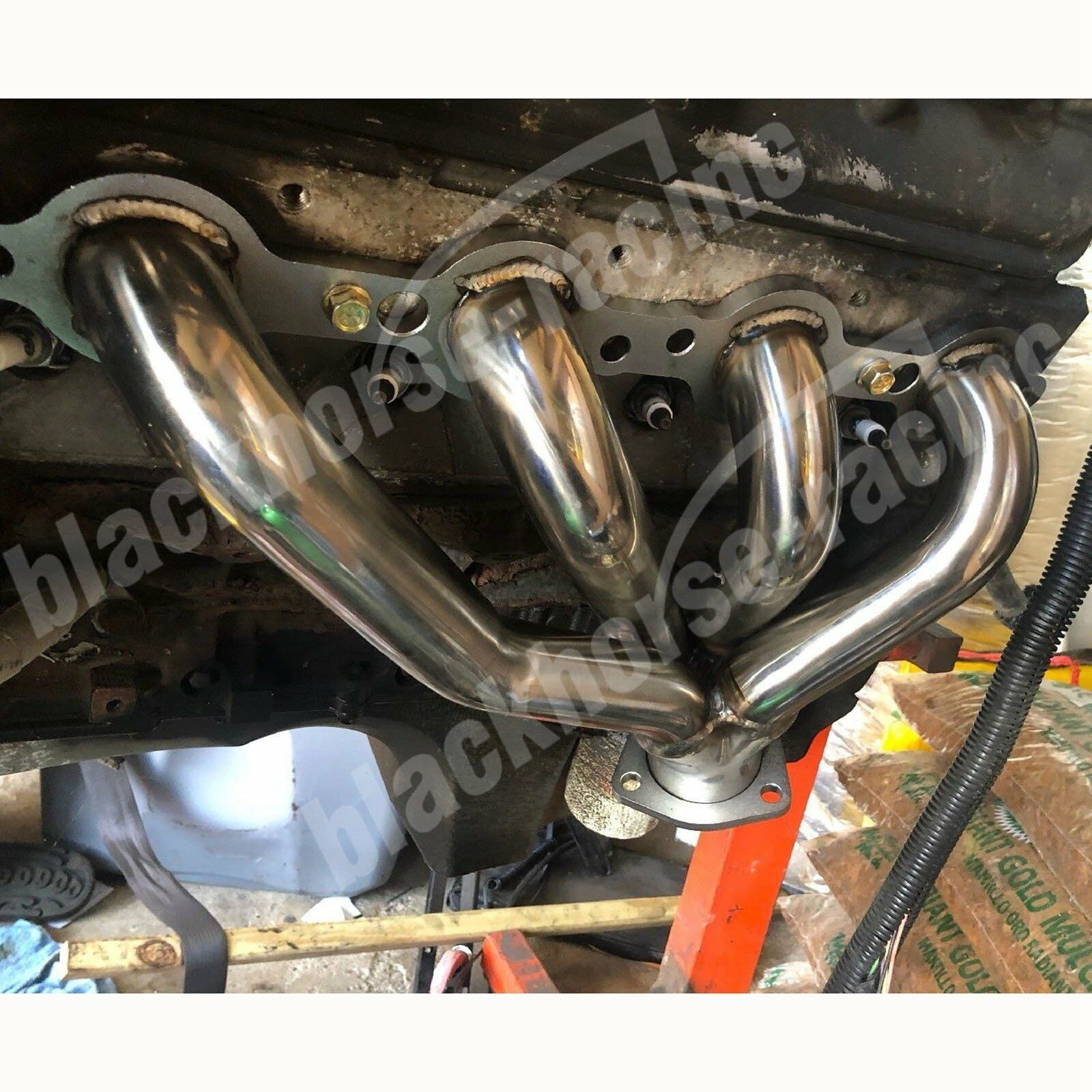

i have a set of block huggers purchased from ebay - pretty sure you can't link to ebay on this forum, but just search "ls1 block hugger headers" and peruse the plethora of pure stainless chinesium that's available.
some pictures of them in my thread here: https://ls1tech.com/forums/conversio...volmaro-2.html
passenger side looks like this

you could also try these s10 swap headers. the driver's side dumps fairly close to the block and somewhat more rearward than the block huggers. blackhorse racing on ebay on has, search "s10 ls swap headers"

Power isn't at the top of the priority list on this one. The Summit ones we tried were 1-5/8 primaries, and the ones on the car when we got it were also about that size.
Has anyone else used Hedman 68520 headers? Those look about right for this one. Now if I can find some and get them soon, maybe those will work.
And thanks for the pix @bobcratch . You gave me some ideas, even though the specific pix and links didn't look like they'd fit.
