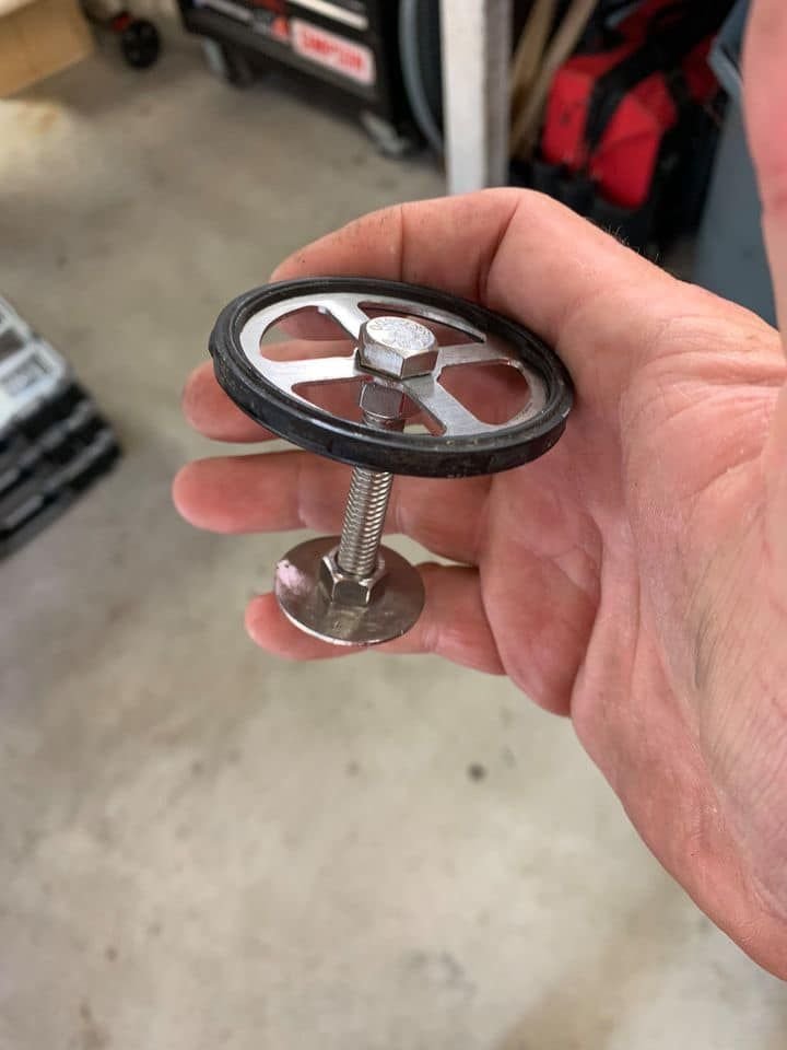

Yeah overheating while cruising is a radiator or tuning issue. I don't run a thermostat at all I'll share a pic of what I run. I'm running a Summit dual pass radiator which has a big a/a intercooler in front and a single Ford fan. On E85 with tuning specifically to keep it happy (ask me if curious) I cruised yesterday in 85F heat at 19x, and in bumper to bumper traffic I was 189-197.

No haven't needed to make that change though I like the idea of it. Just using the high speed fan setting of the Contour fan.
I just wanted to show that even a low buck solution with a big obstruction can work if you have the right parts.
