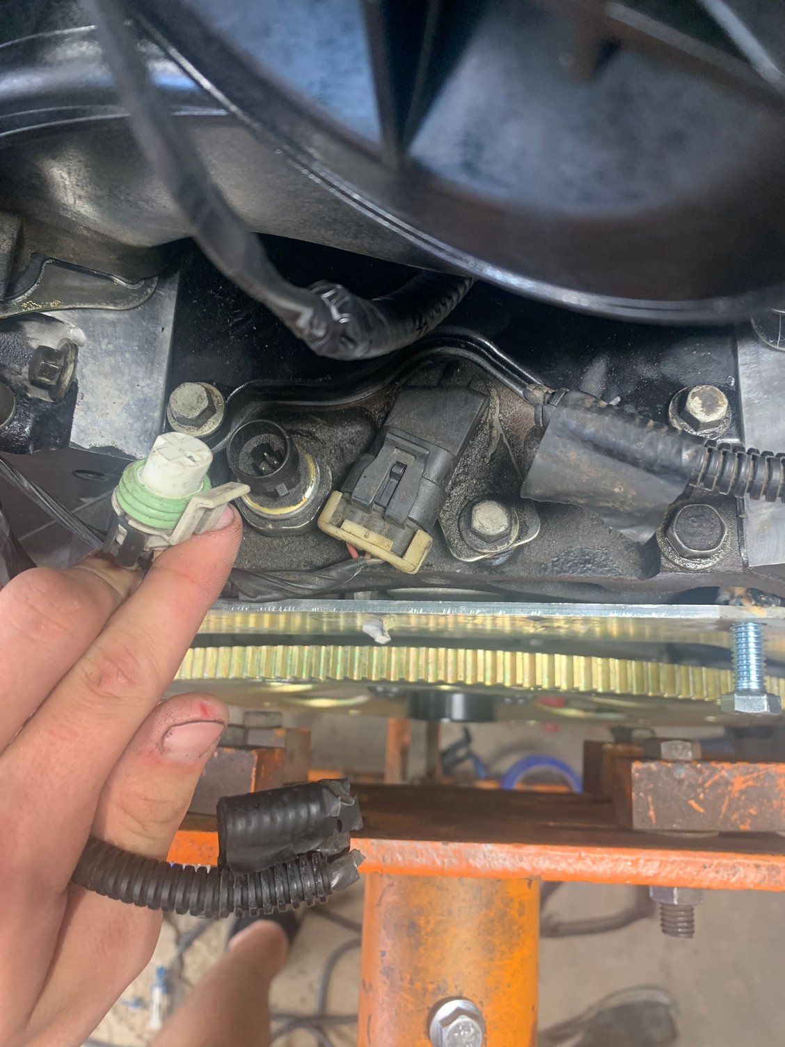

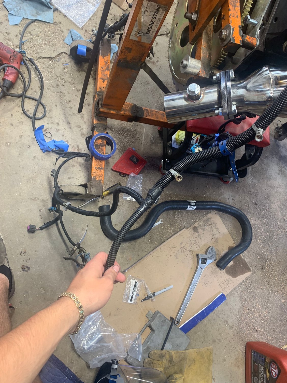

Old Aug 13, 2022 | 11:07 PM
KyleKetterhagen's Avatar
Joined: Apr 2022
Posts: 81
So here’s all those connections that I am confused about (the old o2 sensor is still with the harness so ignore that one)
Old Aug 14, 2022 | 12:59 PM
The0nlyon3's Avatar
Joined: Aug 2007
Posts: 405
Likes: 42
square 4 pin plugs are probably rear o2 sensors (not needed) but the gray trapezoid plug is front o2 and required.
Old Aug 14, 2022 | 01:00 PM
Joined: Apr 2022
Posts: 81
i was thinking that, but I’m more concerned about the oval plugs
Old Aug 14, 2022 | 01:55 PM
dlwilson's Avatar
Joined: May 2011
Posts: 148
Likes: 28
From: Lake Worth, FL
Default AC compressor?
I can't be sure, but I think that's the AC compressor clutch connector.
Old Aug 14, 2022 | 02:44 PM
Joined: Apr 2022
Posts: 81
they seems to go back further than the transmission and don’t connect to any engine part and it seems like there’s another rear o2 sensor so I think I’m just gonna chop all those off
