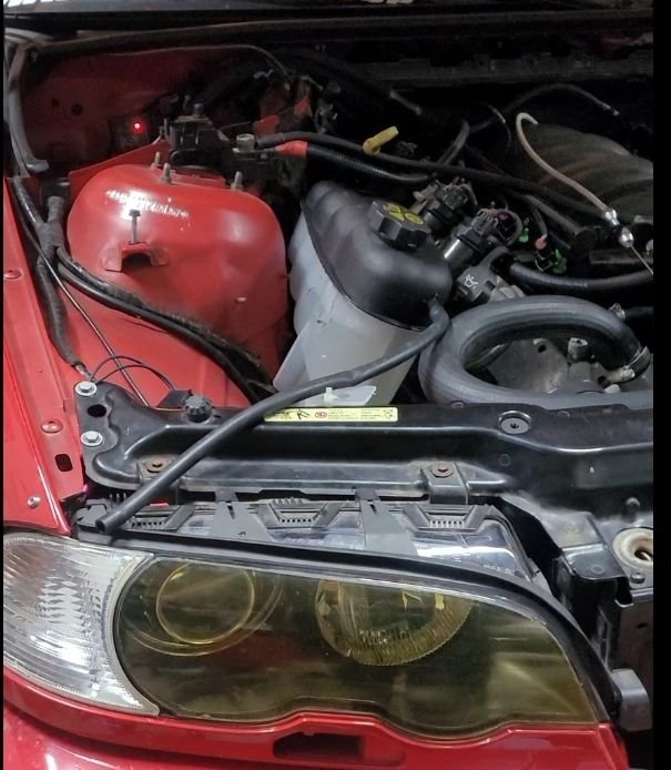

The radiator is the lowest part of the system, and the upper rad hose seems to be the highest point as it keeps air locking, (but the resevoir cap is higher than the rad hose?) I've tried venting the steam ports into different parts of the system and it doesn't seem to make a difference. The car runs between 190-210 and never goes over 210, it just pushes water out of the system after 3 laps. Upper rad hose is full of air too.
I'm concerned the force of drifting corners at high rmp is allowing the water pump to pull air from the reservoir
Pic shows resevoir height in relation to upper rad hose, we mounted it at this height and leveled it. 2012 tahoe resevoir.

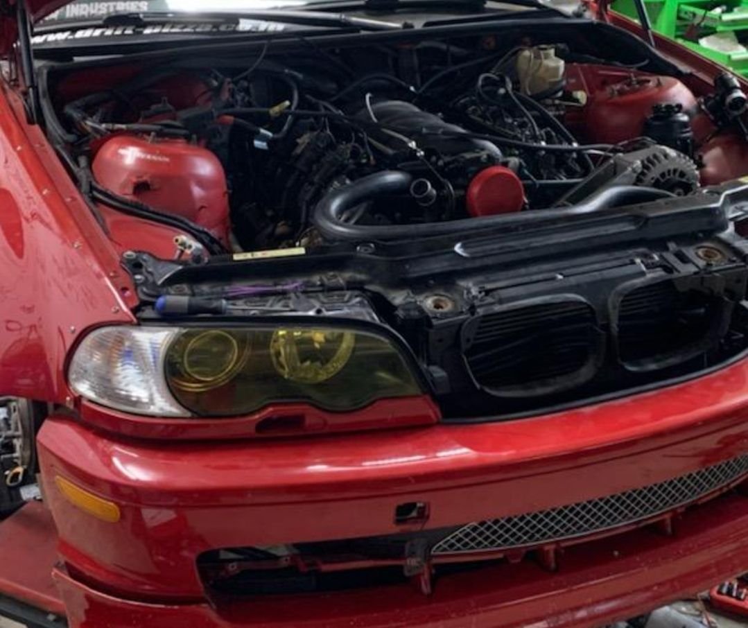

General engine bay pic, not showing resevoir but how little room we have to work with.
At this point I'm thinking I need a custom low profile metal expansion tank that will fit above the intake and a swirl pot to get the air out. Any help or insight is appreciated, I've attached some pics but I need to take some better ones later.

In my e39 I used an aluminum mini cooper expansion tank that I found on Amazon. I made a bracket and mounted it up by the driver's side strut tower, and my motion raceworks steam port kit vented to that. You could do the same on the passenger side.
