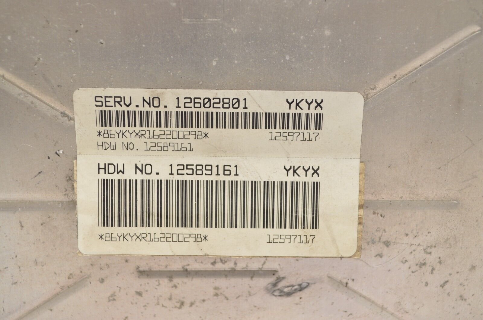

Does this PCM have the IACV drivers?
Old Dec 5, 2022 | 02:06 PM
Sacrilege's Avatar
Joined: Apr 2019
Posts: 220
Likes: 76
From: Vancouver, WA
Default Does this PCM have the IACV drivers?
*edit* confirmed. Has driver.
Has the correct hardware number but newer service number, from an 07 express van. Seller isn’t willing to open it to verify.
Old Dec 5, 2022 | 09:24 PM
B52bombardier1's Avatar
Joined: Dec 2017
Posts: 1,467
Likes: 265
From: Bossier City, Louisiana
Yes, that Hardware number is on my list of IAC-compliant PCM devices.
